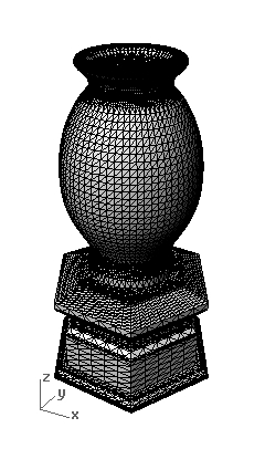

    As far as software is concerned, I use Rhino 3D. :cool:
    You can save any model you design as an .STL file.:doubleup:
    This is an example of a vase modeled in Rhino and saved as an .STL file
    Hope this helps.
