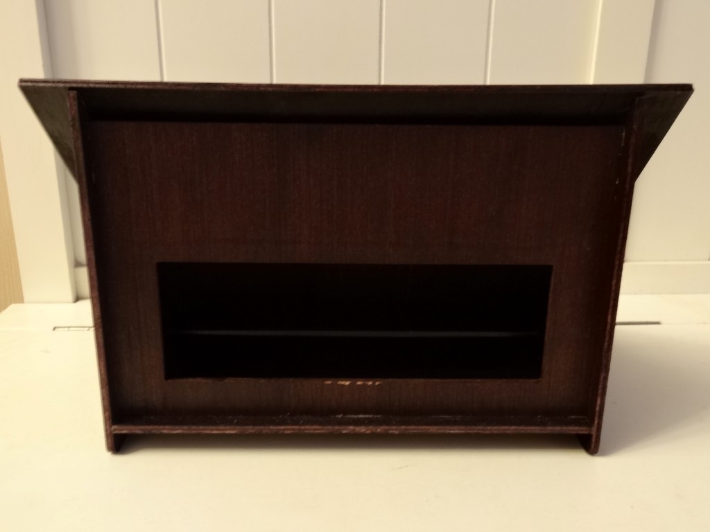

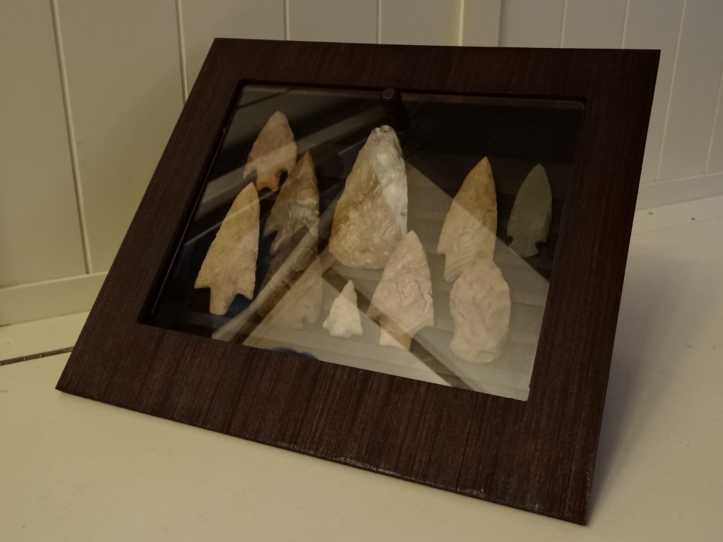

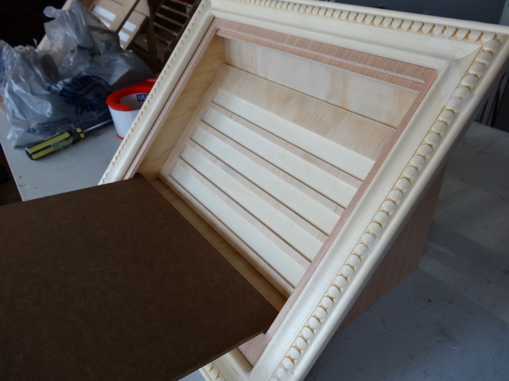

    Hey guyz,

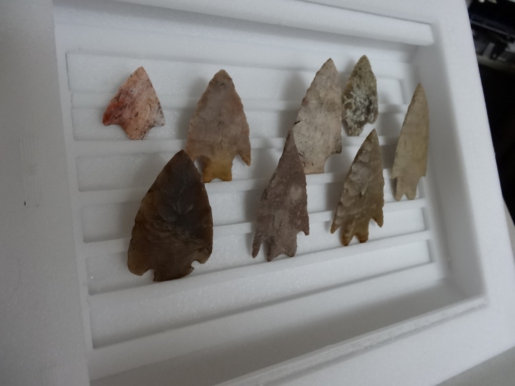

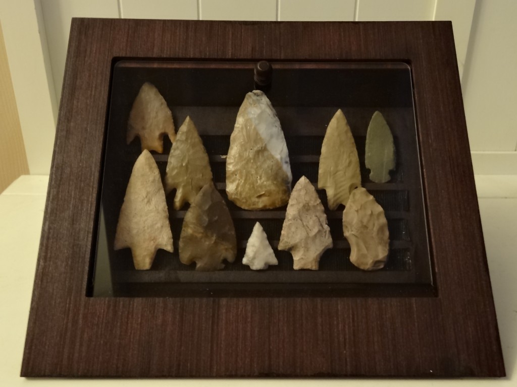

    Here is the Arrow head case project that my Dad and I worked on for Christmas presents.
    These were the gifts we gave out to all the men in the family who are history hunters at heart.
    They were very happy to have them.

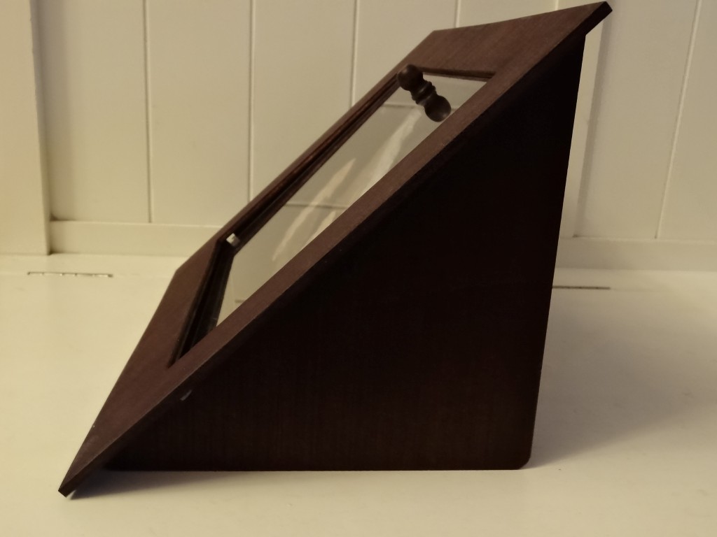

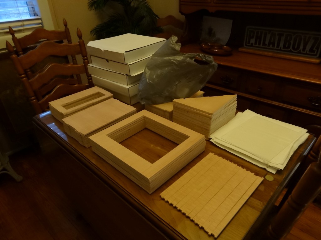

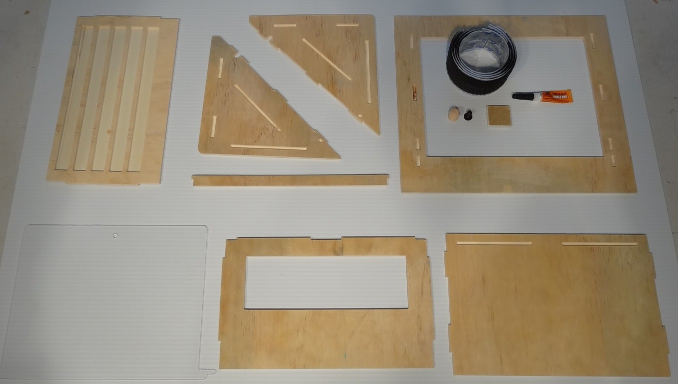

    Cut from 1/4" (.200) Luan using wood glue to hold everything together. There are no tools needed for this build.
    One of my personal favorite parts of this project was that on the final parts (not the foam version) the tabs do not show though the slots. They slots are recessed and not all the way though and the tabs are shorter in length. This gives you a nice finish on the exposed part of the build :good:

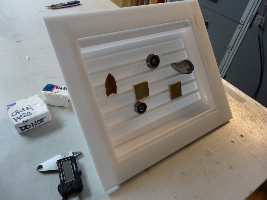

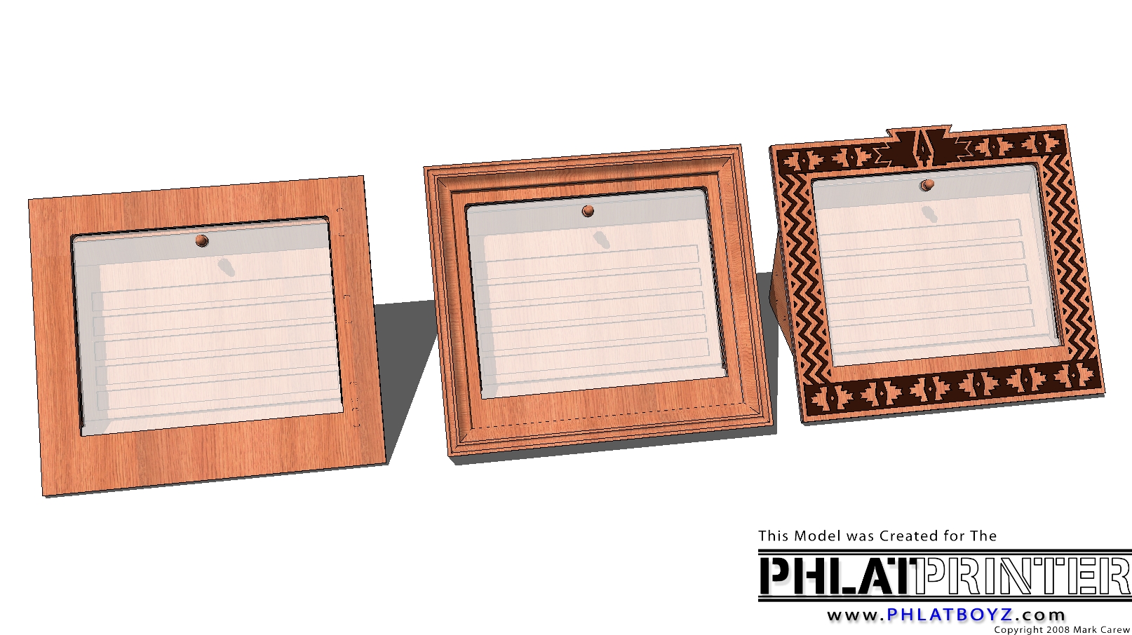

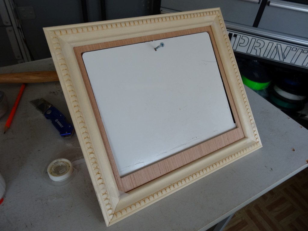

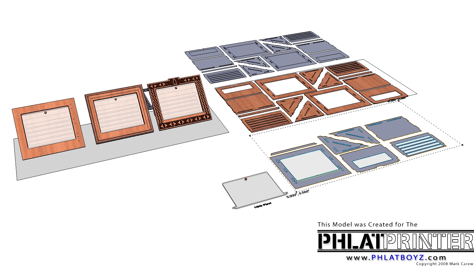

    The code is for the foam prototype version. You will see 3 different ideas for the cases frames that you can experiment with on your own projects.
    Please share pics/files of your builds
    Mark and Trish Attached files ArrowHead Case_4_notabs.skp (2.4 MB)Â [​IMG] [​IMG] [​IMG] [​IMG] [​IMG] [​IMG] [​IMG] [​IMG] [​IMG] [​IMG] [​IMG] [​IMG] [​IMG] [​IMG]

    Very nice Mark! Gives me ideas for making domino holders which is something I've had in the back of my mind for awhile.
  3. 3DMON
    They came out real nice! :good:
  4. TigerPilot
    That is super nice, Mark. I'm going to steal that idea, for sure! :fugly:

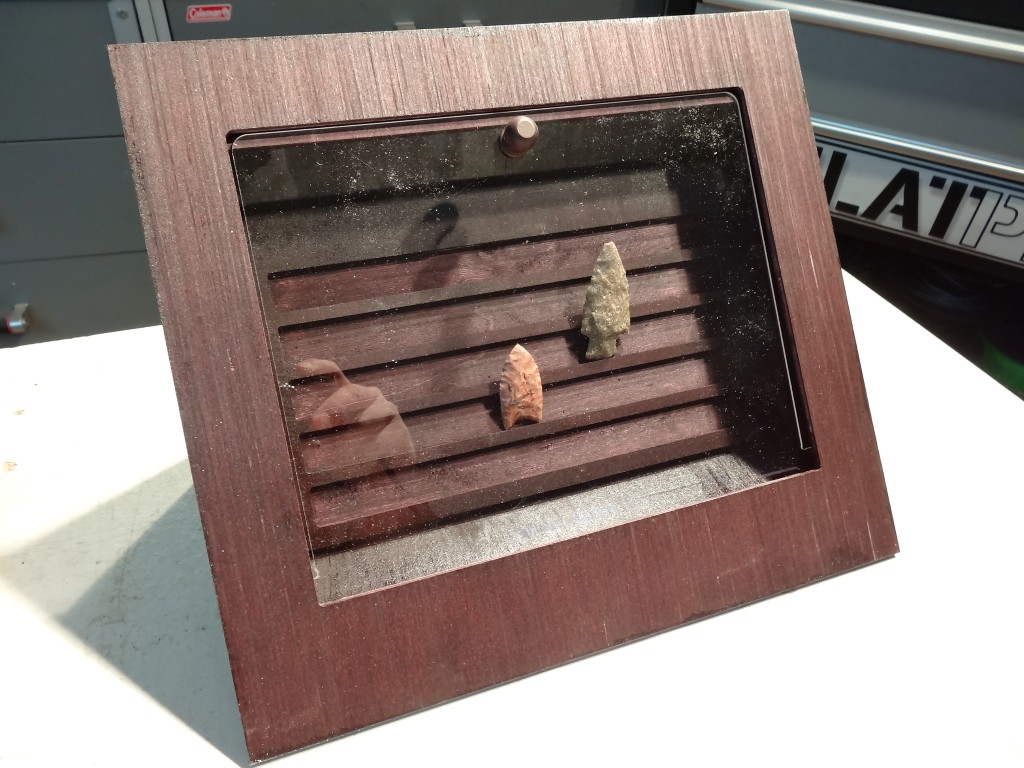

  6. ToxicToast
    Wow! That is beautiful work!
    Thanks Chris, the stain really helps set it off and give it that finished look.
