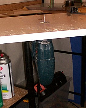

    Jigsaw:
    A fairly good substitute for a ScrollSaw, especially when used for interior/detail cutting or sheet trimming. Much more predictable and variable for plastic cutting than a rotary tool. Use metal smooth-cut (24tpi) blades for most cutting. For smaller cuts or low heat tolerance materials scroll-cut wood blades (10tpi upcut/downcut) are recommended. Mine is setup upside-down and attached to a shelfboard to allow me to cut sheets without having to back them with plywood (which I recommend for normal jigsaw operation but can be difficult to setup safely).DrillPress: Far more controllable and precise than a hand power drill. Will allow you to use spade bits for larger holes as well as help you control your downforce.

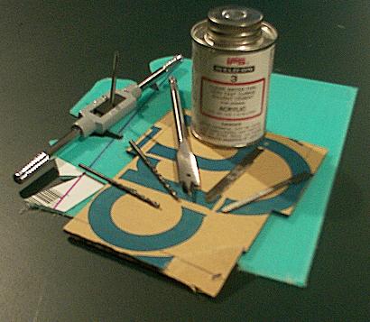

    Drill Bit Set:
    for holes smaller than 1/4" any drill bit set seems to work fine. But for larger hole diameters a plastic specific set or a good variety of spade bits is essential. I prefer using spade bits over hole saws or larger drill bits if I'm working with plastics (except for ABS and polypropylene which get "gummy" when spade bits are used).

    Needle Files: A triangular needle file works best for flat surfaces and a round one is great for curves. Bot are used for cleaning the edges of sheet after initial cutting, and before sanding them to a finished edge.
    X-acto knifes: These can be use to carve softer plastics or use the dull side to deburr cut edges of plastic sheets. A good variety of blade shapes and lengths is recommended.
    Deburring Tool: This is a thick handles pen looking too with a curved swivel blade on the end. It's made solely for deburring the edges of cut holes and can make quick work of cleaning up rounded edges and drilled holes. They can be difficult to find because they are machining tools and not woodworking tools so don't expect to find these are Home Depot or Lowe's. Mcmaster.com or Sears are the best places to look.

    IPS Weld-on #3 or #4:
    This is an extremely useful and effective plastic solvent that fuses ABS, Polycarbonate, and Acrylic together (in any pure combination of the three). Simple brush onto or apply to contact area with syringe then secure pieces together in the final form you want. #3 formula is slightly thicker and faster setting, while #4 is water-thin and sets more securely. #4 is recommended for anything you are trying to make air-tight because it's thin enough to use capillary action to fill all of the gaps between the sheets you are joining together. In order to join sheet edges securely and tightly make sure they are sanded to atleast 400grit level and are straight enough to make a scure bond. You do not have to apply any contact pressure to get a good chemical bond. Over application will lead to ugly, but working joints. Can be applied an reapplied as needed without complications.
    It's a good idea to use this in a ventilated area, and while it will not adhere your skin to plastic it WILL create permanent fingerprints. This is a mildly toxic substances so excessive skin contact is not a good idea.
    It with also work with butyrates and styrenes, but I have not tested it on polypropylene or polyethylene yet so you'll need to ask a plastics shop about compatability. I do know that it is completely incompatible with all PVC plastic blends so avoid buying ABS/PVC (Kydex T). ABS/PVC is a crappy plastic anyways. If you need a specific solvent for a material, check out the wide range of products available from IPS: http://www.ipscorp.com
    Both #3 and #4 (and a whole host of other plastic adhesives) are available from McMaster (page 3229).
    To apply Weld-on accurately and safely I recommend using 3ml luer-lock syringes with flexible PTFE tubing "needles".
    These can be purchased from medical supply, or through industrial supply catalogs such as McMaster (part #s 7510A651 & 75175A691)
