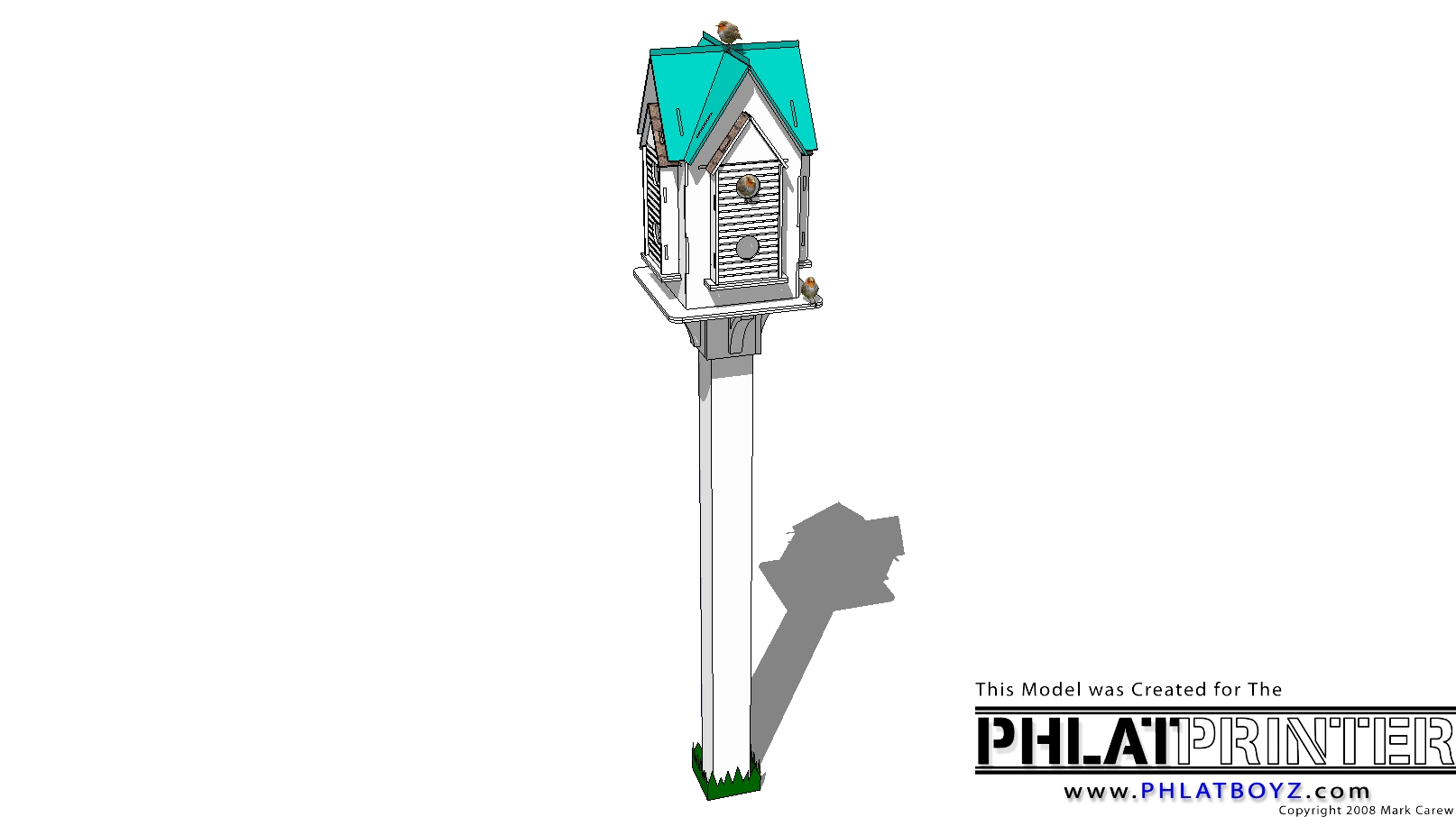

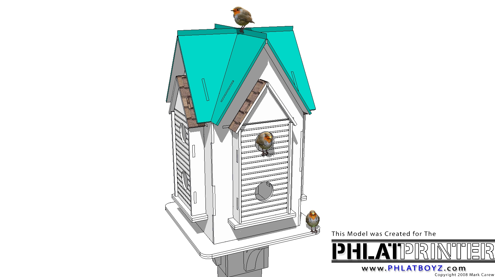

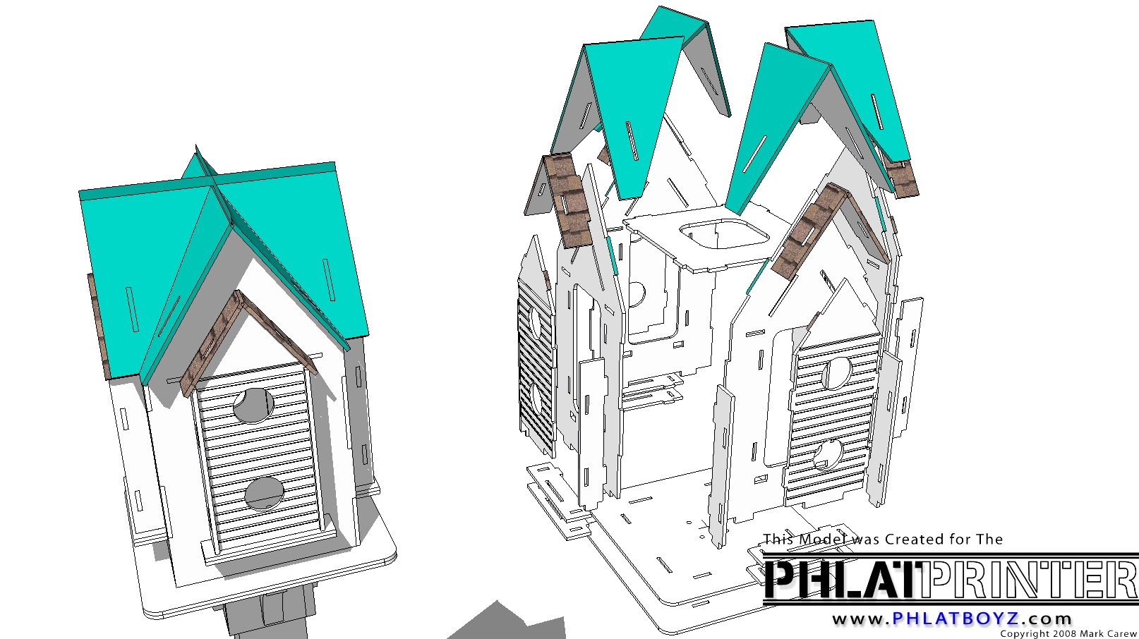

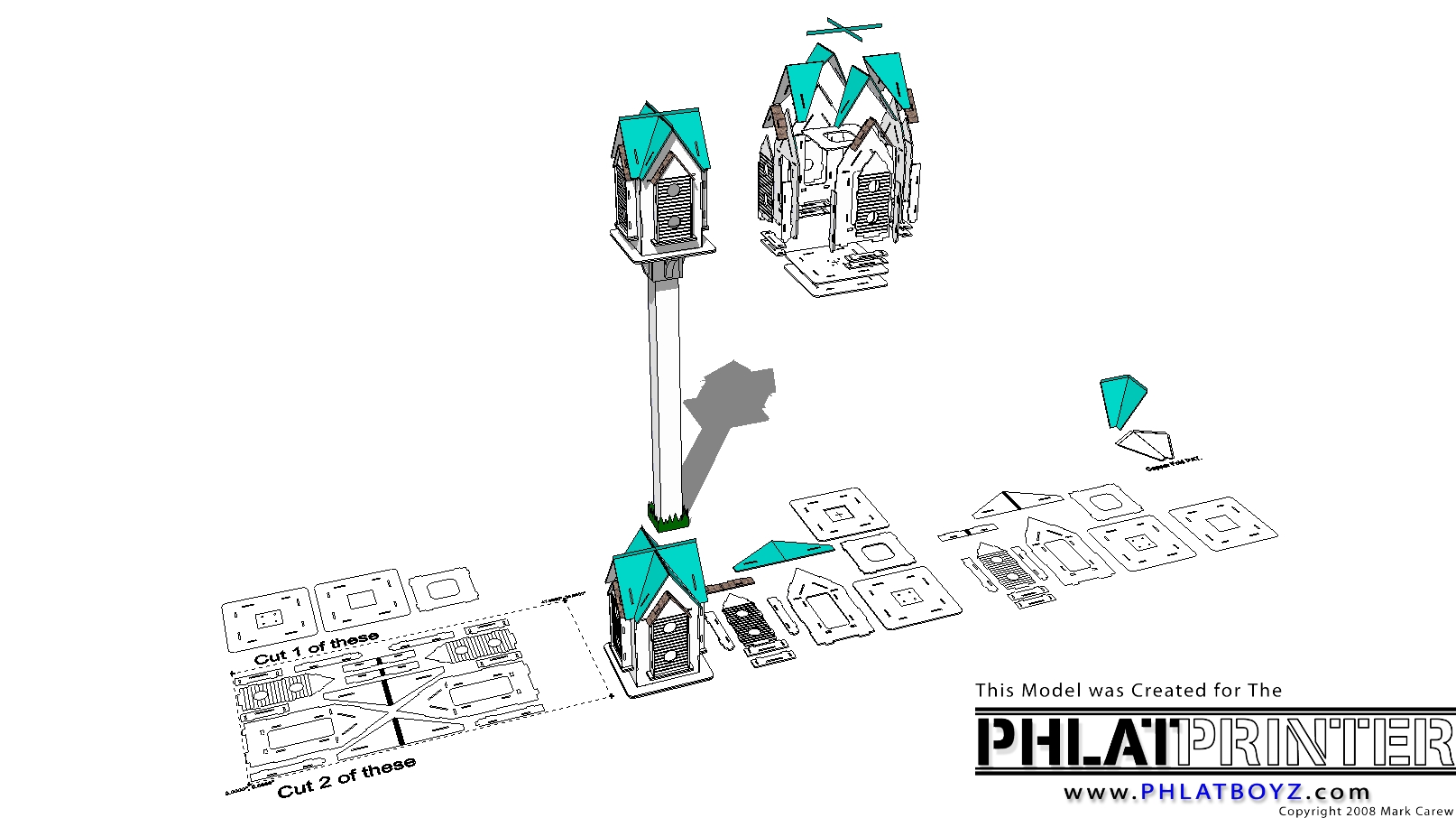

    Here is a bird house design we are working on for my sisters for a Christmas present this year.
    This is cut from 1/4" (.200) Luan using copper rolled sheets for the roof.
    We will be using wood glue to hold it all together and painting all the parts white. The lower (smaller) roofs are going to have cedar shake nailed to them. We will also use finish nails in other spots that may need it.
    The base that wraps the 4x4 post will be cut from 1/2 pine and painted white and the 4 small corbels will be bought from the hardware store and these things will be added after the birdhouse is mounted in place.
    Enjoy
    p.s. I have not cut this out yet, but will post pics when we do :) Attached files [​IMG] BirdHouse.skp (2.5 MB)Â [​IMG] [​IMG] BirdHouse_1.cnc (64.2 KB)Â BirdHouse_2.cnc (22.8 KB)Â [​IMG] CUT1_BirdHouse.dxf (177.4 KB)Â CUT2_BirdHouse.dxf (566 KB)Â

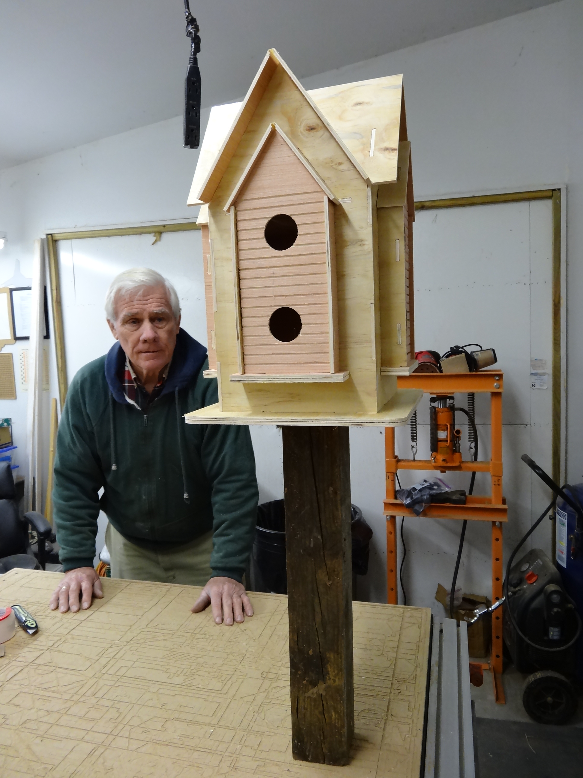

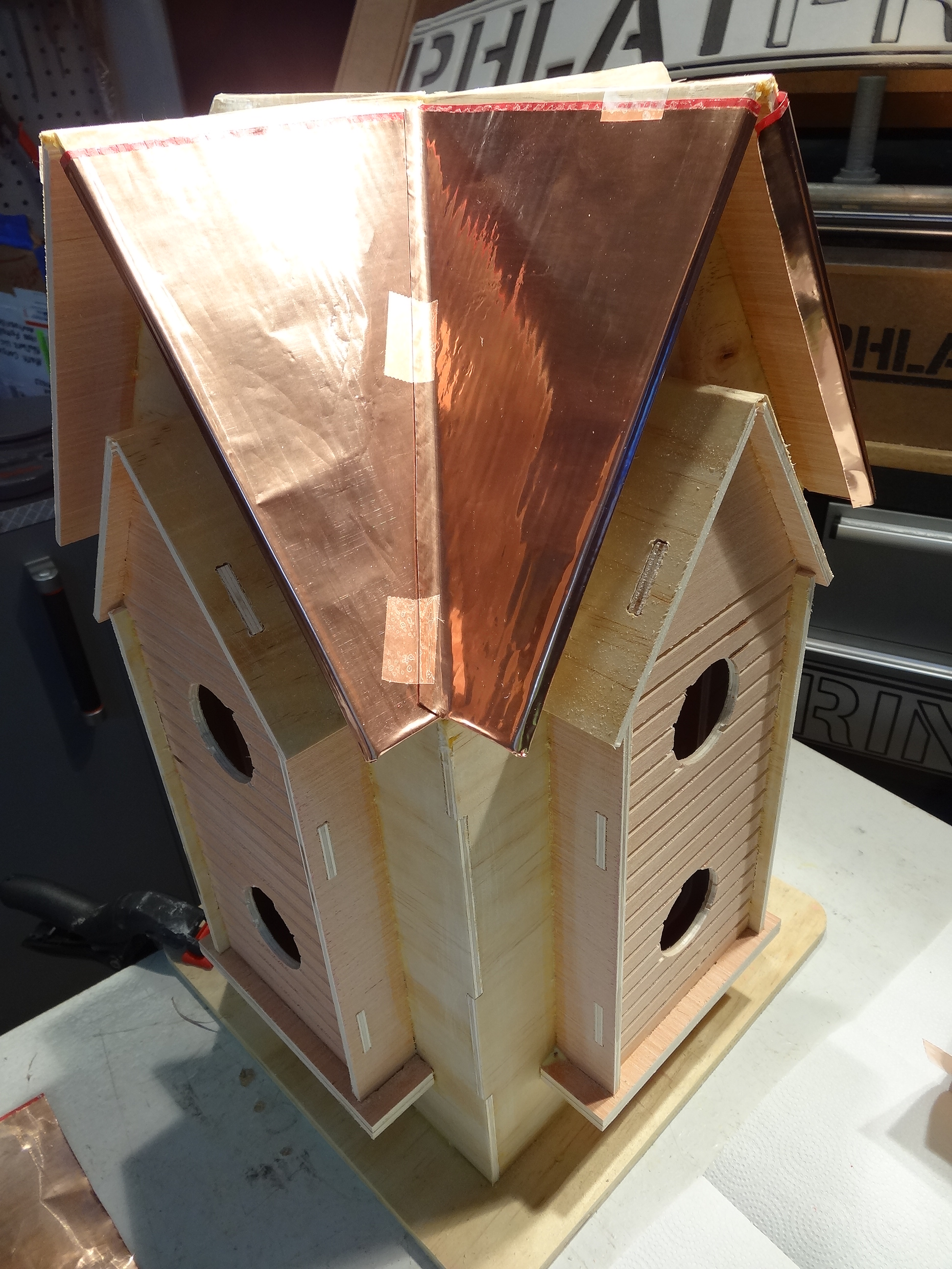

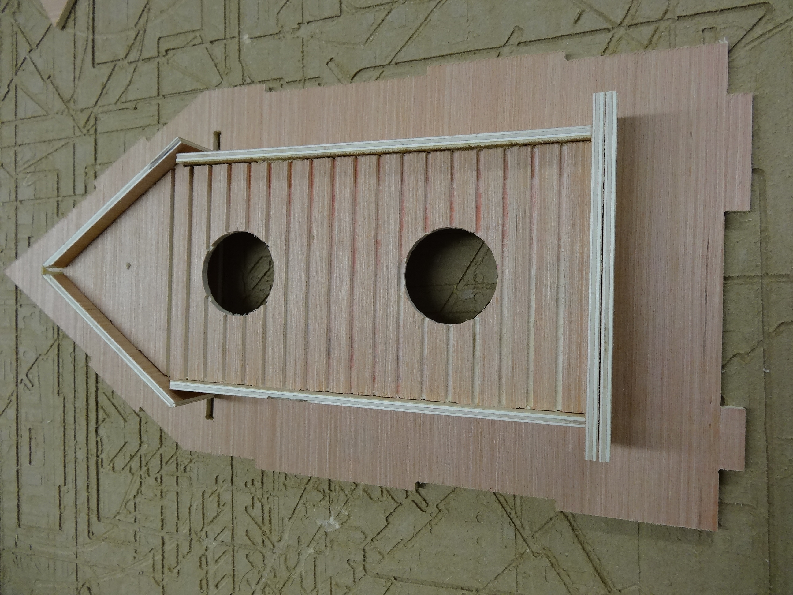

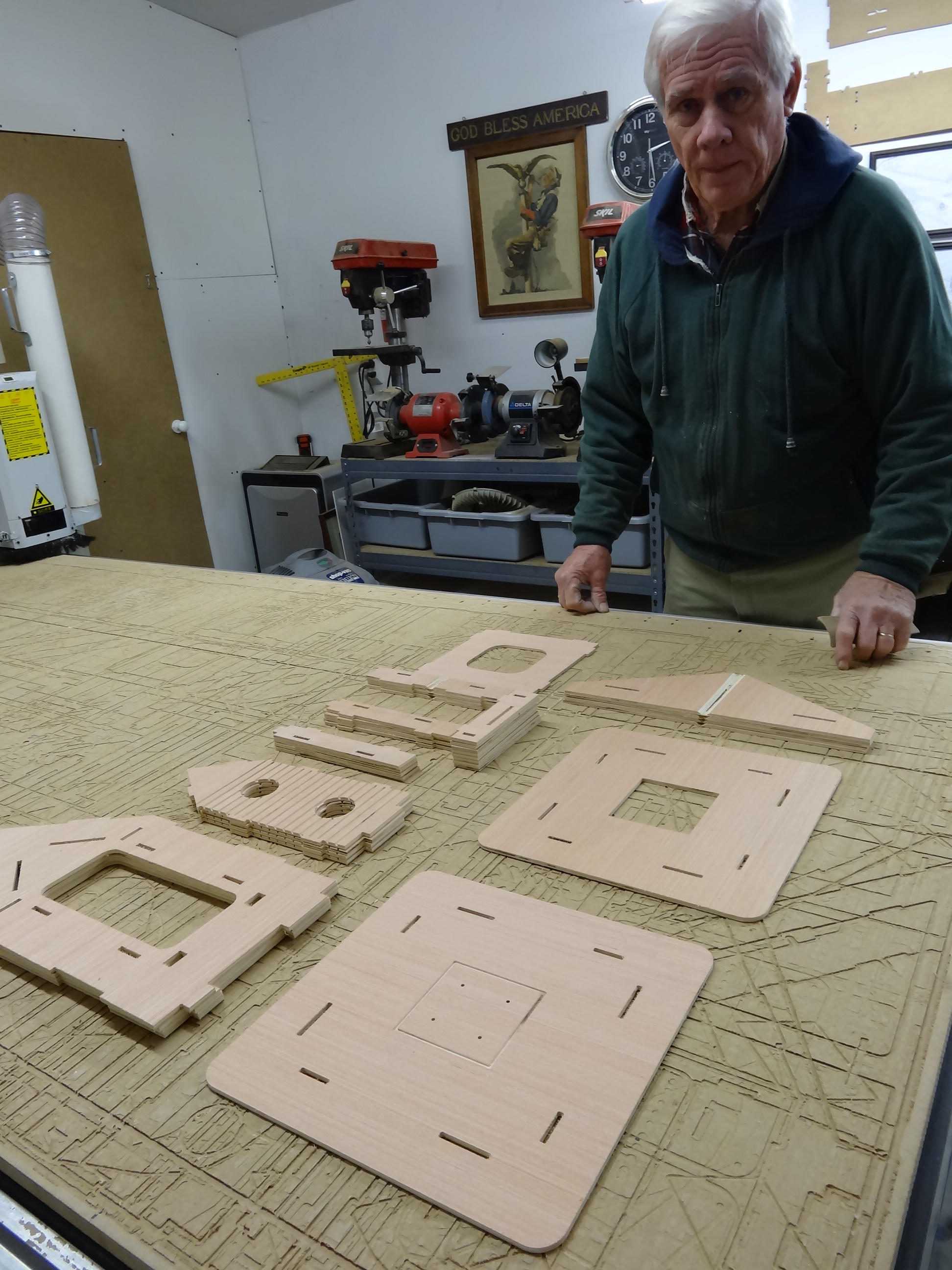

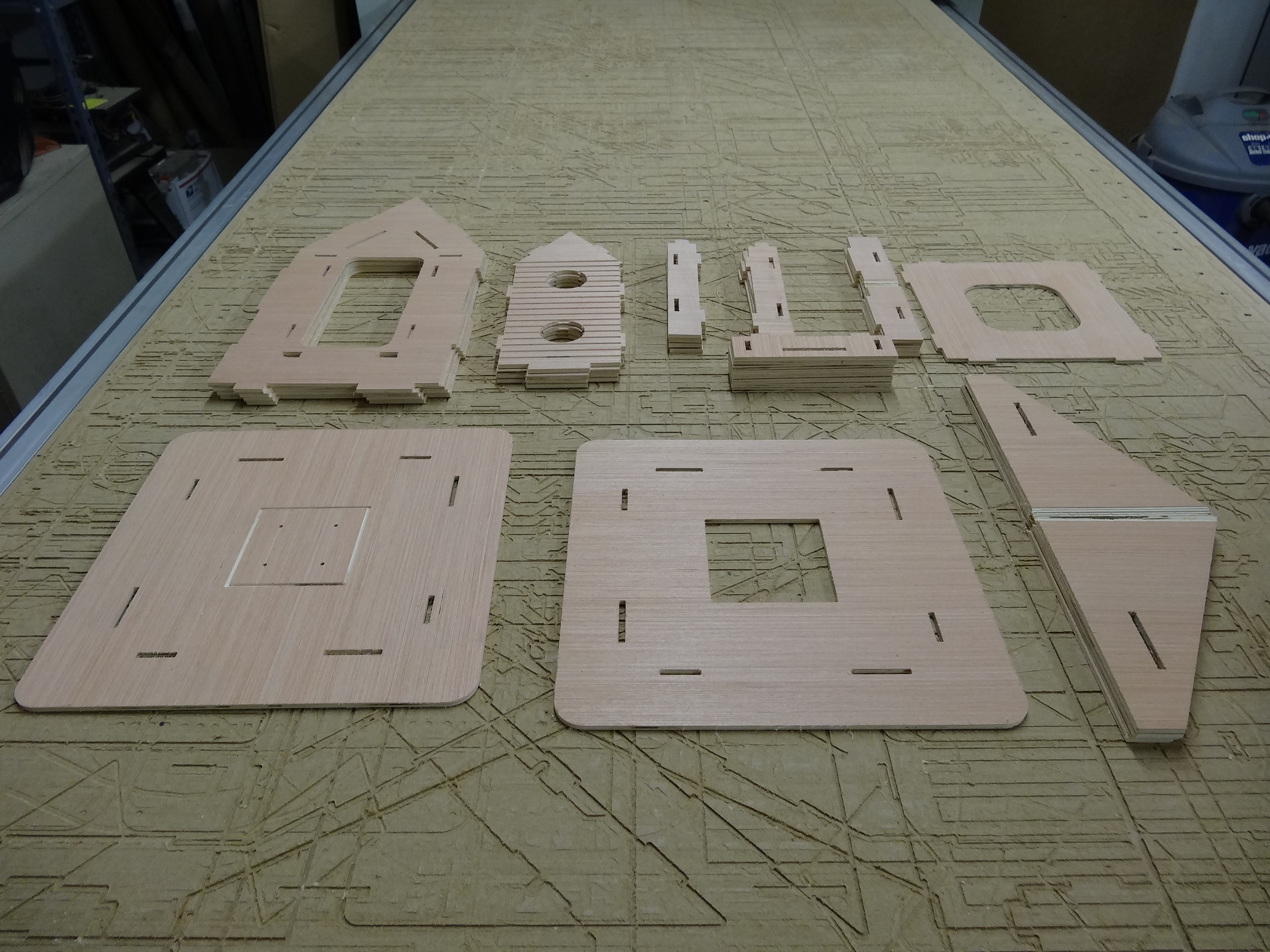

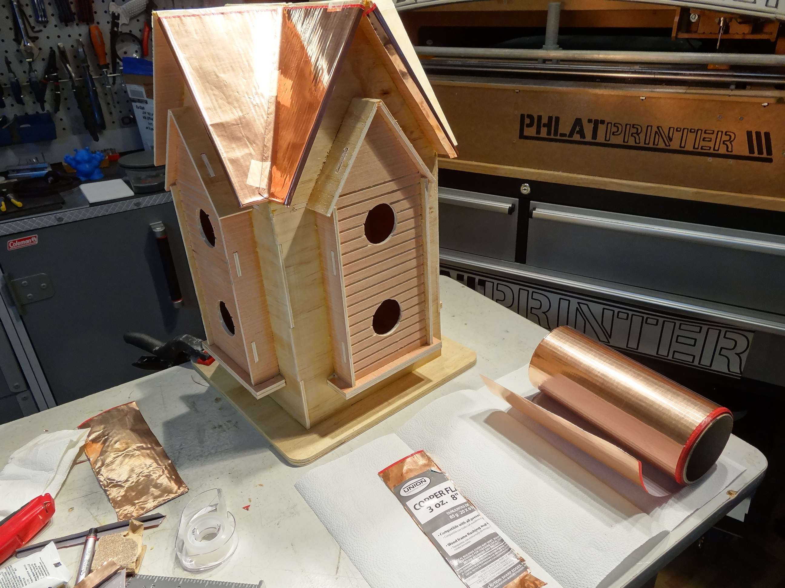

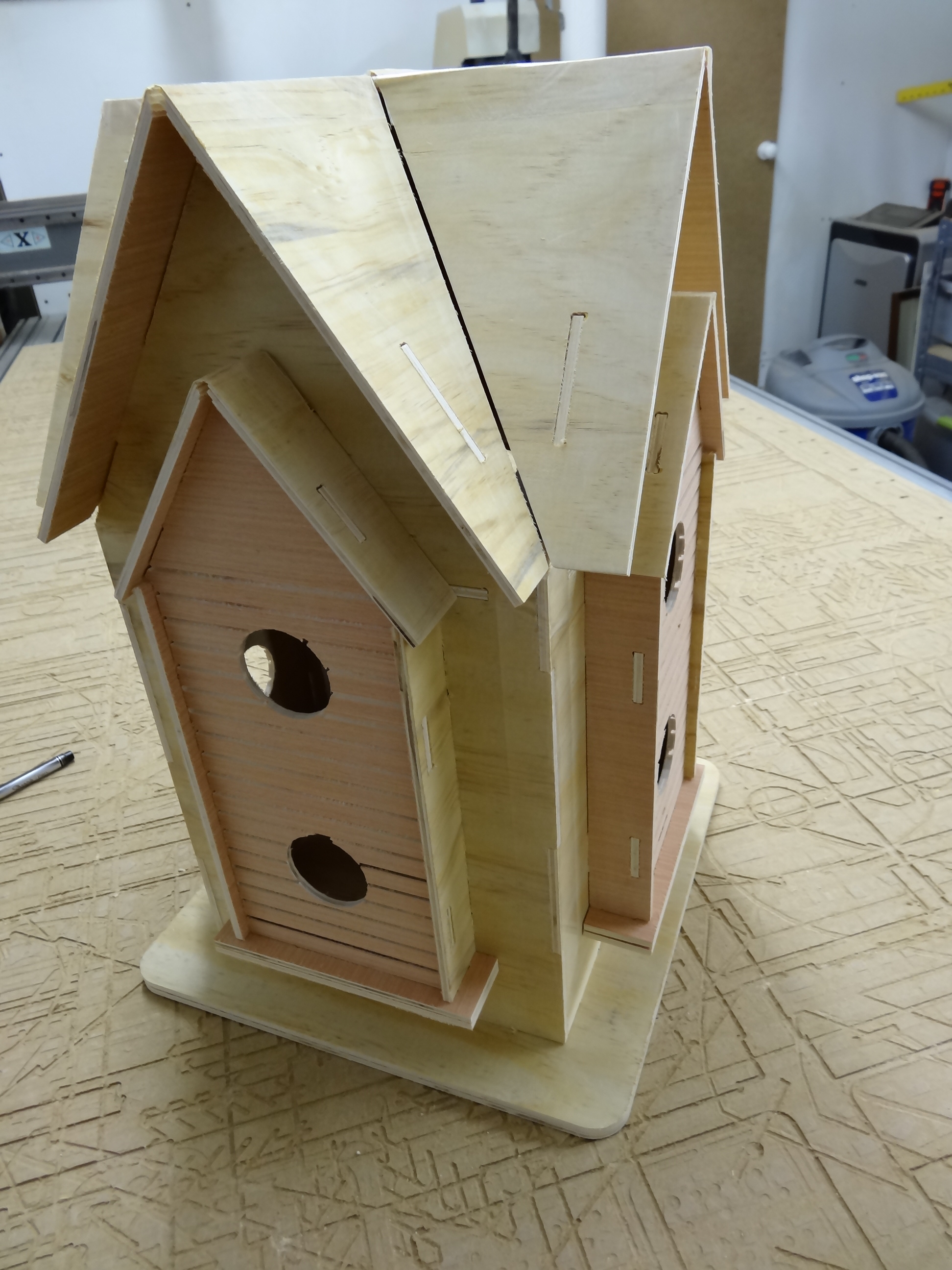

    Hey guyz,

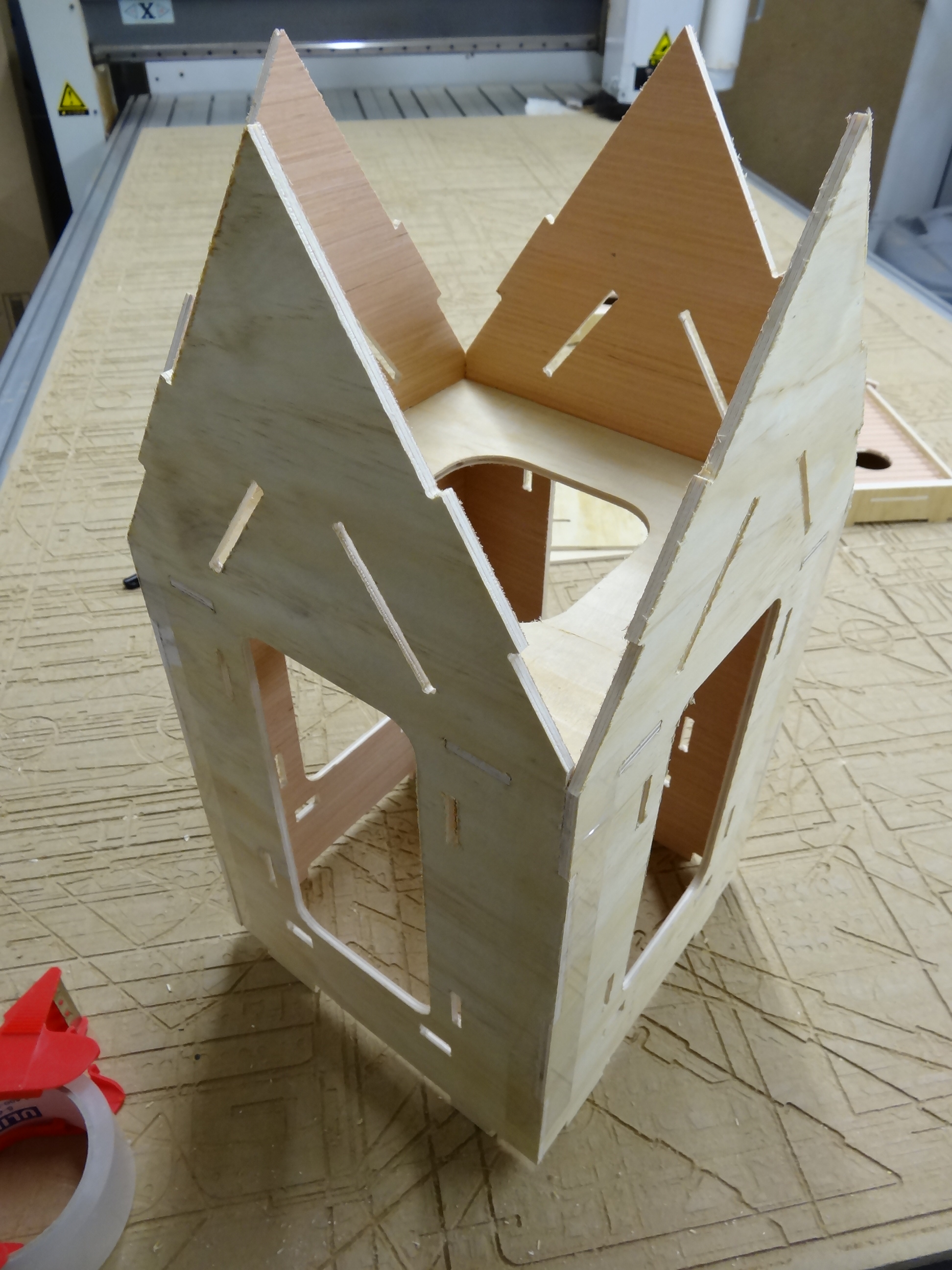

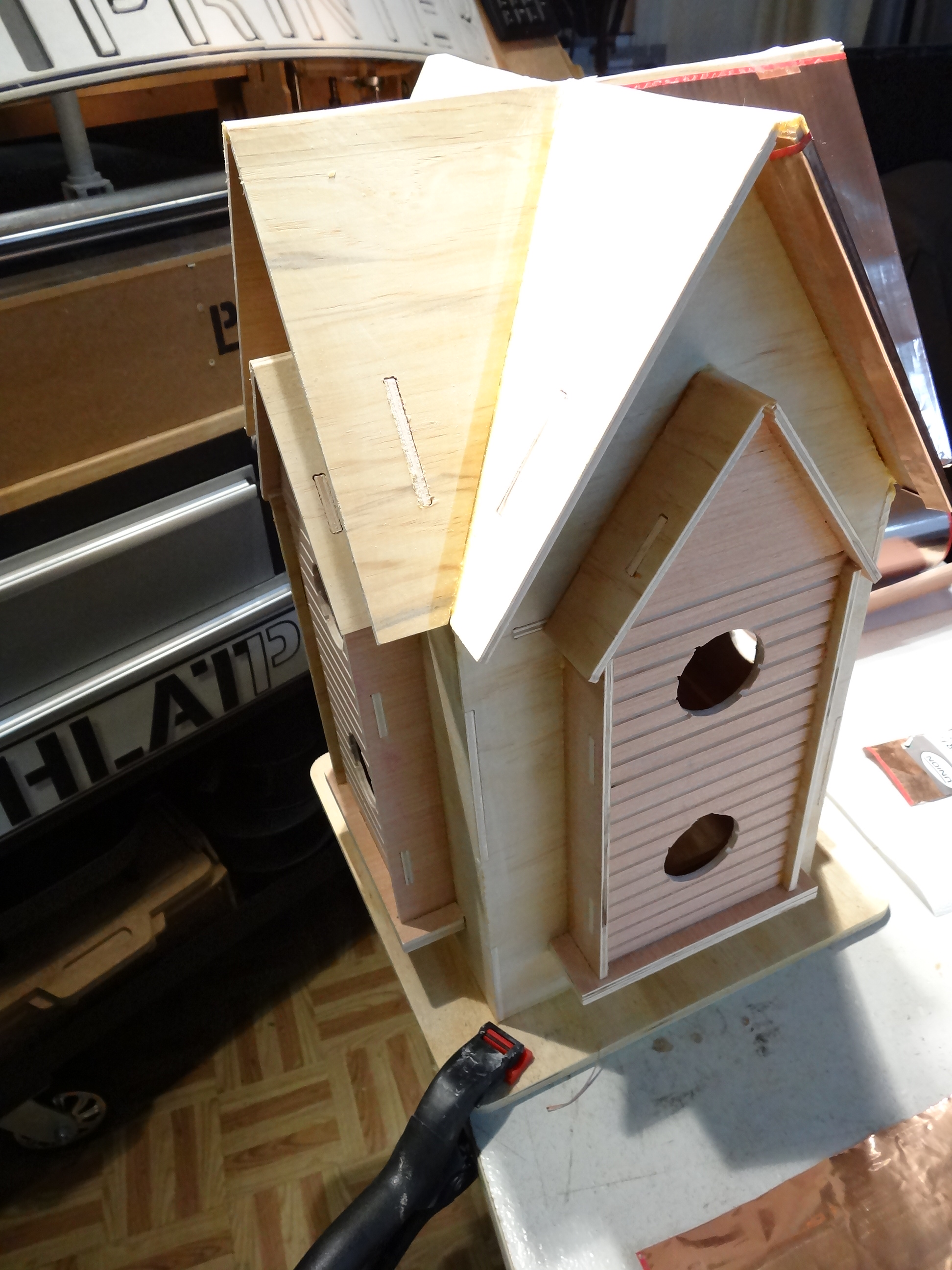

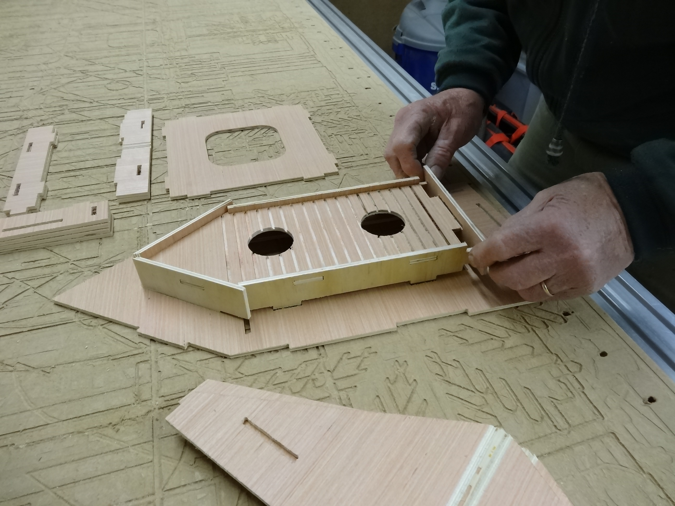

    Dad and I got some progress on the Birdhouse today :good:

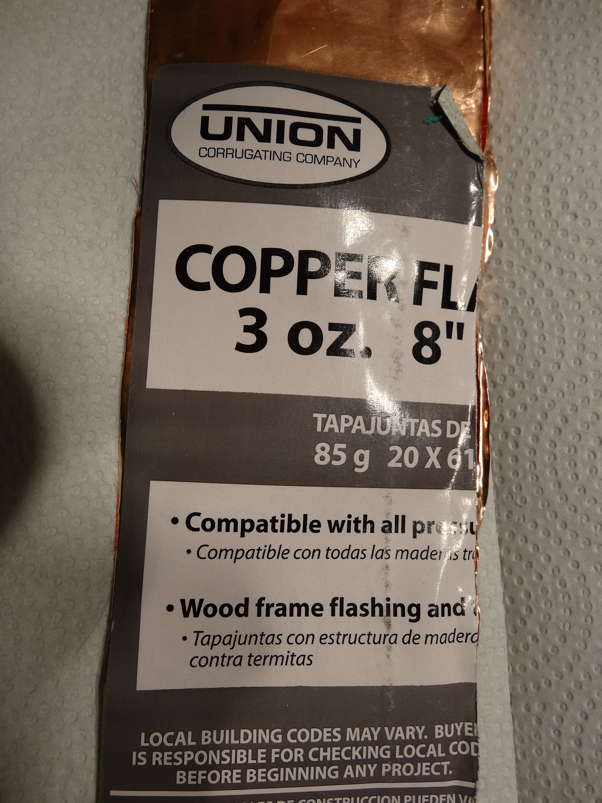

    We could not find the copper sheets but we did find copper flashing so we are making do with what we have :)
    Mark and Trish Attached files [​IMG] [​IMG] [​IMG] [​IMG] [​IMG] [​IMG] [​IMG] [​IMG] [​IMG] [​IMG] [​IMG]

  7. TigerPilot
    1,578
    Mark, the leftover copper flashing would be good to make a squirrel/rats skirt. Without it the condo will be raided :D

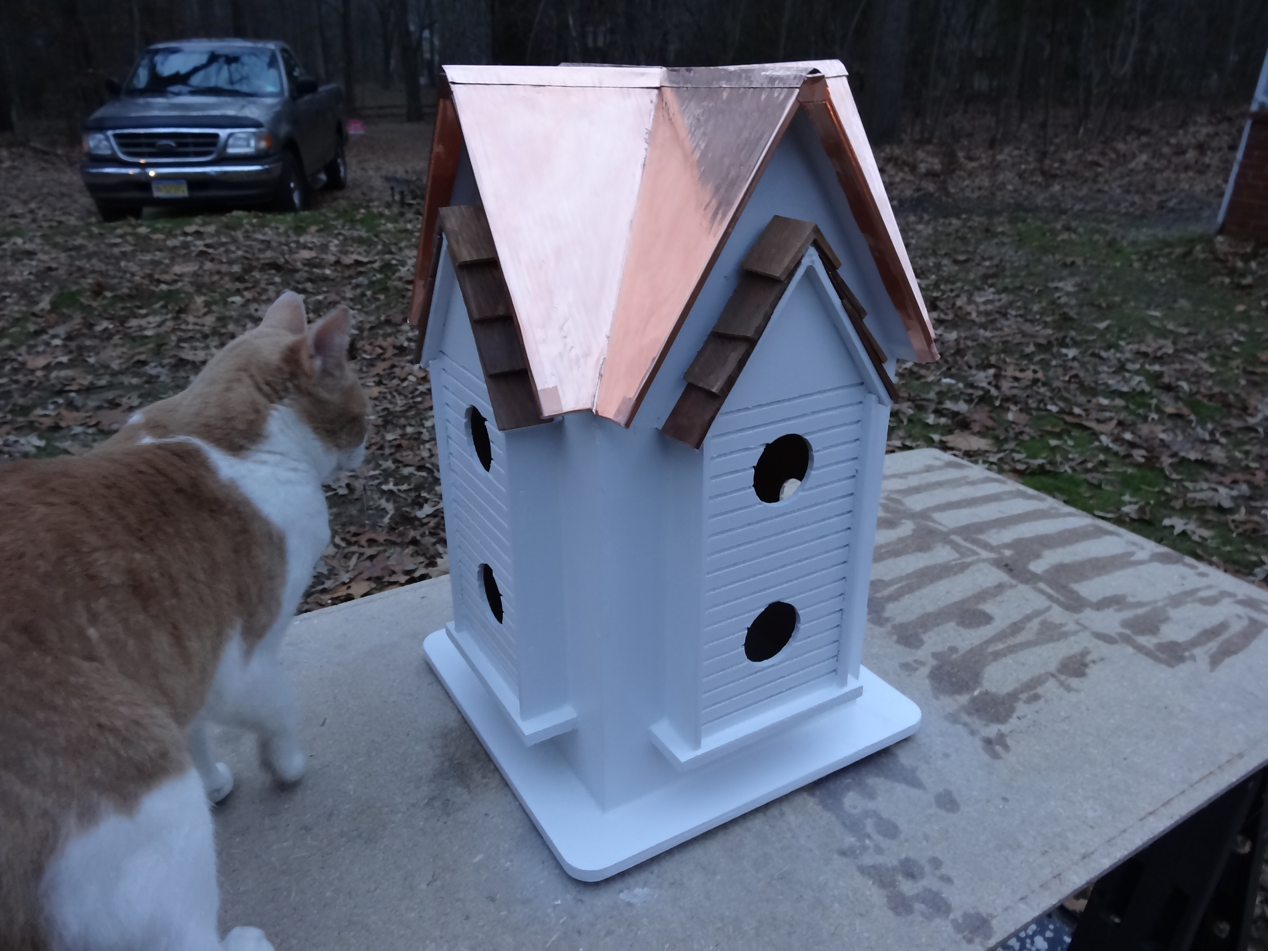

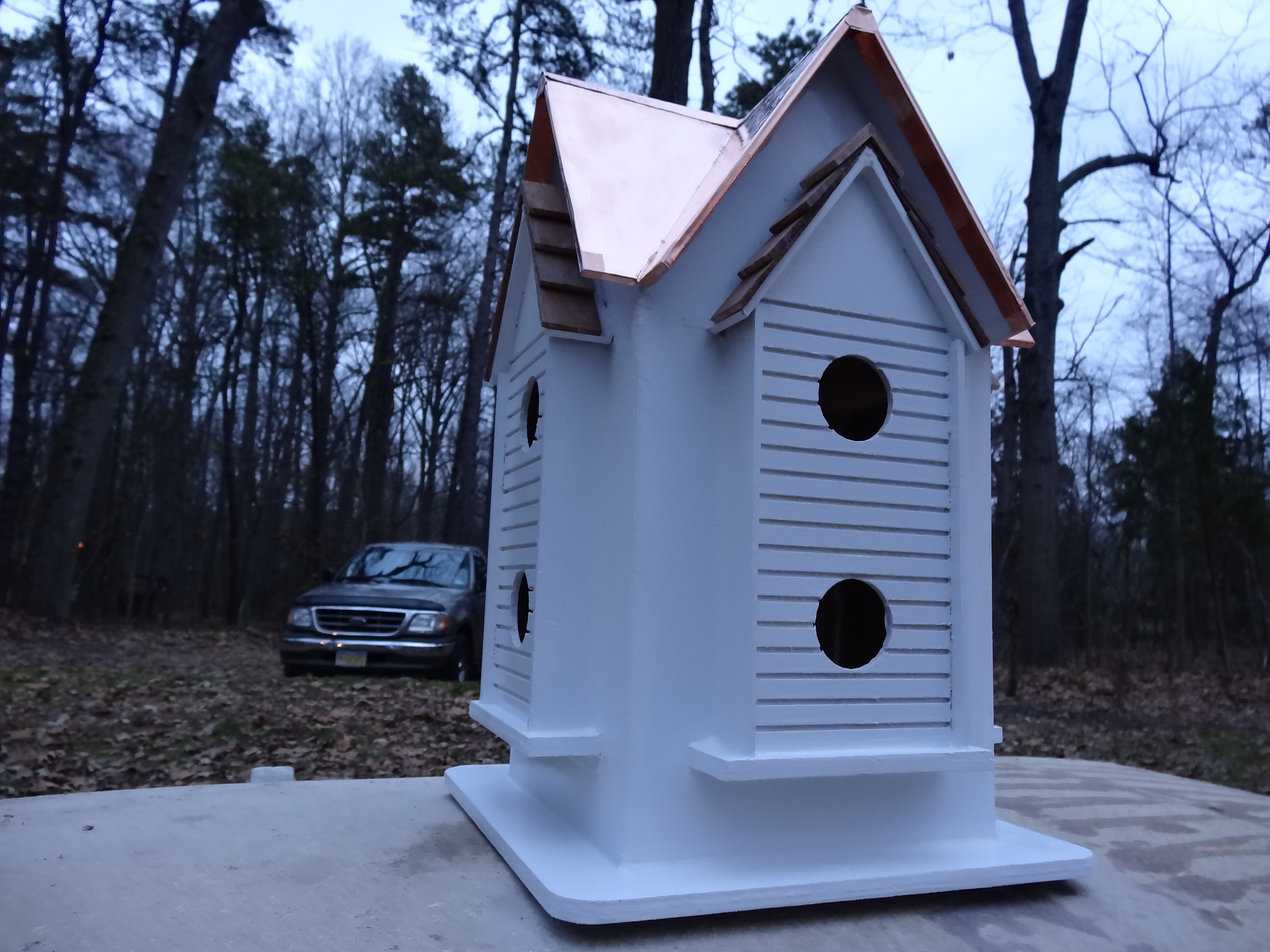

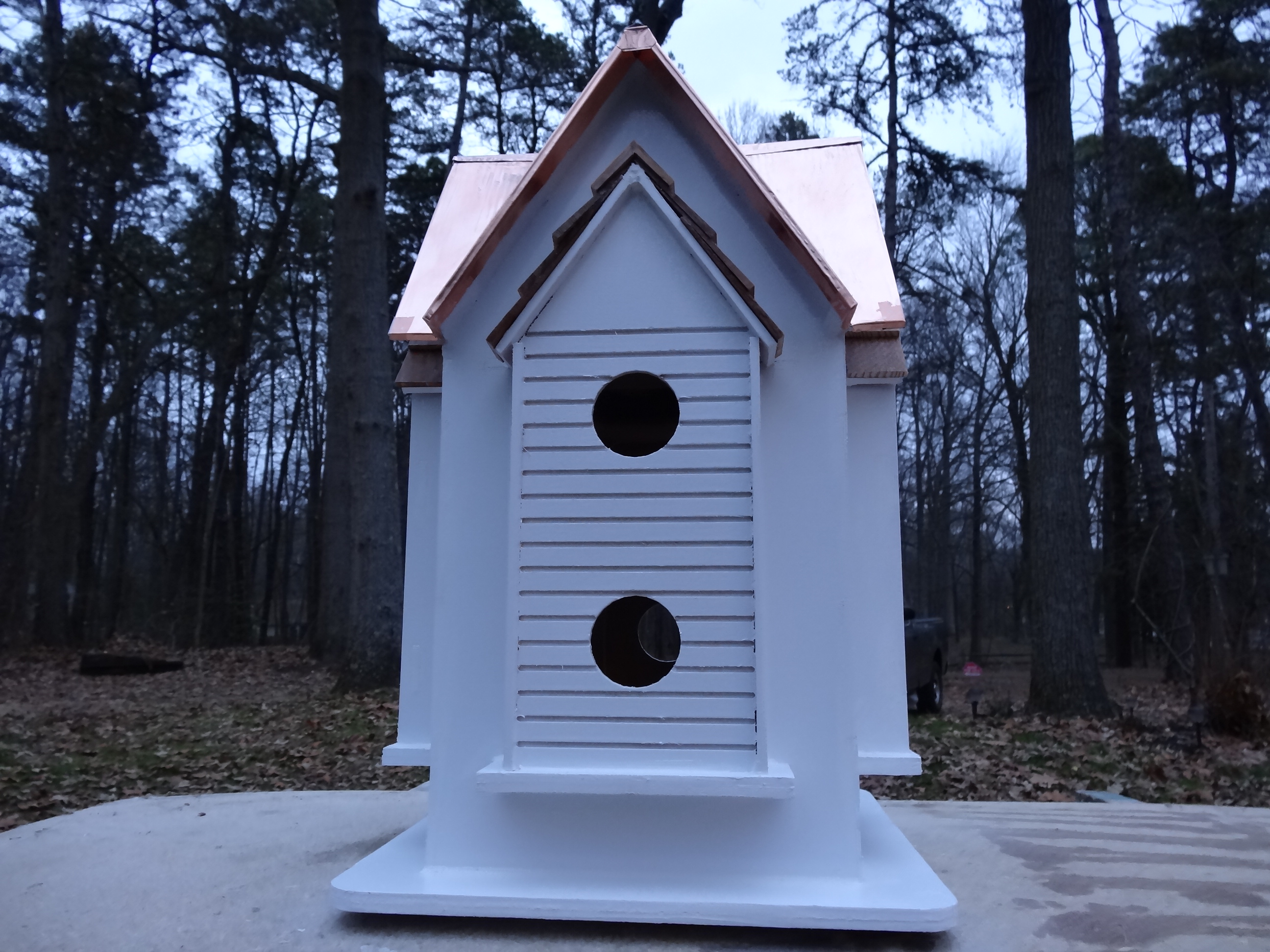

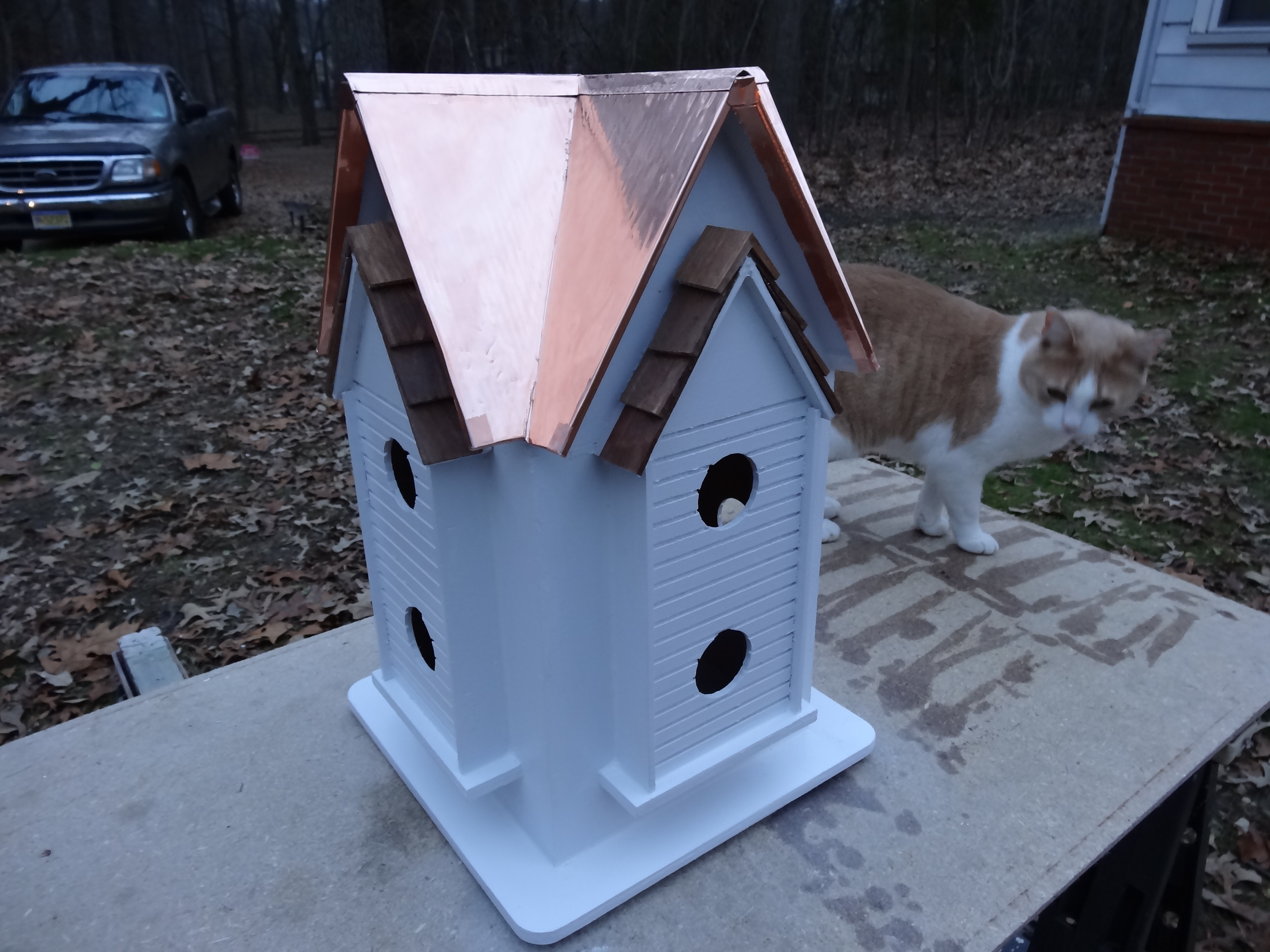

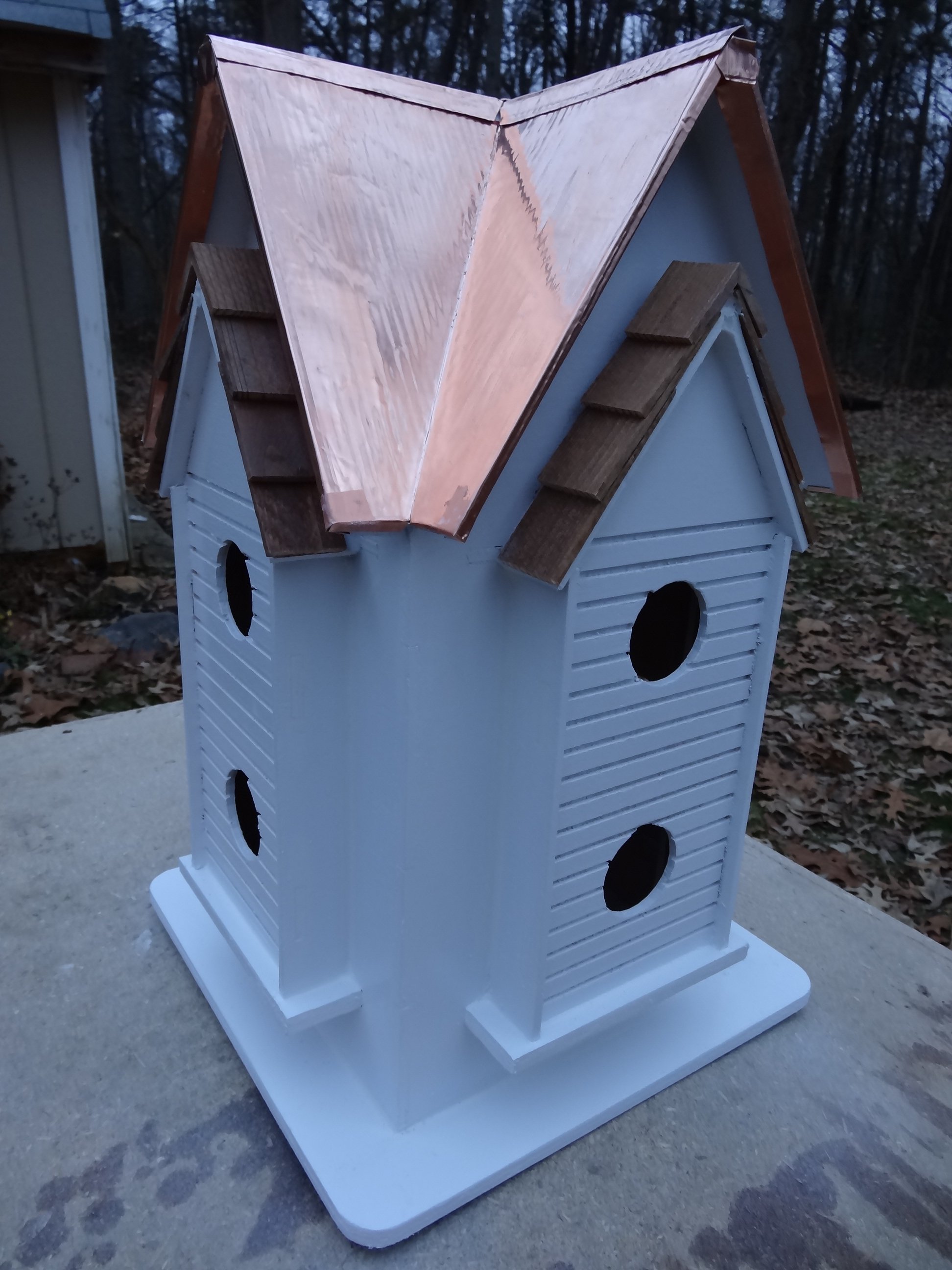

  13. kram242
    Hey guyz,
    Almost complete! :doubleup: A few more touch-ups here and there but for the most part done :)
    For the lower roofs we used Nelson shims from Lowes
    [​IMG]
    http://www.lowes.com/pd_3969-57404-PSH8 ... nt=Default
    We stained them with cheery minwax stain and it looks a lot like cedar. We also cut these down to get the proper scale look.
    It will take two packs and the cut offs were used for the peak caps.
    The copper flashing was not nice to work with as everything left a ding or scratch and it had no real stiffness to it. If I had to do it over I would look for copper sheets in place of the flashing. I think it would be much easier to work with.
    We used two coats of white (spray can) primer and then two coats of gloss white spray as well. We caulked any seams and holes using a dab of water on the finger to smooth out the caulk.
    [​IMG]
    http://www.lowes.com/pd_221668-69-DM461 ... facetInfo=
    We then went back with one more quick coat of the gloss white to blend the caulk in.
    Over all have to say a very cool project! I got a chance to work alongside my Dad and as a plus this birdhouse condo is sure to make one of the Sisters happy :good:

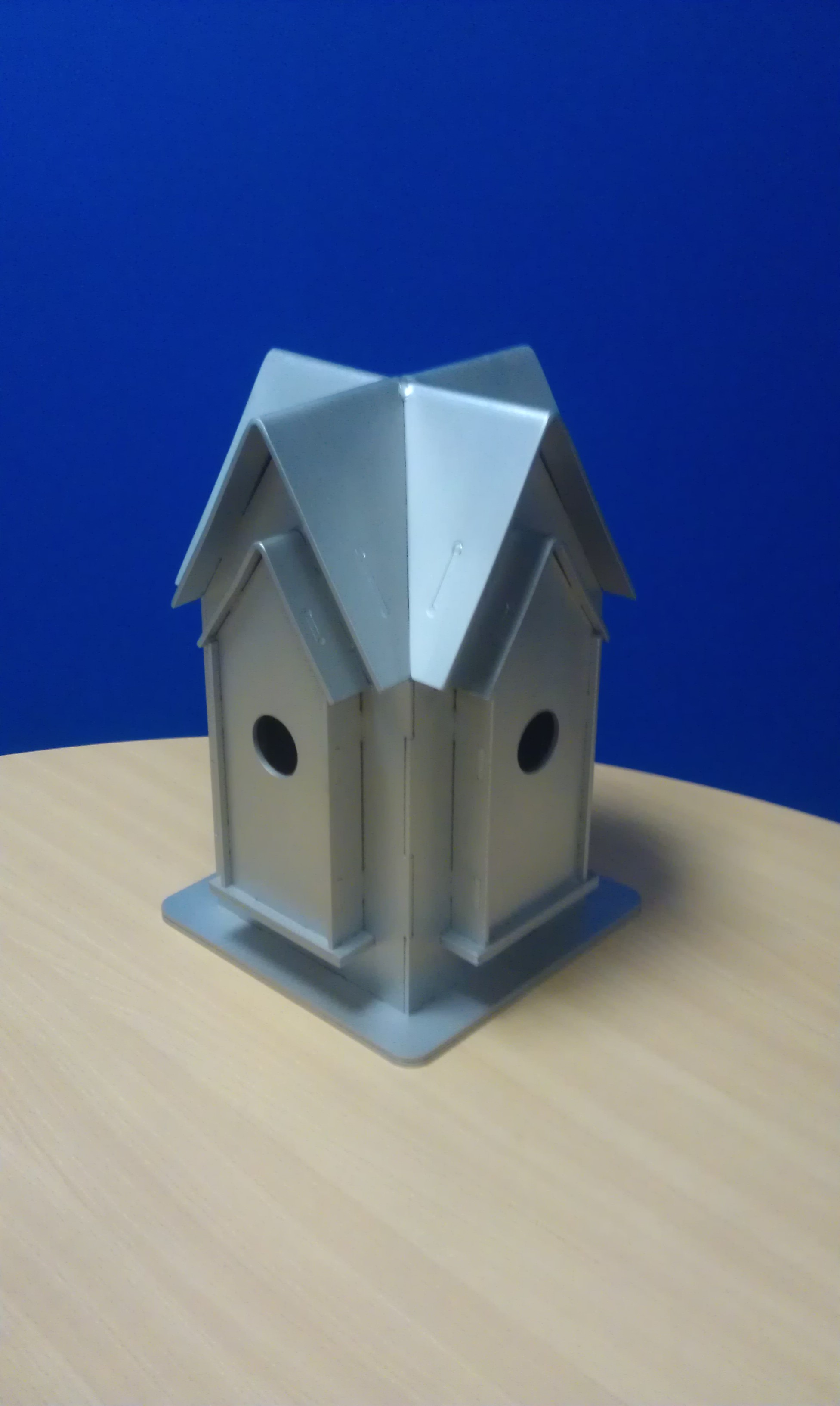

    Cheers. Attached files [​IMG]
