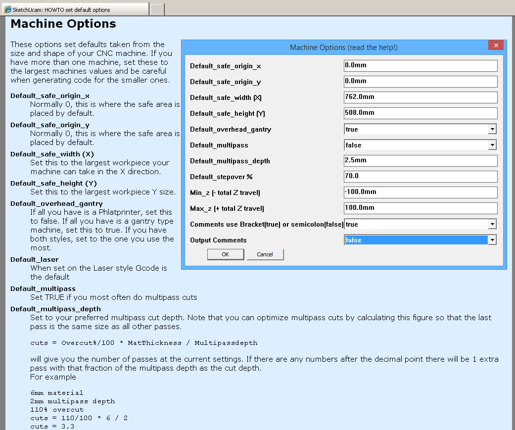

    Also, you can change the defaults that will be used for new drawings by using the dialog at
    Tools|PhlatBoys|Options|MachineOptions
    Hit the big blue question mark in the toolbar, then in the right hand side menu click 'Machine Options' under the 'Change default options' section and you will see this:
