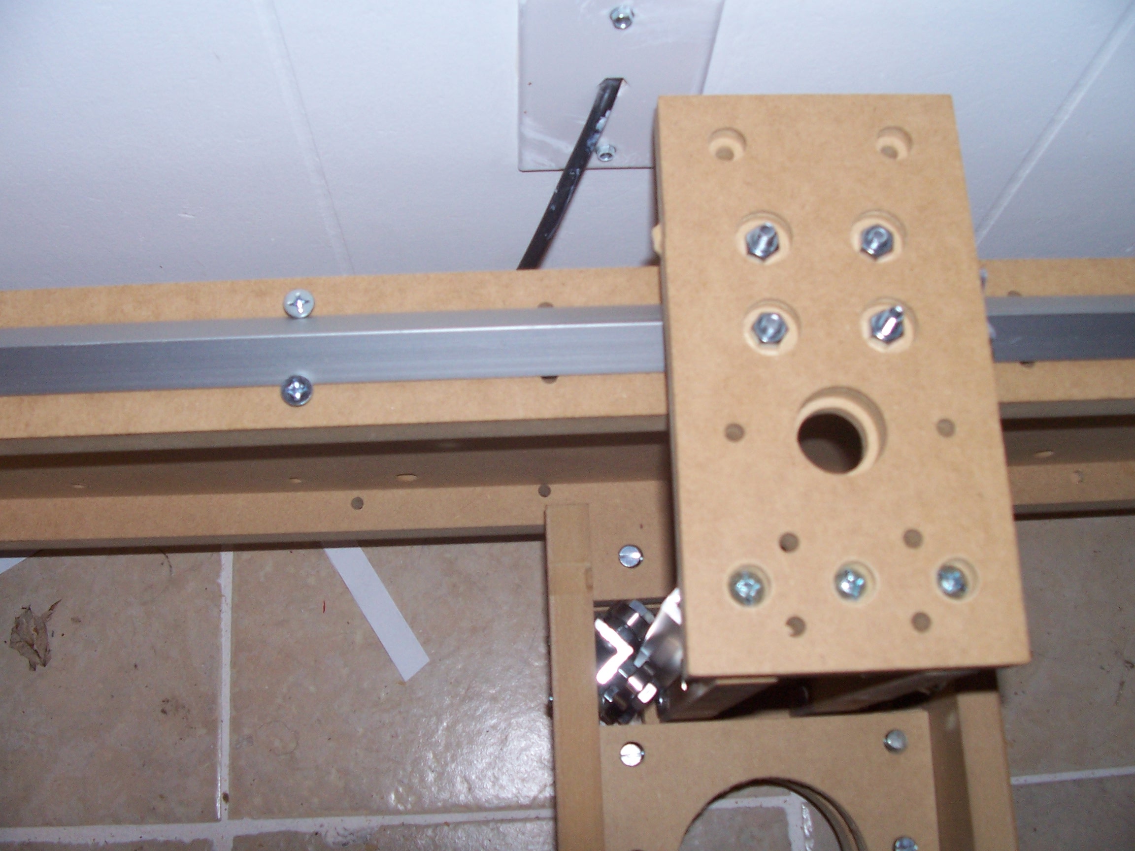

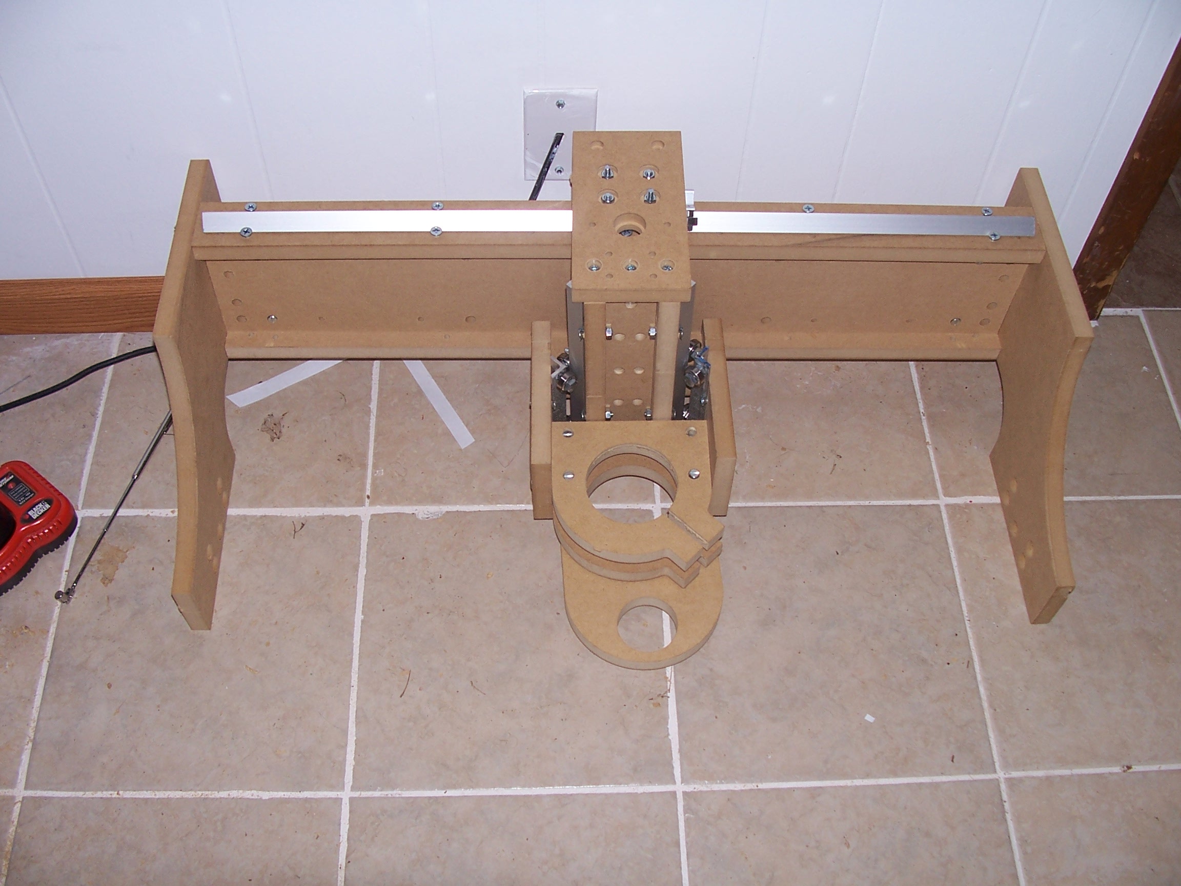

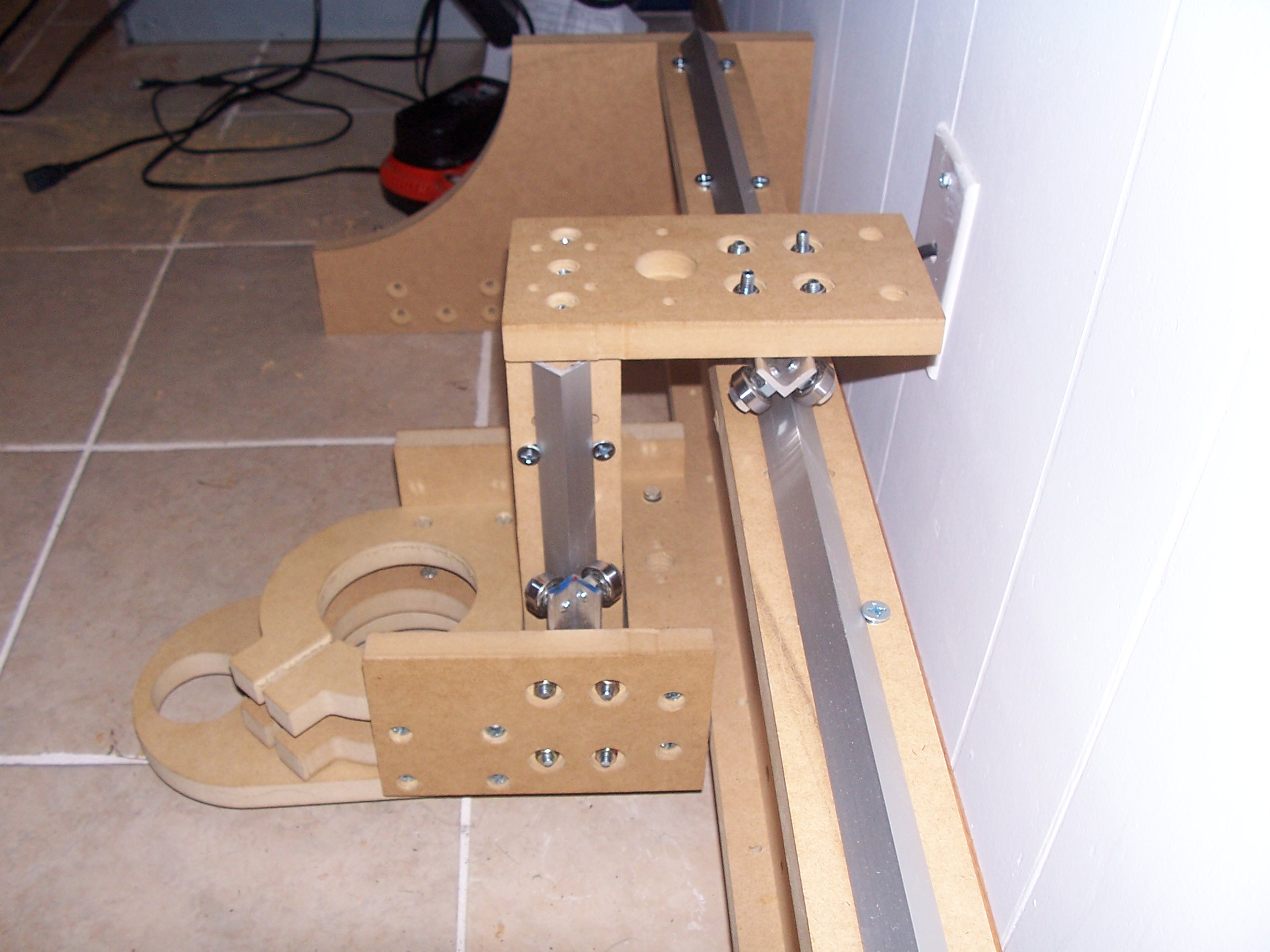

    Ok, I started building my 2x4 Flatbed CNC Router this evening. I have completed the Z axis, except for the alum. channel rails that I am waiting for.
    Here are some pics Attached files [​IMG] [​IMG] [​IMG]
    Nice Crash5050!
    Looking forward to seeing the build as it progresses.

    are you building the the buildyourcnc v.1.3

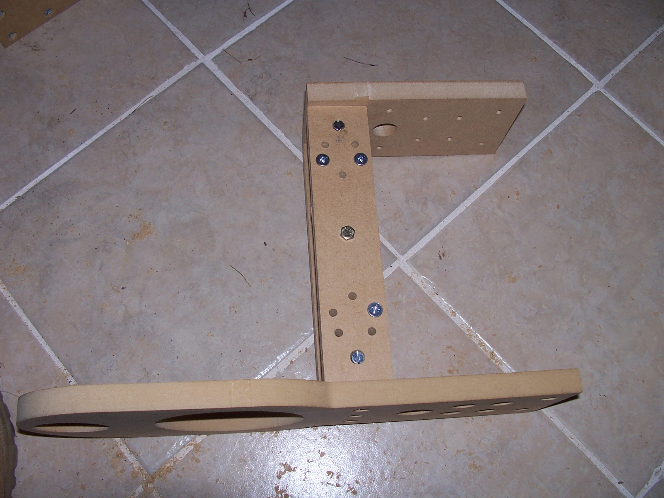

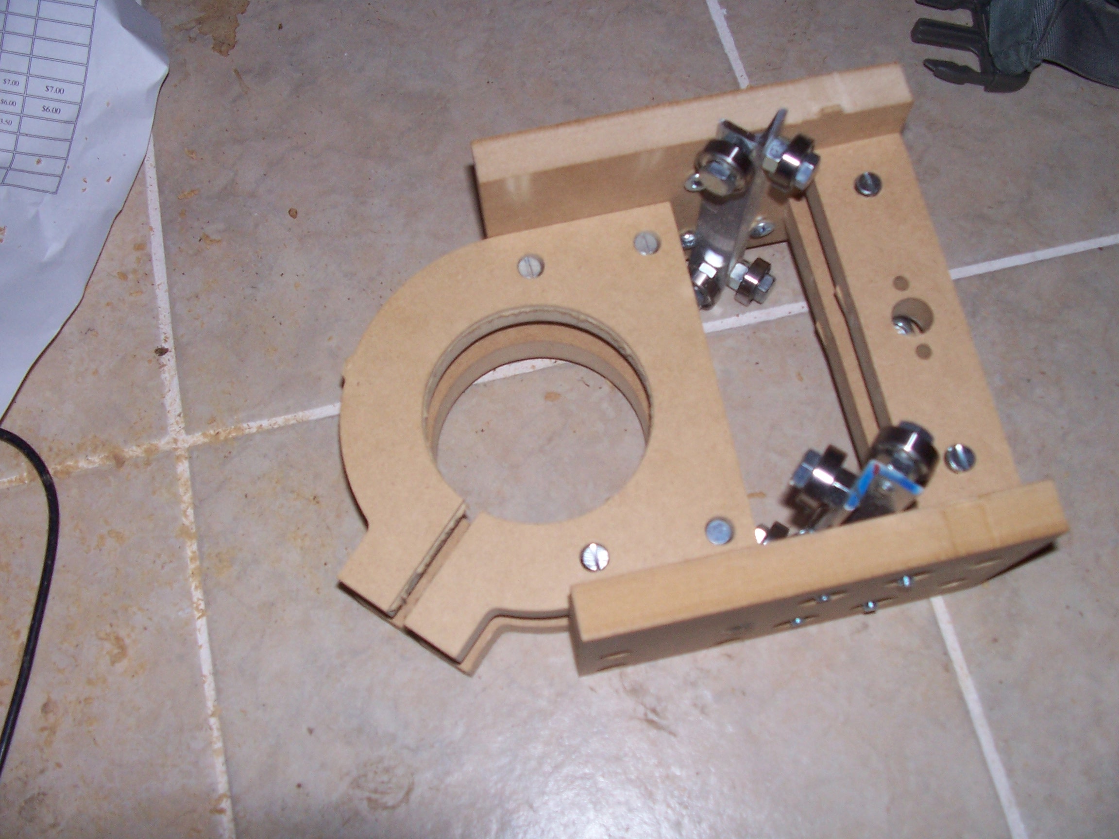

    Yes I am, here are some more pics

    looks good it goes together pretty easy just a lot of bolt when i did mine had to keep going to lowes for more bolt.

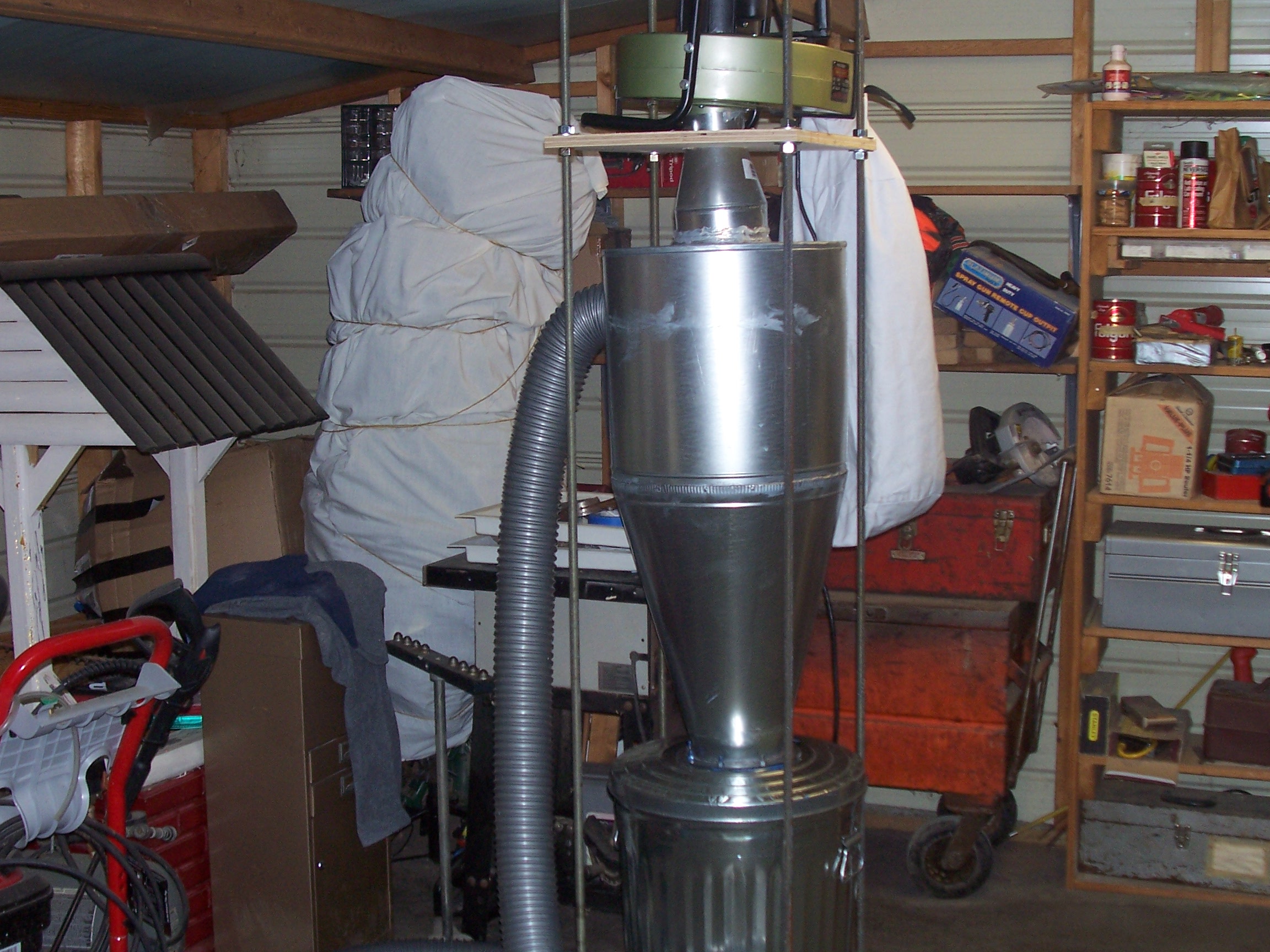

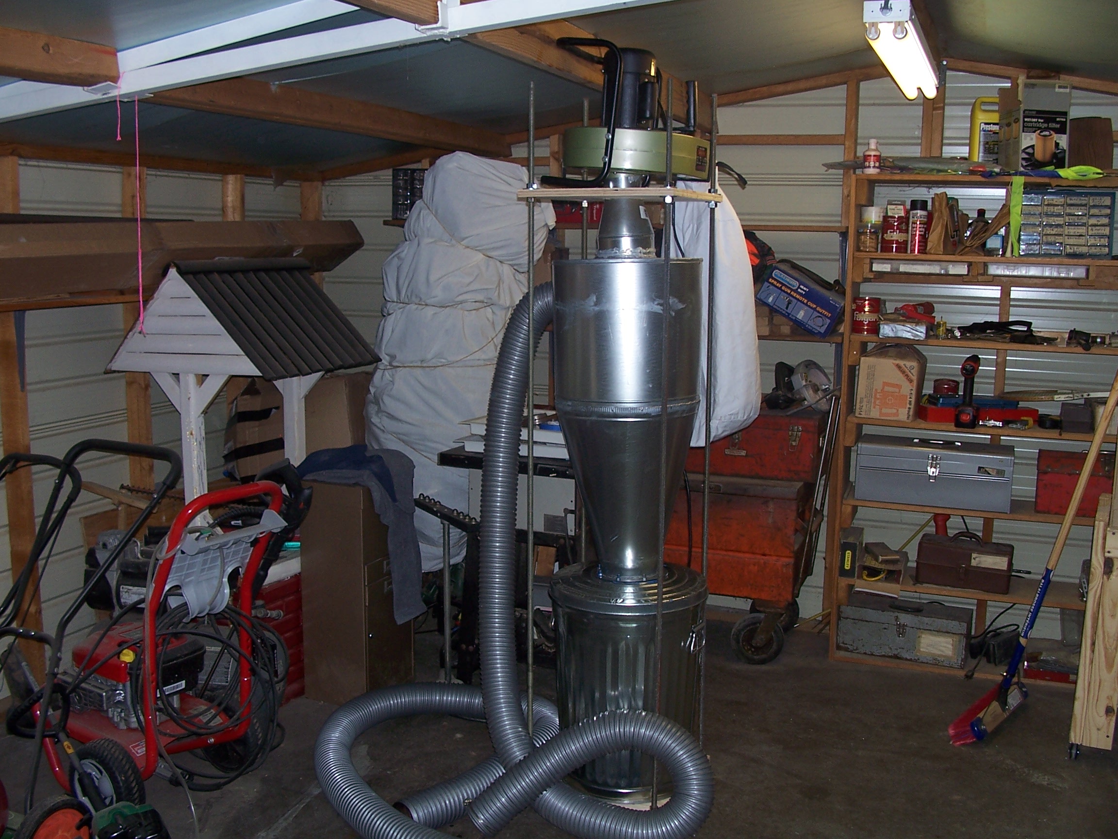

    I just thought I would post a couple of pictures of my cyclone Dust seperator system. I used 4 lengths of allthread, and 2 pieces of plywood to hold the weight, bolted the collector unit to the rafter of the shop.
    Check it out! Attached files [​IMG] [​IMG]
  11. TigerPilot
    That thing is BIG. Is it very noisy?
  12. crash5050
    crash5050 Member
    190
    Not really, about the same as a shop vac.
  13. 3DMON
    Looks great crash 5050! The cyclone separator is the best way to go in my opinion.
    Do you have an easy way to empty the can though? It looks like you would need to unbolt it to get to it from the pics.
  14. crash5050
    crash5050 Member
    190
    Details Details Details, hehehe two bolts from the rafter will allow the whole thing to pick up. It should take a while to fill up a 33 gallon can of dust though. The intital design was to use 1 1/4 x 1/8th angle to make a frame with slots so all I had to do was loosen the bolts in the slots and raise the entire thing. But the welding shop wouldn't do such a little job, they had bigger gas wells to fry. I am going to get a welder this weekend from Harbor Freight and try my hand at it, it has been 15 years since I Tig Welded.

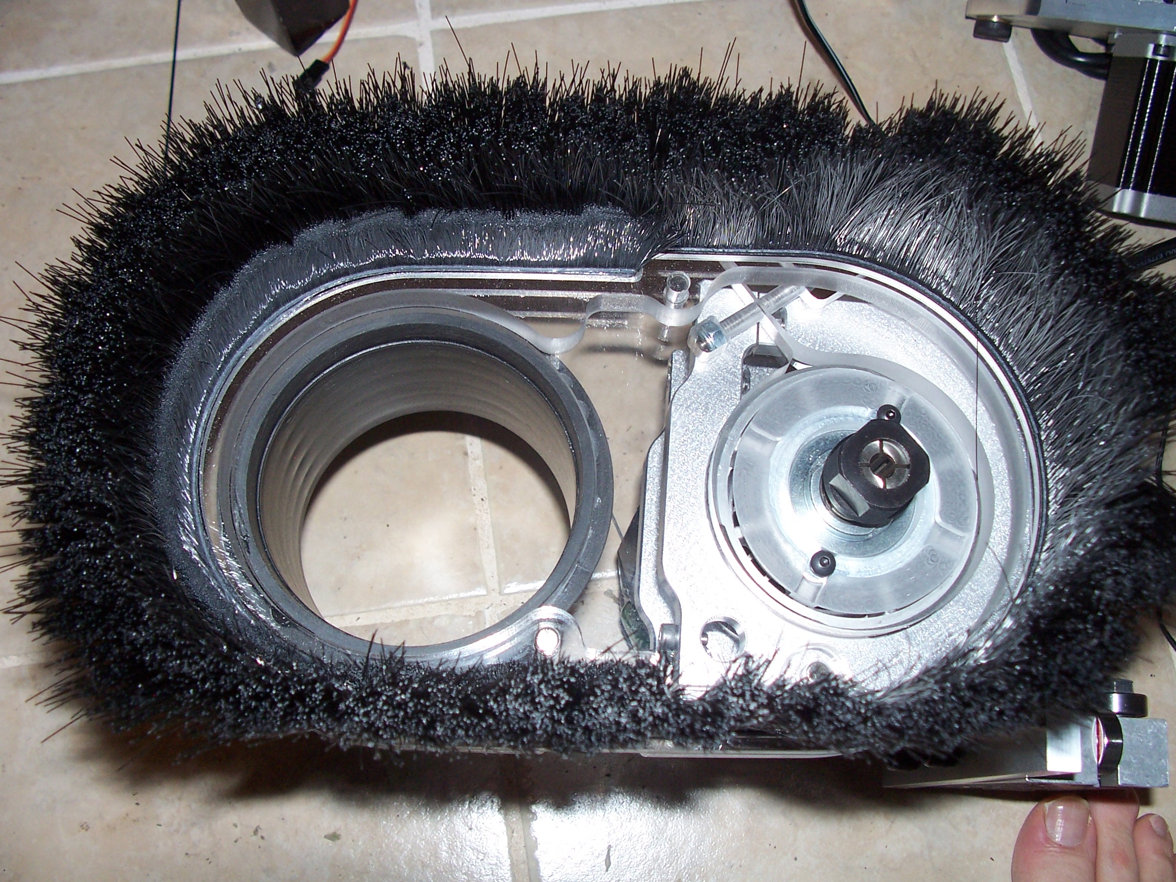

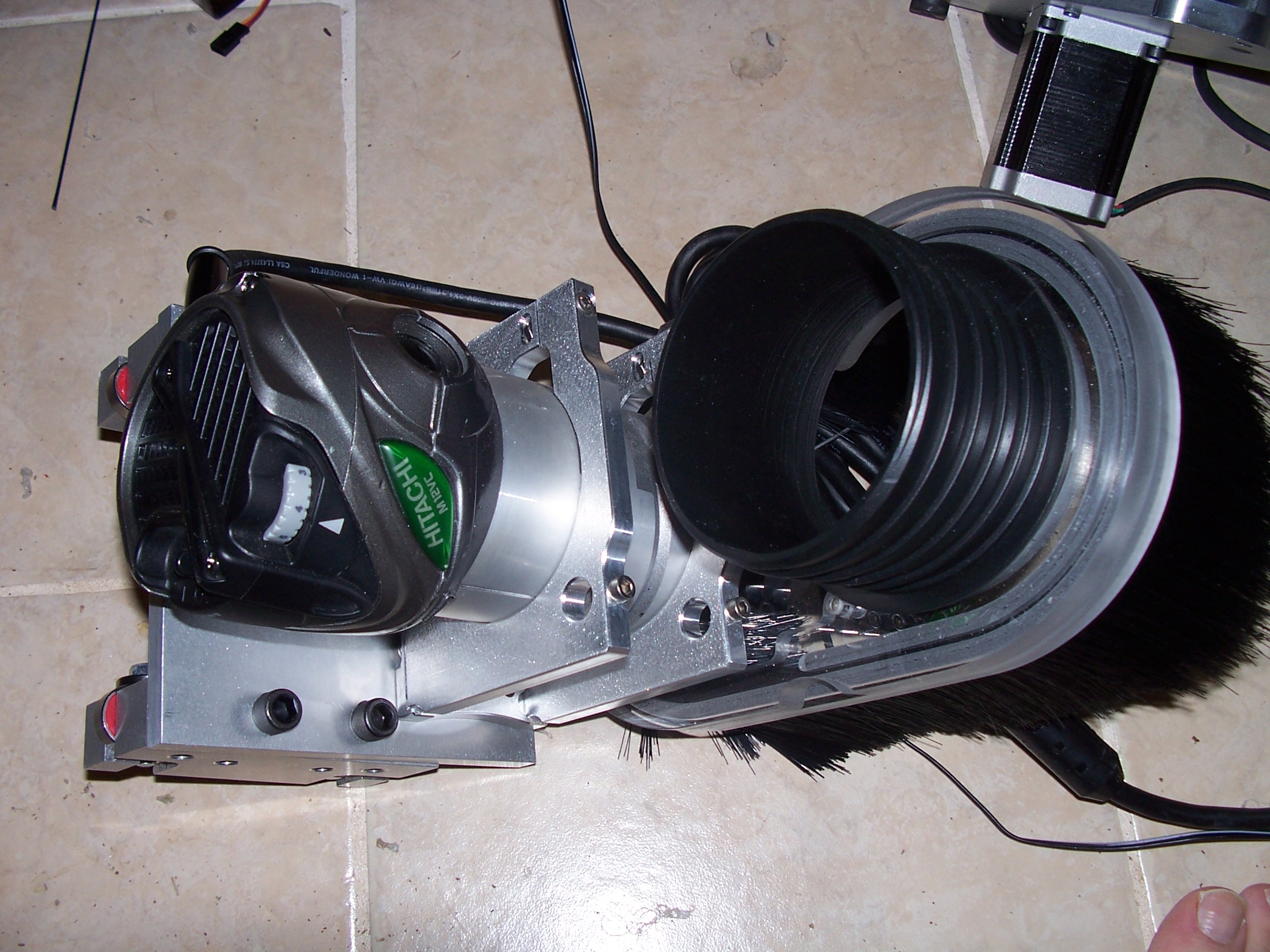

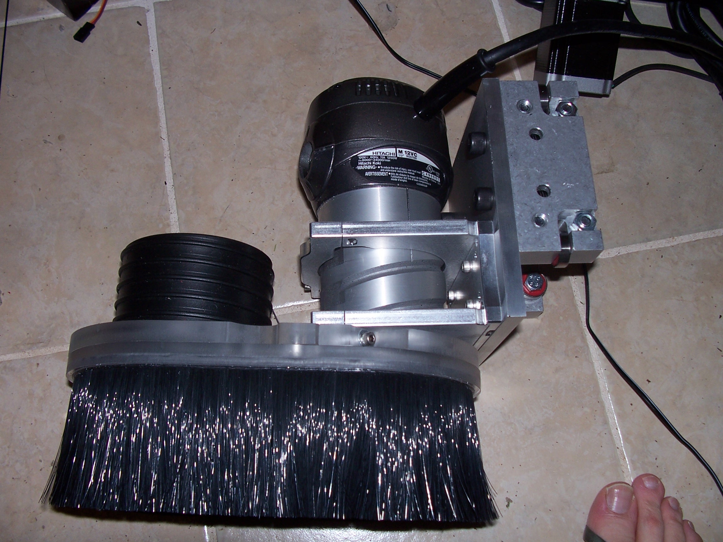

    Here is my Hitachi 12VC Router mounted to my K2CNC Alum. Router mount, attached to the new Z axis back plate and the CNCrouterparts Linear motion rails. And the dust shoe to connect to the big cyclone system.
