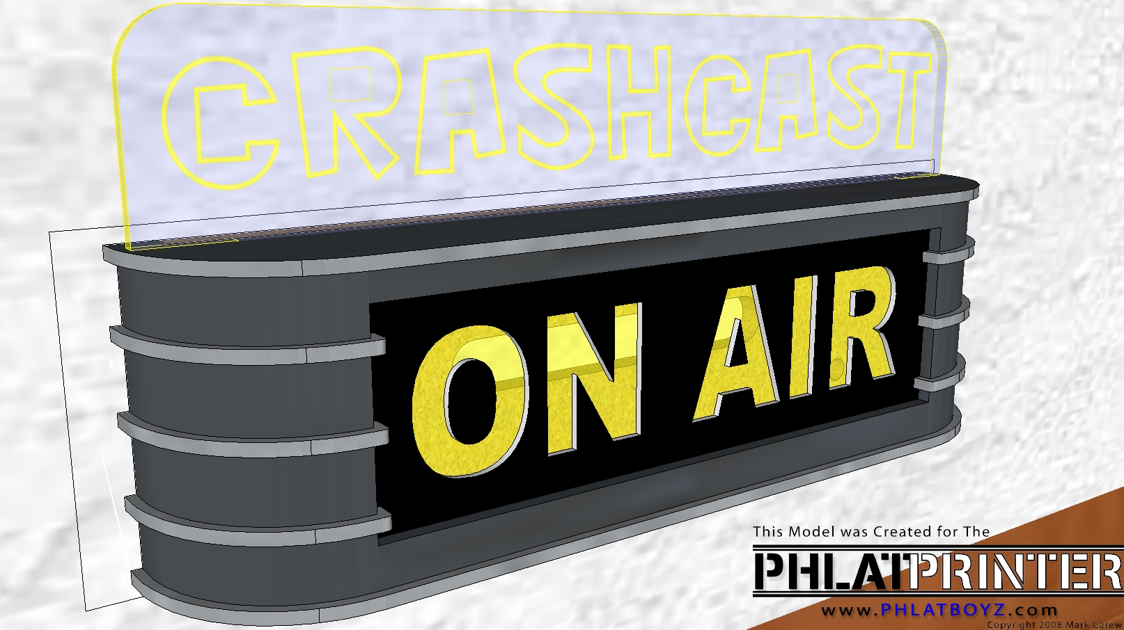

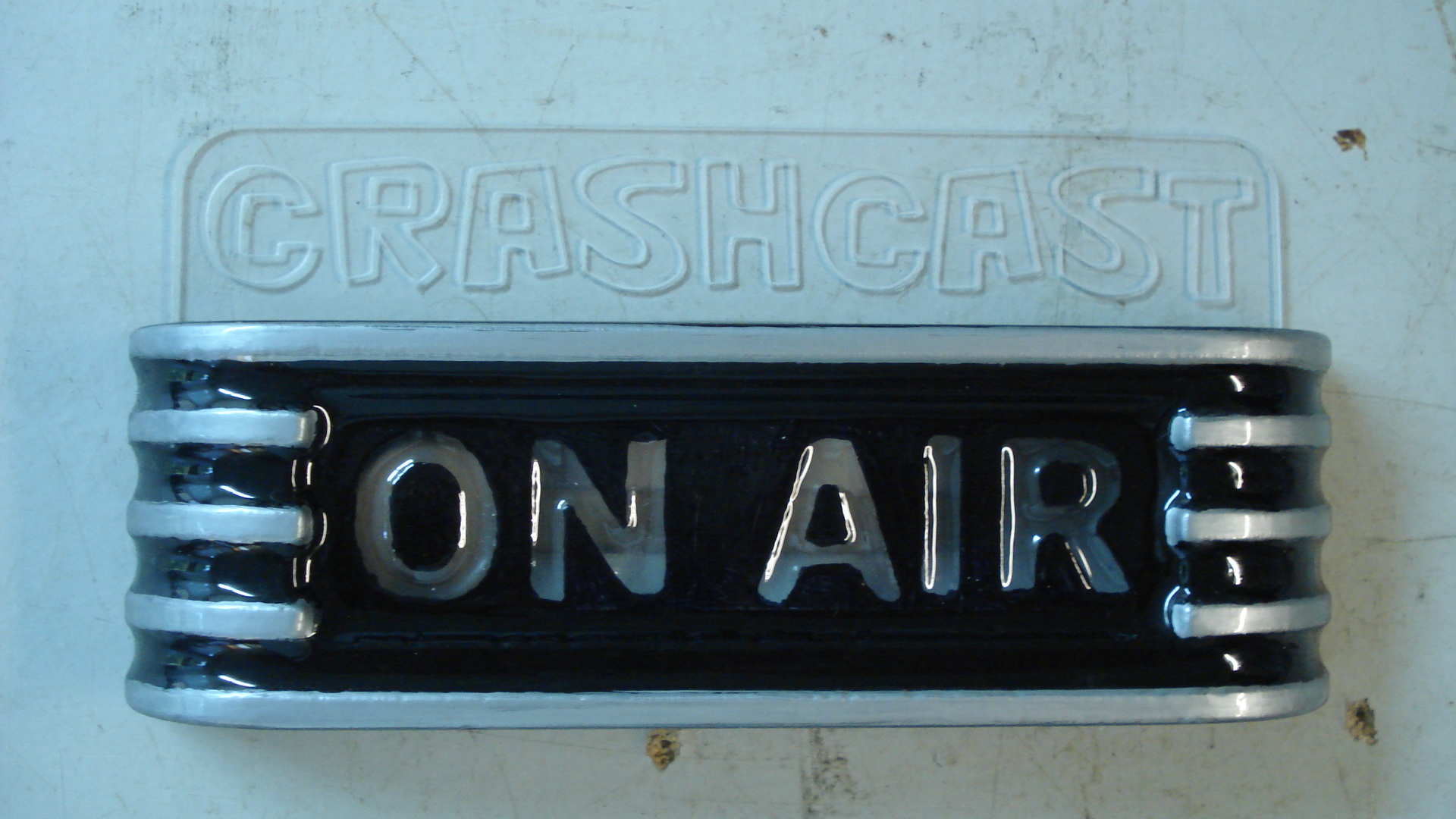

    Here is the prototype On AIR sign we are making for Mike 'Crash" Hancock podcast studio.
    PhlatLAB episode here: http://www.phlatforum.com/viewtopic.php?f=180&t=7418
    His new studio is where the magic takes place for the super cool Crashcast http://www.thecrashcast.com podcast.
    We have a lot of work to do on this project still and I am sure there will be changes, so we will post any update or changes made as well as pictures once the project is complete.
    Enjoy

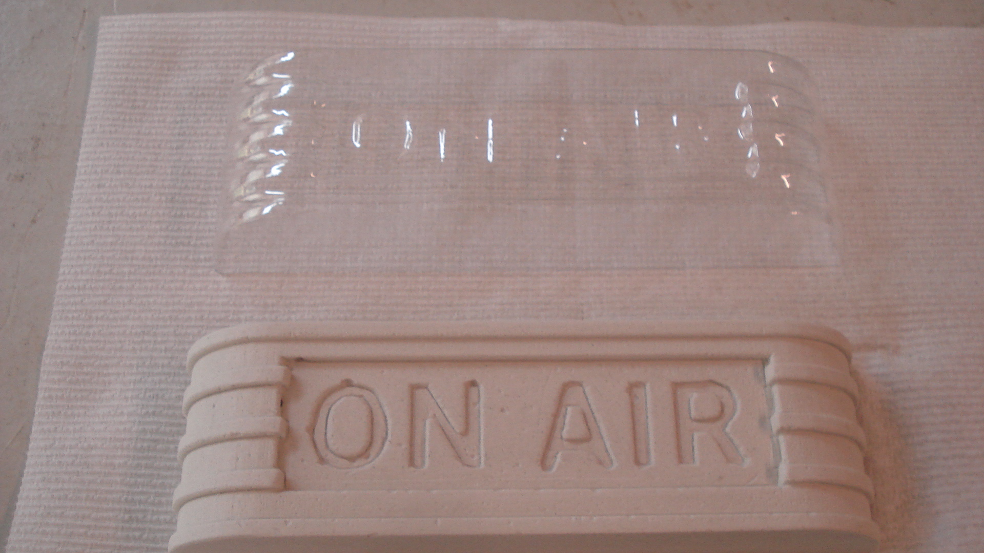

    Project materials:
    - 2" Foam board for mould
    - Plaster of paris for vacuum plug
    - .020 PETG plastic for Phlatformer
    - Paints and Marks/Paint pens
    - 1/8 Plexi glass Attached files [​IMG] [​IMG] [​IMG] [​IMG] On Air Extra Sign.skp (336.5 KB)Â [​IMG] On Air.skp (1.1 MB)Â

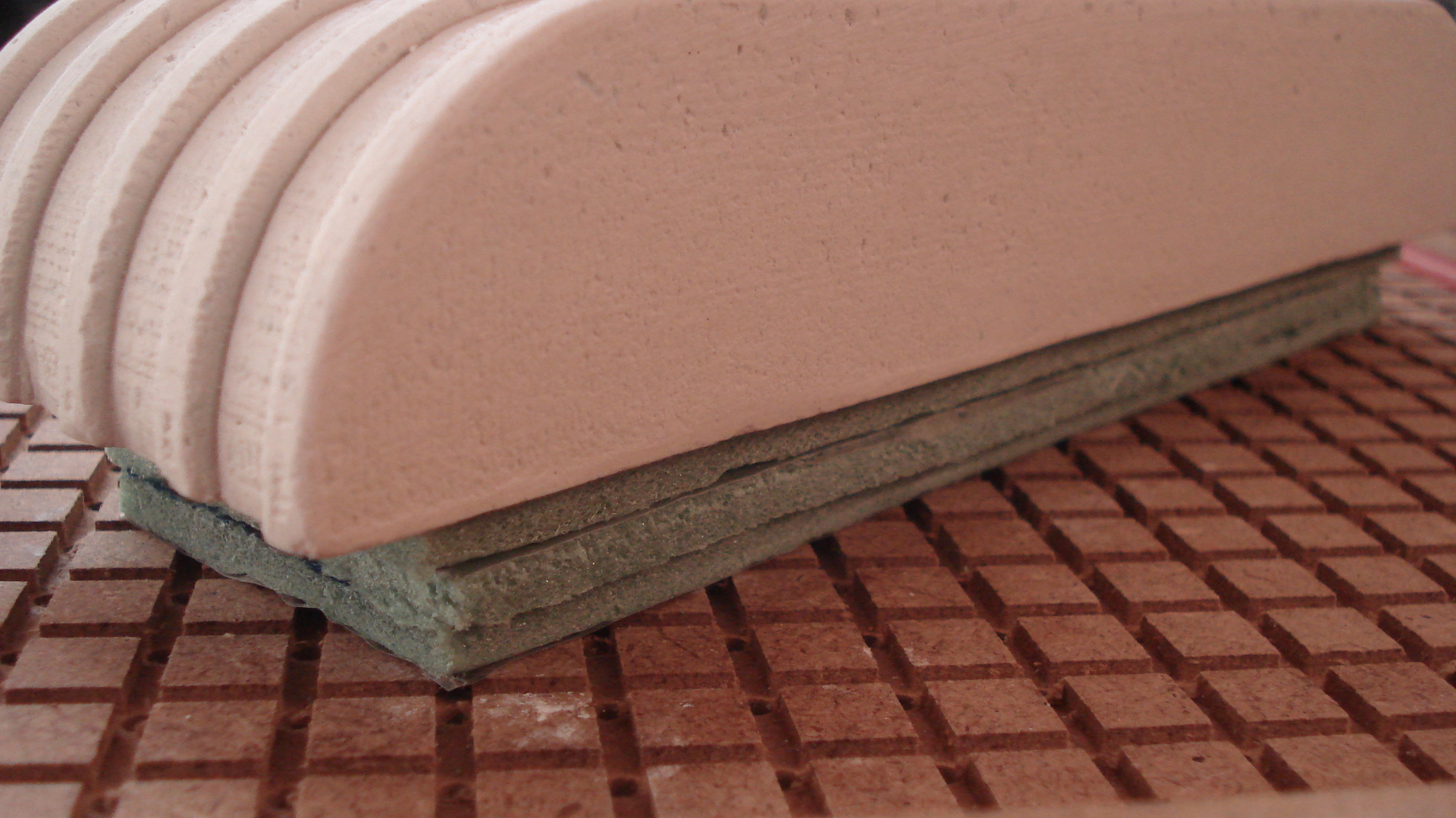

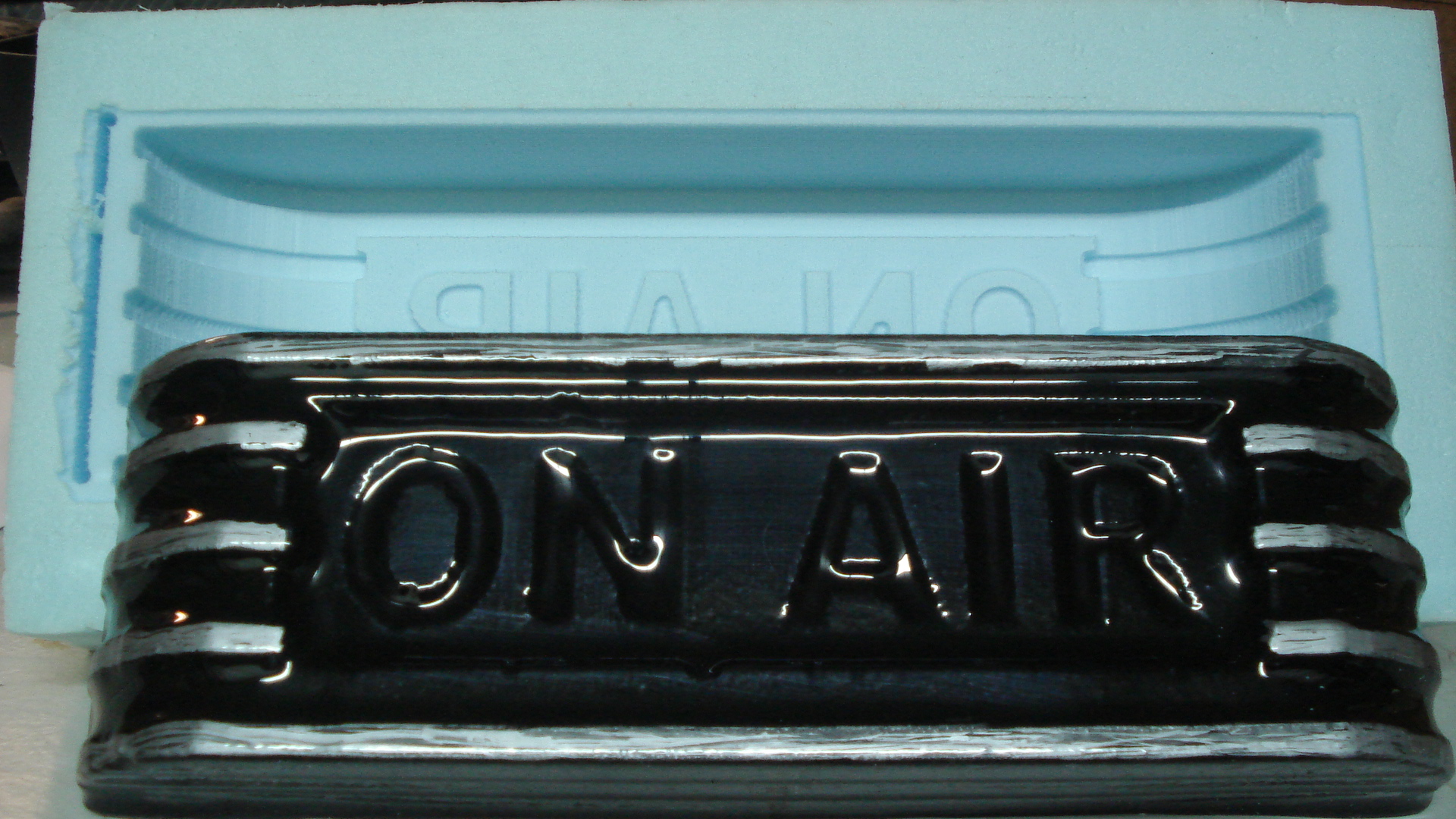

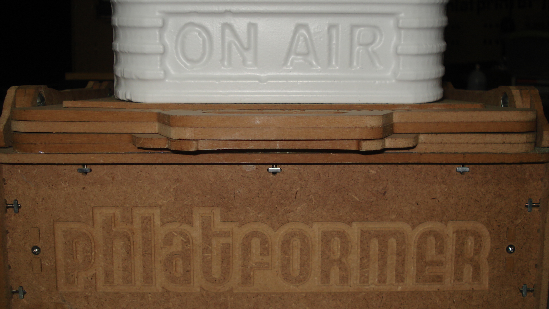

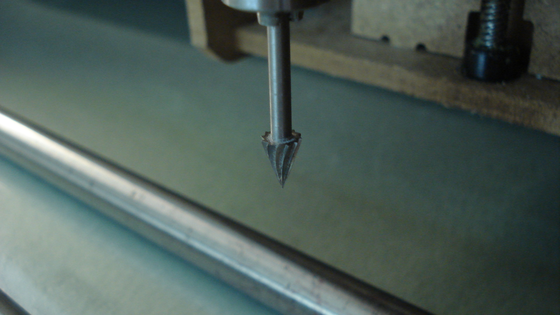

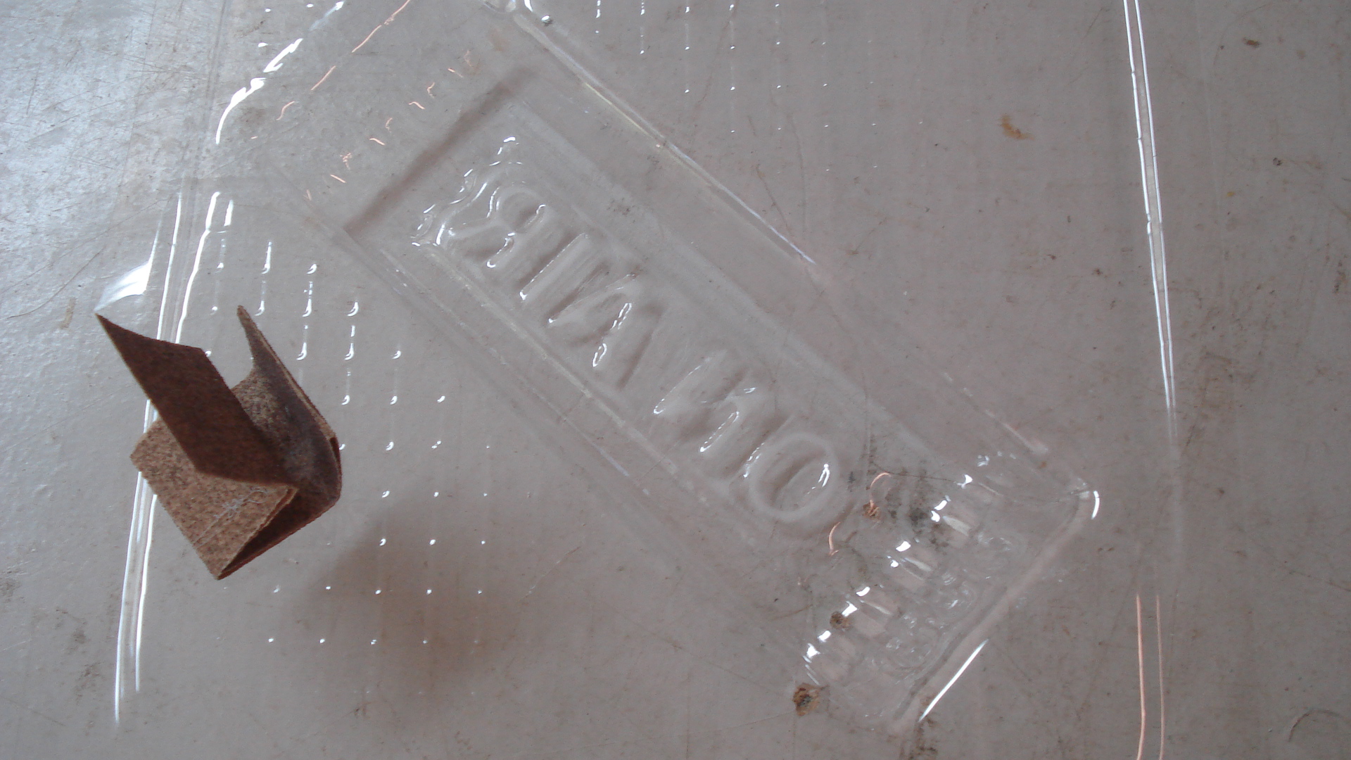

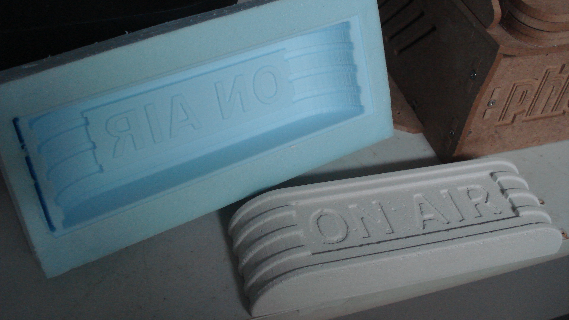

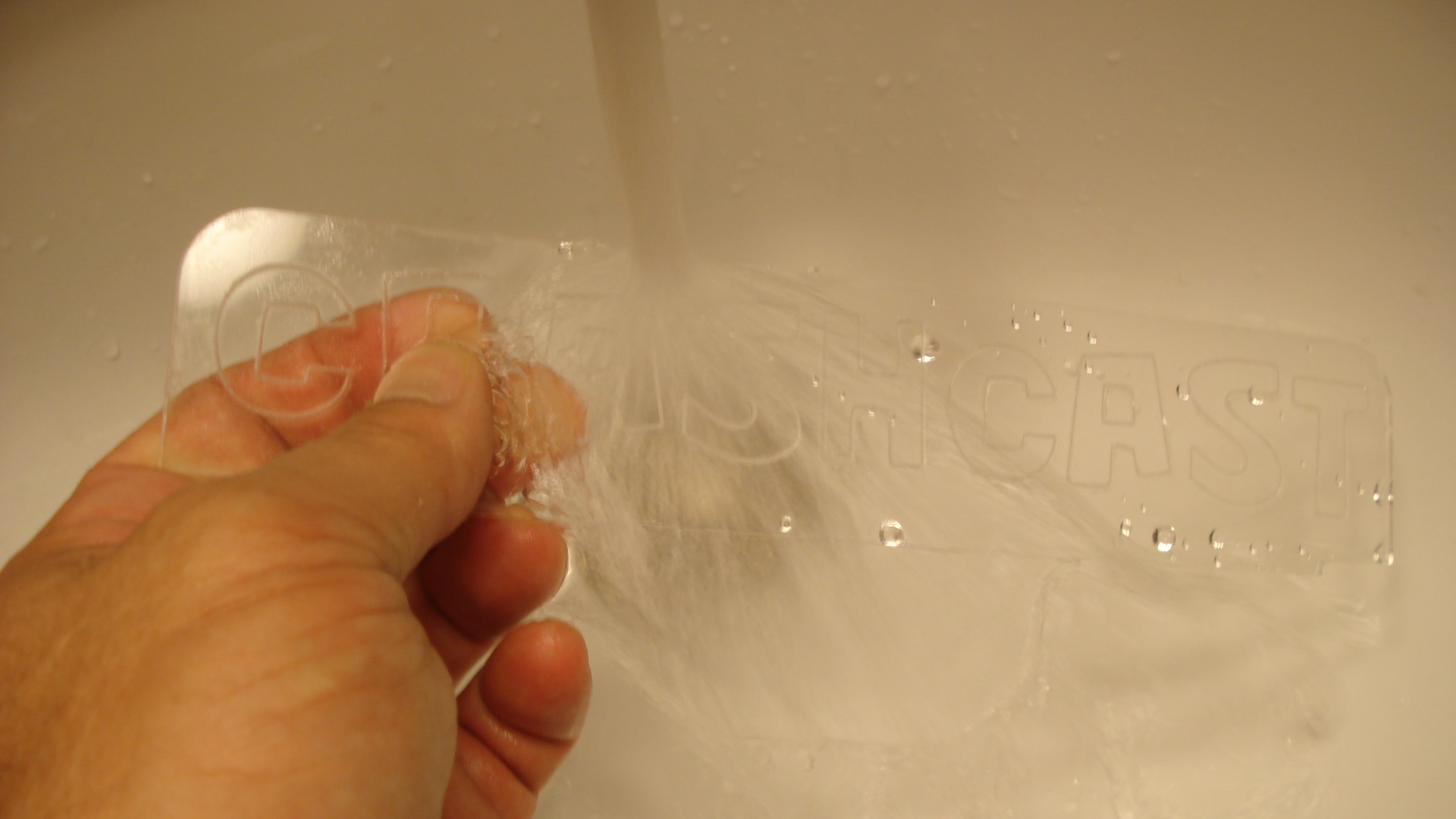

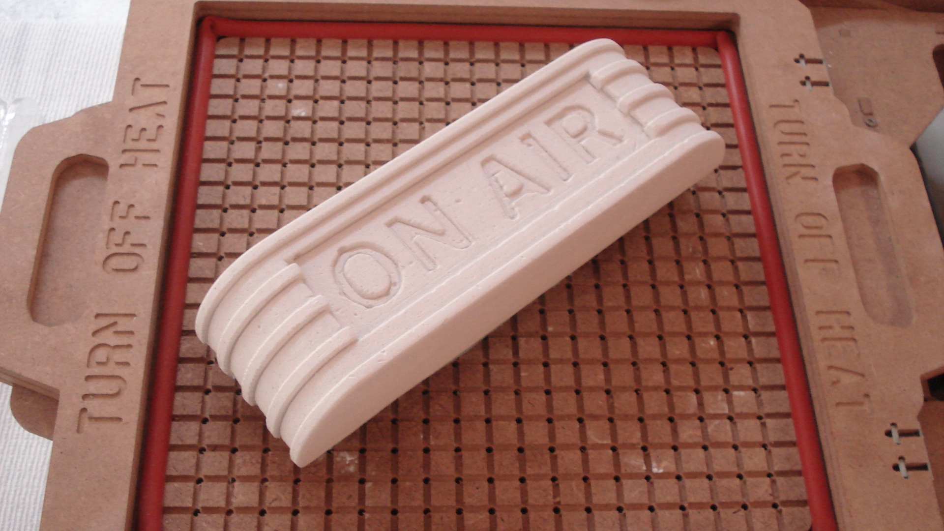

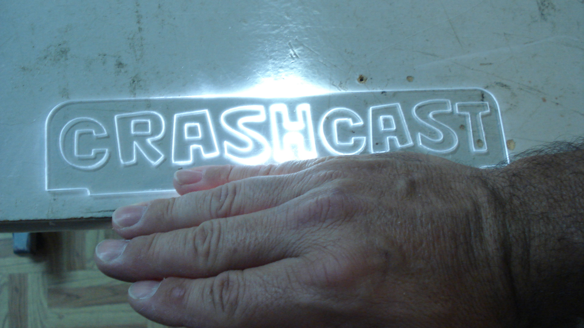

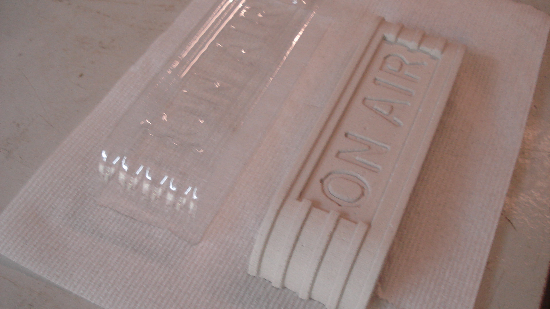

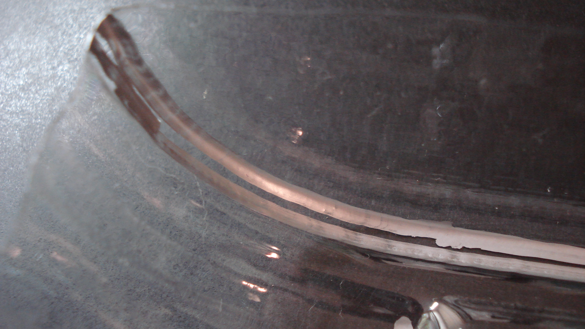

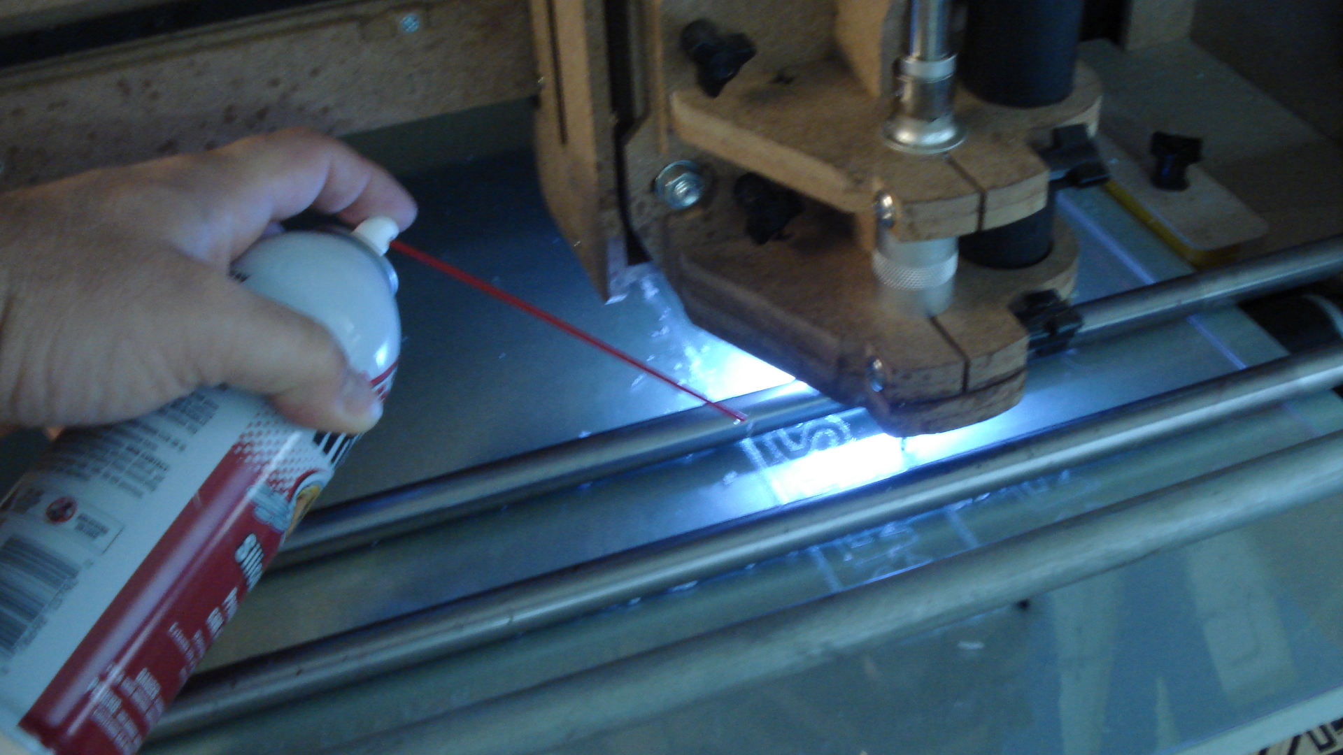

    Ok so work has started on the Crashcast sign and I have a few pic to share :)
    Attached files [​IMG] [​IMG] [​IMG] [​IMG] [​IMG] [​IMG] [​IMG] [​IMG] [​IMG] [​IMG] [​IMG] [​IMG] [​IMG] [​IMG] [​IMG] 38804=15009-DSC08725.JPG">[​IMG] [​IMG] [​IMG] [​IMG] [​IMG] [​IMG] [​IMG] [​IMG] [​IMG] [​IMG] [​IMG] [​IMG] [​IMG]

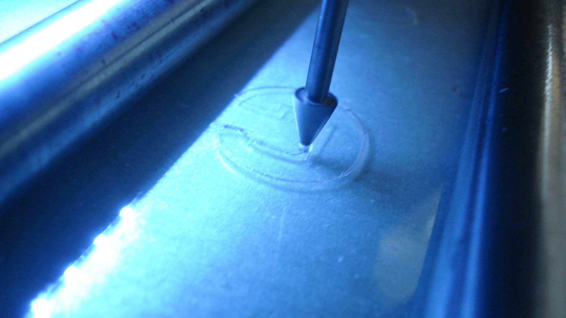

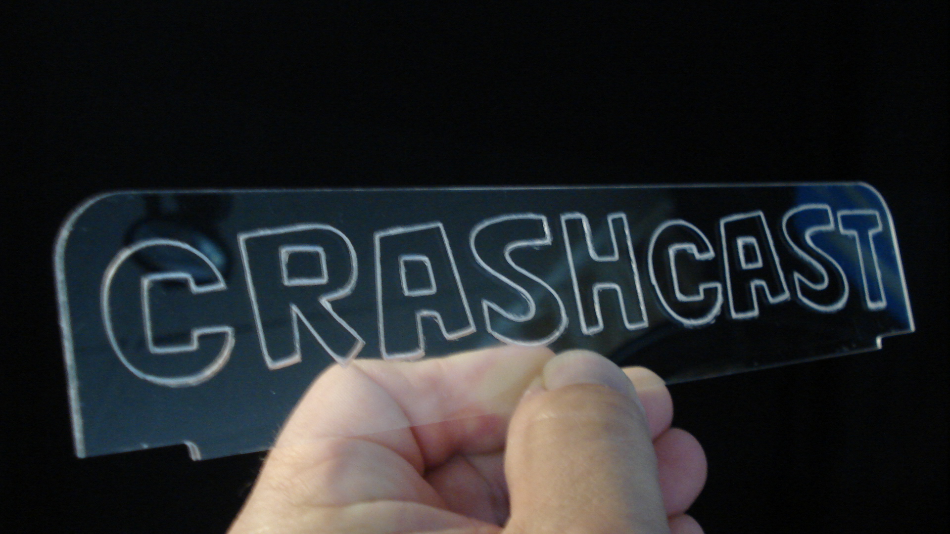

    Hey Mark...if you can drill into the bottom of the plexi, where you are holding the flashlight, and set the LEDS into it, it will light more evenly.

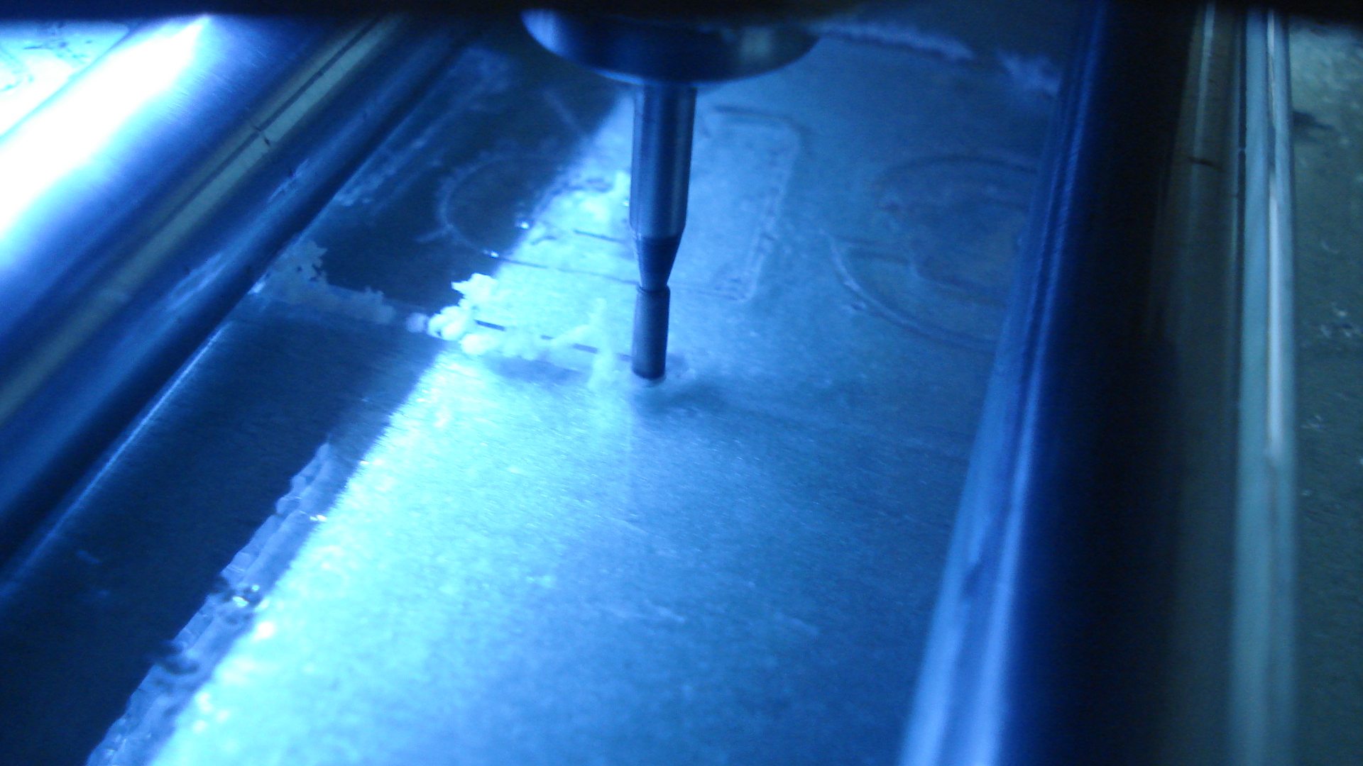

    I did a sign similar to that for Mother's Day this year, using my Sherline. I found that using the ball nose dremel bit worked best, and running multi pass was imperative. I had to play with the speeds to get it right, but it sure was cool when I figured it out!! I kept the vacuum cleaner running to clear the chips...
