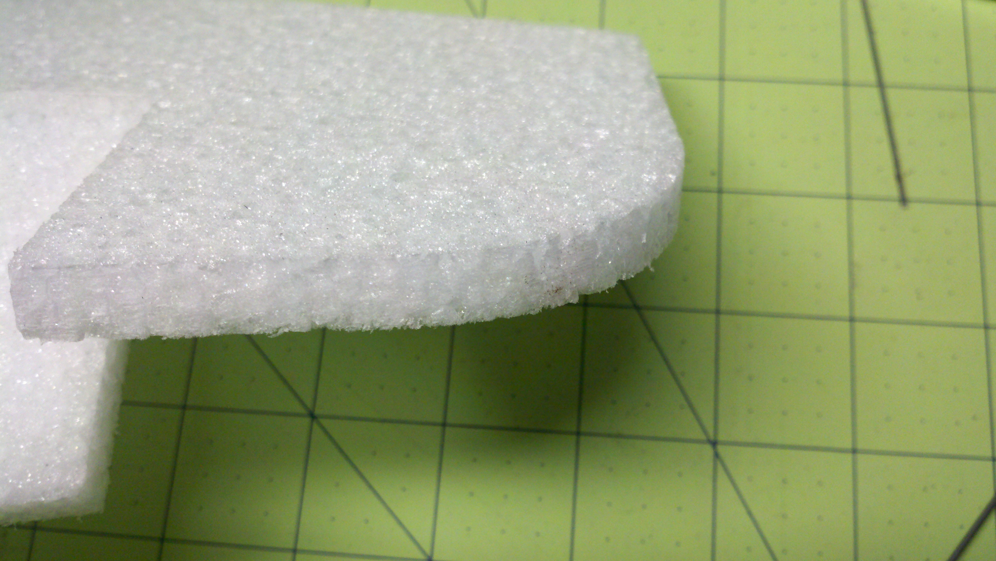

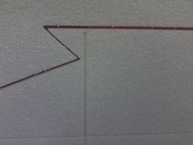

  15. dugd1013
    dugd1013 Member
    135
    Air Capital of Kansas
    After quite a bit of trial and error cutting I have found a very reliable combination for cutting designs out of 9mm 1.3lb & 1.9lb density EPP foam. I have settled on a feed rate of 35 ipm using the stock MK spindle and a Dremel brand 1/8" tile cut bit. I use a FFF carrier sheet slightly longer than the 24 x 36 EPP sheet and pin each end with (5) straight pins. I have been using V style tabbing set at 50% depths. Every pattern, no matter how complex has cut exactly as it should using this configuration. The cut edge of the EPP will appear slightly skinned over, which I actually prefer for my foamies. Hopefully this will help take some of the guess work out of setting up for EPP cutting.

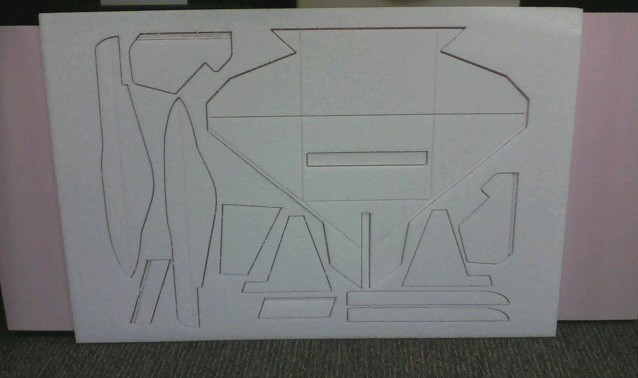

  19. dcampbell
    dcampbell Member
    54
    6
    Followed your guidelines for speed and feed and got a nice cut on 9mm epp of an f22. Used pink ff as a backer. Thanks for your trial and error for everyone else! Attached files [​IMG] [​IMG]
