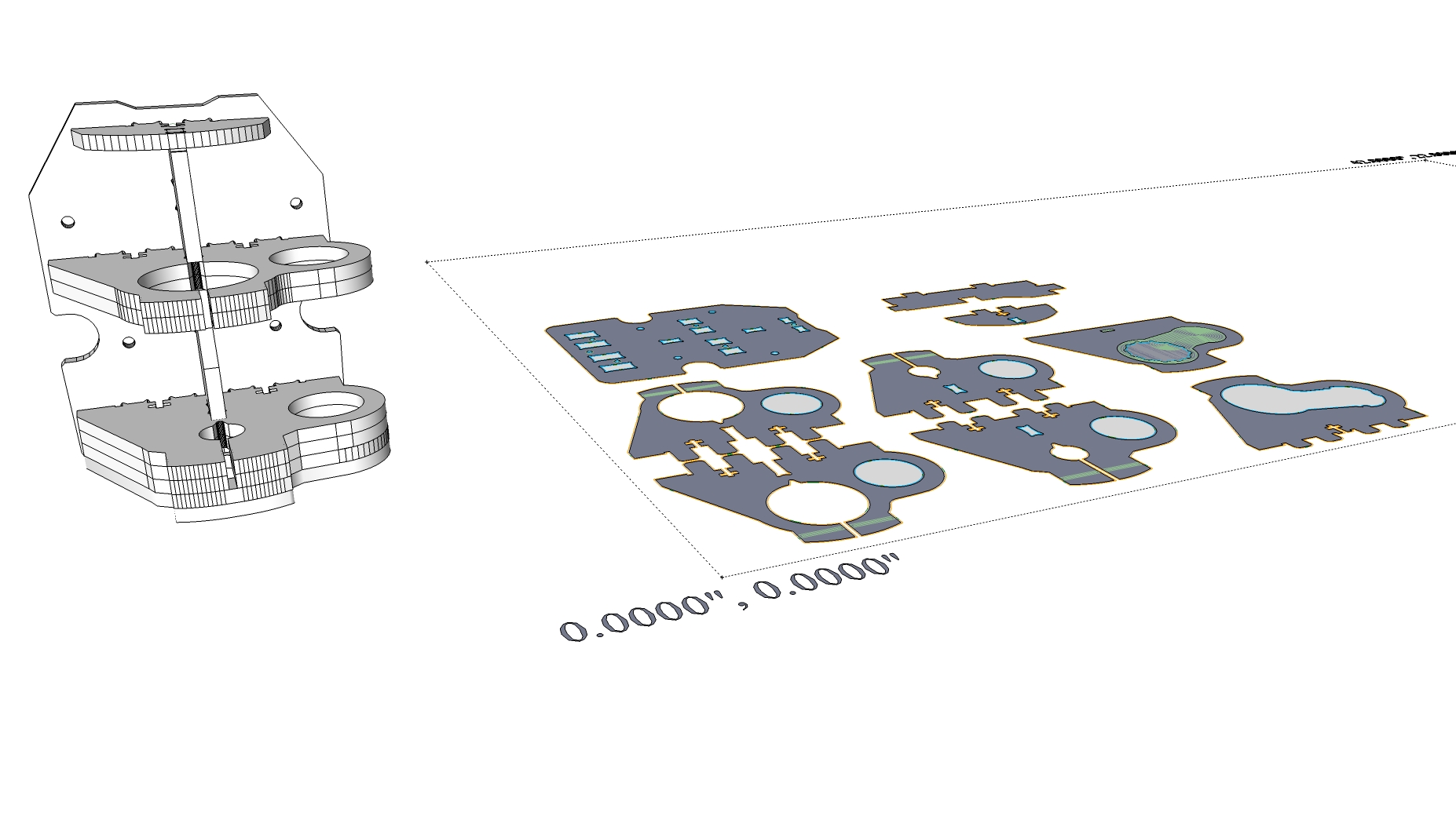

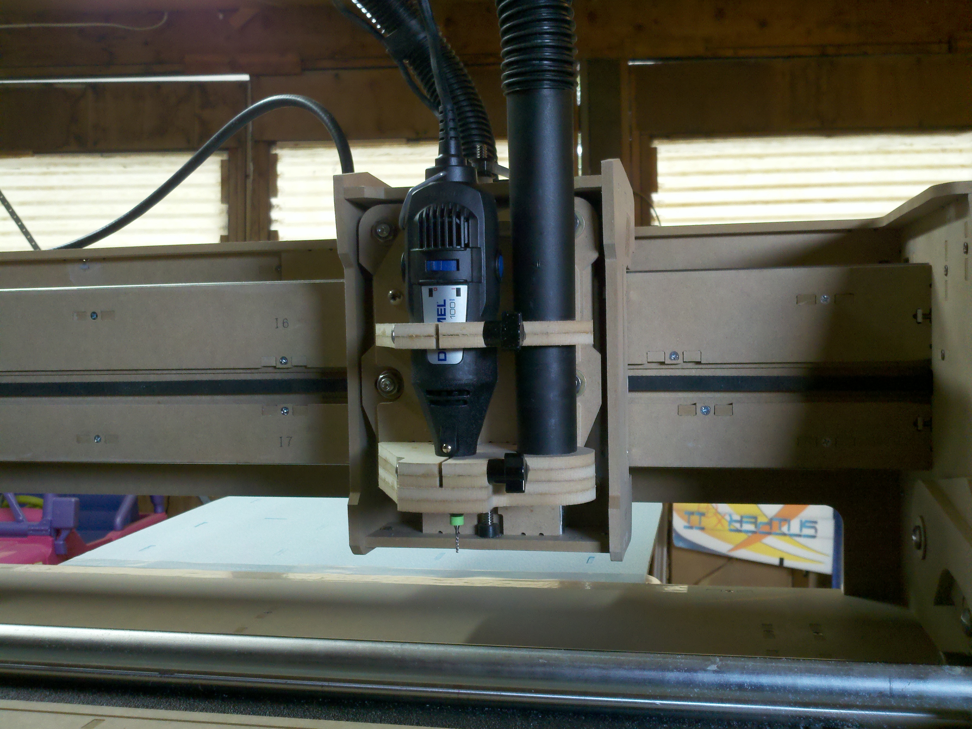

    Here is the Dremel attachment I have been working on. I know it fits the 100 and the 200 models. It is setup to be cut with a 1/16" bit at 20 ipm. Please look at the 3d model for assembly. I had to drop the whole attachment down in order to fit shorter bits in it and not bottom out the roller bearings on the z axis.
    One of the main reasons I did this attachment is to gain some more rpm at the spindle, mainly just for cutting EPP foam. If you have a problem with run out and/or vibration, try a different collet or go to the keyless chuck that dremel offers. You can pick a cheap single speed Dremel at Walmart for about $35. Attached files [​IMG] [​IMG] Dremel attatchment.skp (4 MB)Â

    Nice one Craig !
    This one is going to be a BIG HIT .... You knocked another one out of the park :banger:
    Im going to get lots of use out of this one. :dance3:
    Thank you !! :good: Attached files [​IMG]
    SWEET! Thanks you Craig :doubleup:
