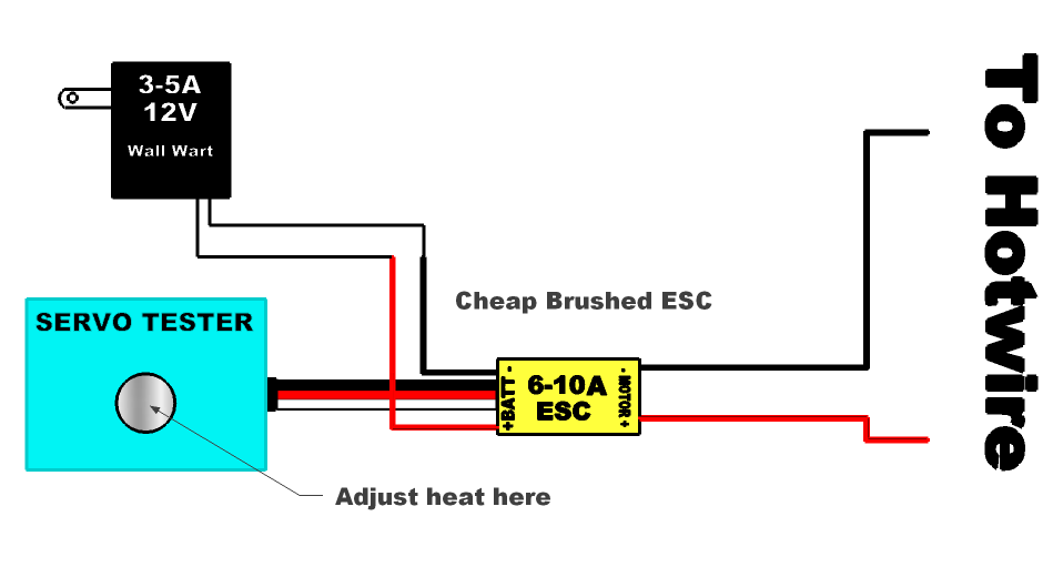

    Here is a simple cheap way to build a good hotwire with things you may already have.
    Here is a link to the servo tester/driver...
    Turnigy Servo tester/driver
    Just about any old brushed esc will work.
    Just use alligator clips to attach the motor wires to your hotwire and use the servo control knob on the servo tester to adjust your heat.
    -Buk Attached files [​IMG]
