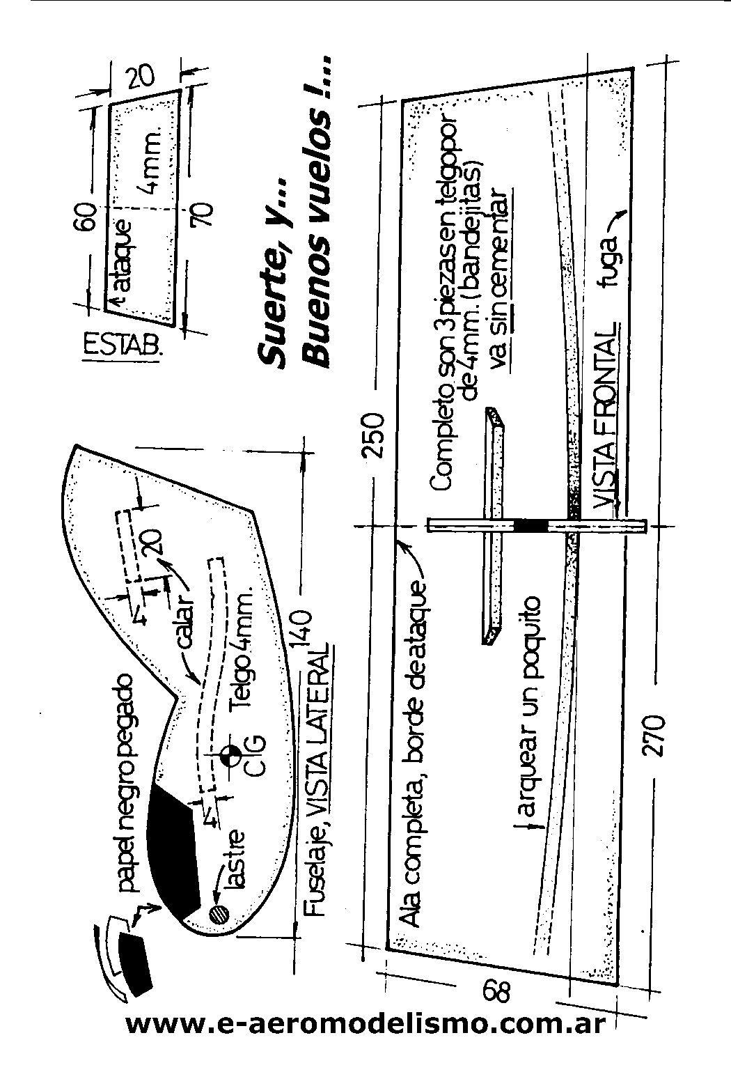

    I have made about 200 of this (by hands) for primary school kids, they were doing the final job on polystyrene trays using plastic knives. Not always good looking results but always good flying performances. :p
    Finally I have made the cuts from phlatprinter both based on 3,5 mm and 6,2 mm depron (thickness +/-).
    If you like them just scale the wing and tailplane thickness to suit your material.
    Balance is obtaines with one or two euro cents.
    Thanks to Guillermo of the Argentina Escuela de Aeromodelismo for sharing the plan pics.
    Carlo, third Italian Phlatboy (... not so phlat to be honest) Attached files [​IMG] [​IMG] cortito022.skp (319.2 KB)Â cortito026.skp (315.5 KB)Â
  2. rcav8r
    Those are pretty cool. I'll have to make a few for my son and his friends. That incidence on the tail sure looks a little excessive ;)
  3. actaline
    actaline New Member
    21
    You are right, it looks a little excessive but it helps due to the short fuselage
    anyway a few kids reported the model was flying well even without tail :lol:
