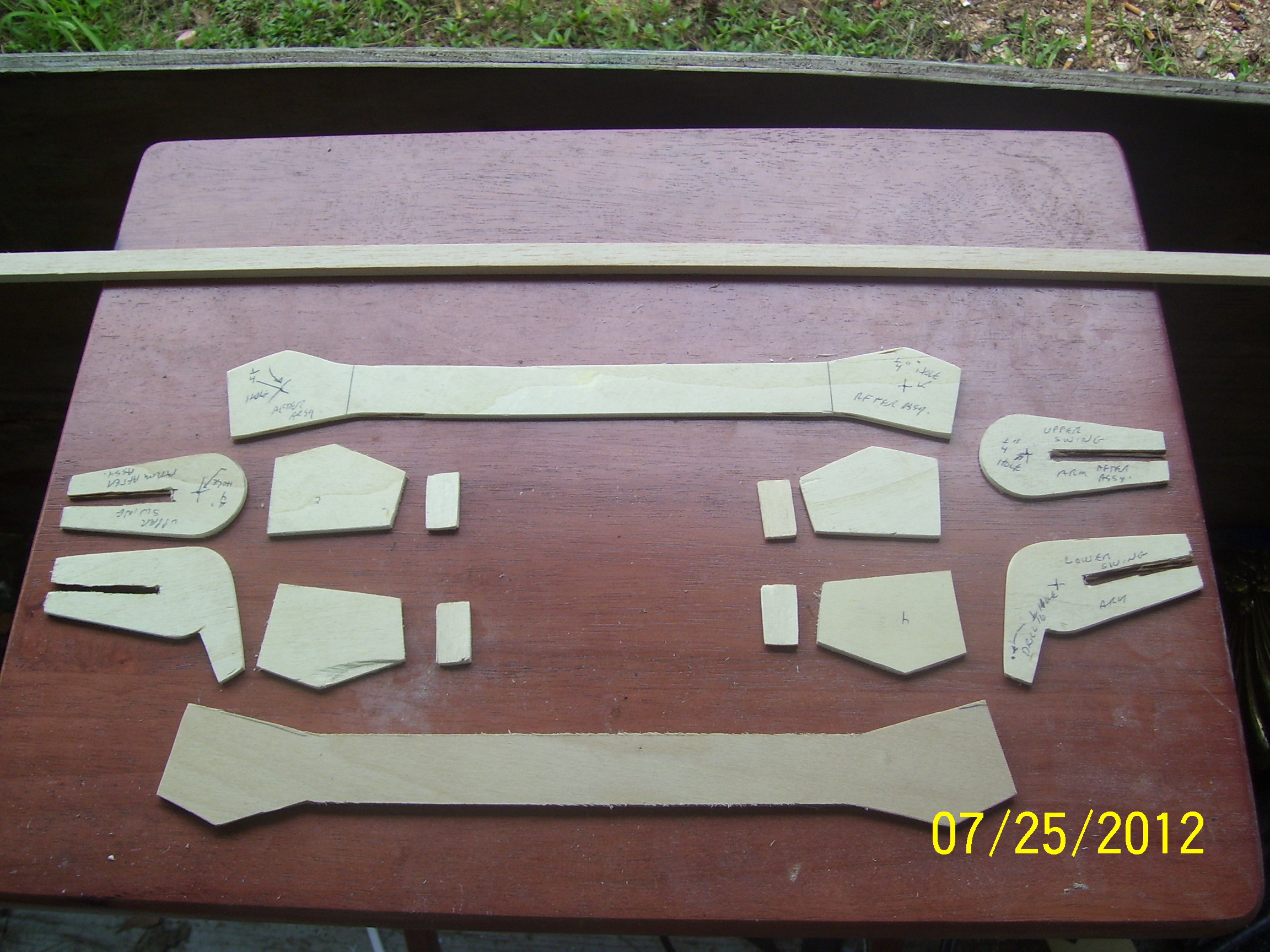

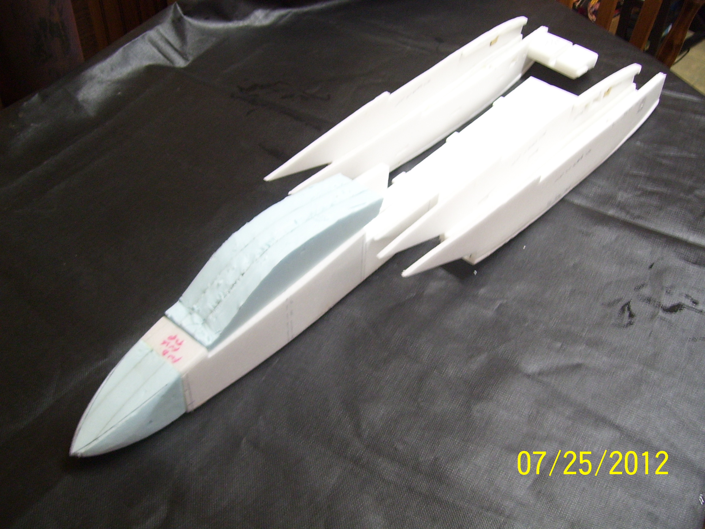

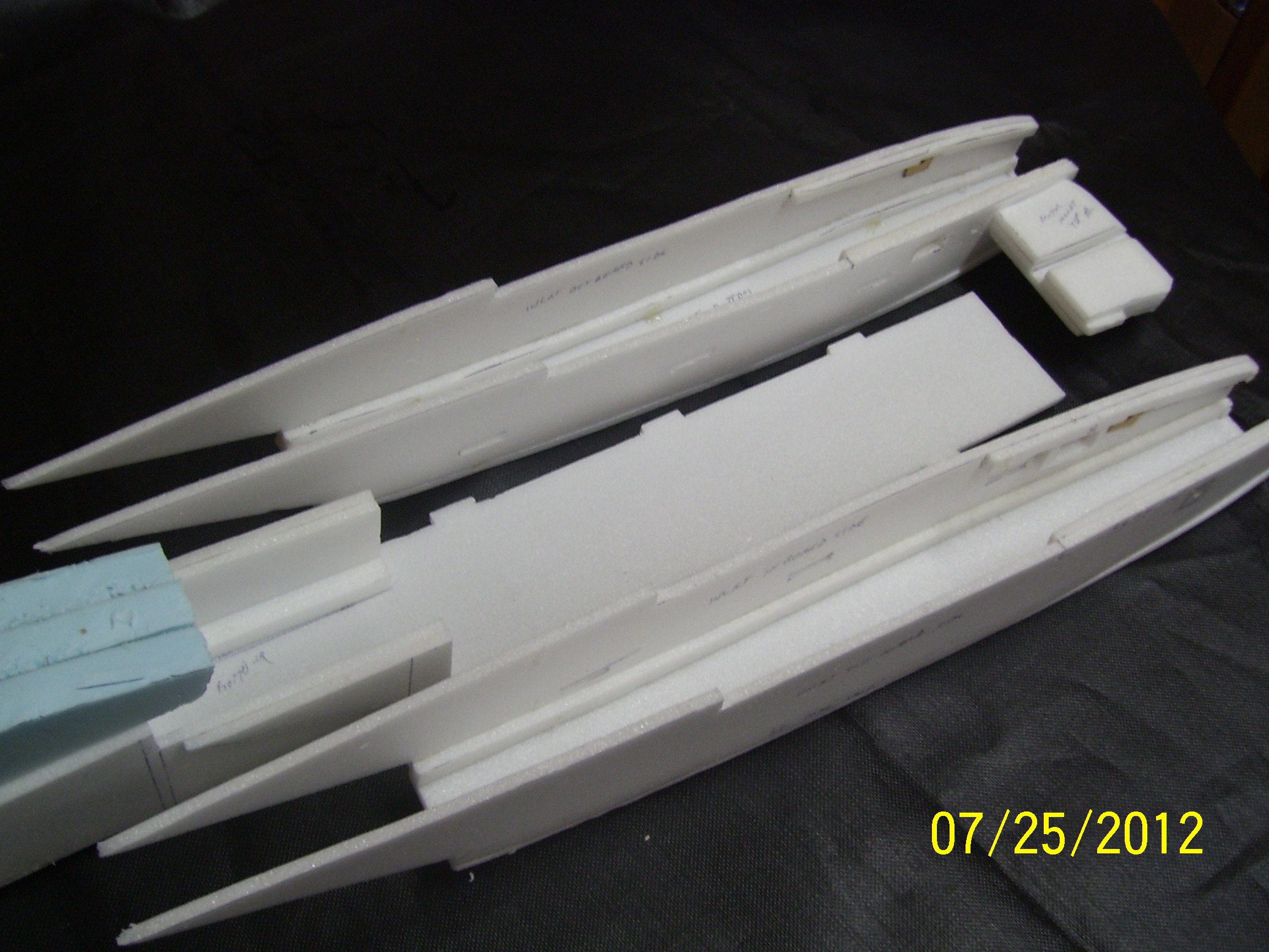

    Thought I would post my progress on the Steve Shumate F-14 ,with swing arm.
    Wow you took on a challenge on this one. thats a tough build.
    Looking nice Gary :good: keep up the good work.
  3. rescue911
    rescue911 Active Member
    418
    earth

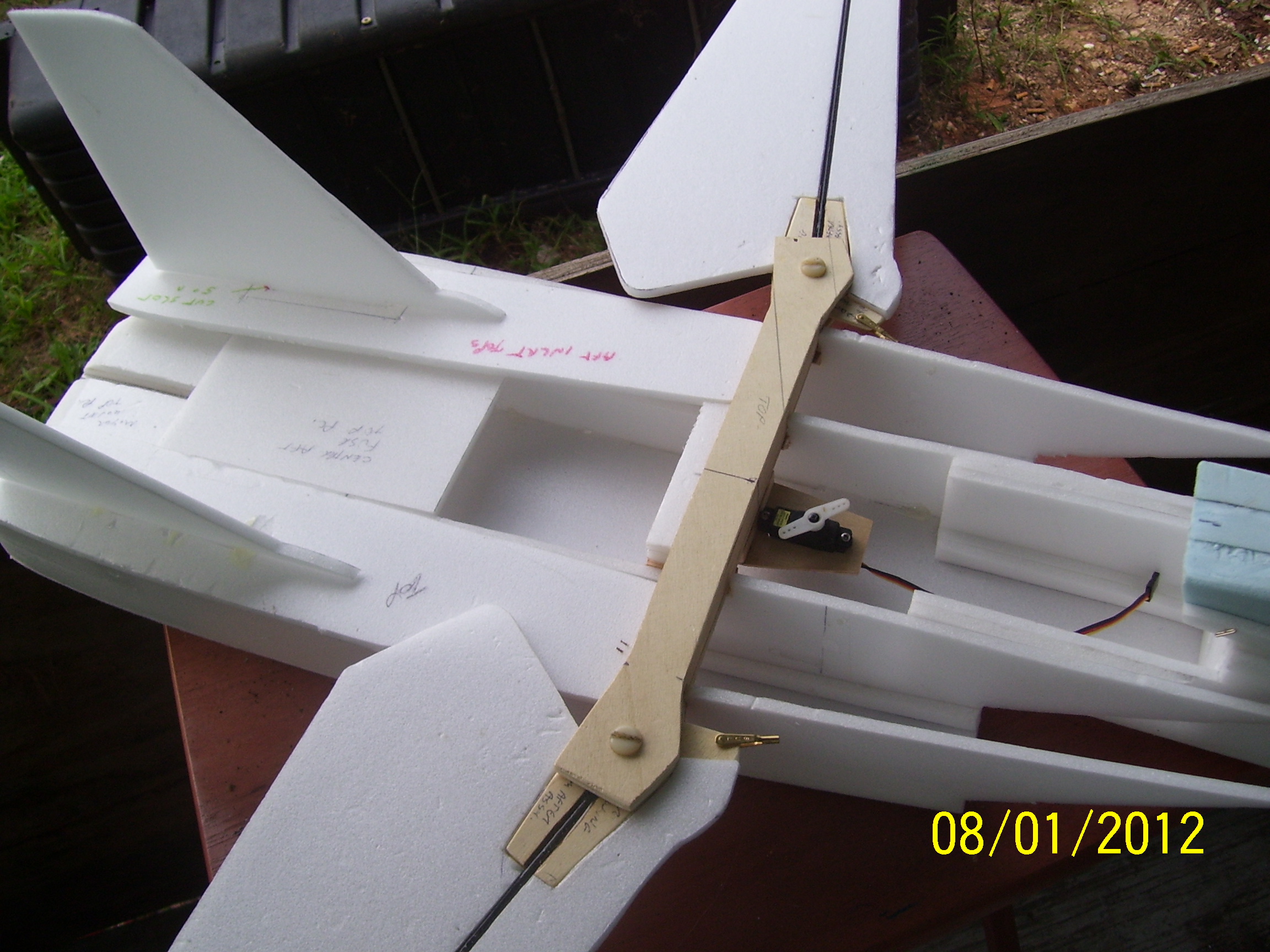

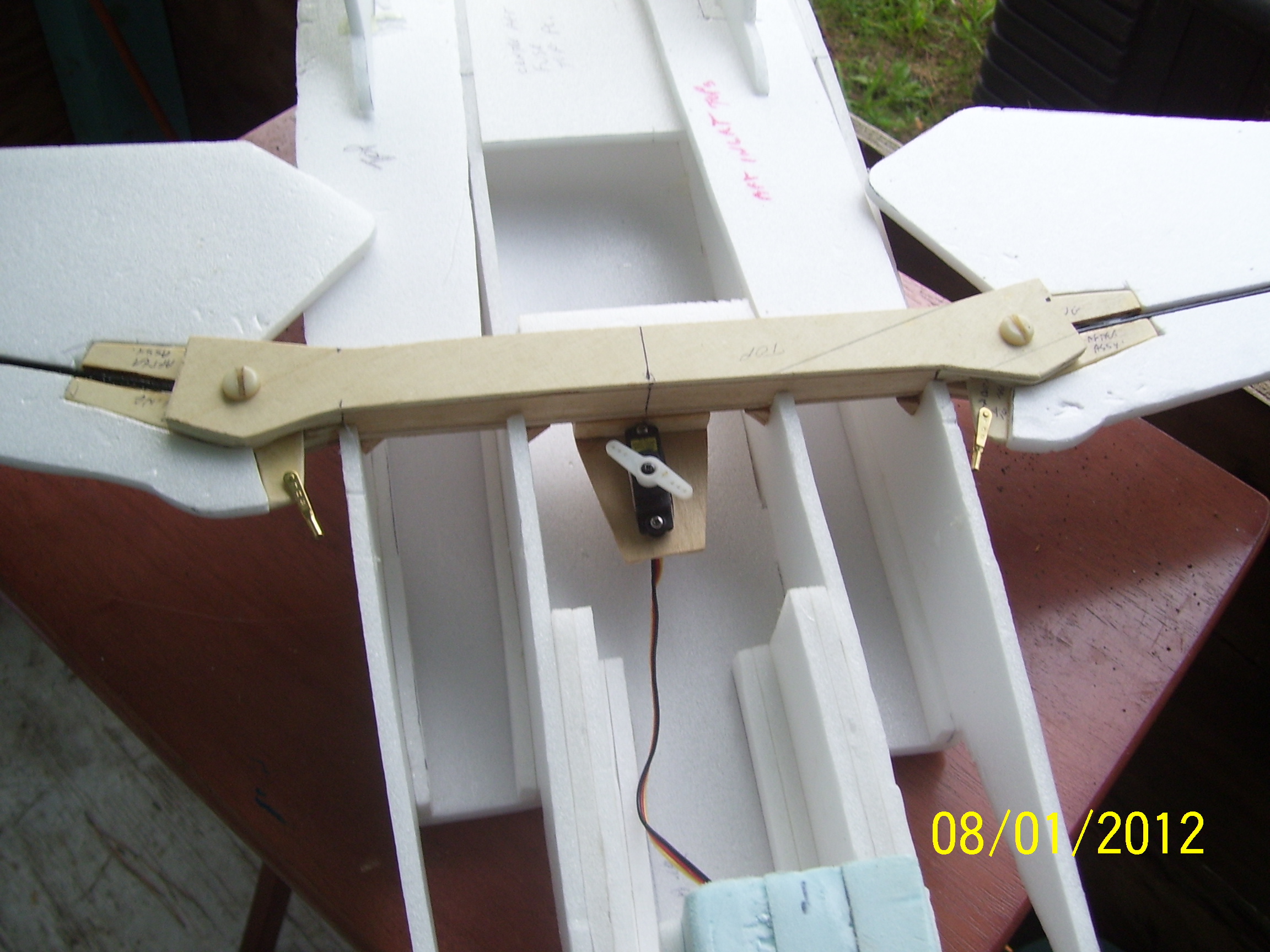

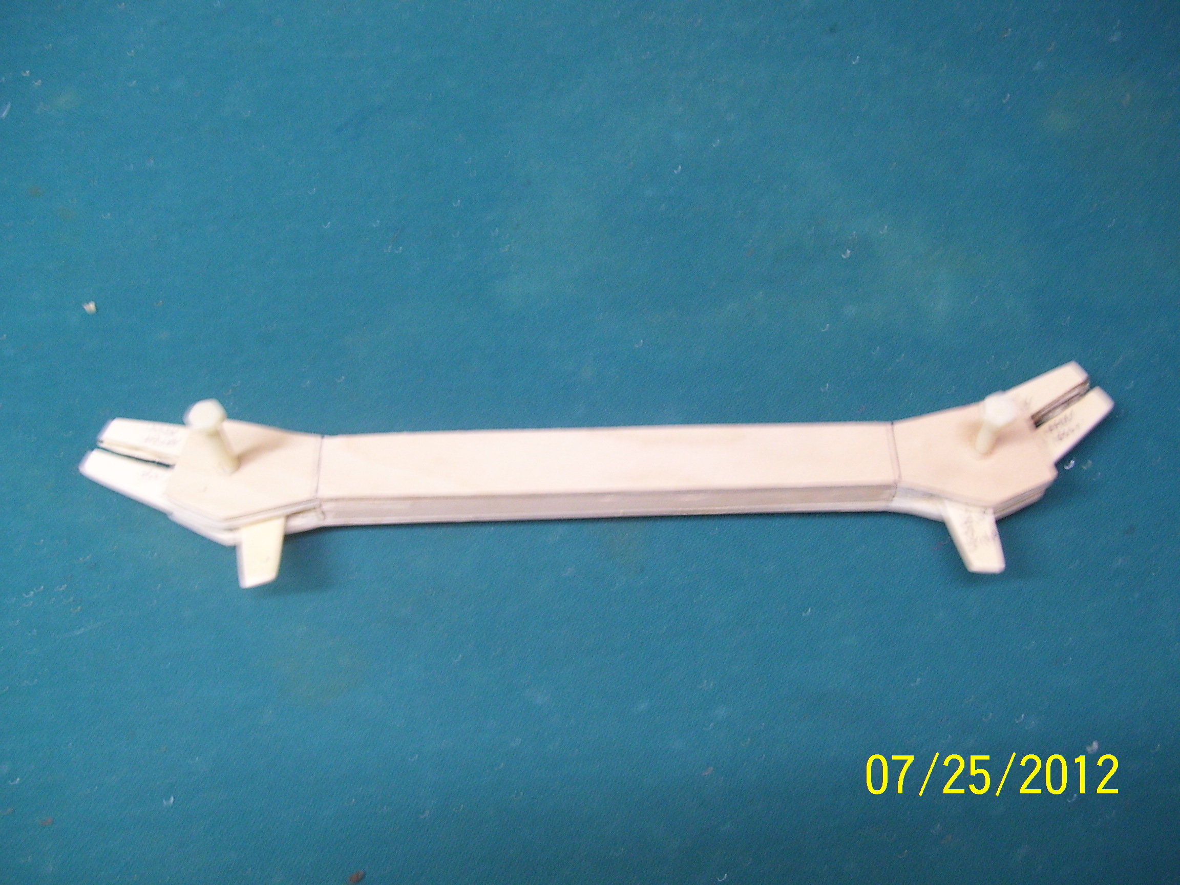

    I have the wing sweep mechanism built and now I have to put the push rods on it.
    Will download the photos of it as soon as I can get my camera working.
    Sounds good Gary I will move this into the scratch built section
  5. rescue911
    418
    earth

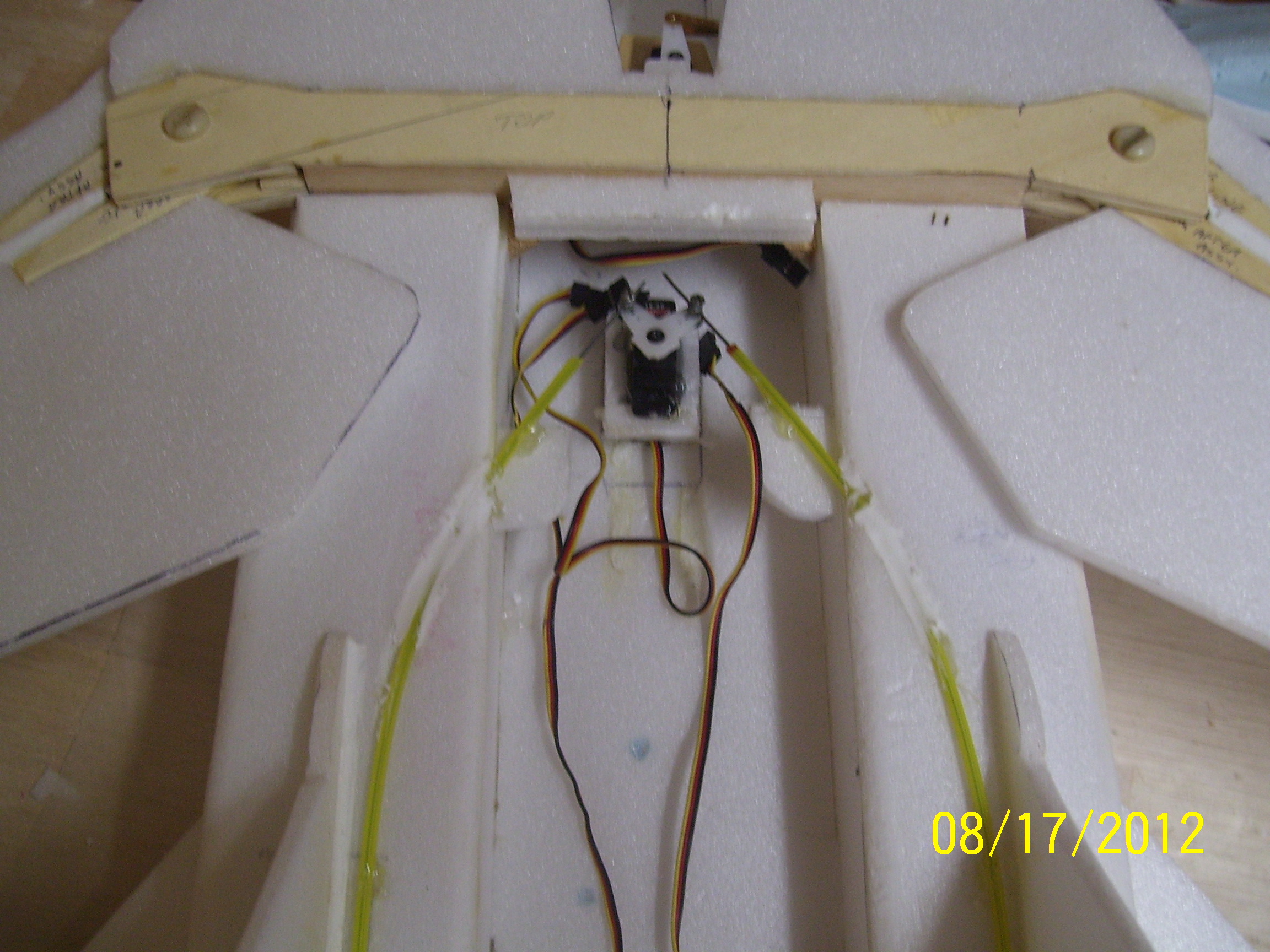

    Swing Arm is ready for the push rods.
    Wow going together quick. Looks great

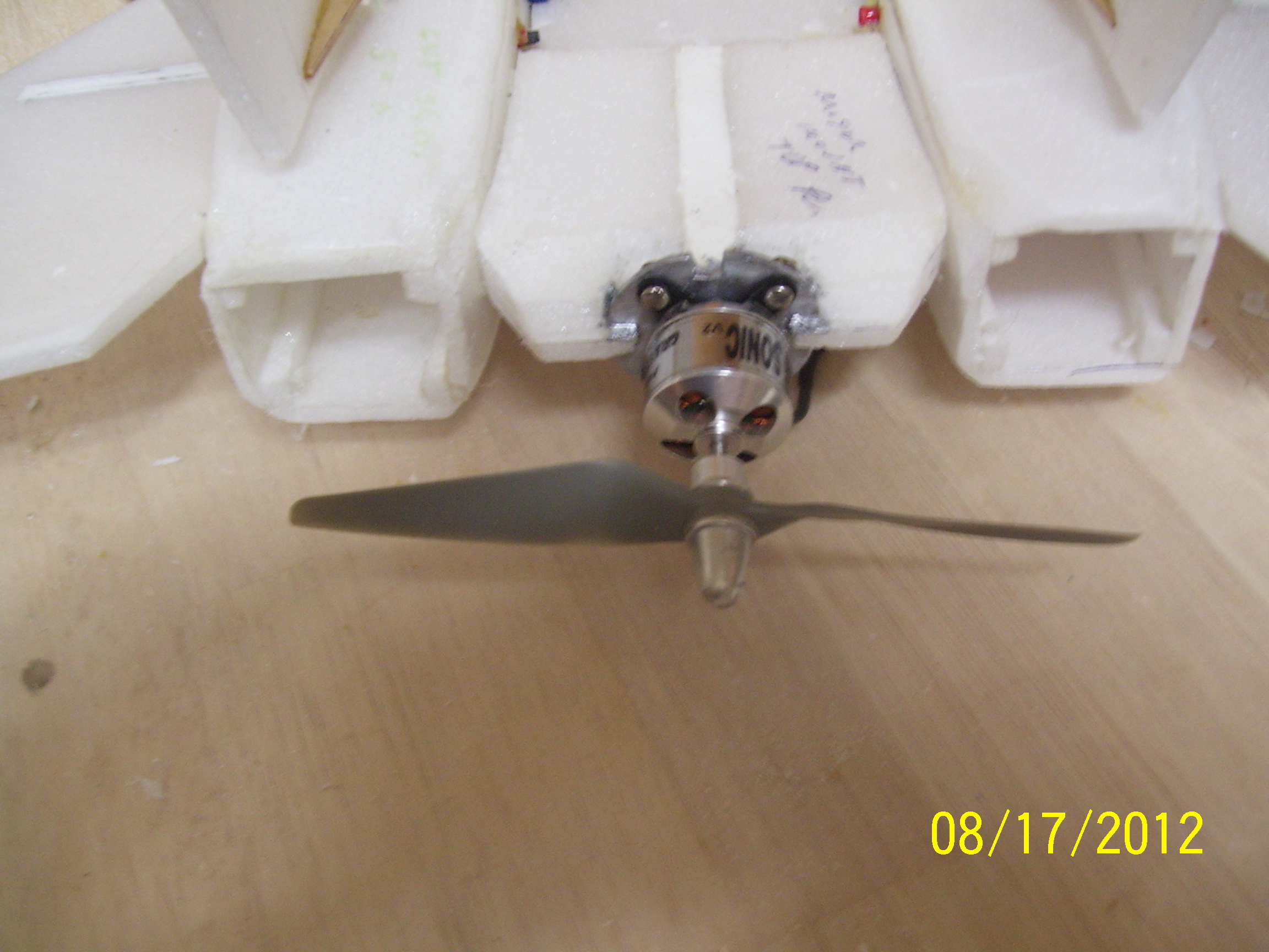

    I put a Hobbico High speed micro servo C5-12 to test with.
    The plans call for a Hitec HS-81MG servo.
    I have a HS-81 that I can use ,but I have to rip it out of my Mig-29 to use it.
    If the C5 will work I will leave it in there.
  11. rescue911
    418
    earth
    Normal set up is.
    Himax 2015-4100 brushless motor.(Inrunner)
    4.4 Gearing
    APC 9x7.5 Prop
    Speed of about 50-55MPH
    High speed- set up
    Himax - 2025-5300 brushless motor.(Inrunner)
    2100 mAh 11.1 v Lipo
    APC 7x6 Prop
    25 amp ESC
    Will pull about 20 amps.
    About 70mph
    These are the setups that Steve Shumate posted for his.
    I do not have an inrunner motor,so I hope the 400 size outrunner will work.
    It is a park jet motor. :think:

    Forward strake is on now and going to start on the servo's for the elevons and rudder ,before I can put the rear strake pieces on it.
  14. rescue911
    418
    earth

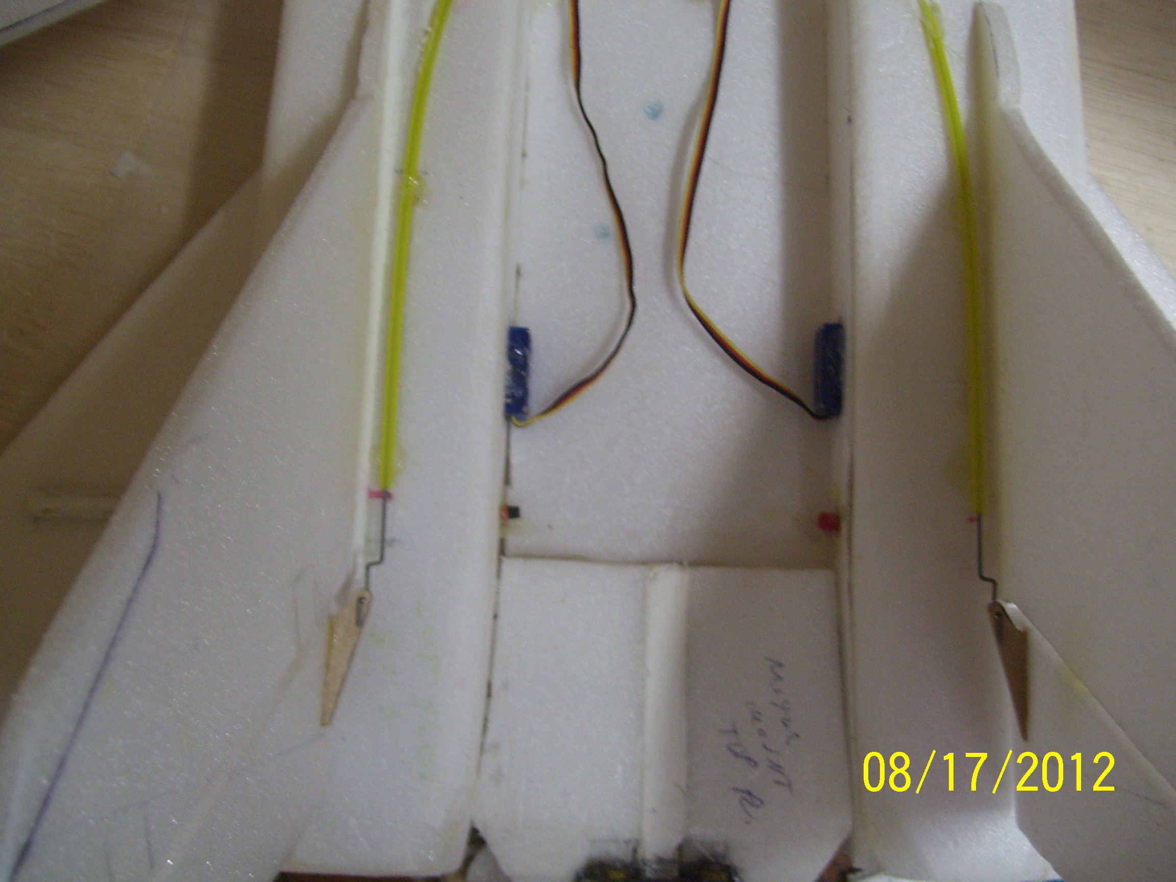

    Installed elevon servos,rudder servo and motor mounted.

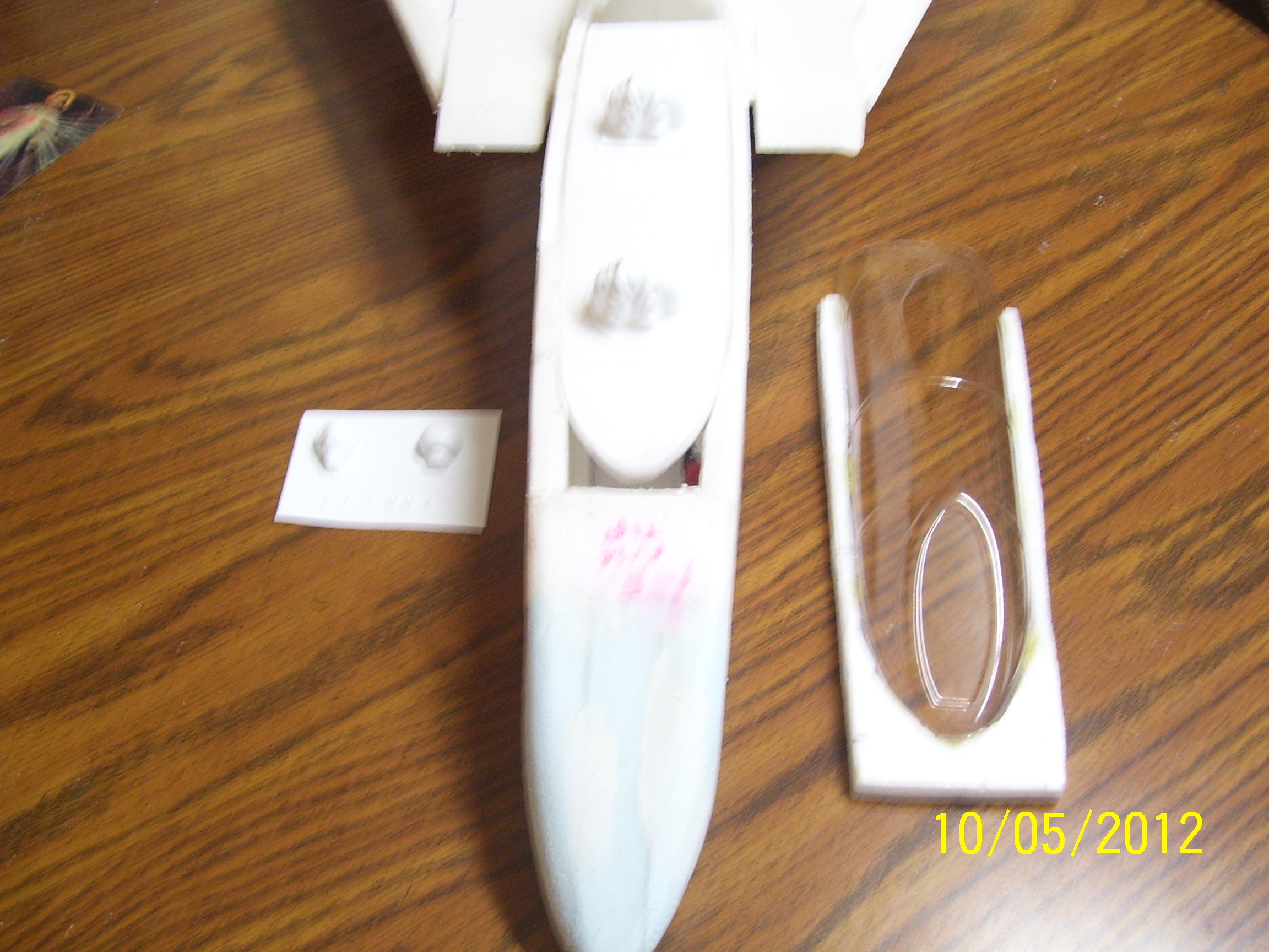

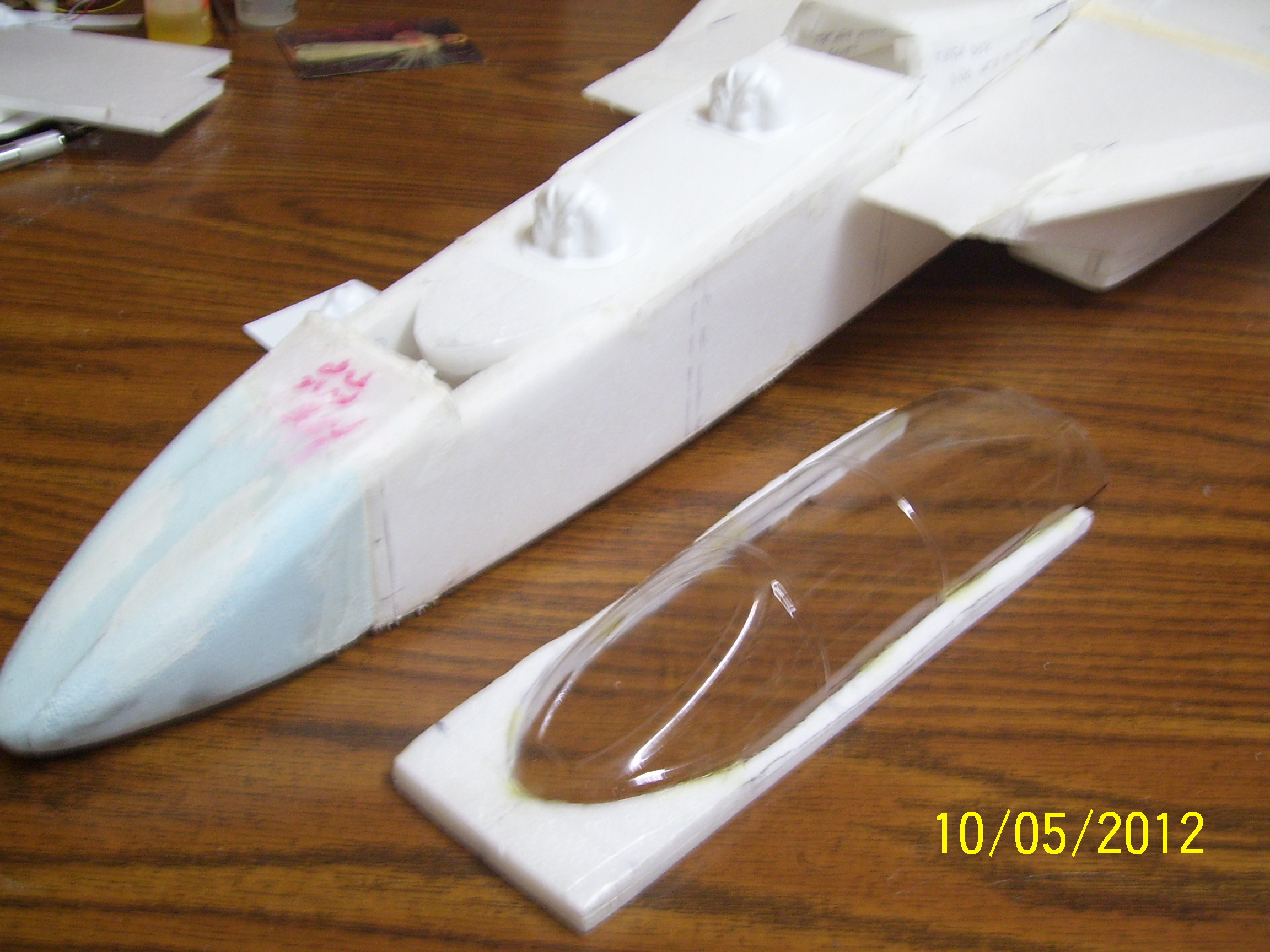

    Building the Canopy and pilates.

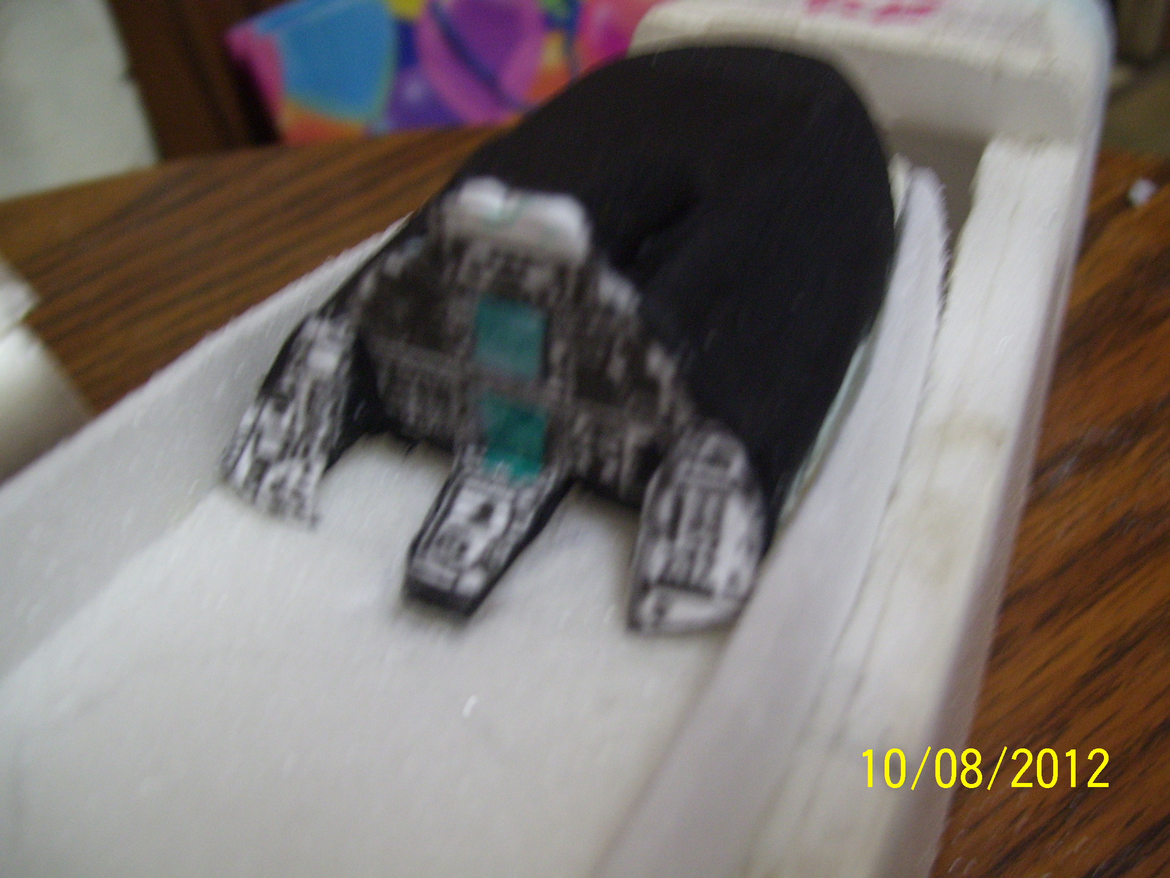

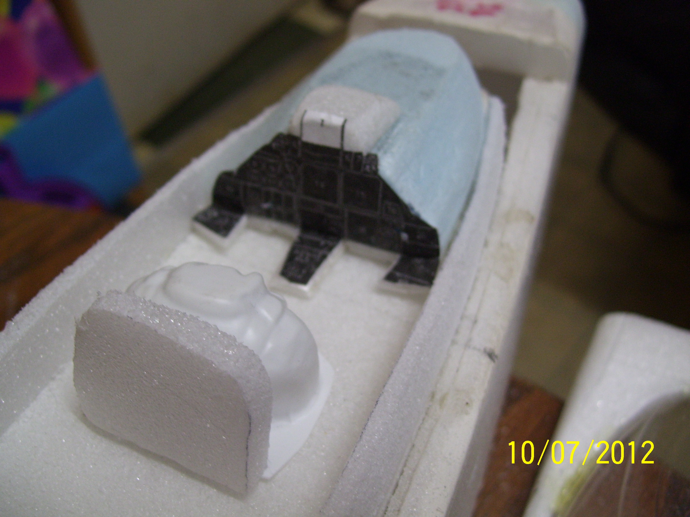

    The forward console is almost ready for paint.

  20. rescue911
    418
    earth
    I will do some of them.

    This is the front console and it is almost finished.
    The picture is a little blurry. Attached files [​IMG]
