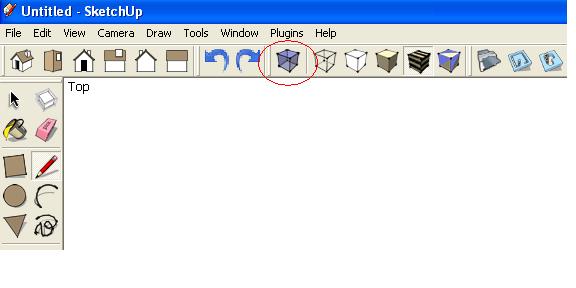

    how do i make them transparent though?
  18. TigerPilot
    If you don't see that part in your tool bar than go to 'view/Toolbars/Face Style' and click on it. Attached files [​IMG]
