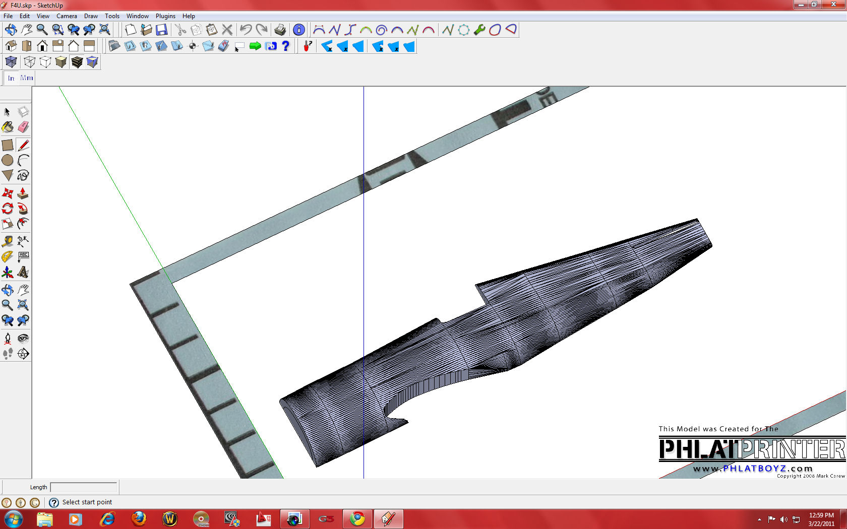

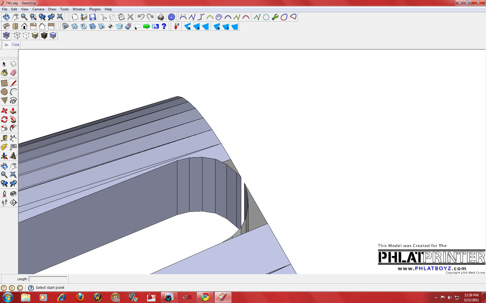

    I am working on a fuselage in 3-D but am having problems getting some faces around where the rear horizontal wing goes, I am posting the file to see if anyone has an idea on how to get a face made there,
    Attached files F4U.skp (2.3 MB)Â [​IMG] [​IMG]

    I was having Problems also with the little ones. I have a Create Face utility ruby that I got from somewhere not sure where. It did the trick here it is back. :good: I did notice that there were extra lines all over the place you might want to turn on show hidden gemotory "sp?" I deleted them in my fix.
    The Plane Looks Great :doubleup:
    E-T Attached files F4U E-T fix.skp (2.3 MB)Â F4U E-Tslice.skp (2.3 MB)Â
