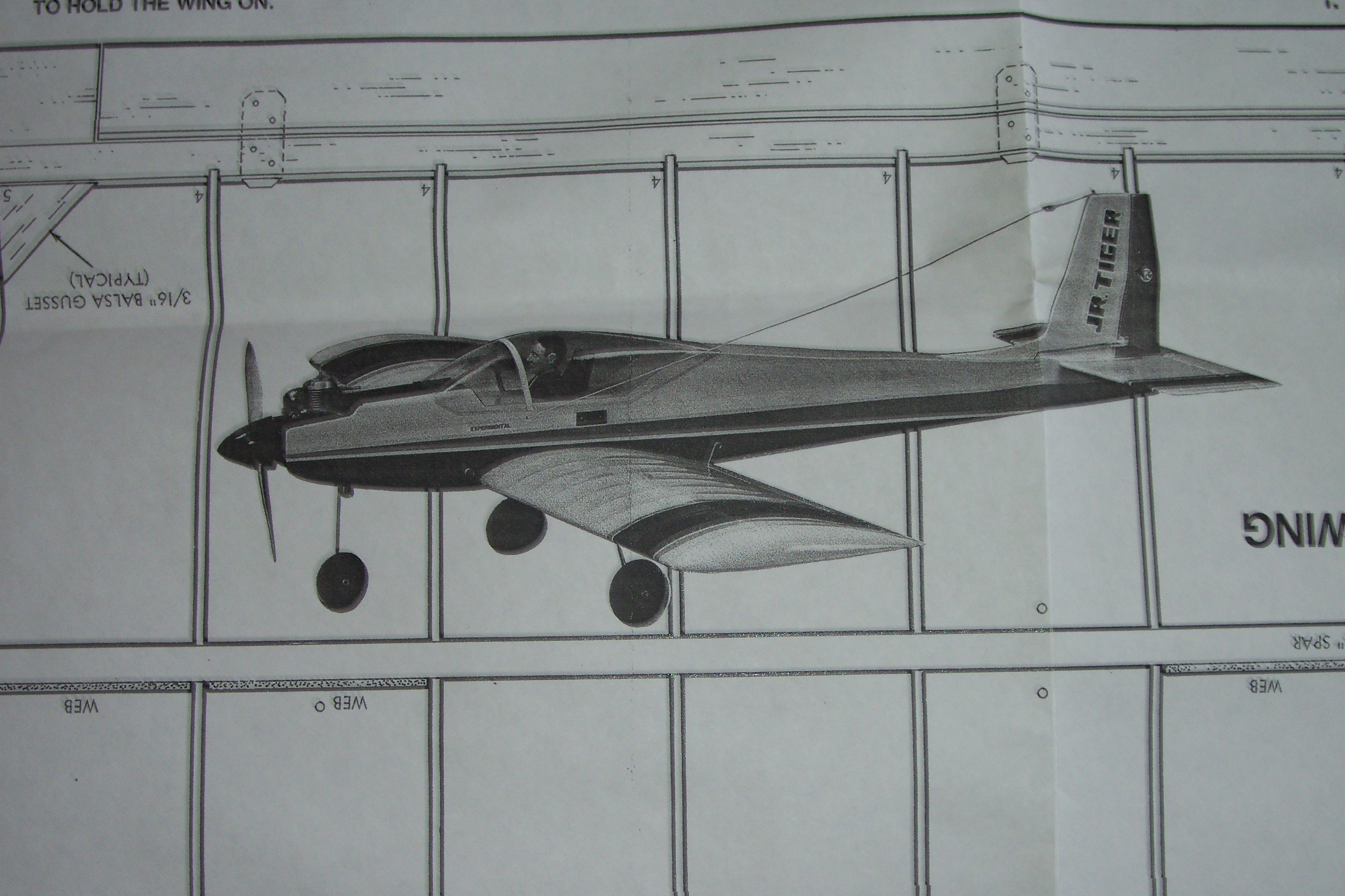

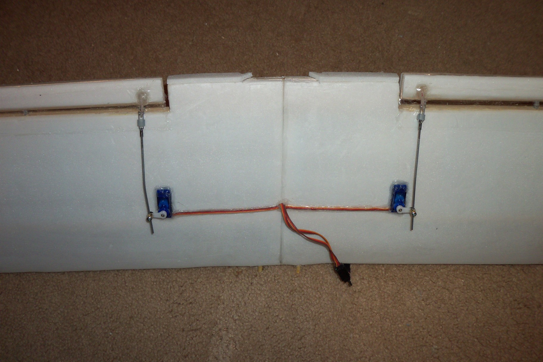

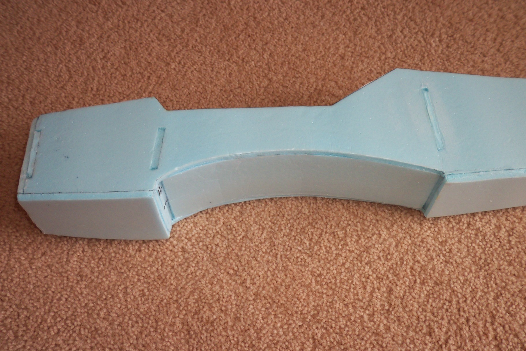

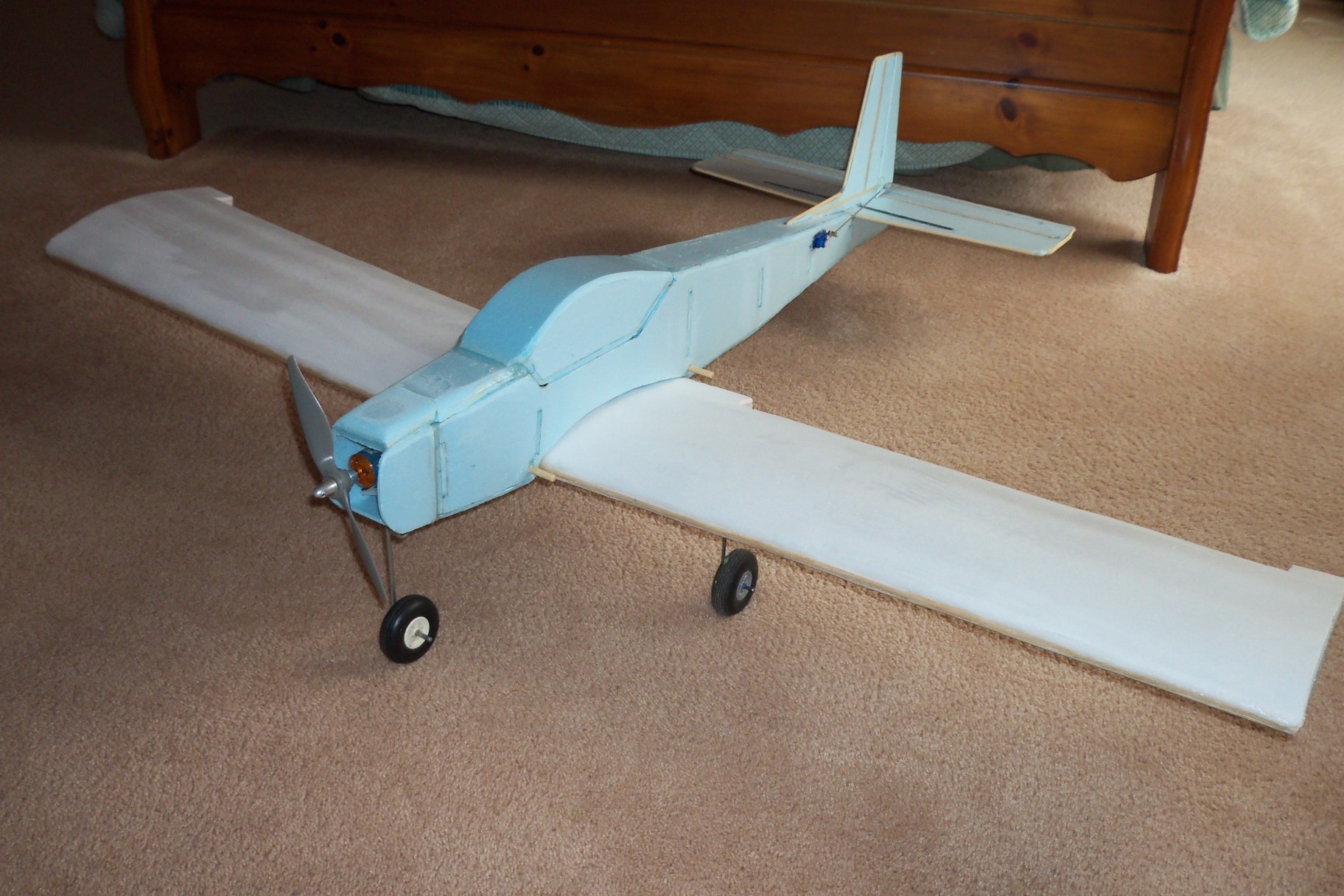

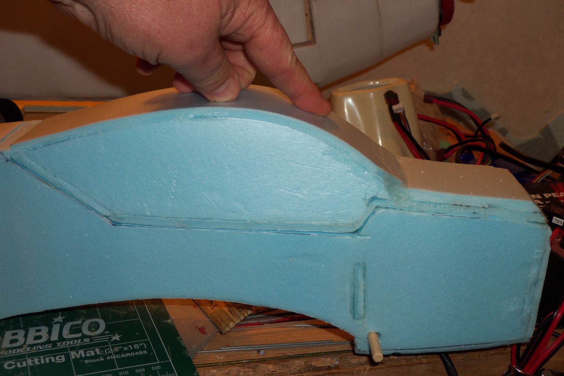

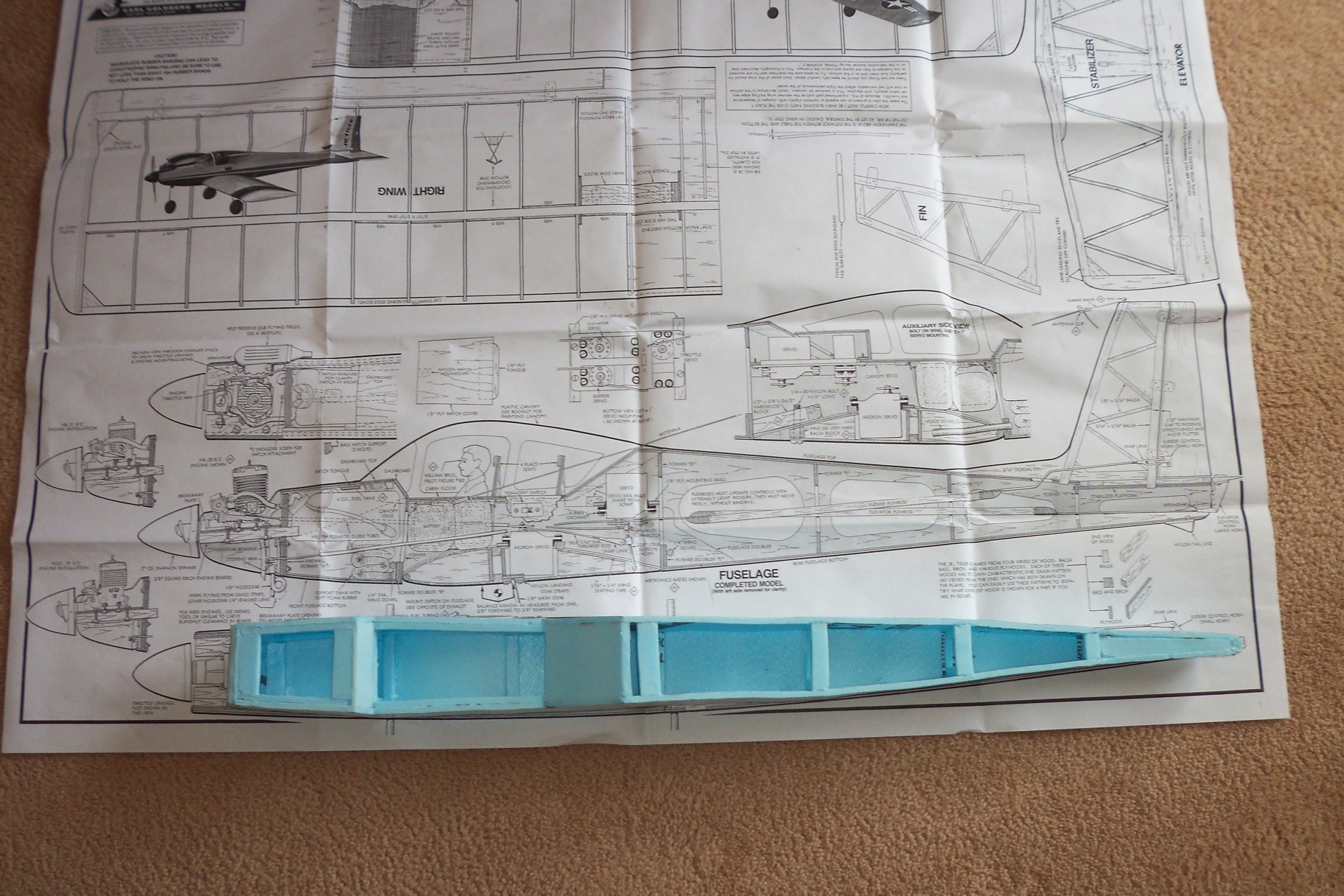

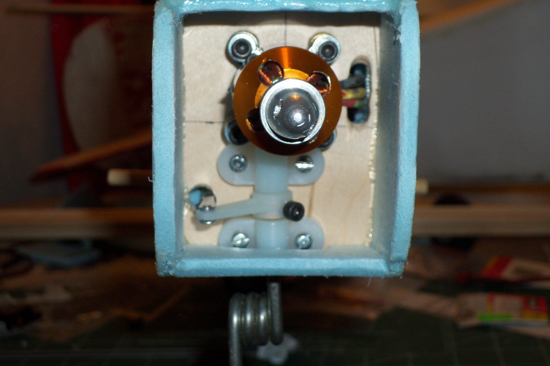

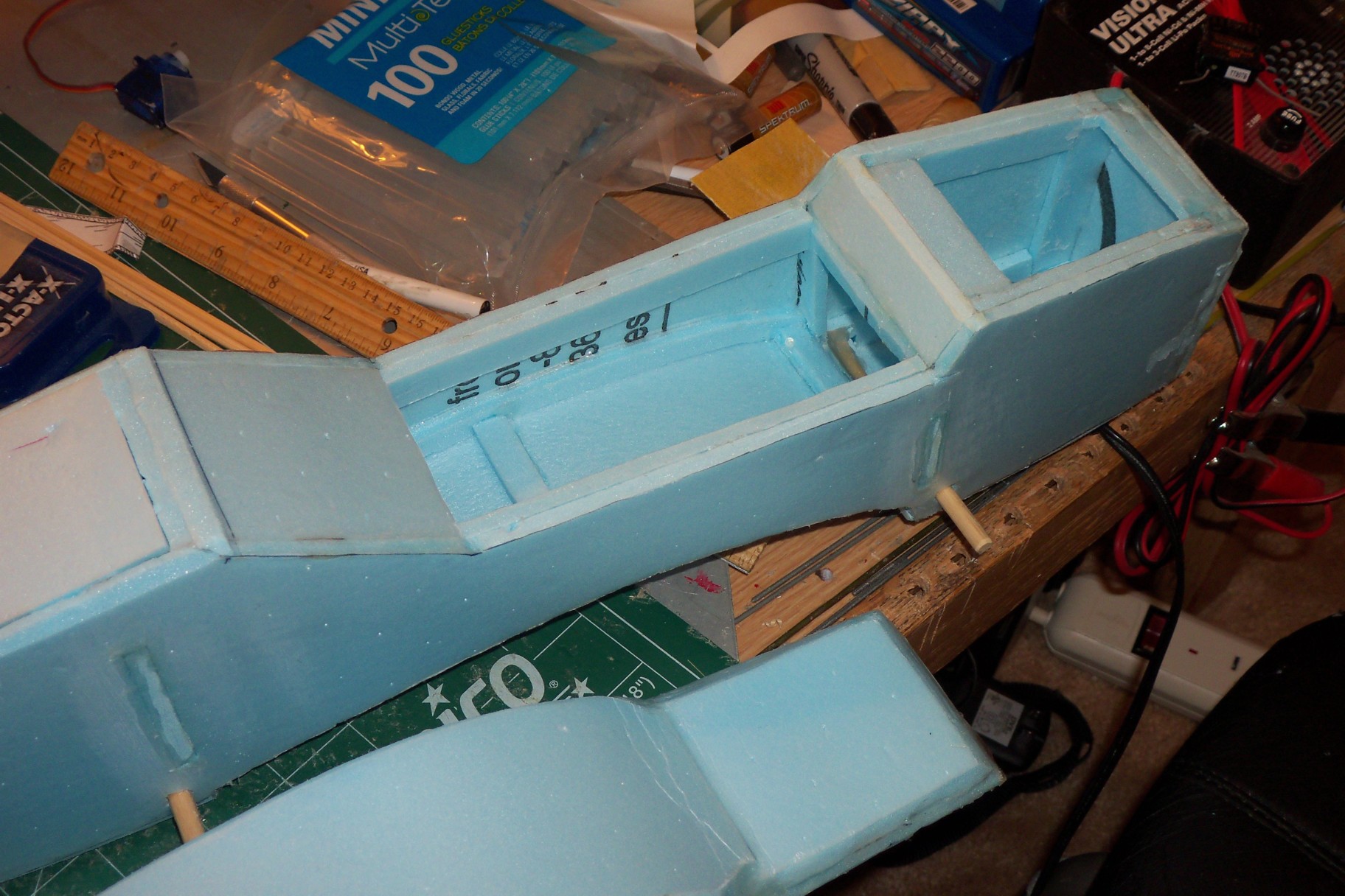

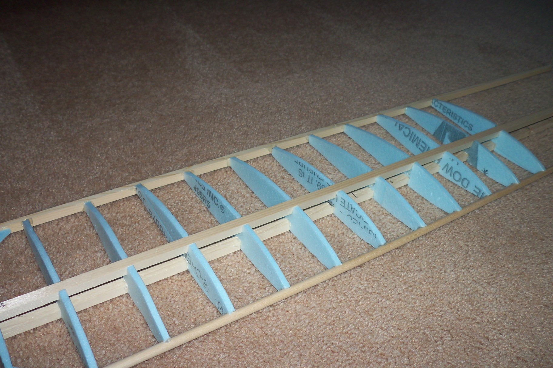

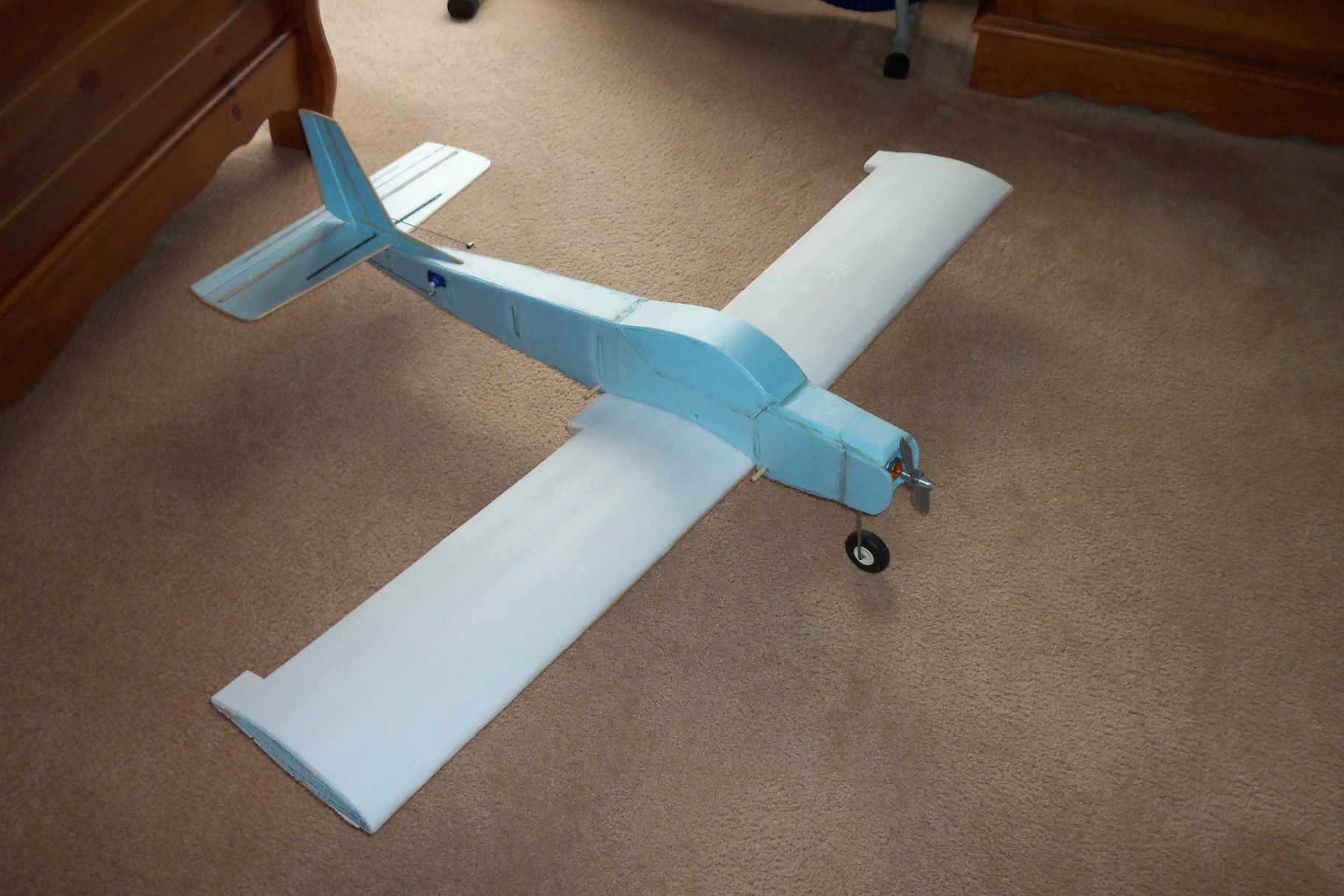

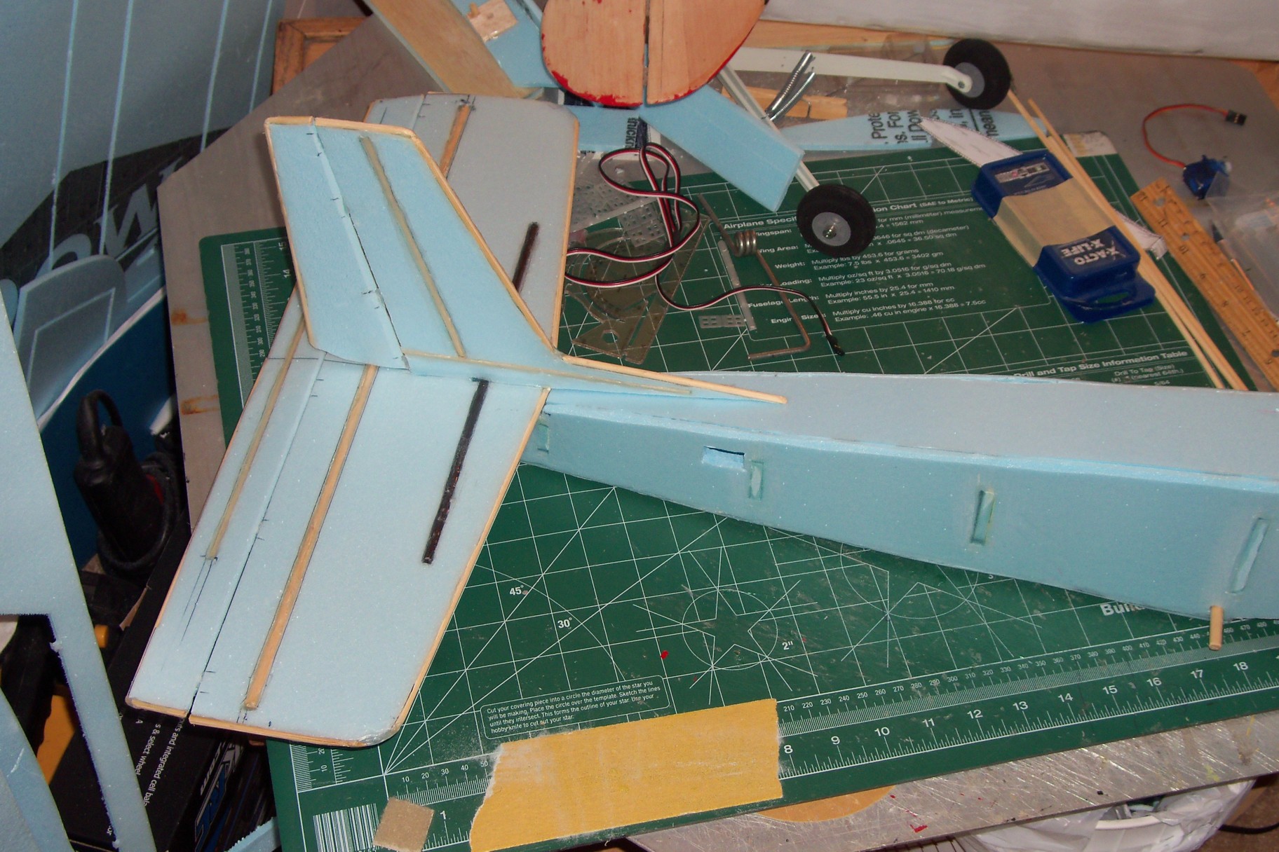

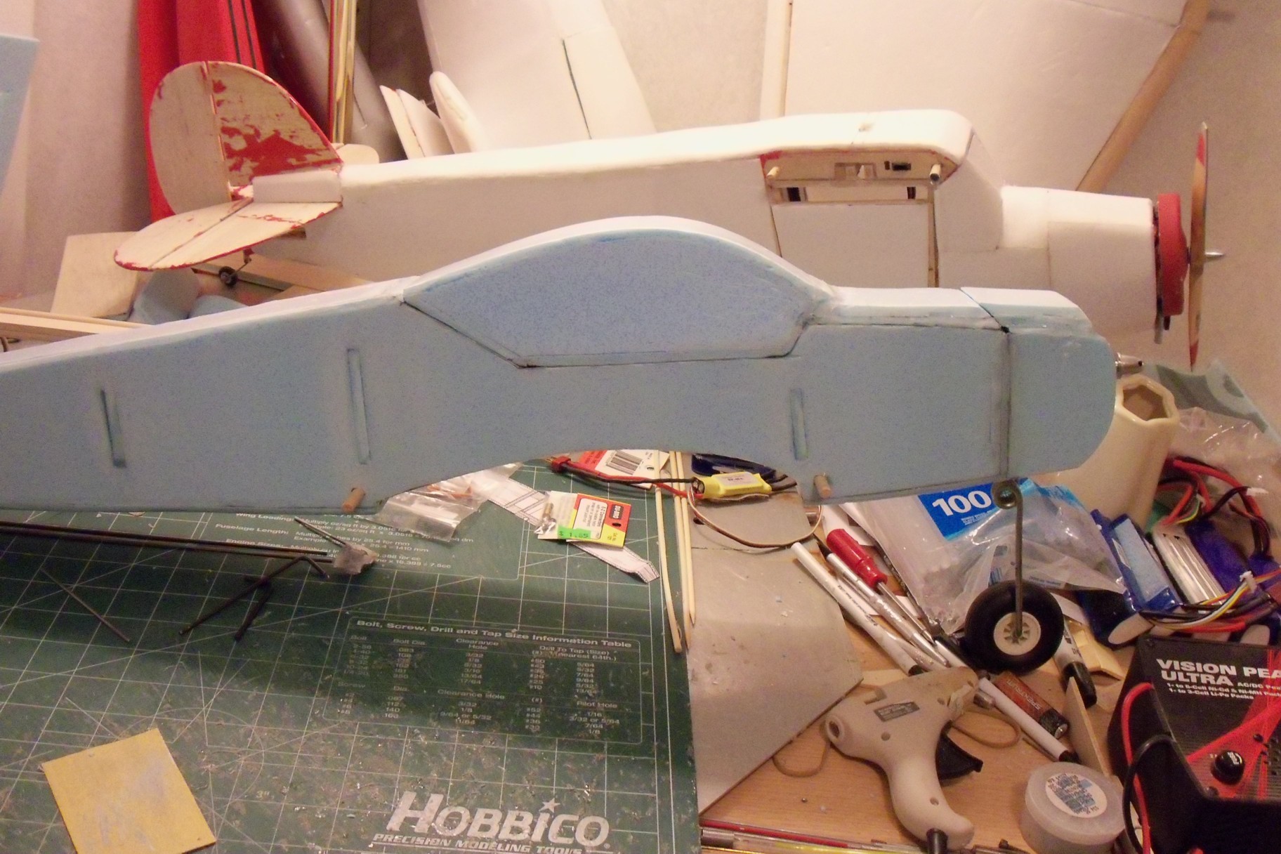

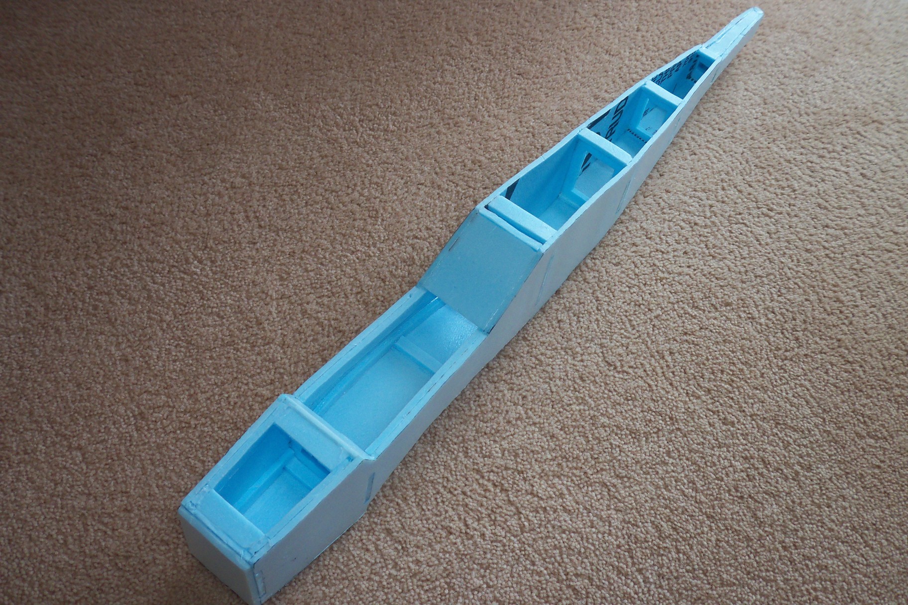

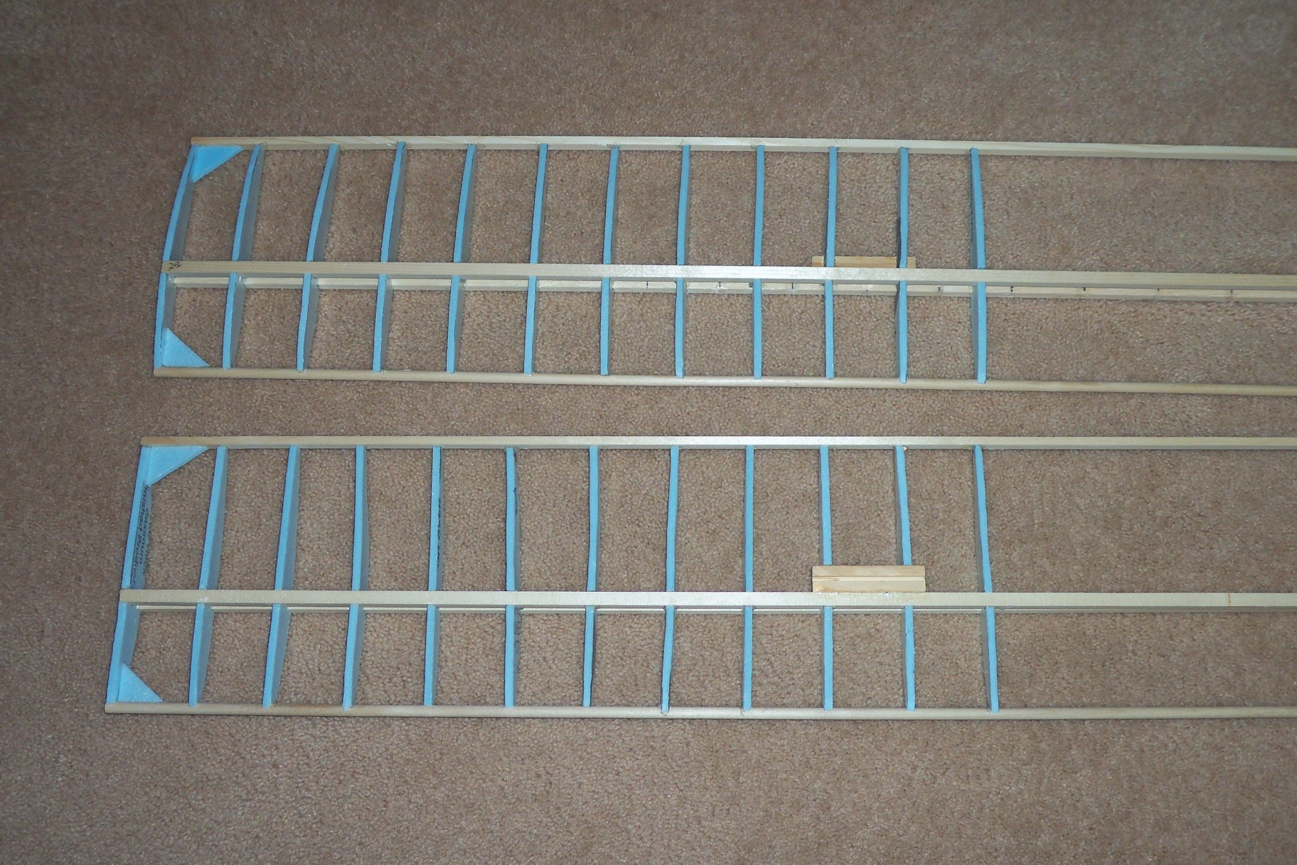

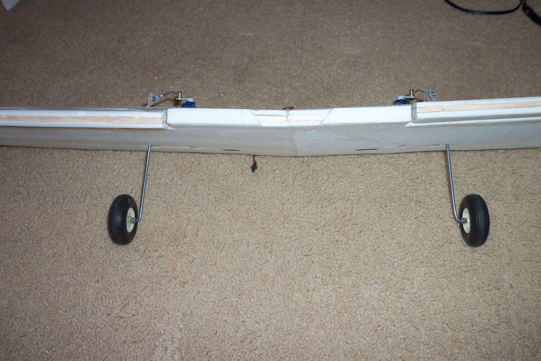

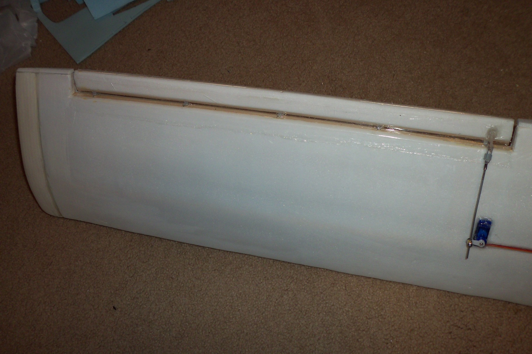

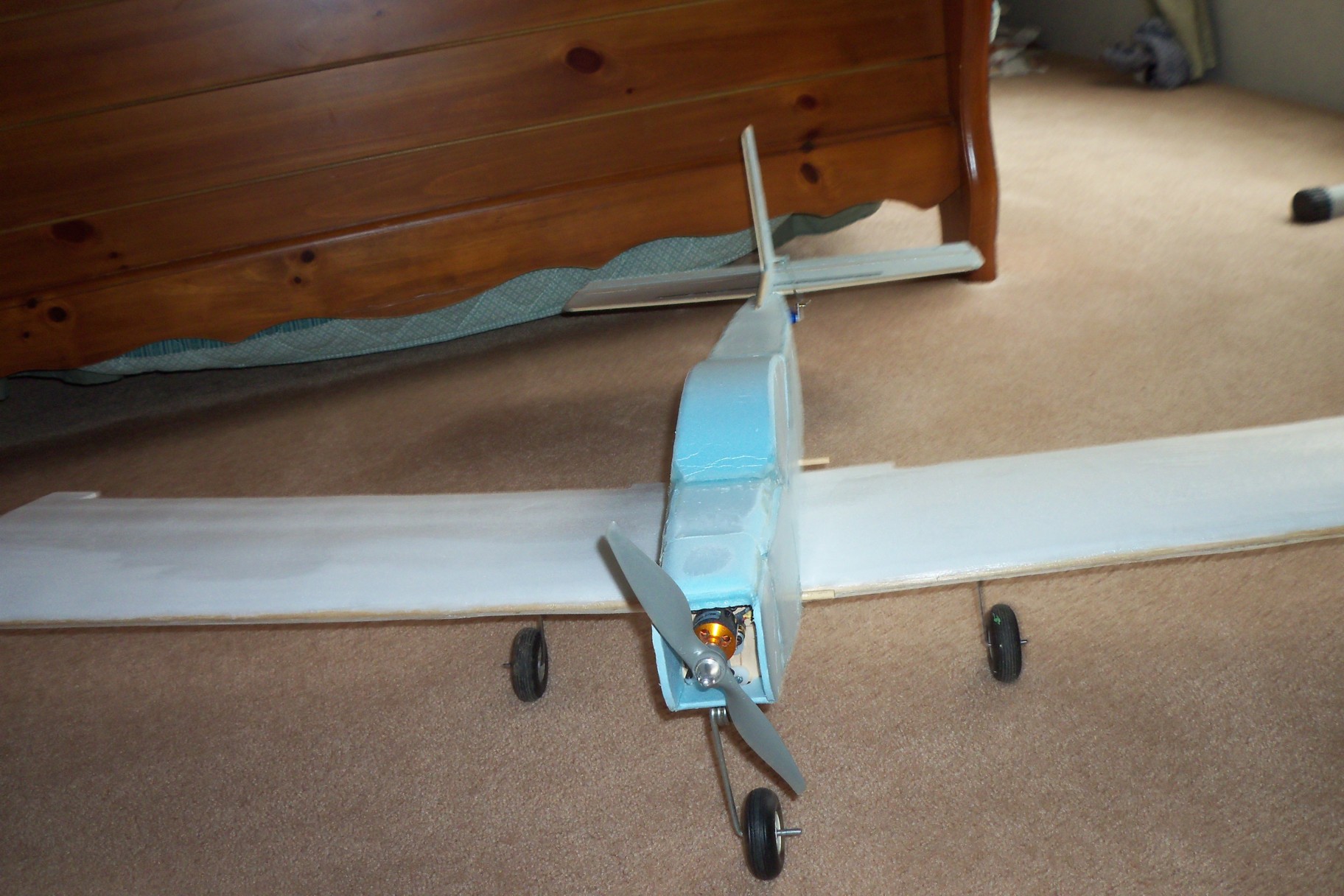

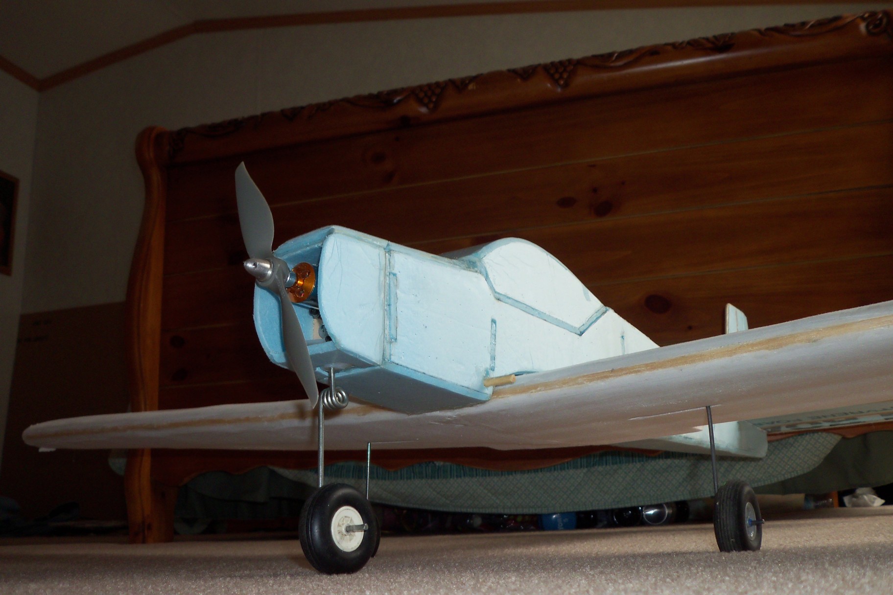

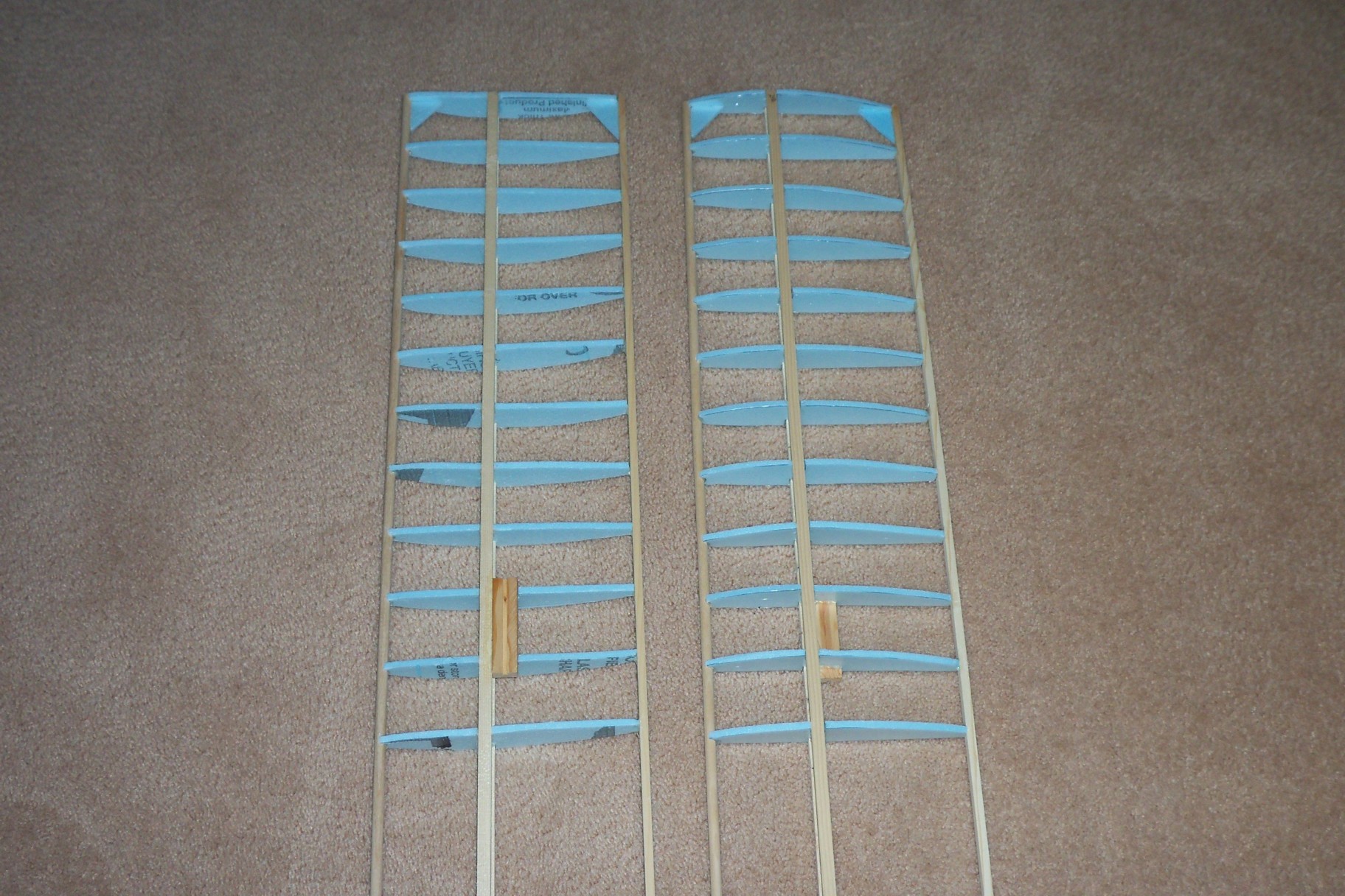

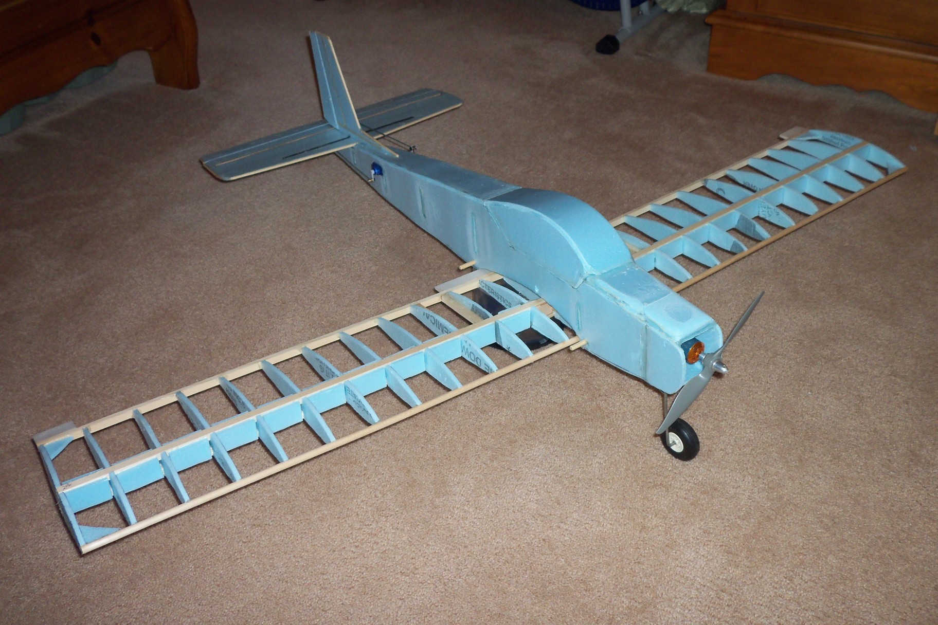

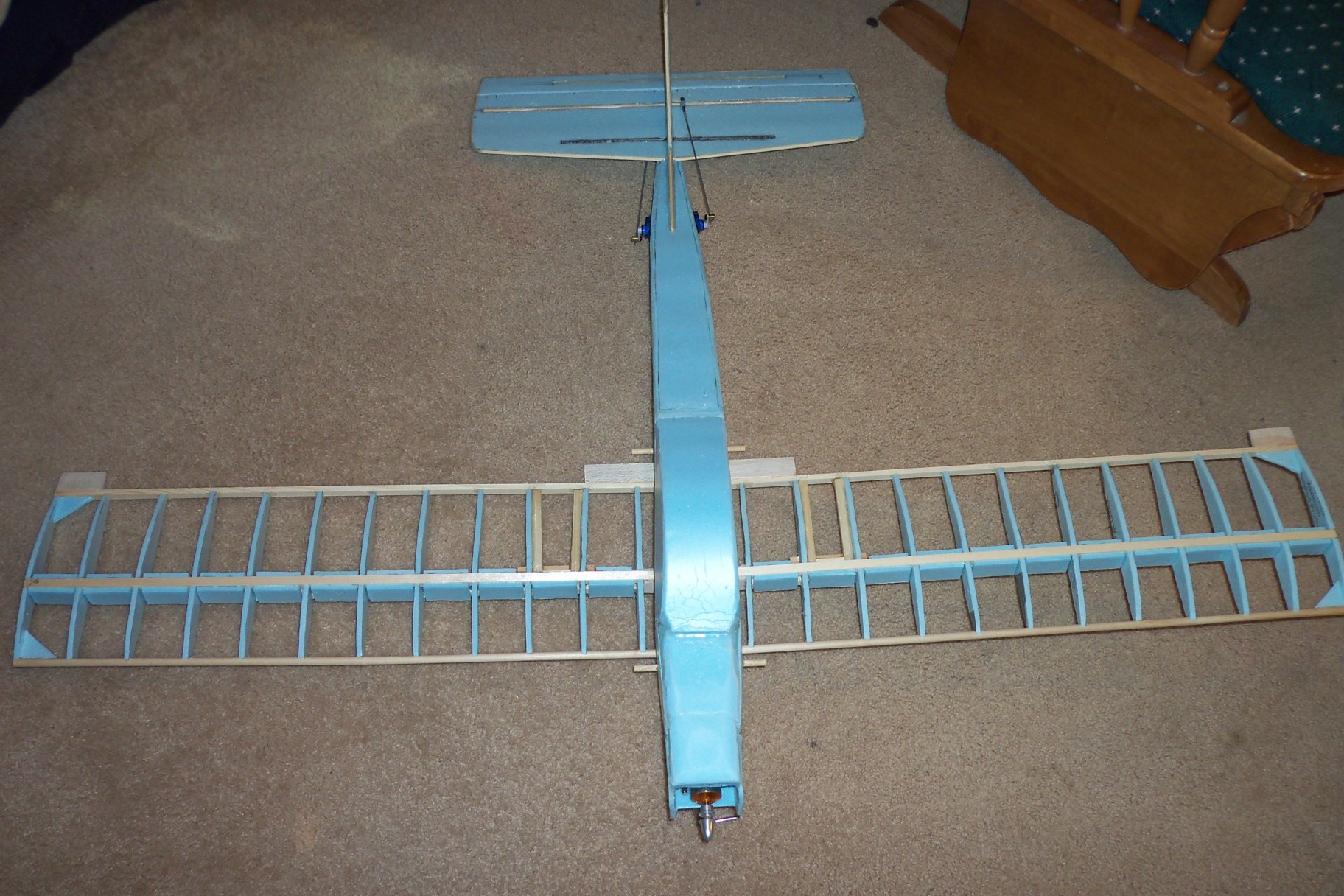

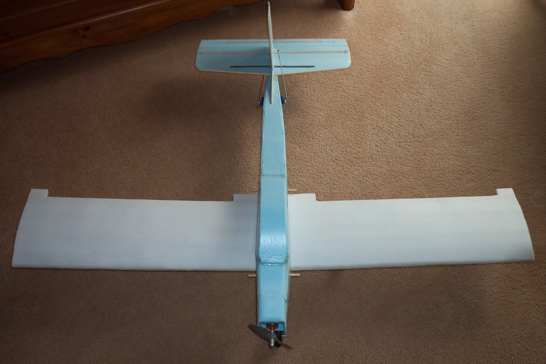

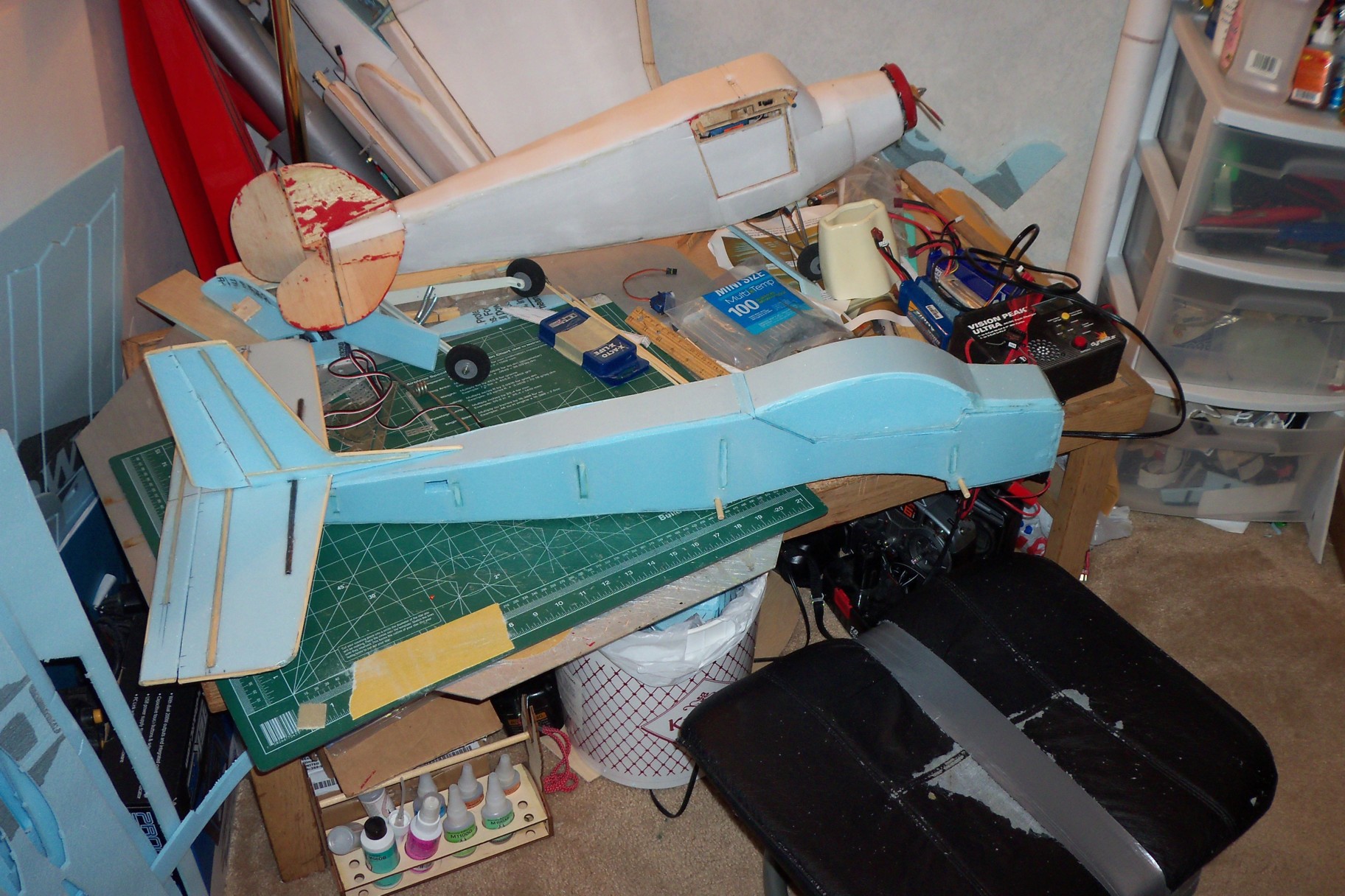

    Started another plane... as if I did not have enough. It is a foam copy of the popular Carl Goldberg "Jr. Tiger". This one is all hand cut, sorry no phlatprinter on this one. Just about ready for it's first attempt at flight, Balancing and taxi testing first and if the weather continues to be nice... The maiden flight.

    Nice job mudman. Cutting all of those parts by hand must have been a labor of love. Hope it flies as good as it looks!
  3. kram242
    Beautiful work Lee! This is going to be a great flying plane just by the looks of it.
    Great job bro :doubleup:
  4. 7up
    7up Moderator Staff Member
    1,090
    Kentucky
    Great building job! :doubleup: Good luck with the maiden.
  5. rcav8r
    rcav8r Moderator Staff Member
    1,193
    Looks good. Once of the best flying planes I had was an old Tiger II. Kit, not the ARF. The ARF weighed too much and was VERY noticeable when comparing the way they 2 of them flew. I always wanted to do an electric specific one.
  6. TigerPilot
    1,576
    Man, after seeing these pics I so have to find a place where I can use a plane with wheels. :girl_cray2:
    I can't believe you've cut this all by hand. Talk about masochism. :fugly: Did you find it to weigh any less than the all balsa one? I take it it was less expensive, though. :dance3:
  7. rcav8r
    1,193
    NOt sure of the WS on this one; what is it?
    I know from my experience, that I hit a point of diminishing returns for foam/vs traditional construction weight wise. I built a Kadet Sr. from foam, and the empty fuse is HEAVY. About twice as I can build from balsa; and this was before I glassed/painted it like I had planned. I abandoned the foam one, and hope to have a wooden one ready this season.
    Cheaper and easier, yep foam wins..... but not necessarily when it comes to weight.

    I remember my Old wood "Jr. Tiger" and it was heavy with the engine and gas tank and the large servos back then. This one is not too bad... I have not weighed it yet so we will see. I had to add about 6 ounces of lead to the nose to make it balance. I started painting it and used a metal flake acrylic spray paint and it did not turn out the way I had hoped it would. So it is still on the build table until I can redo it a bit... Mudman1959

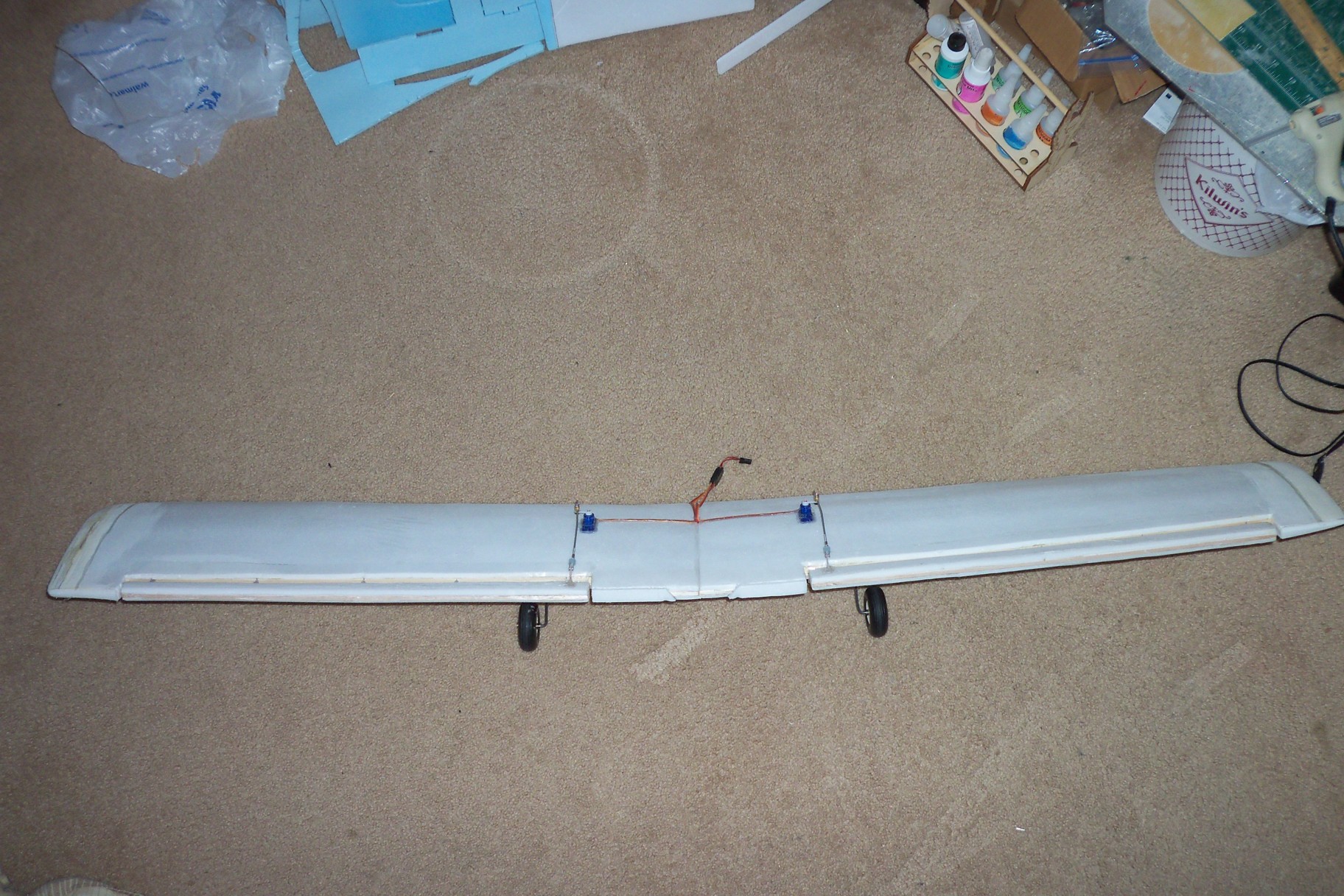

    Paint for the most part is done... here are some photos.

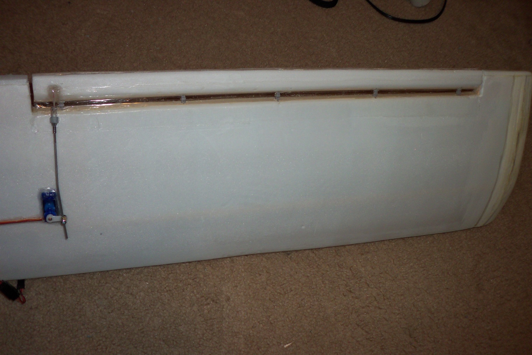

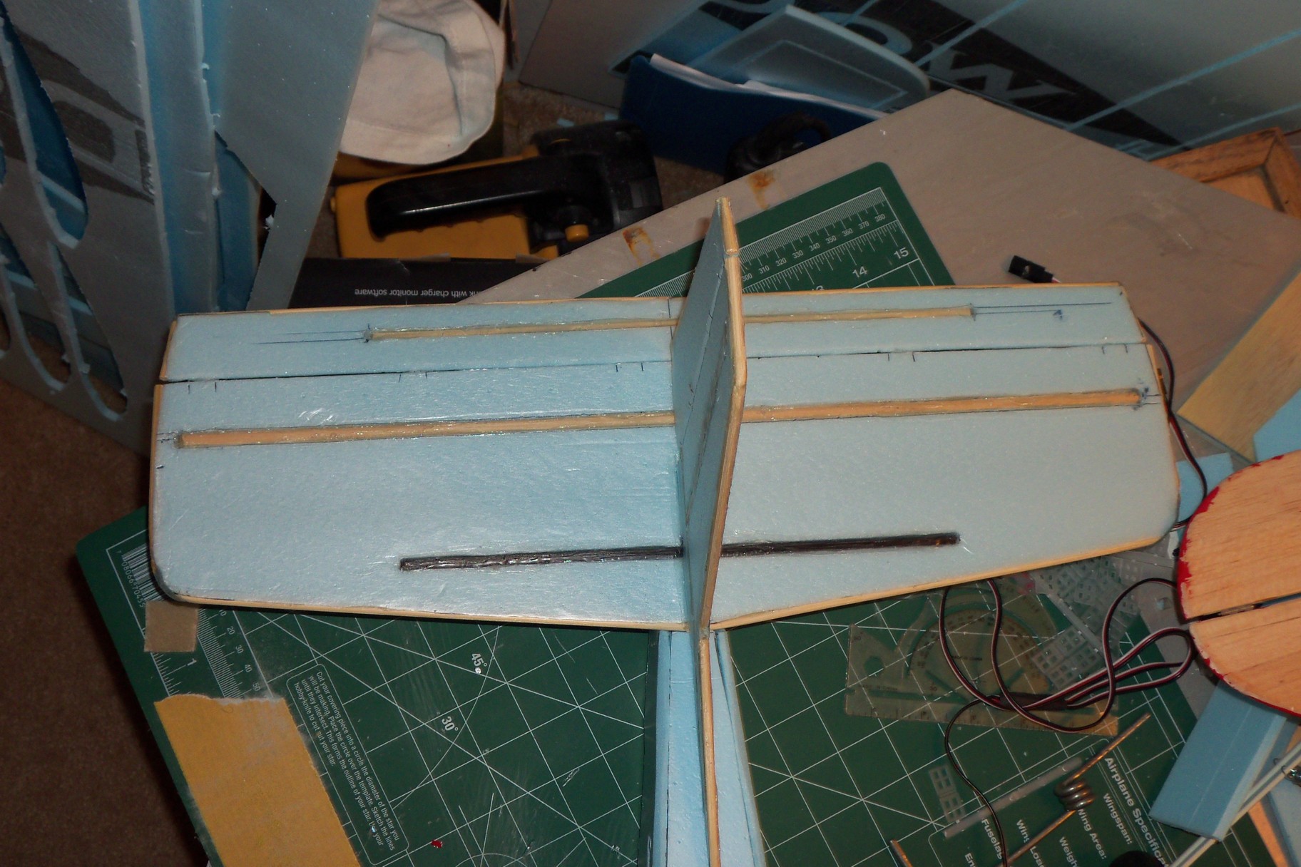

    What did ya sheet the wings with?

    rcav8r... I have not taken it into work to weigh it yet.... Maybe tomorrow. The wing is sheeted with the white Dollar Tree foam board with the paper removed. As for the Maiden flight... well still waiting for that too. I have been so busy with work by the time I get home all I want to do is sit down. I have some days off coming up soon so maybe then. I'll have to get the camera hat out and get a video of it before, during and what might be left after... :nervous:

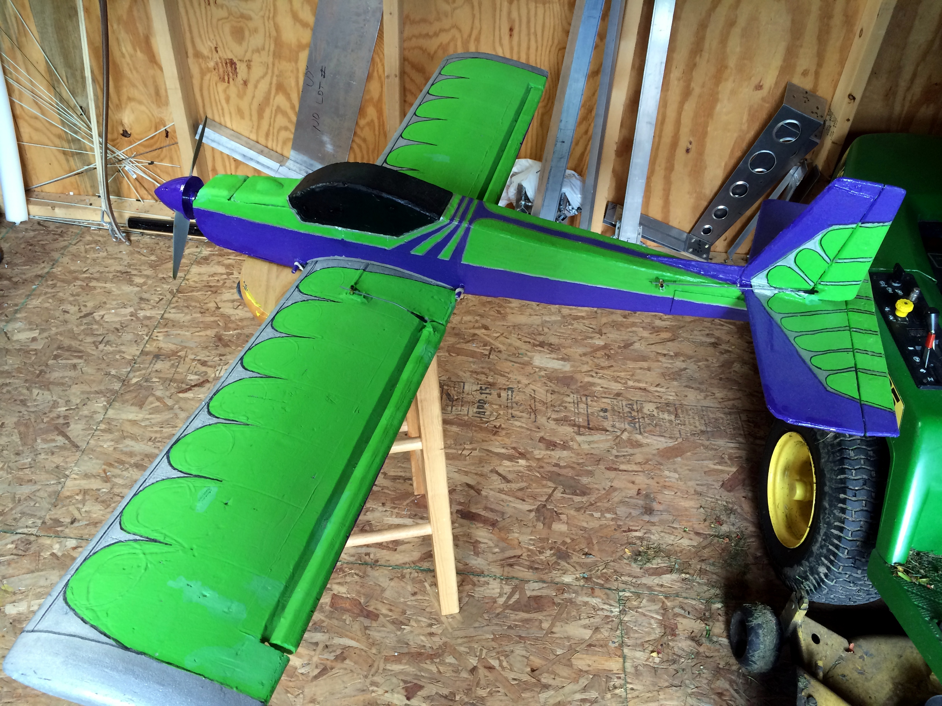

  15. mudman1959
    mudman1959 Member
    94
    8

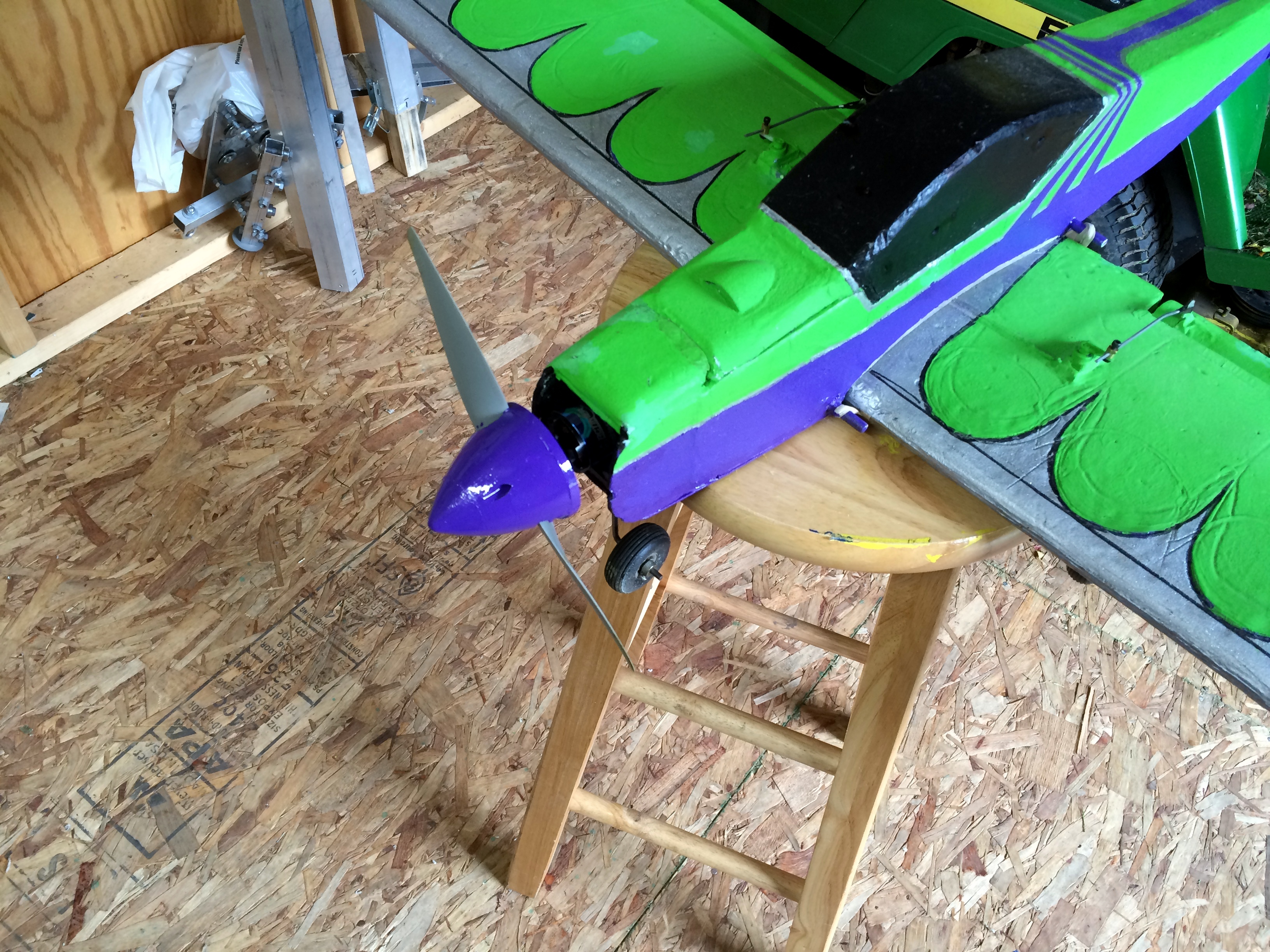

    Still alive and kicking!
  16. TigerPilot
    1,576
    Wow, who would have thunk it, after all these years. :doubleup:
  17. swarfer
    swarfer Moderator Staff Member
    803
    Grahamstown, South Africa
    wow indeed
