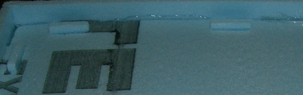

    This weeks project is a lightbox. A lightbox is basically a rectangle cabinet that has a light source inside and a plastic or glass surface that emits diffuse light. They are used for pattern tracing by placing the pattern against the diffuser and then laying the target medium over the top.

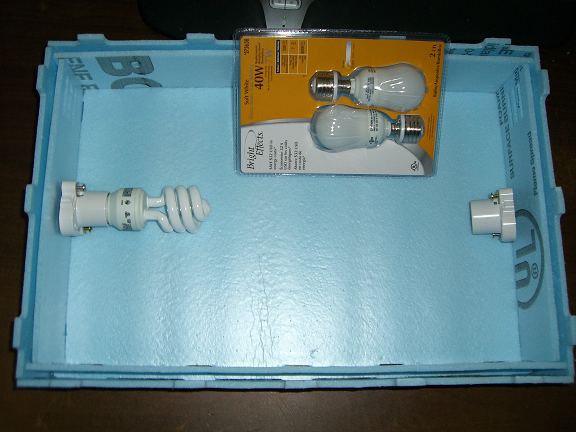

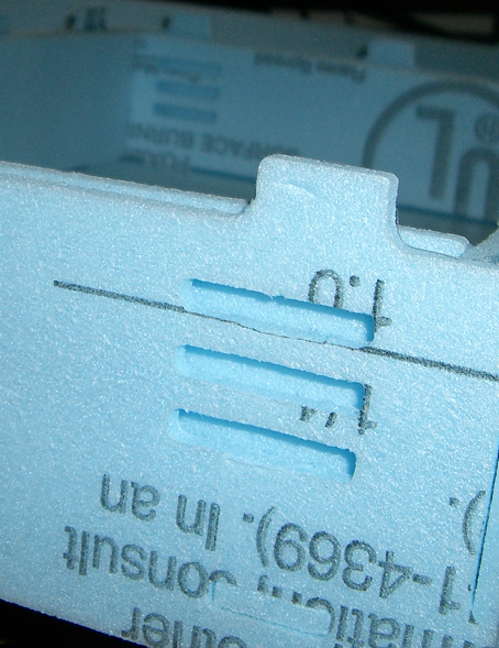

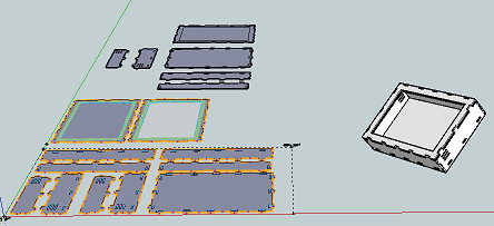

    I started, as usual, by making a basic drawing in SU of how I want it to work. The design needed to include a way to attach an optional foot that will tilt the box and some passive ventilation with the idea that a small fan could be added if needed. I intend to use a pair of CFL bulbs but this may change to tubes after seeing the results.
    Here are some pics of the foam mock up and a screen shot from SU. I will be posting the actual skp file after I have completed the project.

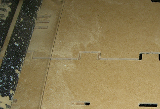

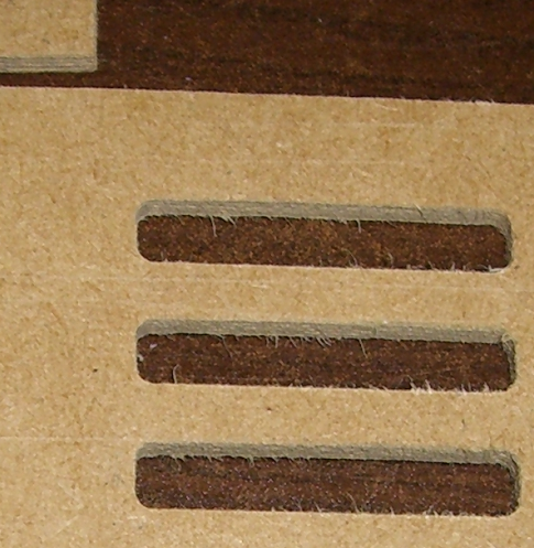

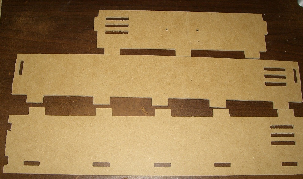

    I started cutting the 1/4" MDF today. I only finished 6 of the 11 parts but it took a couple of hours to complete the cutting. I used the 1/8" fishtail chipper available in the PhlatBoyz bit kit.

  12. ewo
    That Is awsome. I will find some mdf from some where if i have to drive 100 miles
    How many passes to make a cut ?
  13. gasmasher
    gasmasher New Member
    402
    Atlanta, GA
    Thanks guys. It only took 5 passes but the last one was just for cleanup. The param box was set for 1/4" material with 105% overcut and 1/16" mulitpass depth. I cut those parts at 24 ipm but plan to finish the rest at 20 ipm. I have a huge pocket in two parts the plexi will fit in that I may get to tonight if it isn't too noisy.

    I am wondering about this
    Is it the inside box that tilts?
  18. gasmasher
    402
    Atlanta, GA
    No, there is going to be a rectange that fits within the lip on the bottom of the box. What looks like an inner box are paths for air to move through but stop light. They should also damp any fan noise if I have to add one.
