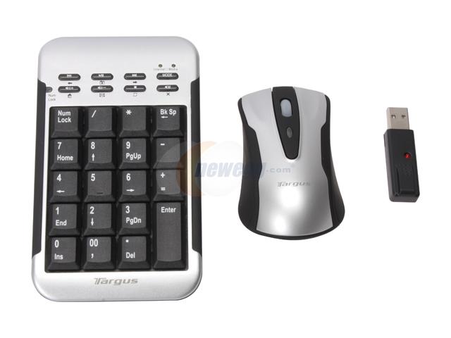

    You know, the ones like Mark connected and attached to his MKII. If you're among the first people to go here http://tinyurl.com/kj2w5c , you might get one for less than $10 shipped!
    If they're all gone, search for "Targus Numeric Keypad" w/ 2 USB Ports - they're listed elsewhere for just a little more $$ :D

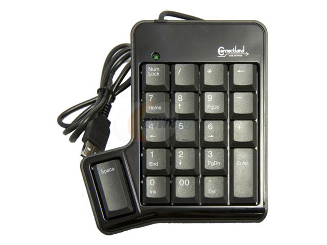

    I got my keypad today, played around with it, and have concluded it a bust. I just don't see a good future for it. The problem is windows sees it as the keyboard and not a seperate device. Dispite the fact that KeyGrabber list's the keypad as a HID device; KeyGrabber is looking for buttons in the "HID Keys" tab. And the keypad has no buttons.
    Another thing is that the KeyGrabber documentation, said that if you reassign a keyboard key then it's no longer available to any other program. And in fact you get a warning screen when you reassign a keyboard key. So it's probably best not to mess with a keypad, where you have to reassign keys. If you want to hack an entire usb keyboard, then that is fine, because all the the keys are there for you to use.
    Sorry Mark, but most likely you can't make the keypad a separate device, like you want to.
