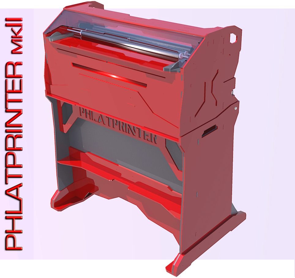

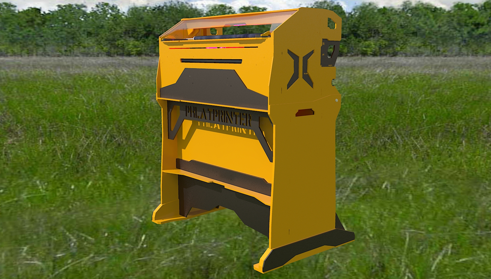

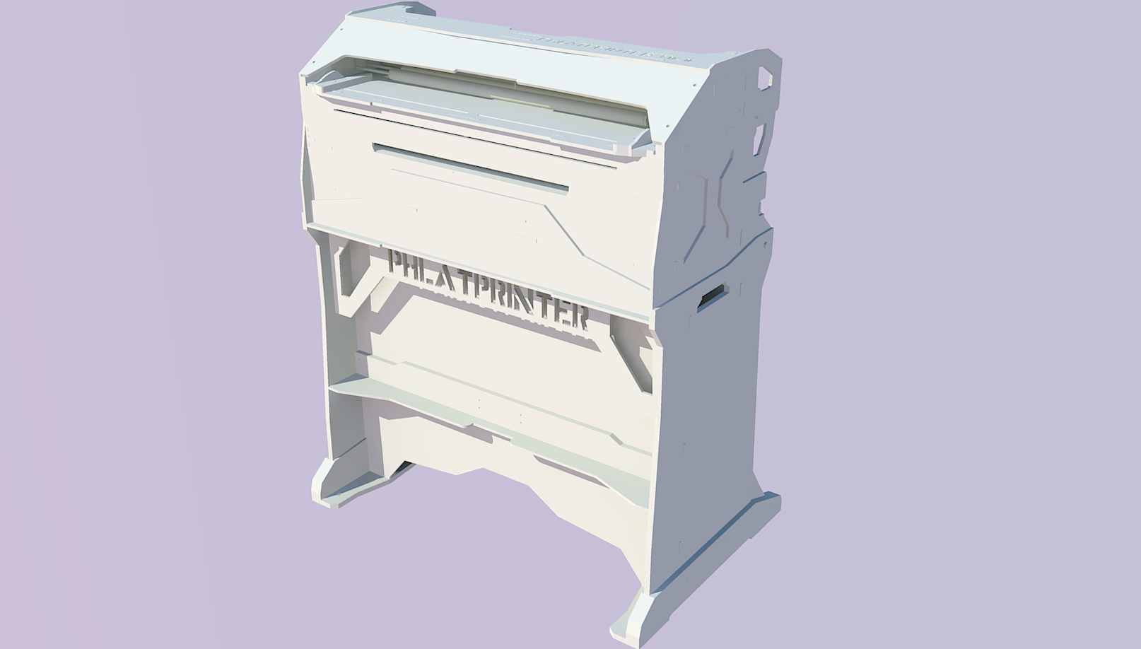

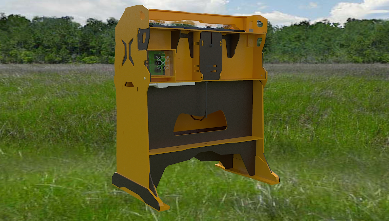

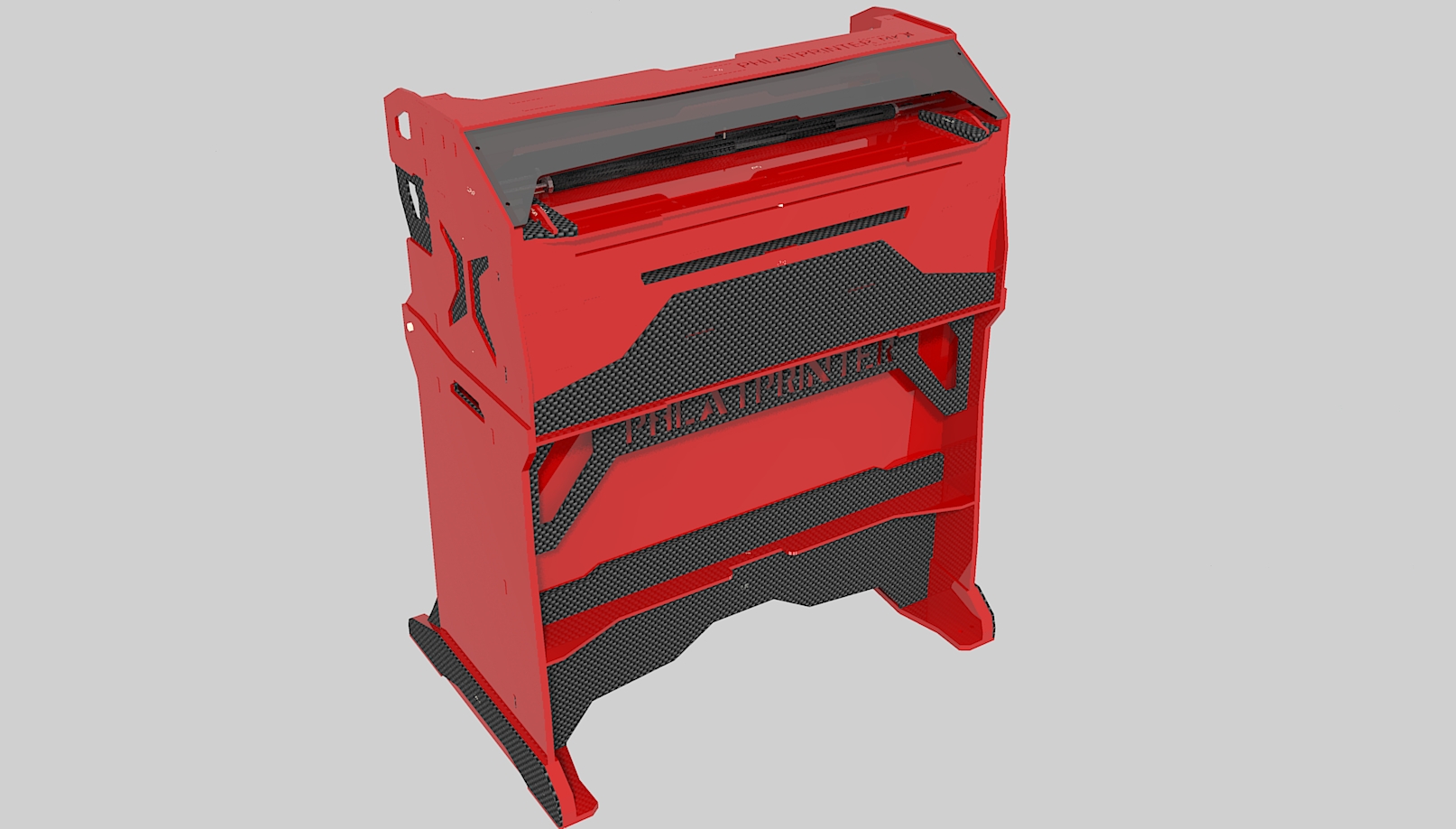

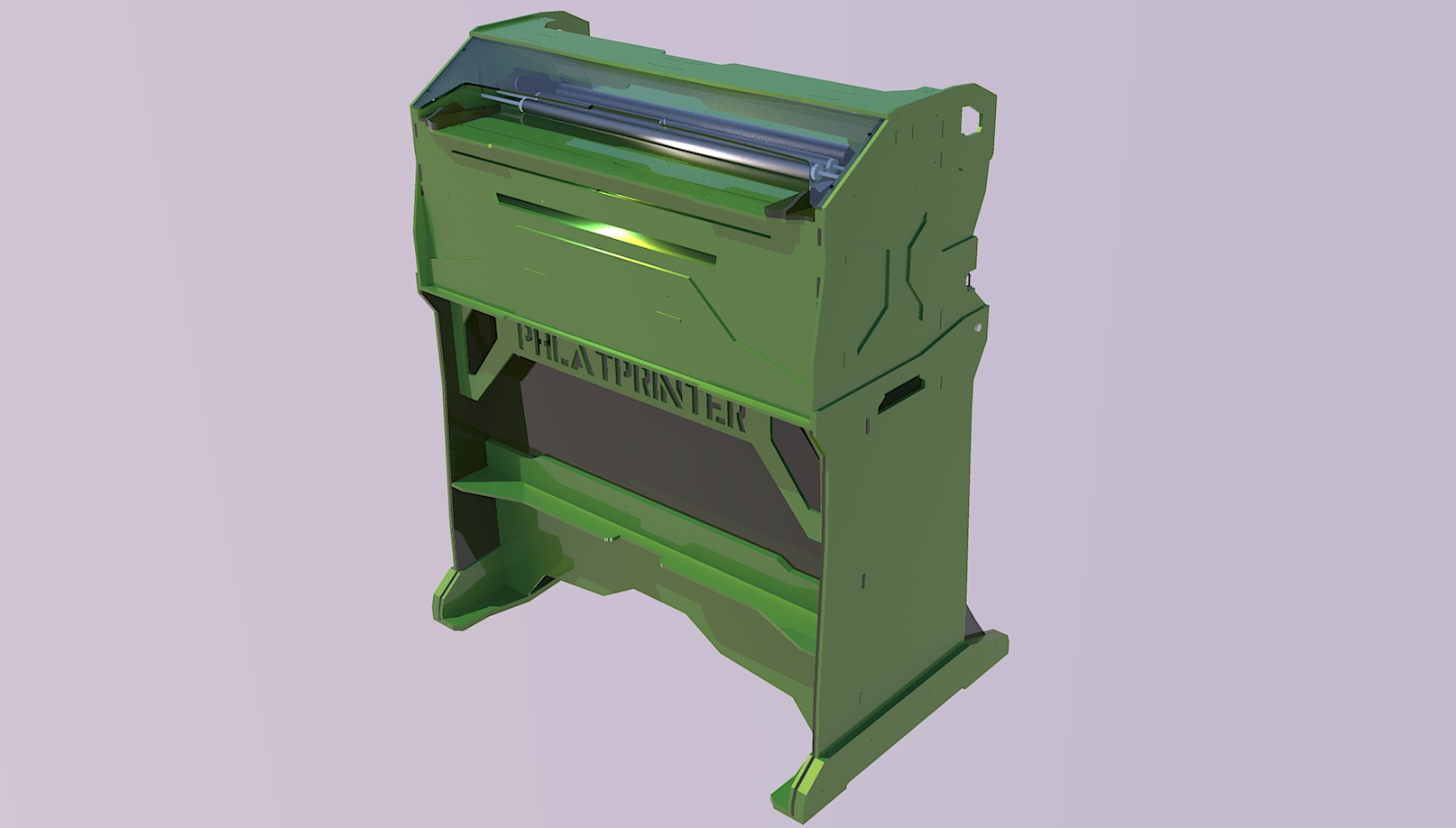

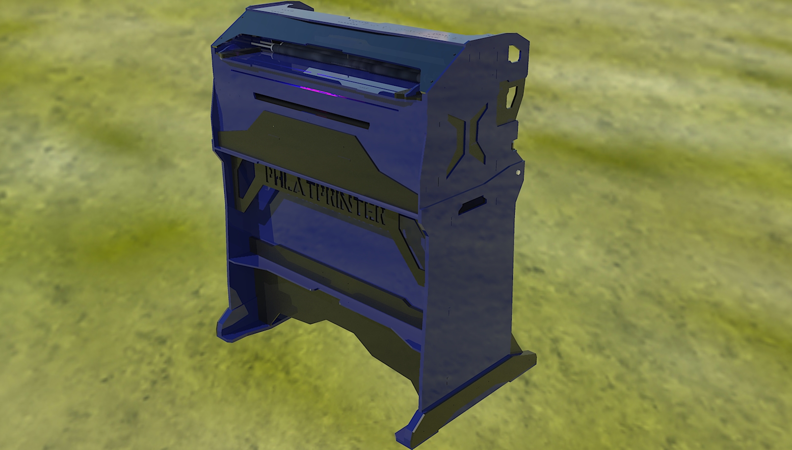

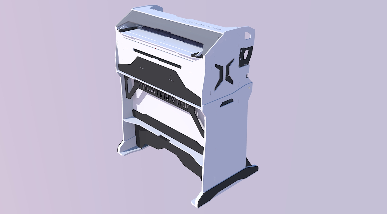

    Here are a few different renders of paint scheme ideas for the MKII
    I will be adding more as I can
    These are hi-res pics so be sure to click them to open them in full view :)
    Also added a plain while clay render for you to photo-shop your own colors over to see what paint scheme you like.
    Enjoy
    Attached files [​IMG] [​IMG] [​IMG] [​IMG] [​IMG] [​IMG] [​IMG] [​IMG]

    Wow, Mark! That's SWEEEEEEEET!
    I'm diggin on the red one, of course.
    Now the question is, what kind of paint and primer should be used? I bet Randy will chime in shortly. :D I was thinking he used Kilz for the primer and one of the two-part catalytic paints on his.

    Woohooo! Make mine shiny red like Randy's!
  4. rjarois
    yea baby!!! that MK-2 in red looks hot!! i like....
  5. xtremeRCpilot
    One more vote for the red one !!!!!Im thinking candy apple car paint :cool:
    Cool guys glad you like them I thought It may give you some ideas on paint
    The texture for the red (and most) is actually car paint :) so I think it could be done :D
    I am still adding more so keep checking ;)

    I'm biased to the Storm trooper :D . White with the cabon look would be nice looking too.
    Me to :) I will render one like that
  9. xtremeRCpilot
    Quit teasing us Mark, its bad enough we have to build the thing let alone spend hours painting it!!! :D
    Did someone say Stormtrooper theme ? :cool:

    Man Mark these renders look sweet! Did you use SketchUp to render these? I like the Bumble Bee theme the best. I like when the II is in black so it pops out visually.

    mark, ther is a tutorial on youtube hoe to spray paint carbon fiber paint jobs....that would look cool also. man, seein them painted like that really makes me wanna get my hands on one, lols. you plannin on gettin them cut outta colored plastic or something?

    Once we ship the MK II's, we are planning on painting ours. We haven't settled on a color yet but Mark seems to be leaning towards Kawasaki green. We also plan on painting ours fully built rather than before.

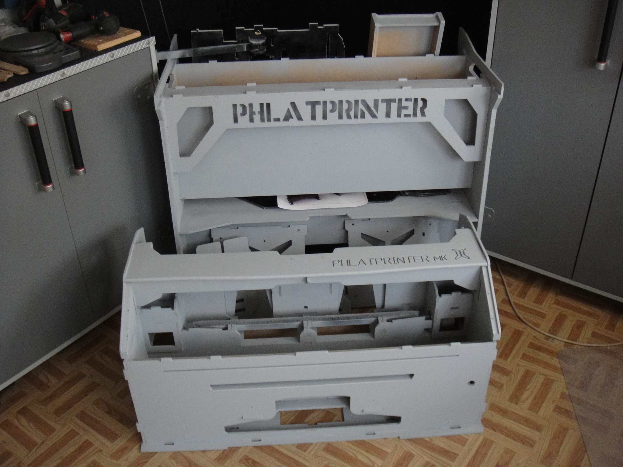

    Ok guys I am finished with the primer stage and had a question maybe you guys can help with.
    Should I sand the primer before the paint goes on?
    If so, should I then wipe the sanding dust off with something?
    Thanks guys this painting stuff is all greek to me :)
    Mark Attached files [​IMG]
  24. rjarois
    yea mark....sand very, very lightly. it will help the finish coat stick better, and smooth the surface a lil if there is some "buggers". then wipe down with a tack cloth, or what i do is use some paper towel a lil damp with alcohol. lookin great man. randy.
  25. kram242
    Cool! thank you for this info Randy! I do have some buggers on there and just wanted to be sure that I could sand them off. I also rub my hand across the parts a get an over spray dust that I thought should be taken off.
    Thanks again brother, this was a big help for me :)
