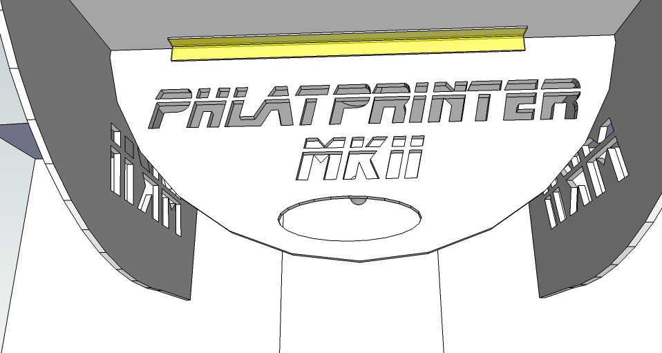

    Guys, here are the tables I entered into the contest. Feel free to modify and use them any way you like.
    Also included in the zip file is the font that I used, It's great for foam as it has a strike-thru (?) in it that gives your cut-aways some support, not just a big open hole.
    Hope someone enjoys it. :D Attached files [​IMG] [​IMG] 7up_MKII_Tables.zip (404.8 KB)Â

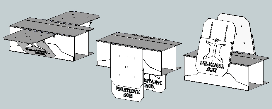

    I finally had some time to finish this up. I built it a couple times in SU and it should print off close enough. Just send me beta tester report please :)
    Attached files MKII Table by 66tbird.zip (5 MB)Â [​IMG] [​IMG] [​IMG]
