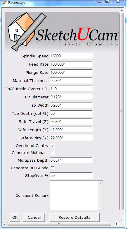

    How do I get this to work? I have Phlatscript installed in Sketchup 7 but there are no 3D options.
    I see a 'generate multi-pass' option. So what am I looking for and where is the option to do 3D?
    Can you be very specific on how to draw and output gcode for a 3D model?

    Make sure you have the latest version of Sketchucam (used to be Phlatscript) here: viewtopic.php?f=98&t=2
    Then just check the generate 3d box in the parameters. The video in the first post explains the 3d part. Attached files [​IMG]

    I looked at the files before I installed and compared to the new ones.
    Interestingly, they matched content and date.
    But, when I overwrote the old files with the newly downloaded files the problem was repaired.
    I can now see the 'Generate 3D GCode' checkbox, etc.
    No idea why re-installing worked, but I am glad that it did.
