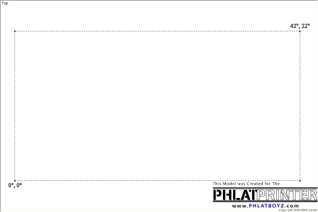

    Here is the Phlatboyz template file for Sketchup 7. You are more than welcome to use it in your designs.
    It will help with the overall look of all of our files
    * To install it just download the file and move it to your C:program FilesGoogleGoogle SketchUp 7Resourcesen-USTemplates folder
    1: Open SketchUp 7
    2: Go to Window/Preferences/Template
    : Select the Phlatboyz_Template and hit Ok
    4
    : Close SketchUp 7
    5
    : Reopen SketchUp 7 and the template will be there
    Heres a short video tutorial on how to install this template
    If you can't buffer this video just right click on the name and save it to your desktop to view it.
    Hope this helps you guys
    Mark Attached files Phlatboyz_Template.skp (161.1 KB)Â Template tutorial.wmv (2.8 MB)Â [​IMG]
