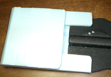

    I have nicked my fingers a few times because I'm not paying attention when grabbing the PhlatCutter. It is an excellent tool for liberating a bundle of blue FFF from its accordion binds with some nice straight edges.

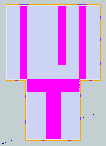

    Since I make a living with my fingers as a programmer and feel those nicks everytime I press a key I drew up this simple sheath for the cutter. Hopefully it helps prevent someone else from looking like my old shop teacher Mr. Stumpy.
    GCode is set for a 1/8" bit but watch the feedrate since it is set at 400. It cut it with no problems using the fishtail chipper in the Phlat Bit Kit using 280 steppers and the Harbor Freight router speed controller set in the middle of the green (Medium).
    Assembly is very easy as long as you be careful about zeroing the Z. When I cut things with 180° bends I make sure the skin on the foam is facing up. Start by creasing the fold cuts.
    Once you have all the folds creased just fold the sides in and lay the bottom over the main section. Apply a few pieces of tape or a dab of glue and you have a simple little holster for your PhlatCutter.

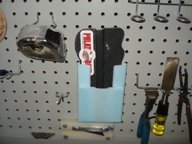

    Ok so I could not wait :D
    Here she is ready to go
    Thanks again Tim for a great design Attached files [​IMG] [​IMG]
