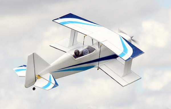

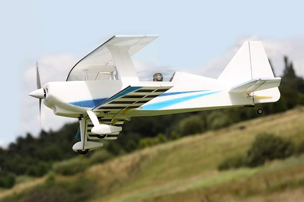

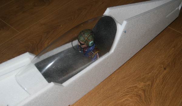

    Hi Fellas,
    Just a few of pics my latest 39" Ultimate bipe.
    All 9mm EPP from RCFoam, cut at 20ipm on a 3mm bit with the original MK1 Phlatty.
    Flys great on 300w and even better on 600 ;)
    Cheers Mark and Trish for creating a truly affordable cnc'er ..awesome job guys !! Attached files [​IMG] [​IMG] [​IMG] [​IMG]

  11. 3DMON
    Very nice!
    I noticed with the bigger balsa versions there is a little bit of positive incidence it the top wing. Did you do this too or are they both straight? I'm still working on mine and that is one factor I'm not sure if I want to incorporate.
    It looks like it flies very well.
  12. MrFlash
    MrFlash New Member
    10
    Hi Shaun,
    Zero incedence on all the flying surfaces and motor thrust . Ive got about 2 degs right thrust on the motor and thats about it. CG is balanced to fly lhands off (level) inverted and it only needs a fraction of rudder in knife-edge at normal flying speeds. Alround its very stable and neutral even with the stubby clipped wing, (think the long tail moment helps a bit)

    What power system for 600W.
  14. MrFlash
    MrFlash New Member
    10
    Hi Dude ,
    The motor was an Overlander Thumper 4240 spinning an APC14 x 7. Probably a similar spec motor to the Hacker a30-14l . Its only on 3 cells but Im pulling just over 50 amps on WOT although it unloads quite a bit in the air.
    Might try it someday on 4 cells and see what happens :eek:
    Oh, the Lipos are UH 2200 - 40C, Rhino 3750 - 20c and Overlander 3300 - 30c and using a Turnigy Plush esc
