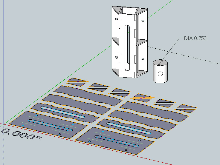

    Nice, mind if I offer it through my SmallPlyParts cnc service? I had just drawn up the same basic thing.
    Fine with me.
  6. 66tbird
    Thanks, I added it to the offerings on the BST

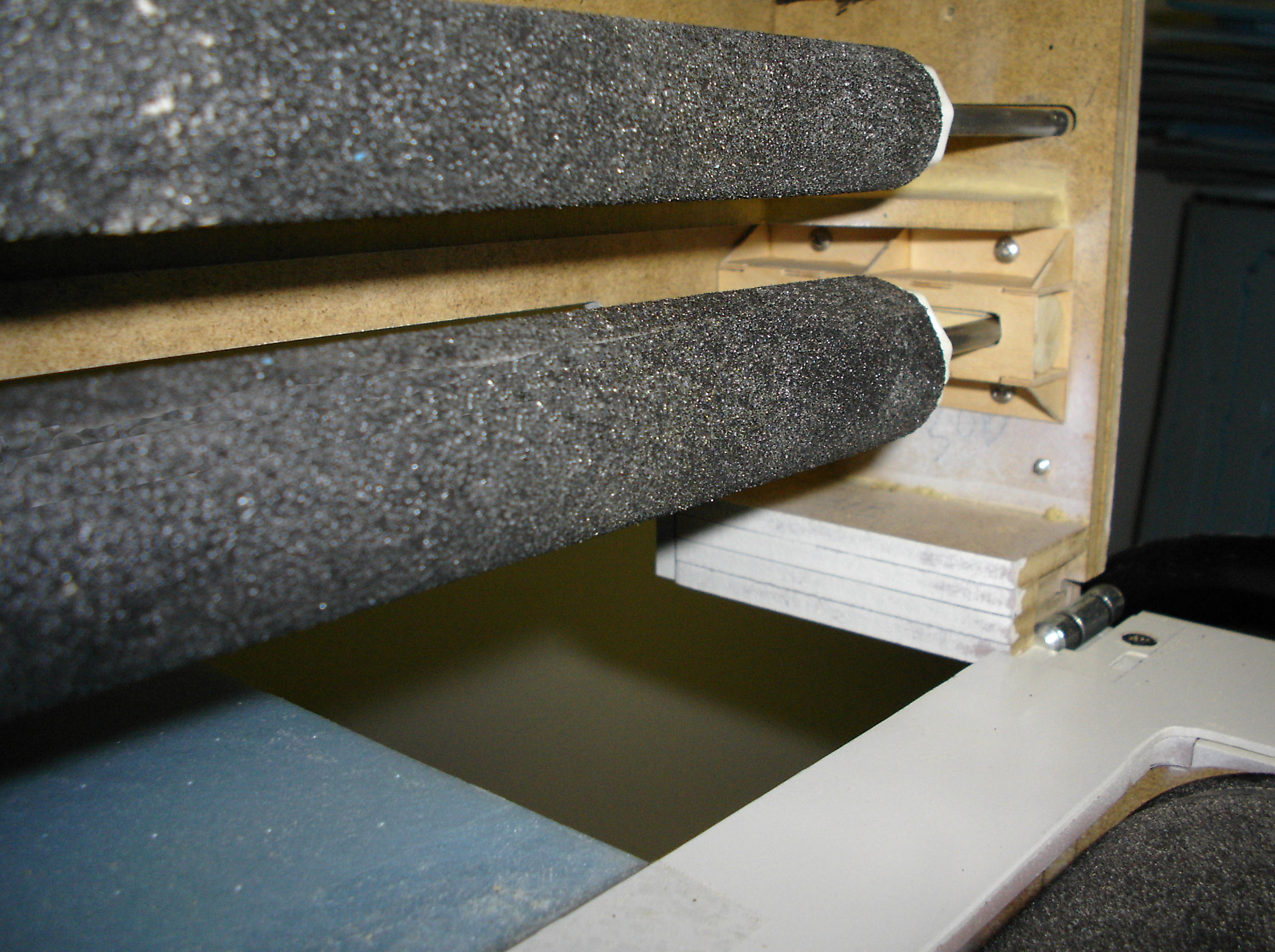

    I cut and installed my mounts today. I had to tweak them a little to make them work right without any binding with the original slots. I also added triangles to keep things square and add strength.
    I edited my first post with the new Sketchup and gcode files with the additions and tweaks I had to make.
    They work great. Attached files [​IMG]

    shawn, i was looking at your photo agian, and i noticed you didnt install the bushings right, unless you like it that way. when i first built it i was going to do square bushings. but decited round would not bind, as it piviots like a indepent suspension....if you did that on purpose, well disregard this post...peace, randy.
    sleeve orientation
  16. 3DMON
    I used a 3/4" dowel. I put it in perpendicular to your red cylinder in your pic. It works perfect, no binding whatsoever.
    Shaun
  17. rjarois
    ok, cool shawn...i just wanted you to know what i did. peace, randy.

    What about the front roller? This is where I see the most good for this mod. If I press down on the roller while cutting it eliminates the wave issues (high and low points....hate it when I have to dig foam out by hand to get a spar in place....). It will also help when cutting ply or balsa....mine tends to push the material up just before it plunges through....
  19. rayclark
    rayclark Member
    134
    Center of Michigan
    I was thinking the same thing. In fact I posted a simialr statement in the other thread. I went ahead and did it. It does seem to help with wavy foam.
