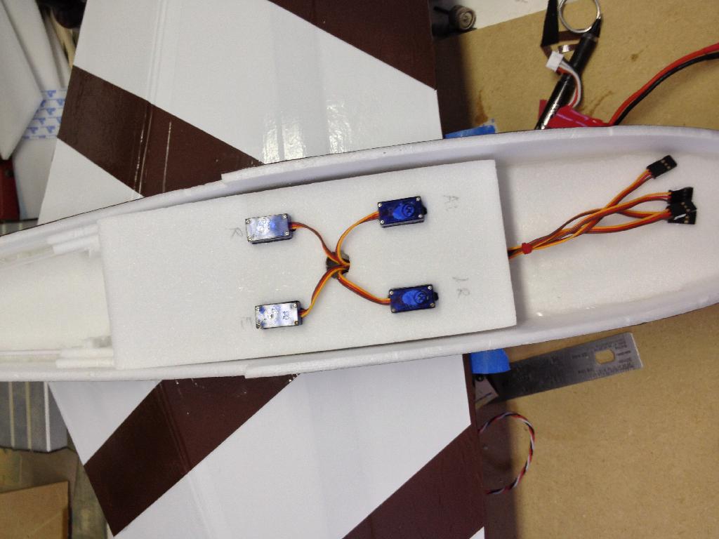

    I made a few changes of course. I added a servo panel under the wing which holds all 4 servos. It is a bit tricky to install since the servos have to connected to the linkage rods before you glue it in place. Make sure you center the servos with your transmitter first!

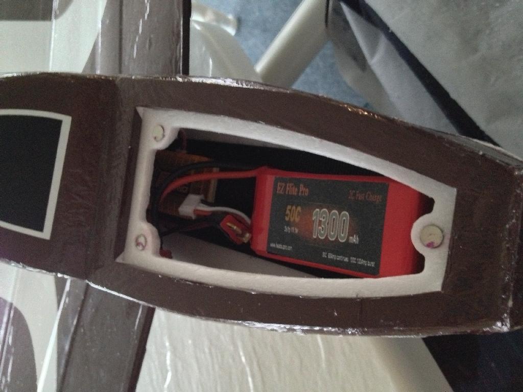

    I have not flown it yet. That will be tomorrow. I installed the EagleTree 2D/3D stabilizer in the plane. I really do love these little gadgets! Landing in wind is a breeze (pun intended). 2D wing leveling mode makes for great landings. No more unexpected gusts throwing me into the ground 1 foot off the runway!

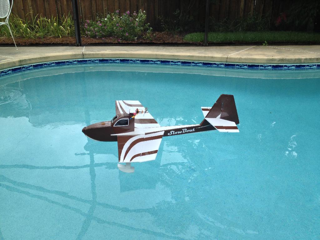

    Had a chance to put it in the water today. Short flight though, sun was in my eyes, so I only did a couple of landings on the water, and one takeoff from water and one from land.
    Camera is an MD80 gumstick camera mounted on a popsicle stick attached to the motor mount.
    This plane is really an awesome flyer. Attached files [​IMG]

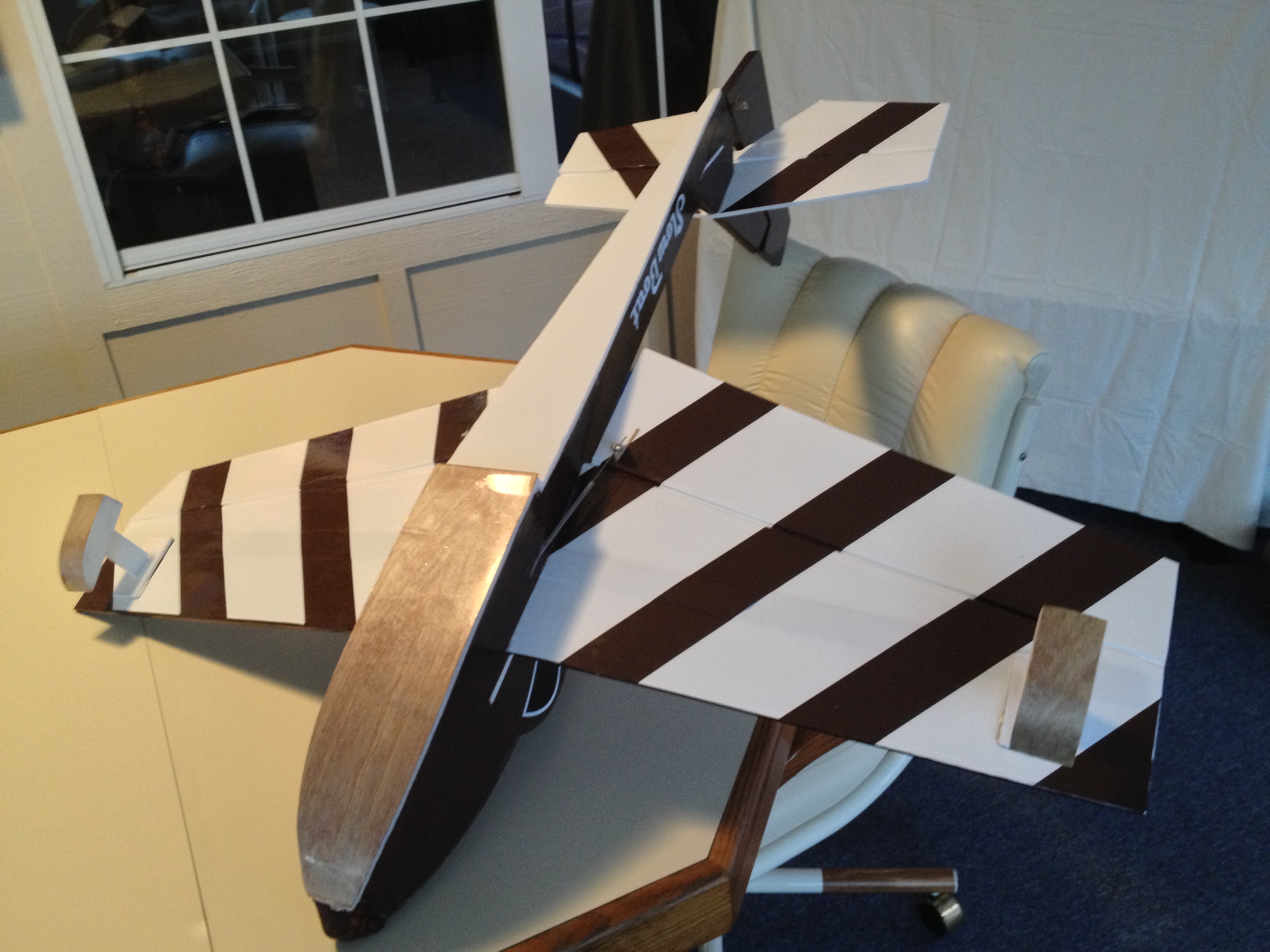

    I've had a couple weeks now to fly the SlowBoat and I have discovered a few things that can stand to be changed.
    1. The wing tip floats are essentially useless. This results in the wings going under water frequently when trying to turn.
    2. The lack of a water rudder makes it difficult to maneuver in wind.
    3. Landing with wing leveling stabilizers may not be the best option since the jolt taken when hitting the water and subsequent bounce back into the air may result in the stabilizer taking drastic action as evidenced in videos taken during testing of the new wing tip floats I made. In the future, I will turn off stabilization before landing.
    That said, there are solutions to all of the above.
    I designed new wing tip floats made from a combination of 1/8" Balsa, 1/8" lite ply, and 1/64" lite ply. The wing tips extend down to the waterline and have compound angles to keep them lined up properly. These new floats have proved to be very effective and allowed me to takeoff and land in some pretty choppy water with no difficulty albeit having to come in a bit hot with a tail wind pushing me.
    I am enclosing the Sketchup file for the floats and some pictures plus links to video of the maiden flight with them. Please note: There is a left and right side! The angles on the plylon supports is determined the position of one piece of wood which has a slot for the bottom of the plylon. Be sure you check this before you glue it in place.
    Build the float section balsa pieces, add the support, and finally, cut strips of 1/64" ply to wrap the bottom while glueing it in with CA.
    I still need to add an extension to the rudder to allow better control while taxing.
    Attached files [​IMG] [​IMG] [​IMG] SlowBoatPlyParts.skp (562.5 KB)Â [​IMG]
