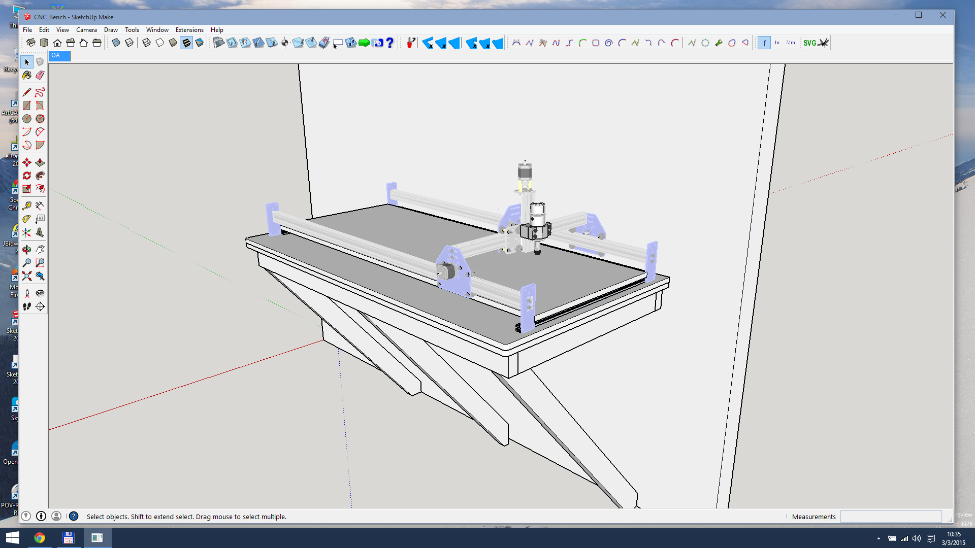

  6. TigerPilot
    I looked at the file. What is the problem you have with it, Arnold? That is what I see in SU2015. As you can see I have SketchUcam installed.
  7. BArnold
    BArnold Woodworker
    26
    Thomasville, GA
    Yep, that's what I see in SU2015 with SketchUcam installed. Much of the detail in the Shapeoko components is gone, blurred out or something. The only way I fixed it was deleting SketchUcam.
    Look at the file in SU without SketchUcam installed.

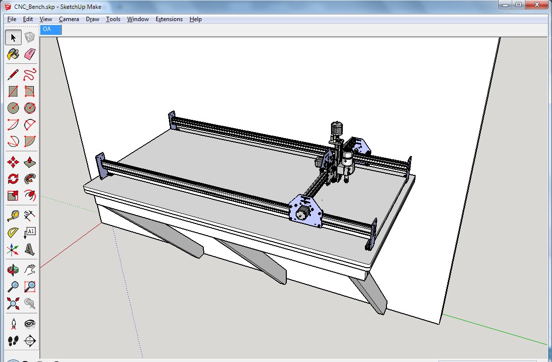

  9. BArnold
    BArnold Woodworker
    26
    Thomasville, GA
    Hmmm.....
    Here's a capture of my file with SUcam totally deleted.
  10. TigerPilot
    I'll be damned! I was able to reproduce the error. To clarify, the lines, or anything else, is not missing it's just rendered differently. I'll try to locate the 'offending' file and will report here.
    Edit: Couldn't locate the file that caused it. Every time I left out a .rb file the whole script will not load and then the model looks like Arnold has it.

  12. swarfer
    swarfer Moderator Staff Member
    808
    Grahamstown, South Africa
    it is setting some styles that are causing some edges to be rendered transparently. maybe a better question is why the model had some odd edge styles and some that are not affected.
