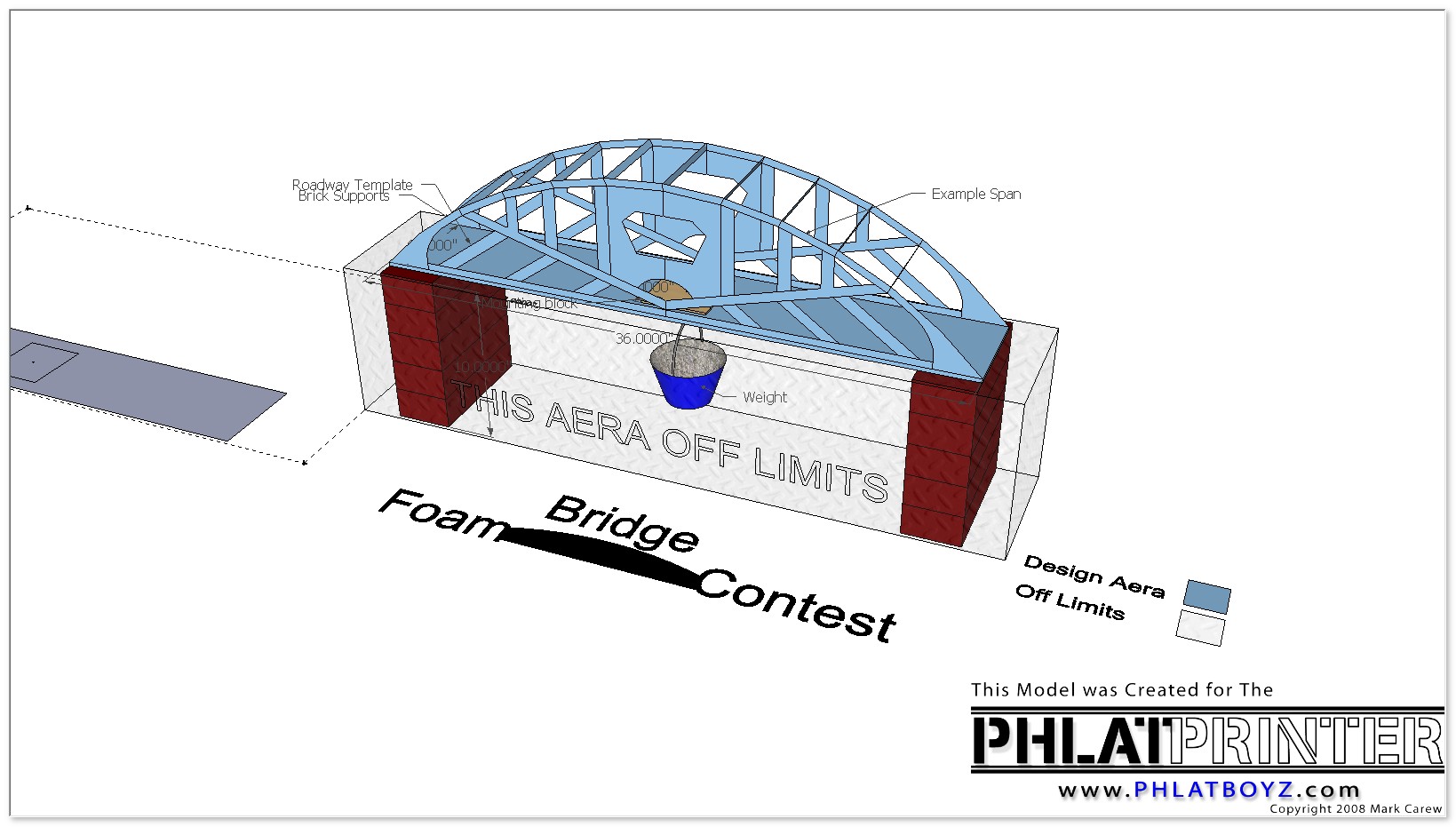

    Remember back in the day during shop class when you had to build a span bridge out of pop sickle sticks and then they test it to see who's will hold the most weight? This contest is basically the same idea except we are going to use foam!
    Here's how it works...You submit an original bridge design to us including the SketchUp file and Phlat Code text file. We will cut it out and build it. The Bridge that can hold the most weight wins.
    The plan is to receive all submissions, cut them out and build them. We will do the weight test LIVE on next week's Wednesday night Phlatboyz show.
    ELIGIBILITY: All Phlatboyz and like-minded individuals. You do not have to be a Phlatprinter owner to enter this contest. Just download SketchUp and install the PhlatScripT plug in and go at it.
    Rules: All entries must be received by Tuesday, March 23, 2010 at 11:59 p.m. EST. All entries must be emailed to support@phlatforum.com and/or posted include the SketchUp file, Phlat Code text file, and any special instructions you may have for building it. Phlat Code should be generated using the PhlatScripT. We will cut it out on the Phlatprinter using 1/4" fan fold foam (24" X 48") with an 1/8" bit. All parts to the bridge must be foam and fit on one sheet of fan fold foam. FOAM IS THE ONLY MATERIAL!
    The support columns will be 4 standard bricks stacked. The dimensions need to be 8" wide by 36" long. This is the road way. No support structure under the road way. We will add a piece of 8th inch ply to the center of the span and hang weight from the center using an I hook.
    You must use the SketchUp template provided in this thread for the start of your bridge because it has the template for the I hook holder.
    We are not responsible if an entry is not received or if we build the bridge incorrectly. We are not responsible for misalignment's. When possible, please use the tab and slot construction for ease of build. We will be using hot glue to build the bridges. If you notice the bridge is built different than you would have intended, please contact us immediately during the live show on Wednesday, March 24, 2010.
    All entries (SketchUp file and Phlat Code file) will be posted in the architecture section of the Phlatforum and will be free to download.
    Only one prize will be issued. The bridge that holds the most weight wins. If two or more bridges buckle under the same amount of weight, the winner's name will be drawn randomly from a Phlatboyz hat. We reserve the right to cancel this contest at any time for any reason. Delivery of this prize is undetermined and not guaranteed by any certain date. We will notify the winner through the email address that was used to submit the entry. Only one entry per person.
    We reserve the right to update these rules at any time during the contest. All posts made by kram242 or Strongest Foam Span Bridge Contest thread will be consider part of the rules (in case we didn't think of something )
    PRIZE: One Phlatformer Shipping charges included
    JUDGES: Mark and Trish Carew
    DIRECT QUESTIONS TO: Please post on this thread any questions or contact us at support@phlatforum.com
    No purchase necessary to win. Void where prohibited. By entering this contest, you have agreed to all of the rules listed above and that your design is public and can be shared on the Phlatforum for anyone to download. Phlatboyz, LLC is not responsible for any injuries that may occur as a result of this contest.

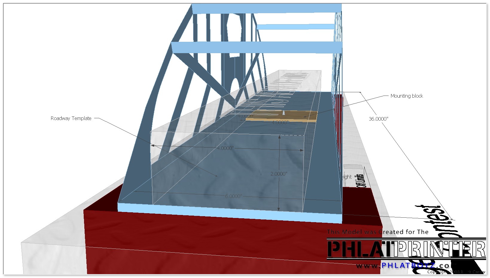

    Ok guys here is the template road file!
    This will be the base starting point for your designs.
    Feel free to modify the roadway any way you see fit, to add you connecting points etc. With these exceptions: (subject to change)
    ______________________________________________________________________________________
    -(roadway)You cannot double it, it must remain a single layer of foam.
    -(roadway)You cannot make it wider
    -(roadway)You must leave the mounting block guide lines and center hole in their place.
    -(roadway)You must leave a road clearance of 4" wide (centered) and 2" tall.
    -(Span bracing)The span bracing must not be a solid wall, you MUST HAVE HOLES separating them at the maximum of 1" to create the brace

    Please download the new updated Sketchup file for the road clearance
    Attached files [​IMG] BridgeContestTemplate.skp (513.8 KB)Â [​IMG]

    How much can we encroch on the interior of the road span? Is there a minimum size box that must be able to pass through like a car? :?
    Good point Bert! The file has been updated to allow for road clearance of 4" wide centered and 2" tall.

    How big should the hole in the middle, for the hook, be? Is a 1" diameter OK?
    Yoram, The hole in the middle for the hook is 1/8th. There are score lines in a square around it so that we know where to put the wood for every bridge for the weight test.
    Basically you would want to work everything from the roadway template file.
    On a side note if you guys notice there is a little space on either side of the off limits area of the top of the road. You could maybe double up supports there (hint,hint) :)

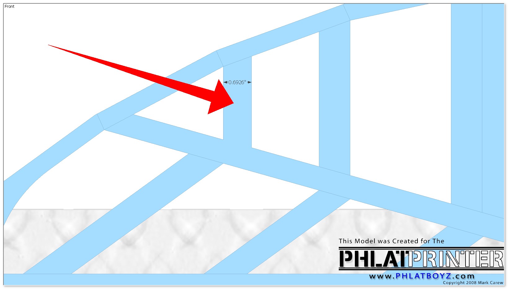

    One thing that has come to our attention is the width of the span bracing. There is a thought that someone may try to make a solid wall for the span. That would defeat the purpose of this contest. So an new rule and hopefully the last one is that:
    -The span bracing must not be a solid wall, you MUST HAVE HOLES separating them at the maximum of 1" to create the brace anything less would be ok. You do not have to worry if a curved surface goes a little thicker just try to keep the bracing width below 1". Mainly we are trying to keep people from making a solid wall for the span, So we have to add this rule.
    So far we have two entries! :D they both meet this requirement. Thank you guys and great job!
    Remember if you complete your bridge you can email it to us at kram2422@comcast.net or PM it to either theothers(Trish) or myself(kram242)
    Thank you and sorry for the last minute changes. Hopefully if you have to make changes they will not be to difficult.
    p.s. If you are unsure what we mean by span bracing check out the picture below Attached files [​IMG]

    :D sorry about that! you can use on solid piece for the walls just be sure that it has holes that have a spacing of a minimum of 1" I will reword the above post.
