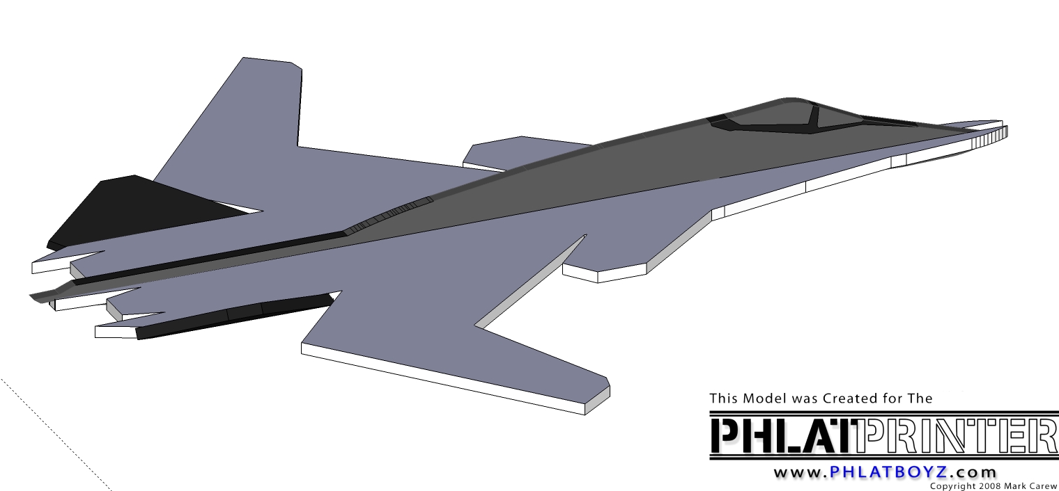

The begining of My ACE COMBAT XO2 Wyvern
Discussion in 'Single Wing Aircraft Plans' started by rescue911, Jun 30, 2011.
  1. rescue911
    419
    I've gotten this far with it.Now for the hard parts.
    Attached files Wyvern 4.skp (452.9 KB)Â
  2. 3DMON
    Looking good!
    A tip for ya. You can export a 2d graphic of what is on your screen in Sketchup under the file tab. Attached files [​IMG]

    Ok everyone I did my best at a cnc for it.The rest is up to you.
    Attached files XO2 4.1.cnc (20.4 KB)Â
  5. rescue911
    419
    The rest of the sketchup files.
    Attached files XO2 4.1.skp (1.2 MB)Â
