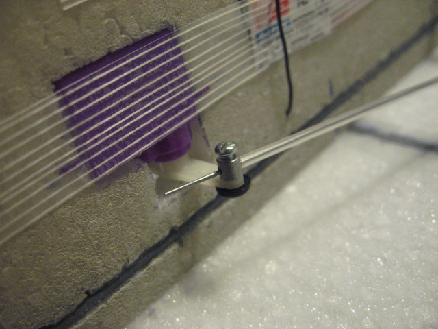

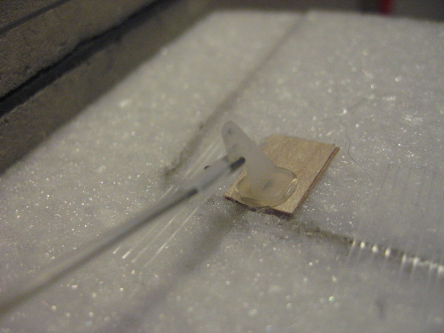

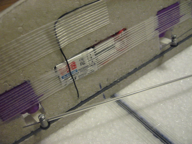

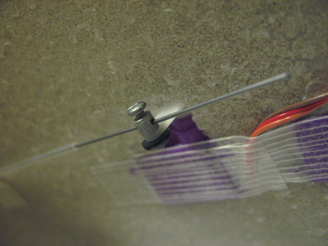

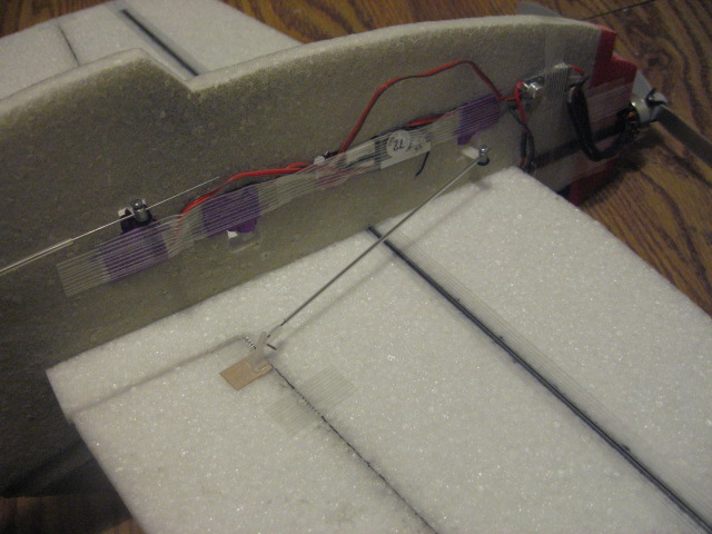

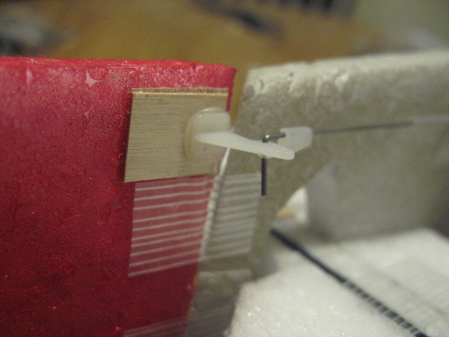

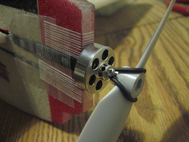

    I thought I would post a few more Pictures to show how how the hardware and electronics are installed
    Attached files [​IMG] [​IMG] [​IMG] [​IMG] [​IMG] [​IMG]
