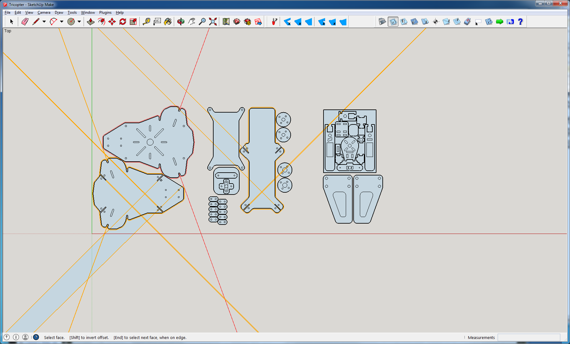

Whats wrong with this drawing

    THis started as a PDF. Brought it into inkscape and exported a dxf.
    when I do an outside cut I get this funkyness. any thoughts?
  2. ewo
    what bit diamiter and what is the size of the slot your trying to cut in those parts?
    also look for stray or broken lines
    I dont have sketchup installed on this computer so i cant open your file to check
  3. Ringo Davis
    Ringo Davis Member
    60
    It is the bit size. I changed the bit from 1/8 to 1/16 and the wierdness went away.
