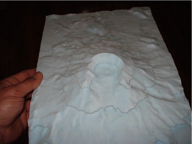

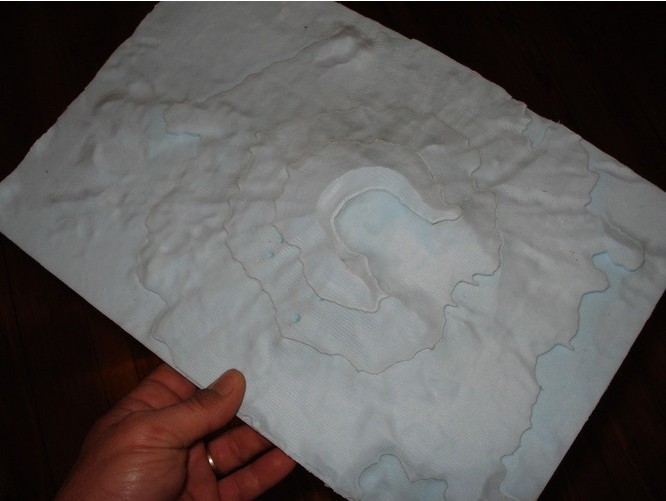

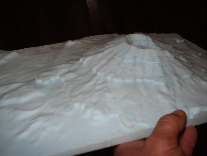

    I did a topical graphical map of mount St. Helen's in four 1/2" layers using the same slicer you described
    It turned out pretty cool but took forever.
    Here's a few pics. The layers didn't matchup the best but I was still learning about how to use it back then :D

    Neat topo and so close to nailing it. I would imagine that took forever.
  13. kram242
    Thanks it did take forever I think I let it run over night for each panel :)
    You can see where the glue I used melted into the foam.
