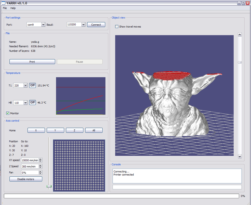

    Hey guyz,
    Here is a nice VERY easy to use host (3d printer control) software written by wuflnor
    We found this one a while back but up until the other day did not have a chance to try it out. Its working great sofar and its simplicitly really makes it shine.
    YARRH (say it like a pirate :D) stands for Yet Another RepRap Host
    Check the web site for the latest versions here:
    https://github.com/wuflnor/YARRH/downloads
    Download YARRH here:
    This is my new personal favorite at the moment. There are a lot of new ones popping up all the time so hopefully we can populate the board with more. Attached files [​IMG] yarrh_v0.1.7.exe (3.7 MB)Â

    Hi, Wulfnor here, author of yarrh.
    Yarrh doesnt manage heaters in any way. All setting temperatures is done from gcode, and slic3r setting. All user can do is set temperature from UI, but it wont be automaticly turned off after finishing print, unless there is a specific gcode at end of the file.
    In my case im using start, and end gcodes in slicer:
    start:
    [pre]
    M104 S0 ;Cancel the M104 set by Slic3r
    M140 S100 ;Start heating the bed up
    G28 ; home all axes
    M84 ;Disable all steppers
    M84 S30 ;Set stepper timeout to 30 seconds
    M190 S100 ;Set bed temperature and wait
    M140 S110 ;Set bed temperature but continue with the gcode
    end:
    M140 S0 ;Turn heated bed off
    M104 S0 ;Turn nozzle heat off
    G0 F15000.000 X0 Y180
    M84 ;Disable steppers so they dont get hot during idling...
    M84 S0 ;Cancel the timeout set by the start gcode
    [/pre]
    As you can see there are gcodes for turning heaters off.
    I also released version 0.1.9 of yarrh, it has some bugfixes and also macro functionality for making push buttons that will send specific gcodes.
