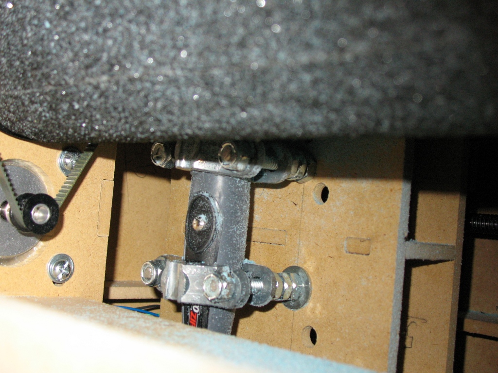

    I finally got my Phlatprinter up and running. I used ACME 3/8" all thread from Enco and made the top and sides removable. The only other notable mod that I did was to the Z-gantry. Because I am using a Roto-zip instead of the Dremel, I wanted a mounting mechanism where I could easily replace or reposition the tool. Here is what I came up with.
    Basically, I cut the grounding bolt off the front of two of these http://www.lowes.com/lowes/lkn?action=productDetail&productId=256460-1558-HT-410&lpage=none and mounted them with 2 1/2" bolts from behind. Attached files [​IMG]

    Nice job!
    Good idea on using those for your clamps.

    Brother Pain, yup, looks good man...good job. randy.

    Very neat Mod!! and useful for anybody with a stock gantry to be able to easily fit a Rotozip. Nicely done.

    Great idea BrotherPain!
    This is a great addition to the mods
    Thank you for sharing it
