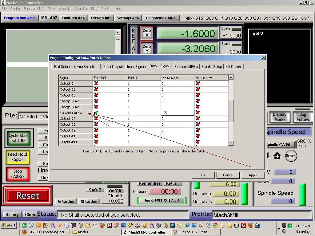

    AFAIK, Idle Current adjustment depends on the controller board you are using, and it is often enabled or adjusted via a jumper or potentiometer on the controller board itself. Unless the controller board has some provision for variability of the current, there is nothing Mach can force it to do.

    Nice one Yoram! have you tried this yet?
    Here are the settings from the read for the setting for those who do not want to sign in
    Attached files [​IMG]
