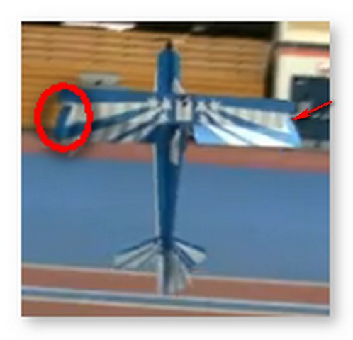

    Nice job ewo!
    Its strange that mach was being bogged down like that, I wonder what else is running in the background that may have been causing this. If you find any more info please let us know.
    The 3D Citabria is going to be a cool plane to bring to indoor fly events because no one would ever think it could do these types of maneuvers :)
    To think its really just a cessna type plane with extra large control surfaces.
    Speaking of control surfaces you may want to look how the ailerons are set up like an edge style pattern plane as they split at the tip and allow the tip to be part of the throw as well.
    Mark Attached files [​IMG]
  7. ewo
    Ahh. Good catch there Mark ! ;) I actually hadnt noticed the ailerons had counter balences
    I will be adding them to the files.. Looking at it now in real life i think i need to make a few other changes as well . One being i dont like the looks of the elevator at all. and i think i need to stretch it just a bit...I will post code when i have it the way i want it.
