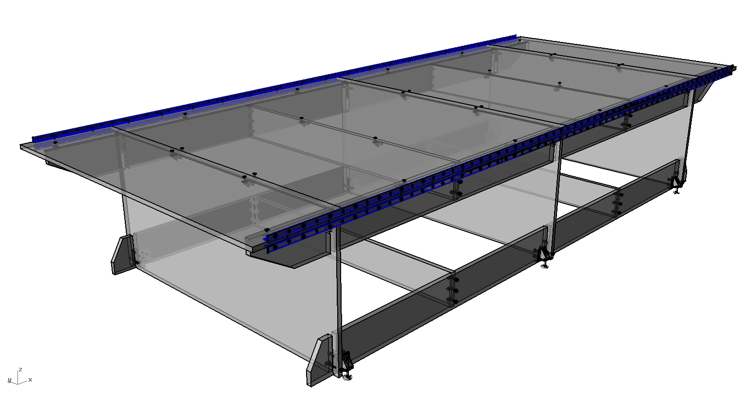

  5. thunder hawk
    Hi folks,
    Here are the plans for my 4' x 8' CNC table.
    You will need to use Rhino3D to view the drawings.
    You can get a demo copy of Rhino 3D ver. 5.0 here.
    The drawings are in layers and are full scale.
    These are 2D drawings.
    There is a BOM with these plans that can be opened in Open Office.
    `````````````````````NOTE``````````````
    Mark and Trish,
    I need to upload Rhino files to your BB the extension is *.3dm.
    Your BB will not allow me to upload 3DM files.
    Please allow 3DM files to be uploaded.
    Thanks.
    George.
    I will upload the plans and BOM when Mark and Trish allow .3DM files to be uploaded.
    Cheers.
    GHB :good:
    Its done George post away! :good:
  7. thunder hawk
    Here are the plans
    This table design is to fit the Black Foot 4 x 8 CNC machine from Build Your Own CNC using Open Rail.
    This design can be modified to fit your needs for your machine designs.
    Assembled table.
    The BOM and Rhino file are attached.
    There will be a few more drawings uploaded that will have close ups of how things are assembled.
    This design is submitted as is, and is free of royalty or copyright .
    Feel free to copy and distribute this design. It should be considered Open Source.
    All I ask is that you give me credit for the design if reposted on other news groups.
    I will post more on this design as I get a little more free time to do so.
    If you have questions please feel free to email me.
    Enjoy the design.
    George H. Boyd :)
    www.ghboyd.com
    Revised 7/23/2013
    The rail mount plan had an error for the drill holes that holds the rail to the table.
    The old dimension was 1/32 dia. drl. Should have been 7/32 dia. drl.
    The plan has been corrected.
    You can download the corrected plans again or just the rail drawing.
