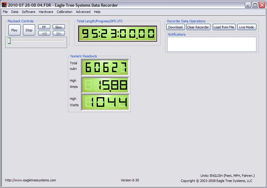

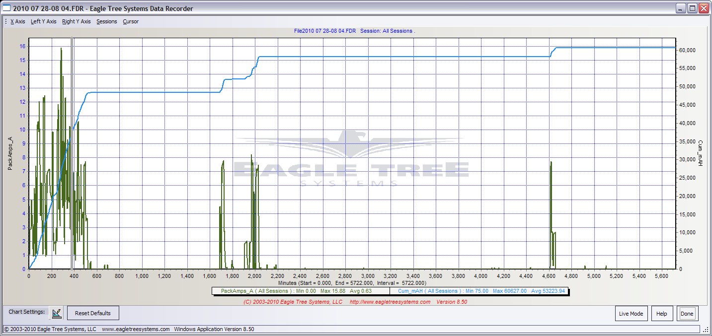

  3. meistertek
    Ok, here is the deep cycle battery usage data from July 28th to August 4th 2010.
    61amp hours were used this week, still not as much as I would think. We only have 25 members in our club and only about half fly electric and of that half only about half fly every week. That's only 6 people charging so that's about 10amp hours or 10,000mAh per person being used. If we were all flying 1300mAh 3S packs on average (actually that sounds close to our average) that would be about 1000mAh of charge back into a pack, so each person would be flying about 9 or 10 flights per week. Hmmm maybe that's right. :geek:
    Another thing is that most of us fully charge all our packs at home before arriving at the field to fly, so those are flights that don't use the charging station. A few guys fly only one flight per day, so they never really use the charging station.
    Well I 'll just keep collecting data! :lol: Attached files [​IMG] [​IMG]
