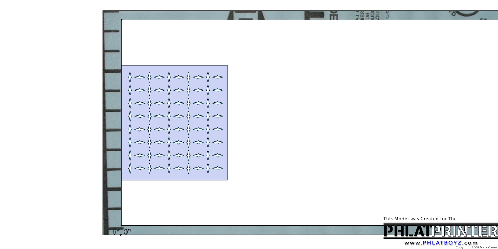

    Hey Thanks Jeff, I love using diamond for my airbrush schemes but used a piece of graphic material and painstakingly cut each diamond out, where were you a year ago LOL :D
    Thanks my Friend!
    John Attached files [​IMG]
  19. Jnida63
    Jnida63 Member
    749
    Glad I could help, I went to Hobby Lobby and seen the price for a little 8" X 10" template for $24 and said heck with that :D
    You will have to change the Phlatcode for whatever bit and material you are going to use, I am going to use a .030 bit and stick some frisket material onto a piece of foam to make mine

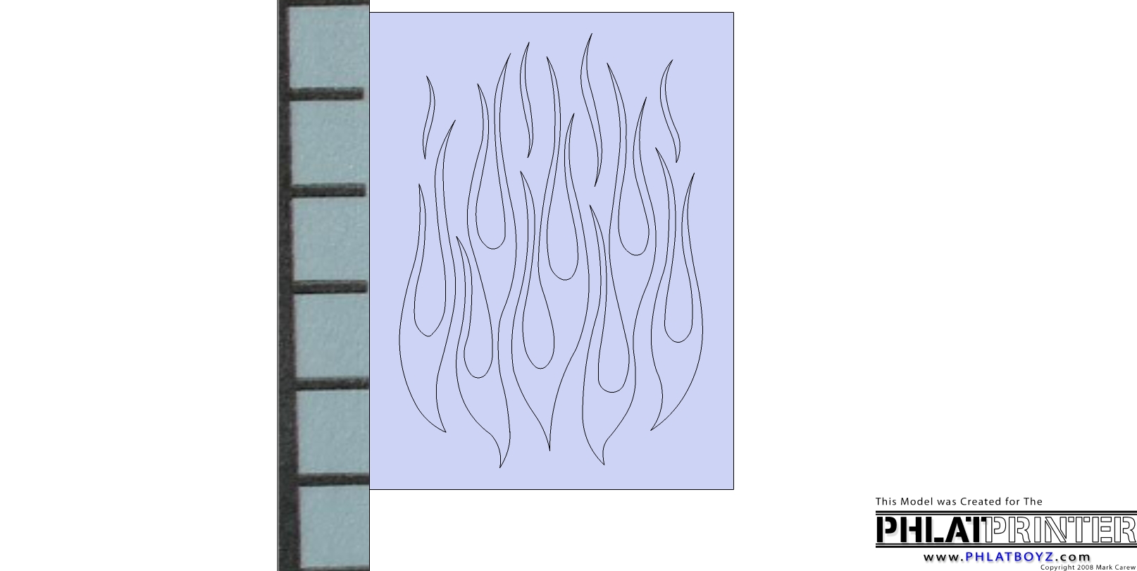

    Here are some flames
    Attached files [​IMG] Flames.skp (532.3 KB)Â

    Thanks Jeff!! I just updated the Phlat code for 2mm depron and a 1/32" bit!! I found the templates to be too expensive as well!! and this looks just a cool :p :cool:
