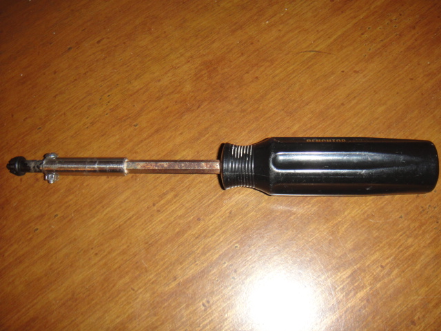

    For folks with big hands, or just wanting an easier way to change bits, here is a quick tool to help loosen and tighten the chuck.
    Use any 1/4" hex bit handle and drill it out for a tight fit for the chuck key. Grind off the chuck key "handle" so you can remove it from the chuck key, and insert it into the handle. I drilled mine for a through screw and bolt (4-40) to make sure it didnt twist when losening or tightening.
    Hope this helps.
    John Attached files [​IMG] [​IMG]

    Well I made mine tonight. I stopped off at the local hardware store on the way to pick up my daughter from swim practice, and picked up the only 1/4" driver they had. Here the shaft was the same size as the chuck, so I couldn't drill through past the driver part. I was thinking of taking it to work and having one of the guys weld it on. But I decided to try and solder it on. What's the worst that can happen?
    Boy was I pleasantly surprised. Worked like a Charm. I just scuffed up the chuck, and cleaned it and the drilled out nut driver with denatured alcohol. Used general purpose flux and solid core solder with a torch. Sure it's on there for good, but I can't see wanting to use it the old way....ever.
    THANKS again for such a simple, but great idea. Attached files [​IMG]
