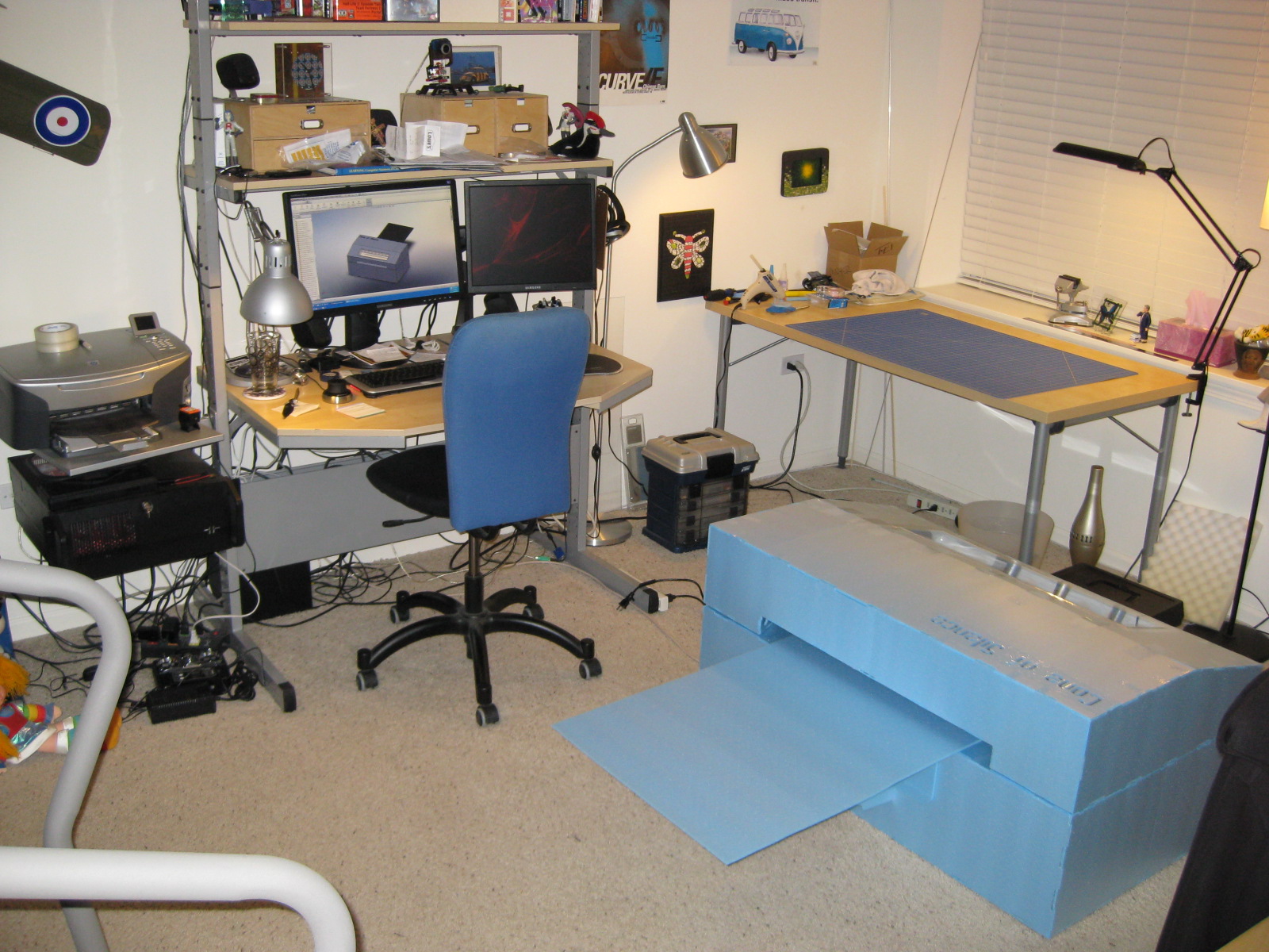

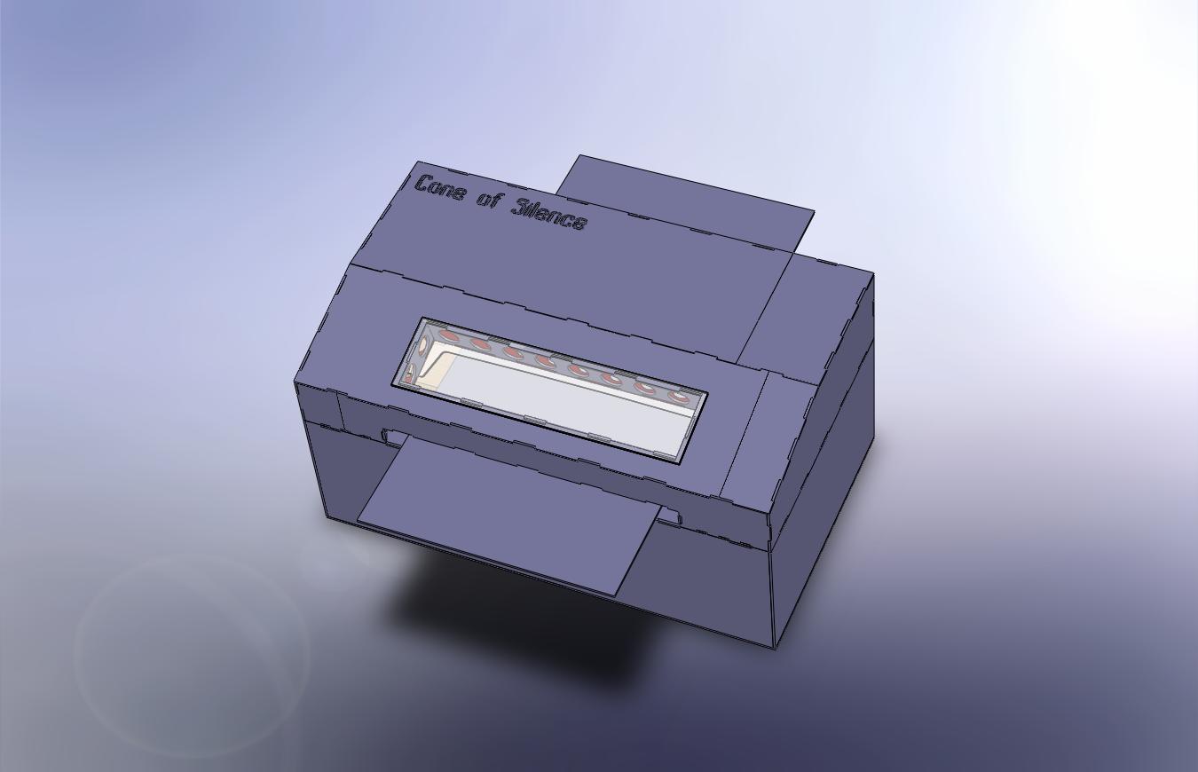

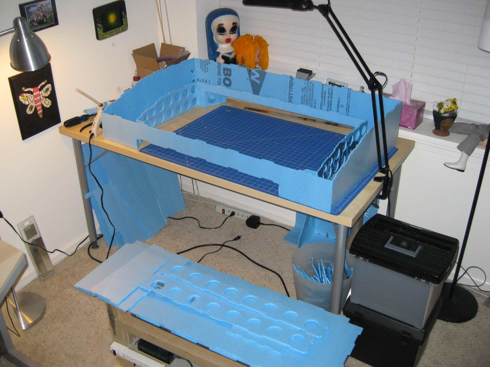

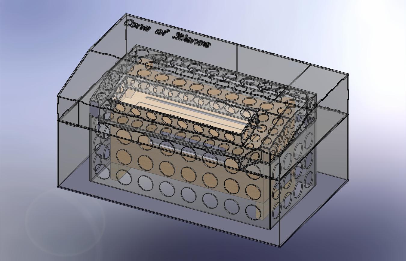

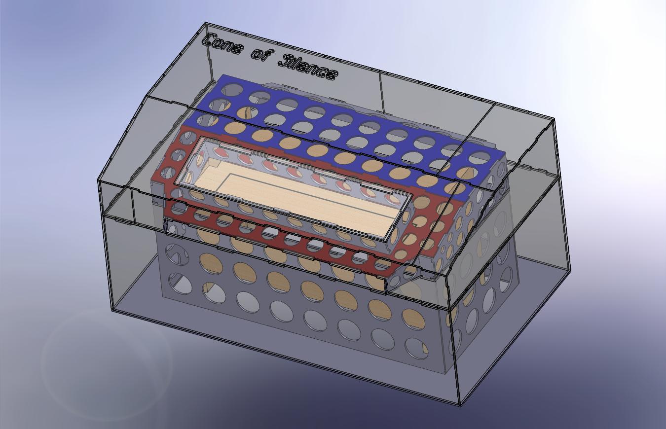

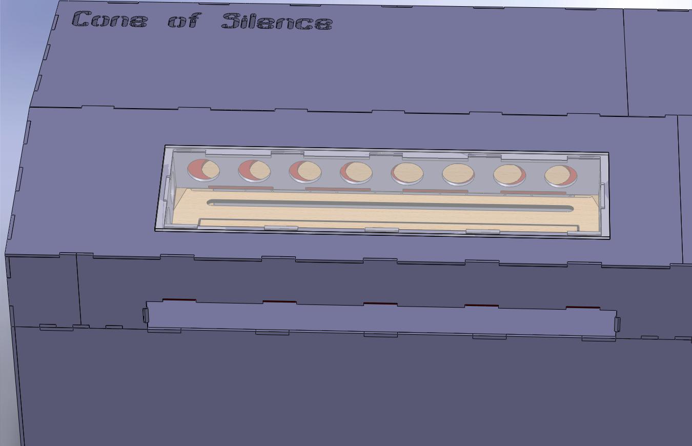

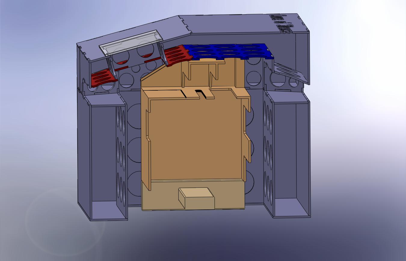

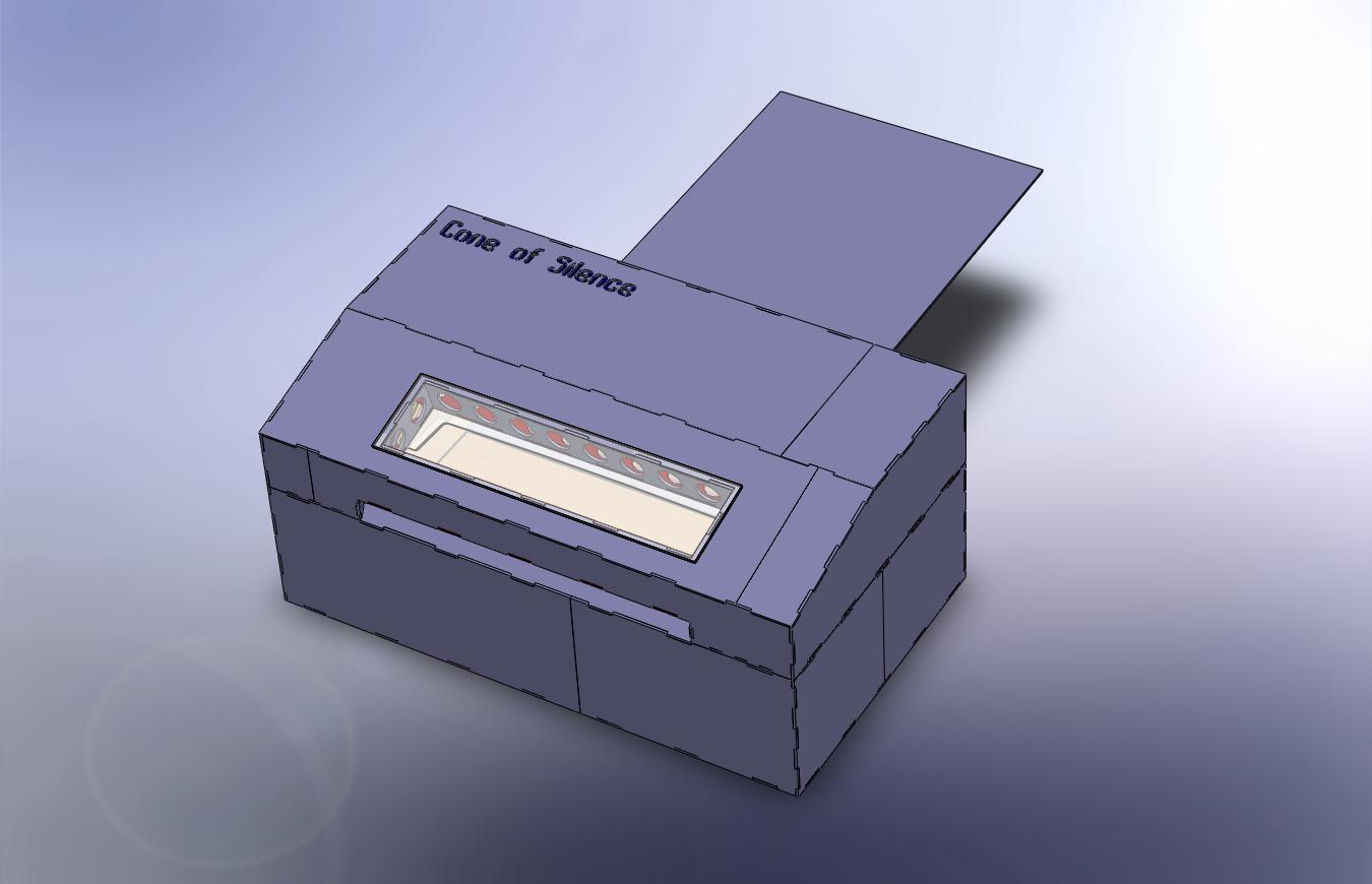

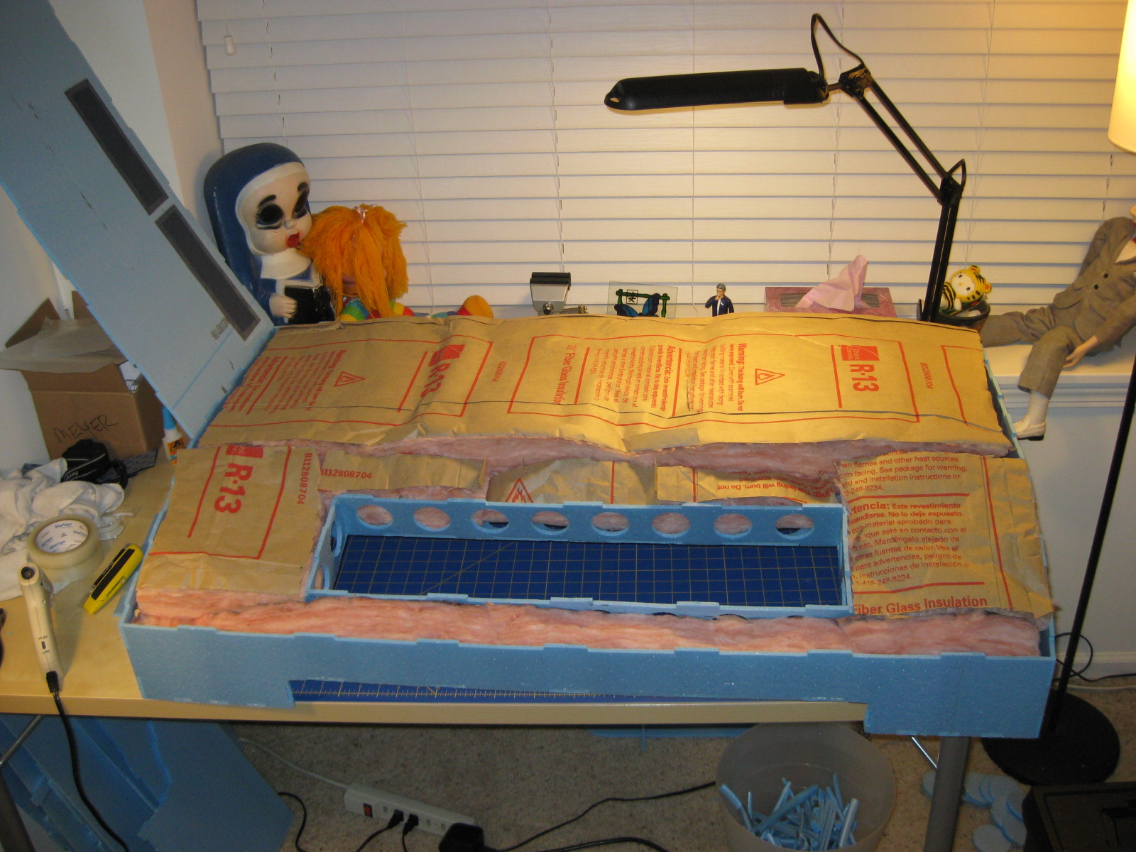

    I probably went a little overboard to get silence, but I have designed and started building an insulated sound cover to trap cutting noise, even at the low dremel setting. I am hoping to get so little sound I can run the PhlatPrinter at night in my apartment and not bother my neighbors.
    The enclosure is called the "Cone of Silence" and takes 12 sheets of foam to make, I hope it frackin works!

    meistertek, how much space are you leaving around the foam and the cabinet? This reminds me of those old dog boxes they used to put impact printers in. They did a GREAT job of keeping the noise level down, but they had about 2" of that soft acoustic foam lining the box.
  9. meistertek

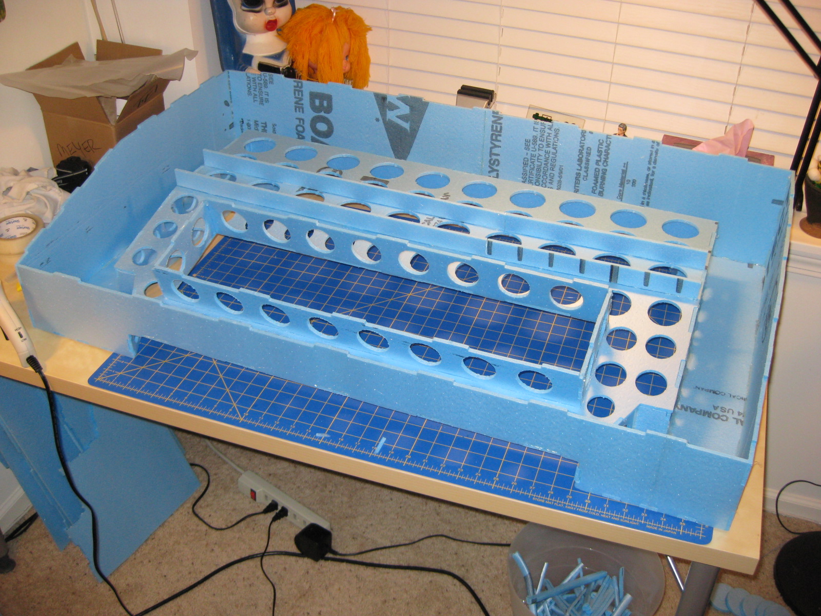

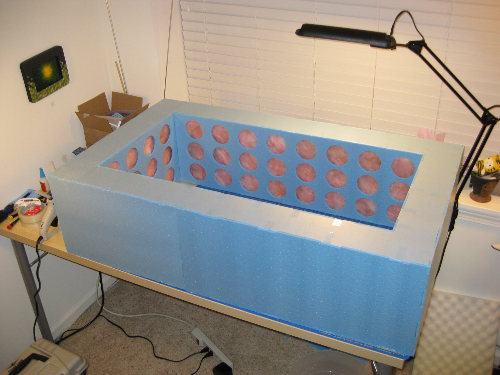

    rcav8r, There is about 2.5" of clearance around all sides except near the control board there is only 1". I guess that may be good since I could add the foam inside there. I remember seeing a few of those dot matrix printer enclosures too, ;) I guess we are both old enough to remember them! I am hoping that not too much sound will go through the slots where the foam goes. When looking around for a solution to deaden sound there seemed to be two camps, one was to make a very dense enclosure, which would be very heavy. The other camp was to make the sound go through so many turns and obstructions that it looses all its energy. I went with the obstruction route since I could use foam for the outside.

    Ok guys, here are some more details on the Cone of Silence design.

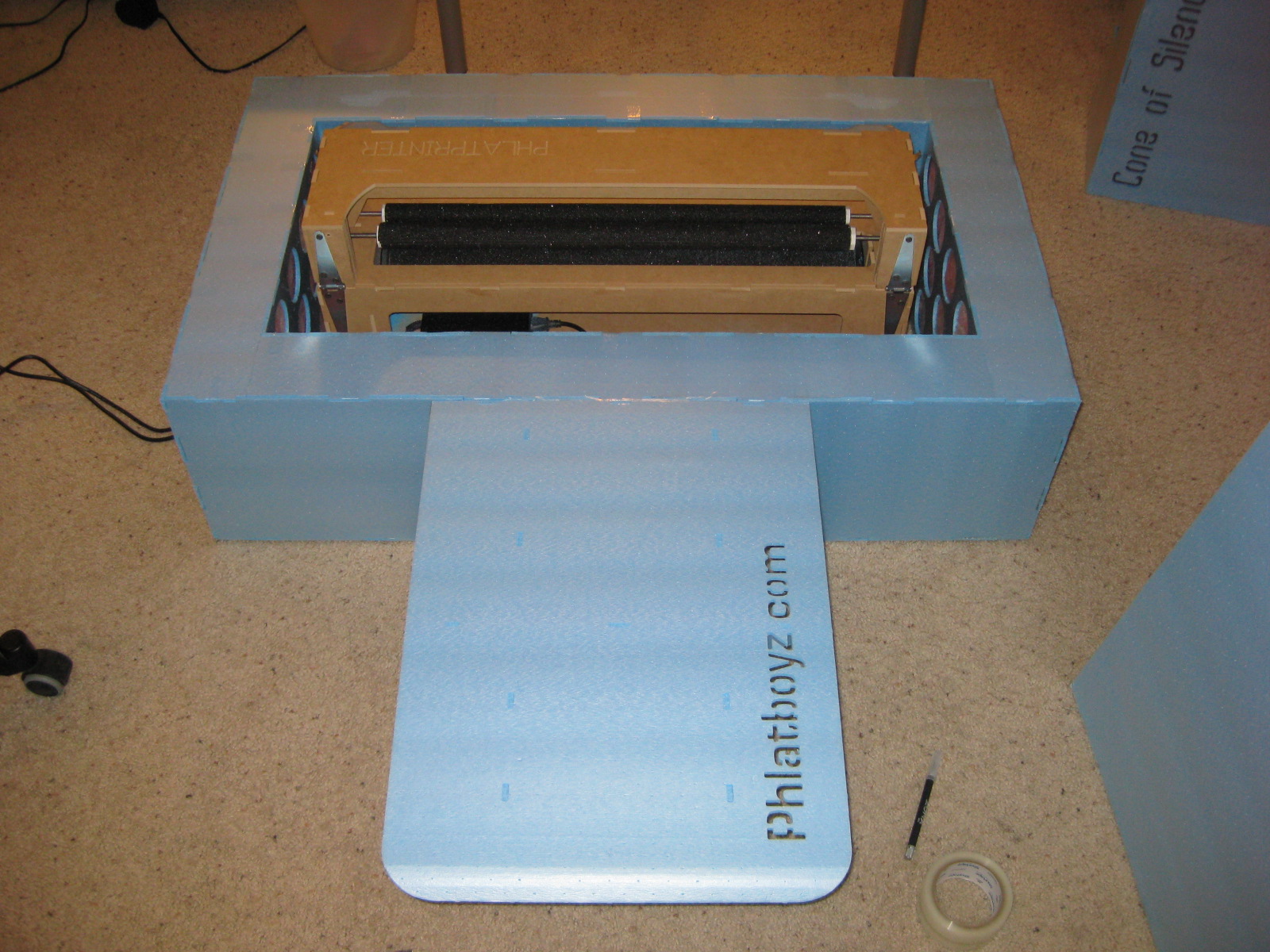

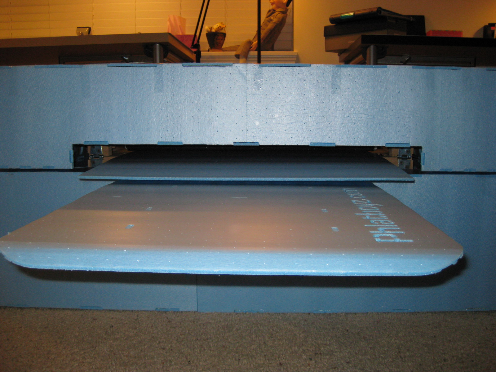

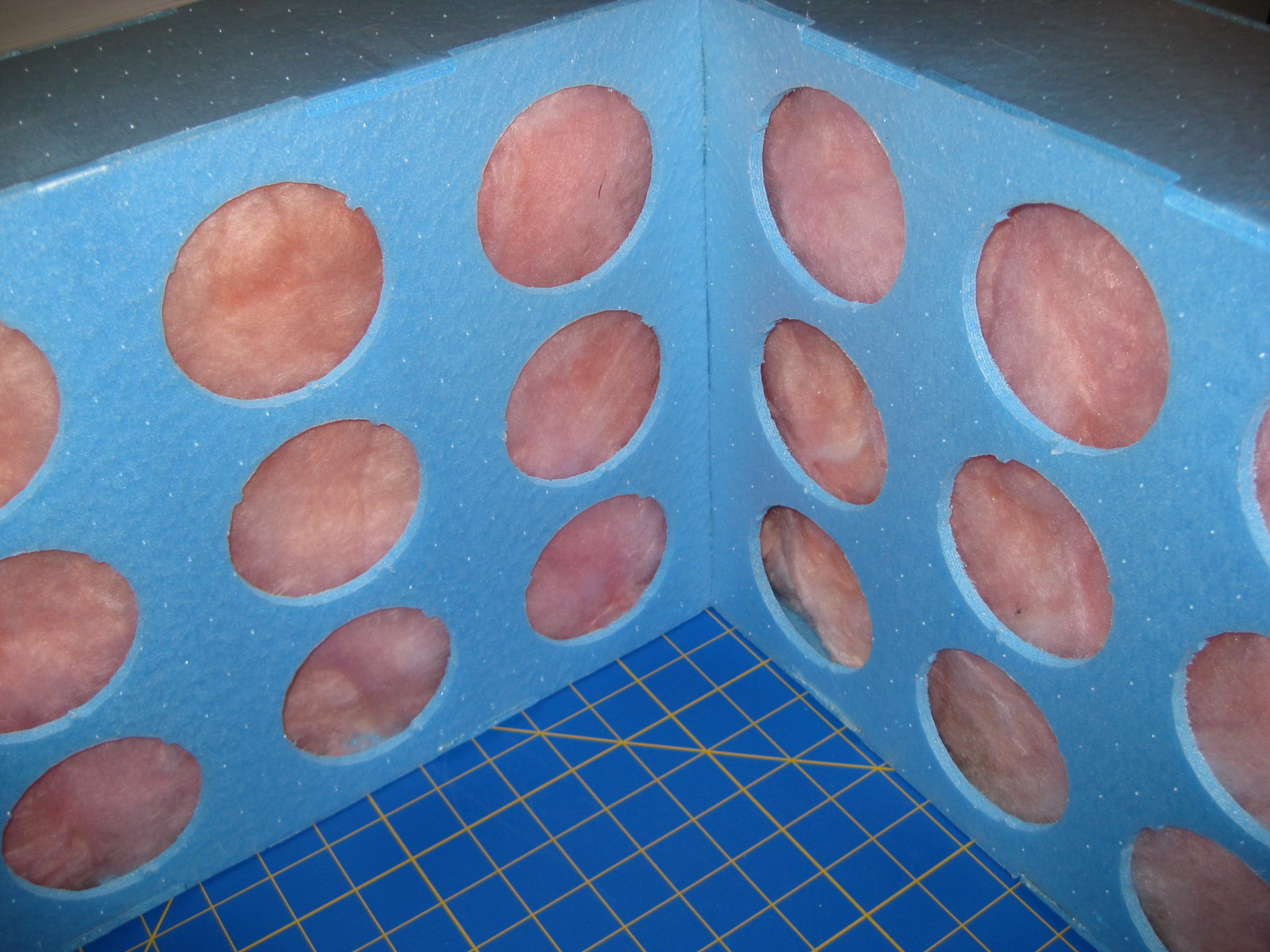

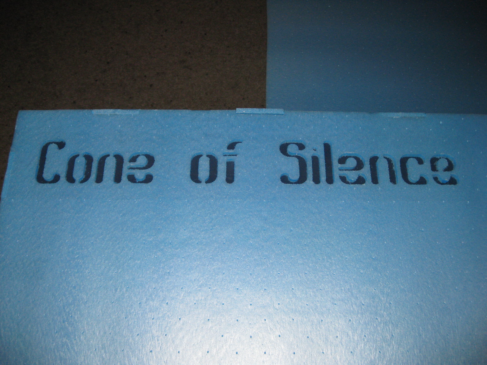

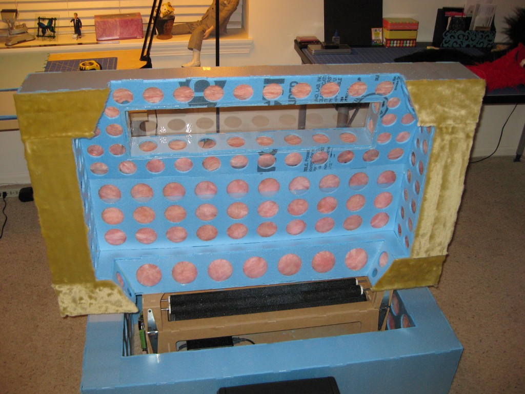

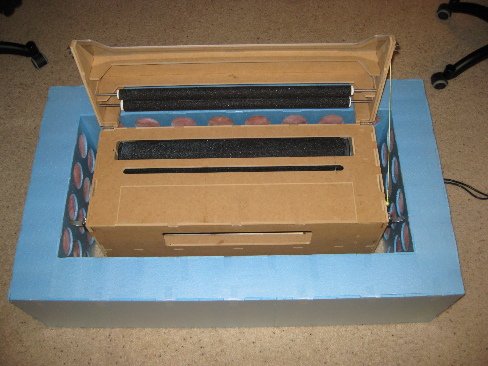

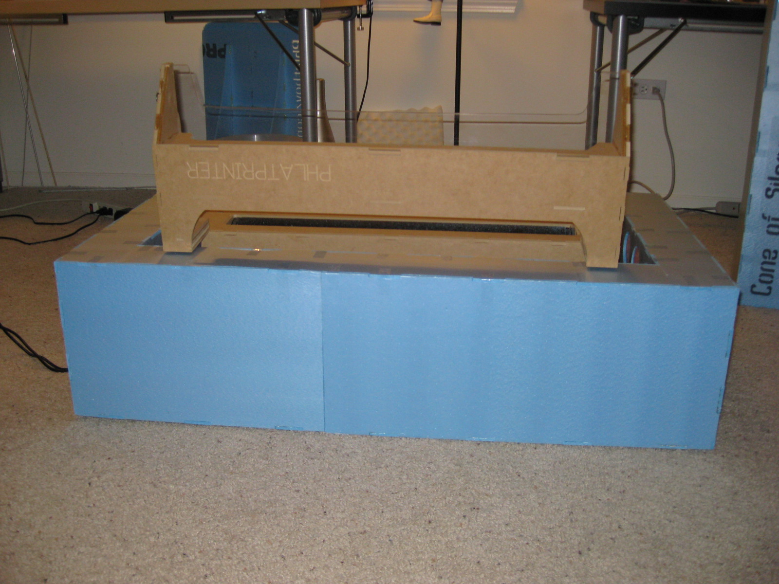

    Well I just completed the Cone of Silence build, and ran some cuts on the PhlatPrinter. The Cone of Silence makes a huge difference! My wife was asleep in the next room, she is about 25 feet away from the PhlatPrinter and there is a short 5ft hallway between the two rooms. She did not wake up when I started cutting! This is with the doors to both rooms open!
    With the doors closed to the room you can only hear the louder buzzing cuts, like when a small piece in a text cut falls out onto the cutting bit. Also the dremel can be heard a little when it is in the middle of the y axis and is buzzing on the rods. There is almost no chance of my apartment neighbors hearing anything.
    I think if I add some covers over the front and back holes on the PhlatPrinter itself, it's going to be even quieter. My RC club has a Db meter, maybe I can borrow it and post some numbers.
    Let me know if you are interested in the PhlatCode for this project.

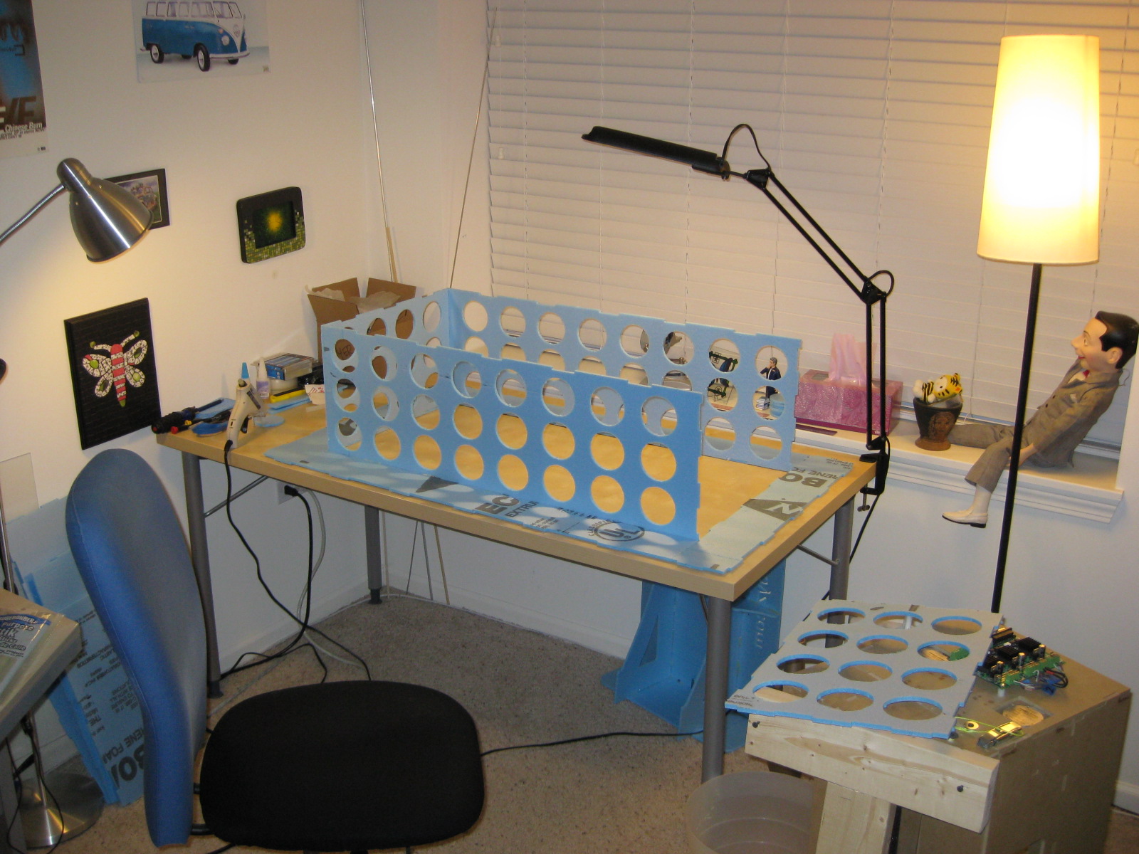

    Here are some photos of the build:
    Attached files [​IMG] [​IMG] [​IMG] [​IMG] [​IMG] [​IMG] [​IMG] [​IMG] [​IMG] [​IMG] [​IMG]

    The e-Assembly file is nice because by using the "Explode" icon, hiding or making parts transparent you can see how the Cone of Silence goes together.
    Just a few things that may help the build:
    1. The 2x4 stand is needed to get the PhlatPrinter to the correct height for the cone of silence slot openings. I added this 2x4 stand to my PhaltPrinter because it sits on a carpeted floor and the y axis will get stuck on the carpet, the stand lifts it up to prevent this from happening. Running on the carpet damps quite a bit of sound alone.
    2. The Cone of Silence top touched the top of my PhaltPrinter so I added one layer of foam shims to the top cover on the bottom surfaces.

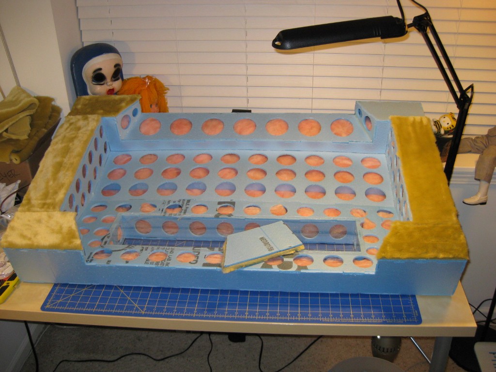

    3. I also added "Fashion Fur" :lol: to the bottom surfaces of the top cover to get a nice seal on the bottom cover. Attached files cone of silence dxf.zip (122.2 KB)Â cone of silence easm.zip (619.9 KB)Â cone of silence phlatcode.zip (46.4 KB)Â
  21. meistertek
    Here are some shots of the "Fashion Fur" I bought at Jo-Ann Fabric to seal the gap between the top and bottom covers of the Cone of Silence. Only 12" of the fashion fur was needed.
