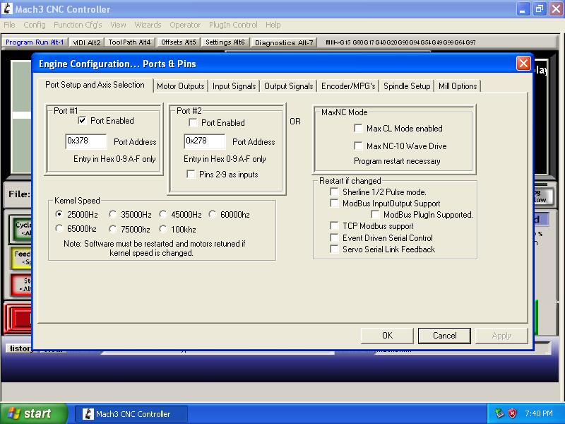

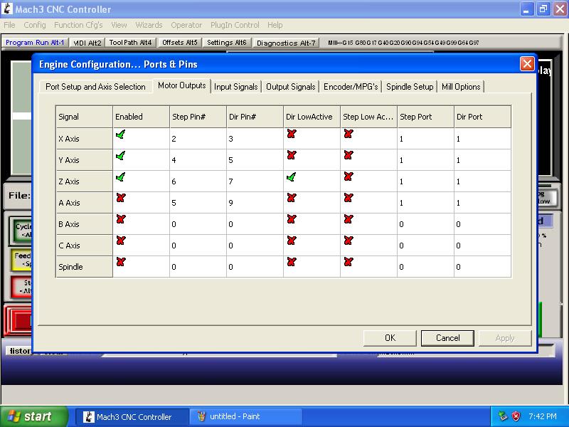

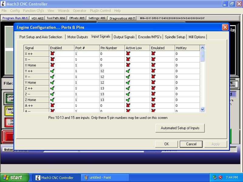

  6. TigerPilot
    I'm using Mach3. When I say printer I mean, of course, the PhlatPrinter. I have the PhlatPrinter III.
    I think these are the screen prints that are missing in the other thread. If it will not help you. let us know. Port Setup.jpg Motor Output.jpg Input Signal.jpg

    I test it an thanks for the pics.
