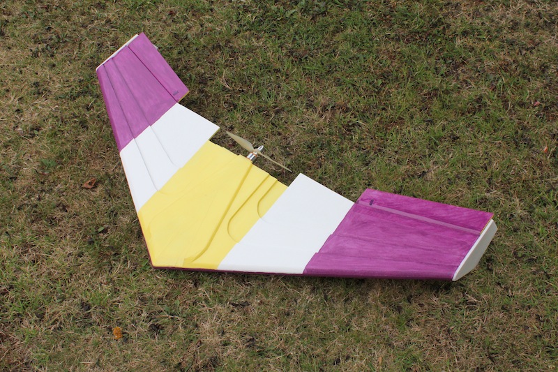

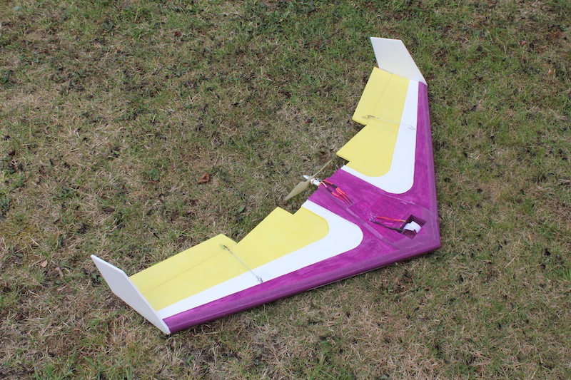

    I had C of G issues with mine. Originally I planned on using 1300 lipo, but had to use 2200 to help the CG. I also had to cut the motor mount free and some of the foam at the back of the wing so that the front edge of the prop nearly touches the foam. The pictures were taken before these modifications and I didn't try to fly it until the CG was sorted.
    Even with these changes I even up with 3oz of lead in the nose. Despite all the extra weight it still flies great.
    I also turned the wing tip fins up at an angle so they would suffer less damage on landing. Attached files [​IMG] [​IMG]

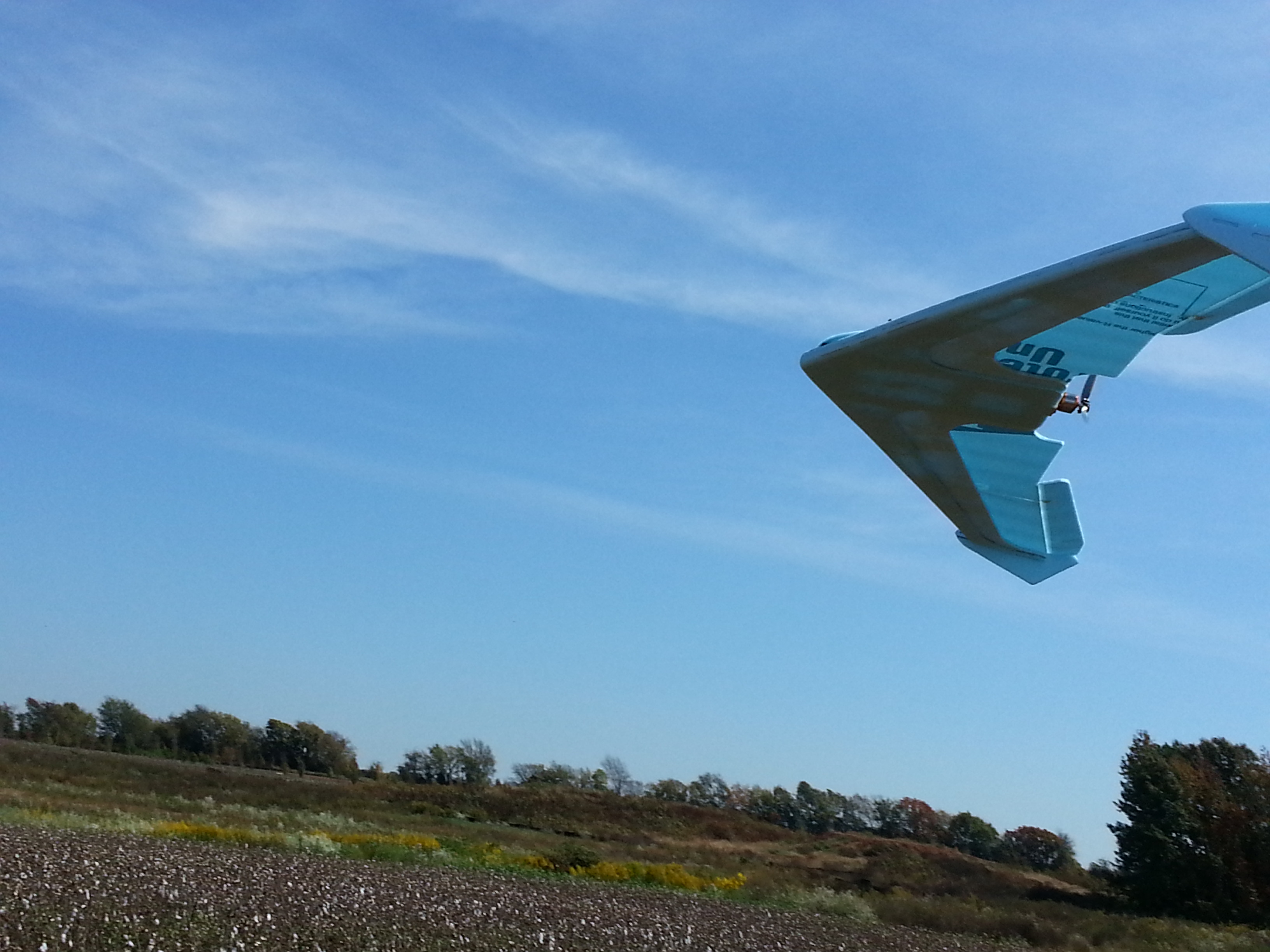

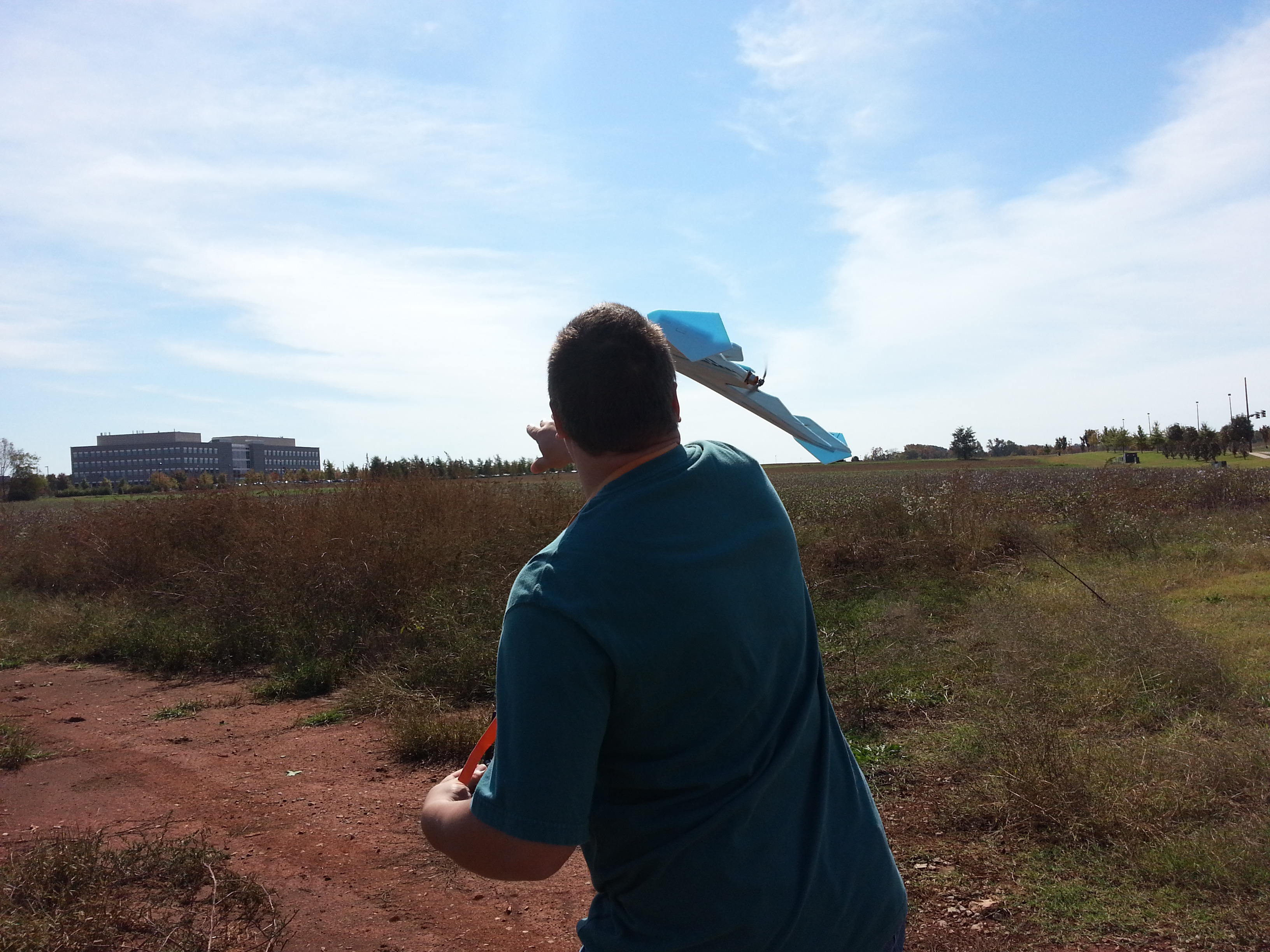

    Finally got around to building this, have been meaning to for a long long time. In any case didn't have any real problems balancing it though I did need to use some weight up front. Also had a 3s 2200 up as far forward as possible. size of the cut worked great for my batteries as it held them nice and snug. used the weight to lock it in back so no velcro on the battery was required but put some for insurances. Also used the half discuss launch method that Gere explained above. That worked great. Below are a couple of highlight videos from the maiden (reason its not painted!!). I would also highly reccommend a spare. You can do it and work without one but it was fluttering at times.
    Attached files [​IMG] [​IMG] [​IMG]
