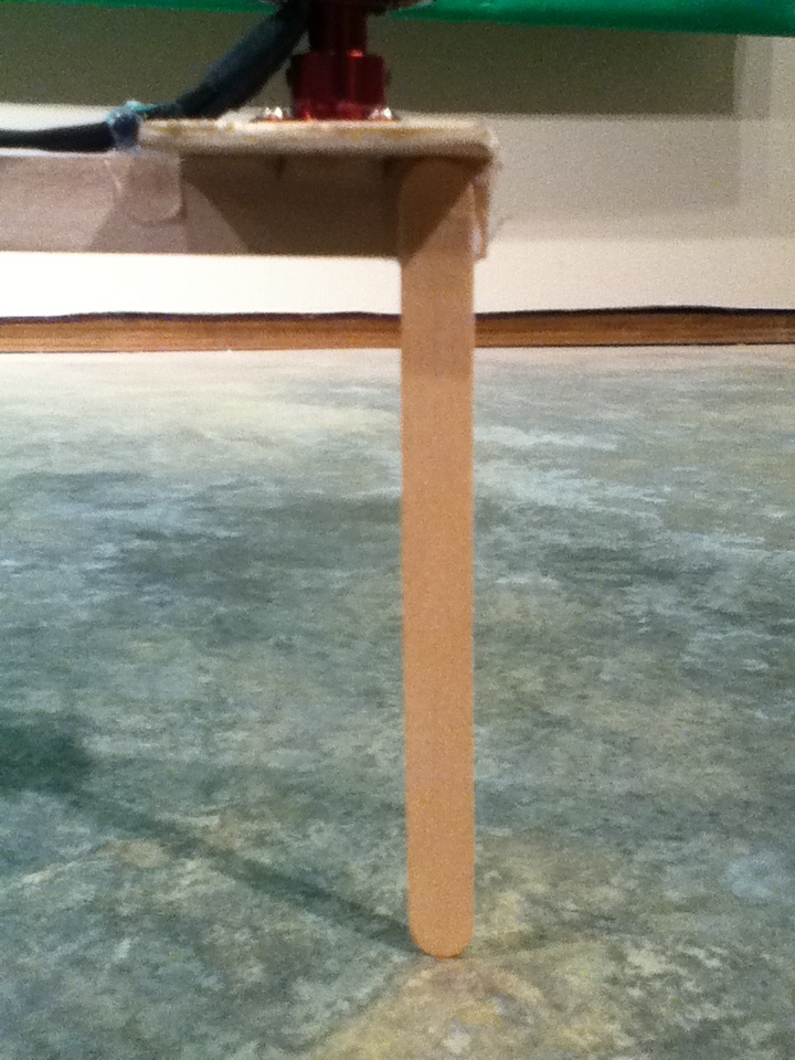

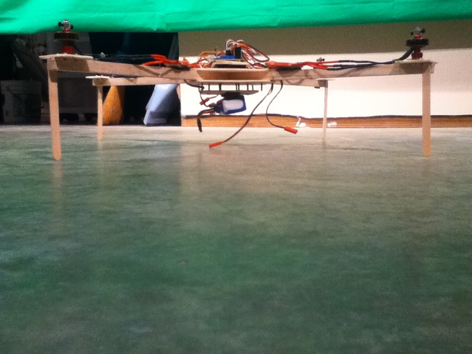

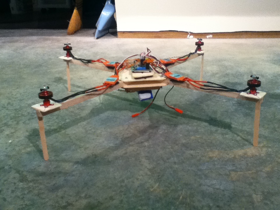

    So I came across this when i was trying to program a board, hope you guys like it. :D
    It is just Popsicle sticks hot glued to the ends of the booms. It is insanely simple and sturdy.
    Good luck!
    ~ Nathan Attached files [​IMG] [​IMG] [​IMG]

    sorry that my first post here is negative but i dont recommend these landing legs!
    the nature of quad flying and especially landing is such that an inturned claw shape would be best.
    whist i applaud the frugal modification i hope no one takes the design on.
    this style would "catch" and flip your quad quicker than a fenchman on shrove tuseday.
    i can post you a gcode file or skb of some claw quad legs if you like.
    im sorry but im not seeing how to do that on this post.
