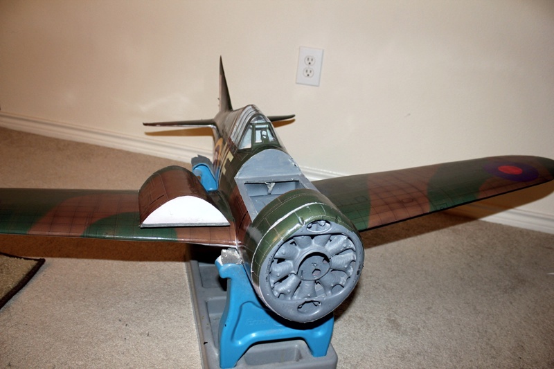

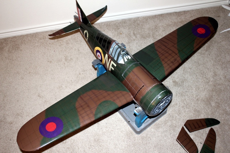

    The wether is really cold, and I'm still waiting for the motors for the Buffalos. In the same time, the camouflage "paints" are ready for printing. So now I'm uploading the files... 1.36Gb each, and that take some serious time.
  9. Watt_the?
    Watt_the? Member
    143
    McKinney,Texas

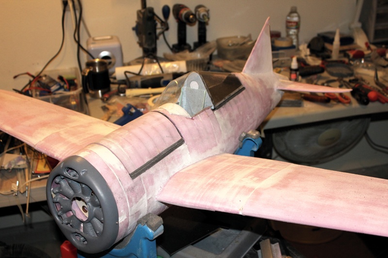

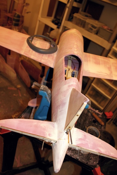

    The retracts did not hold and broke while the plane was landing... so next gen. will have fix retracts until I find or buy a Mill CNC. I'm still waiting for the skins, and I hope this week to have them.
    This is the status with the construction right now. Attached files [​IMG] [​IMG] [​IMG] [​IMG]

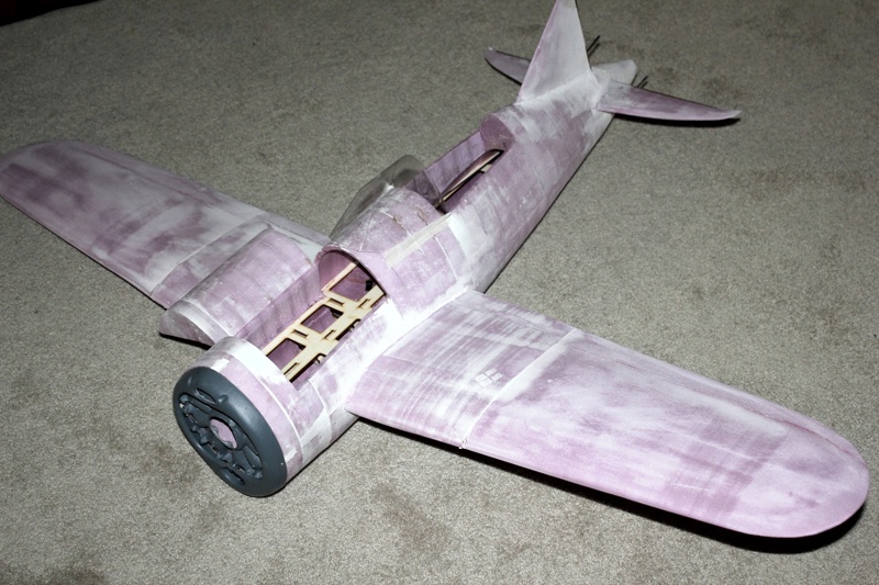

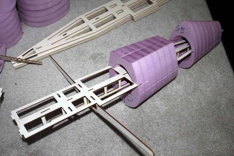

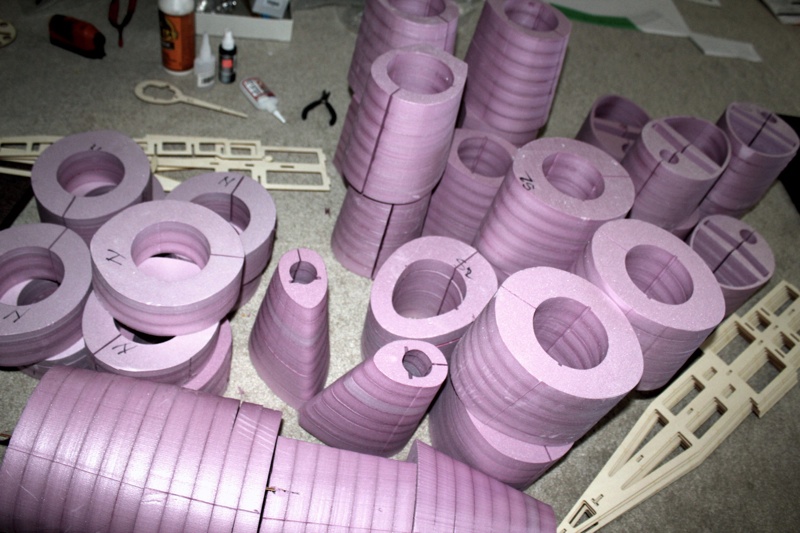

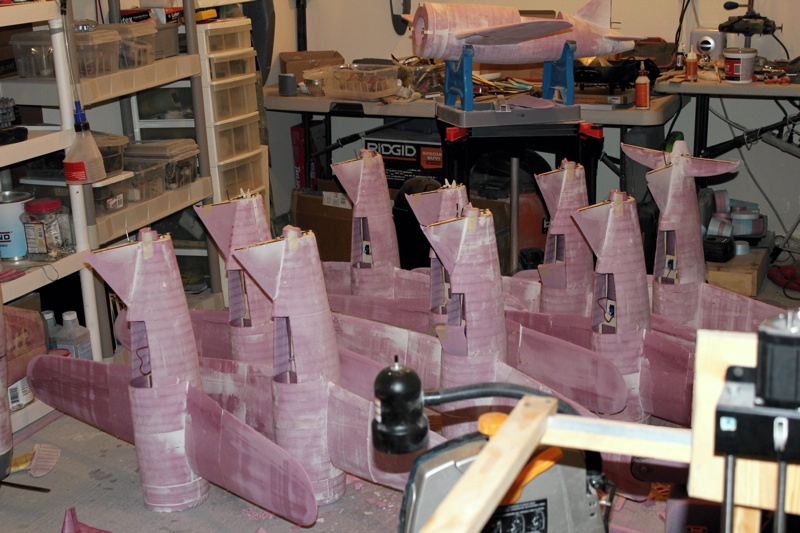

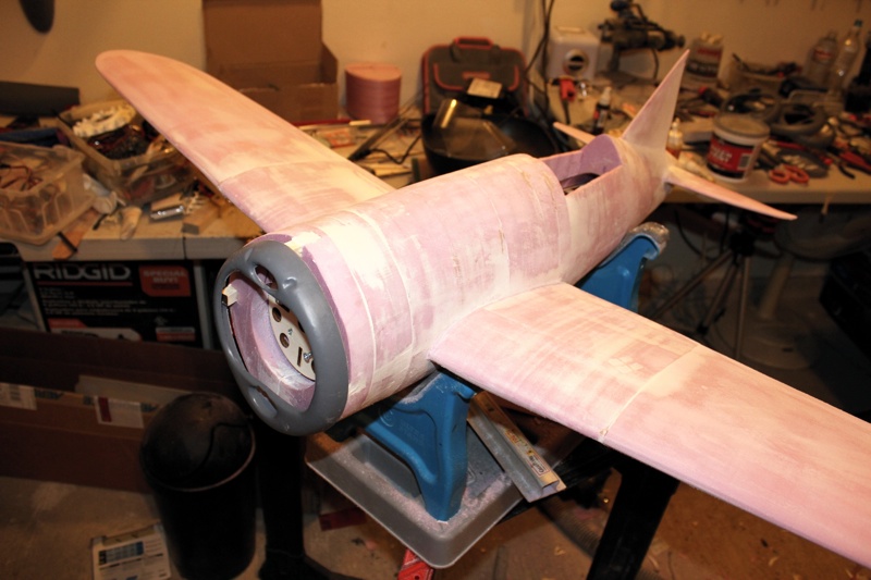

    I tuck a break, I watch the show, and then I went back and did some more work.
    This is the way things are right now... Attached files [​IMG] [​IMG] [​IMG]
  15. TigerPilot
    This plane is massive. You plan on shipping it in kit or assembled? Can you spell B I G B O X? :D

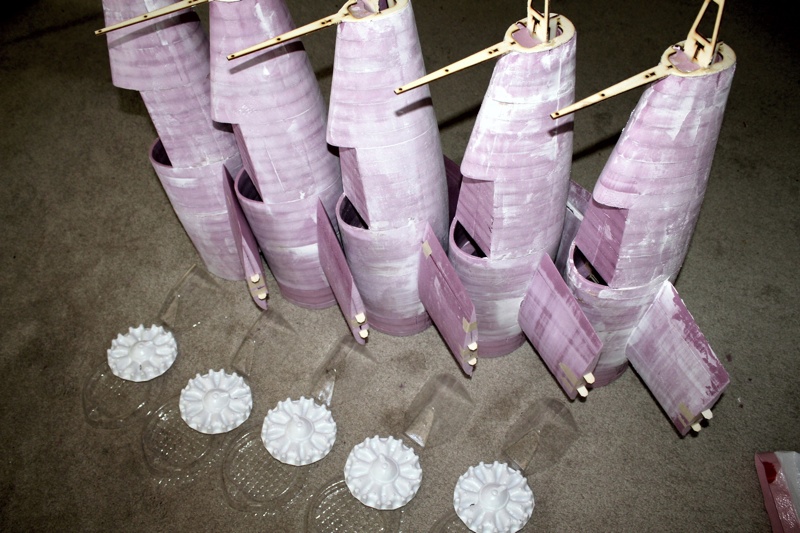

    McKinney,Texas

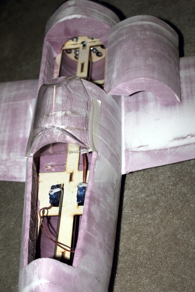

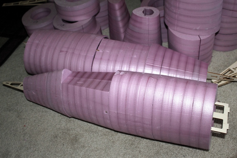

    I have a small update. Now all the planes have tail ready, servos mounted, and the battery hatch cut. Hope tomorrow will get the canopy plastics done.
    Enjoy !!! Attached files [​IMG] [​IMG]

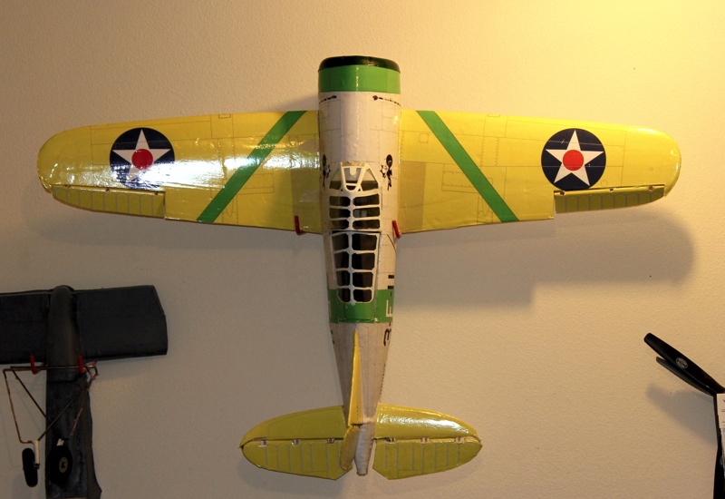

    I try to take it as far as possible. I want the kit to look like a scale plane and cost like a foam plane. The most important part is the way it flays, the way it look and to be easy to repair after a crash. Actually to be able to fly right at the field immediately after the crash.
    I put a picture with the yellow/grey one to see what was the damage.
    I'll do most of the work for ARF and PNP, but people will be able to take it to the extreme with the details. As far as a baritone kit I'm still thinking.
    Now the hard part is to keep the weight low and not get to crazy with the wood.
    I can make a detailed cockpit, but again I'm between choices. If I make it 2D, just stickers attached to strait walls would look just 2D... If I make 3D with the Phlatprinter will be nicer looking but I have to do the painting.
    Next kit will be a "collaboration" between Phlatprinter, my old foam cutter and the Phlatformer. In the past I build a He129 (WS 101 inch), but was not to scale because the aileron hinges... Now with the Phlatprinter I can make them so I know next one will be a german WWII bird, big, big with a detailed cockpit and skin. I was thinking of the Me410, but is with 2 engines, and now in this economy where the money are tight, two means more money spend for everything... so I'll keep it to one engine plane.
    If you have ideas... are more than welcome I'm open to suggestions. Attached files [​IMG] [​IMG] [​IMG]

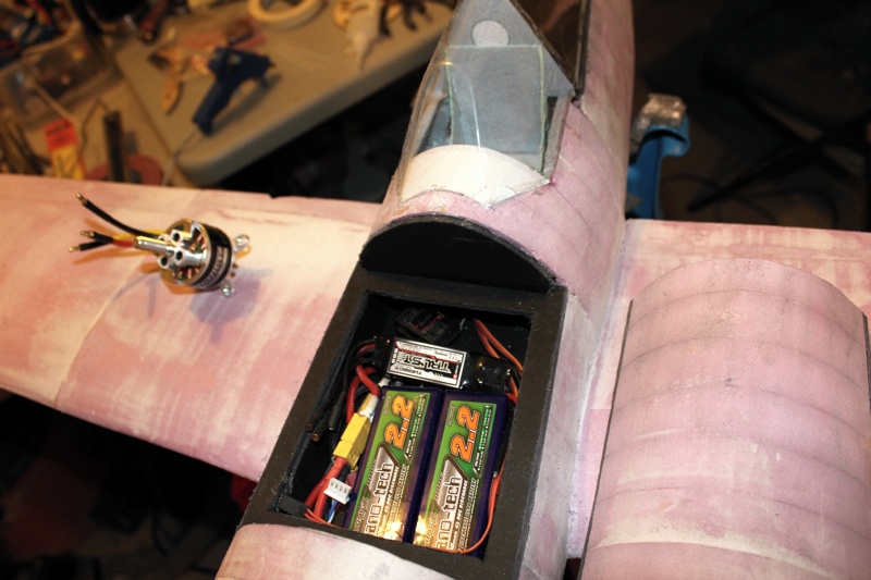

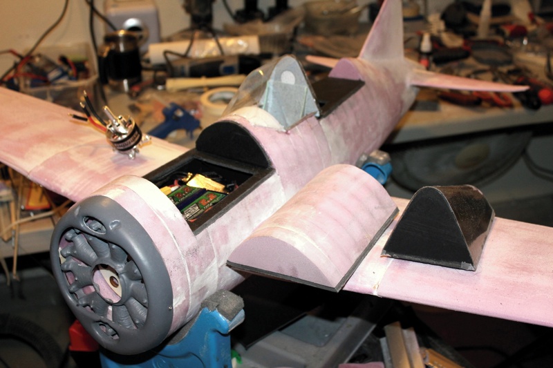

    McKinney,Texas
    Yesterday I clean the "shop" and today was slow... but still I did something. This is the configuration with batteries, ESC, receiver and the motor I use now. Once all the gear is in I'll weight it. Next week for sure the skins will arrive...
    Enjoy!! Attached files [​IMG] [​IMG] [​IMG]

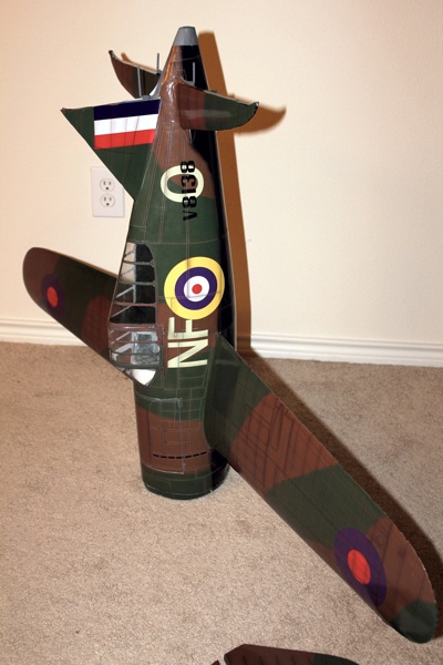

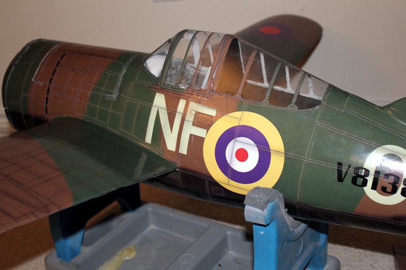

    McKinney,Texas

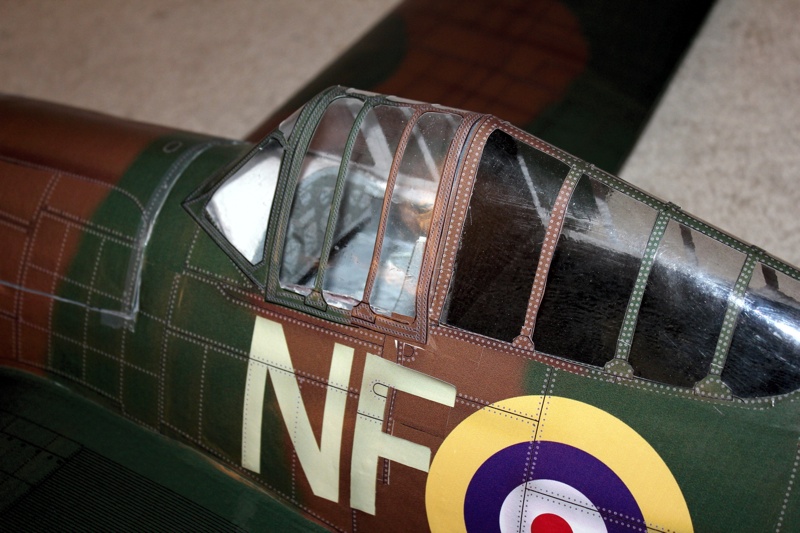

    And the last update for this version... next version will have a hard shel before the vinyl. Because the battery hatch I had some small misalignment problems with the skin, and for now I put some temporary tape. Being first kit, I learn a lot from it's construction, in the future I'll avoid the mistakes I made with this one.
    The cockpit is made also by printing on paper and gluing it on 3mm Depron because is lighter than thermoforming plastic and I didn't have to paint it... like the plastic would require. Also the pilot is missing for now, andI'm still debating... looks vs weight. Anyway, I still have to get the fix landing gear and ailerons done before first flight.
    I know the time and money spent on it... so I have a ballpark figure on the price but I'm curious what would you pay for this kit, ARF and RTF.
    I think is an improvement from what was in the past, and next generation will be a real commercial kit.
    So enjoy !!! Attached files [​IMG] [​IMG] [​IMG] [​IMG] [​IMG]
