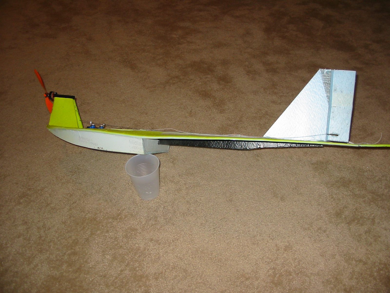

    The "Surfing" flying surfer dude had it's first water tests this AM. Here are my observations:
    Flies well in general.
    Rudder is less effective while flying; probably because it is not in the prop blast any more with the high thrust line.
    Floats fine.
    Taxis on water OK but turning was kinda slow
    Won't take of from water. I couldn't get the back end to go down.
    Lands fine on the water.
    Here is a video of this mornings tests. http://s715.photobucket.com/albums/ww154/lead2feather/?action=view&current=surfing.flv
    I think the fix for rise off water may be to minimize the fins and possibly add some rudder above the board. Still thinking about this.

  10. TigerPilot
    When I first saw your surfer I thought that the step is way to short. There is not enough lifting area in the front that will stick out of the water to give it the push up. The rear area, on the other hand, is way to long to cut the suction of the surface tension. The problem is that the CG is so much forward. If you'll put the step further to the back it may not rotate.

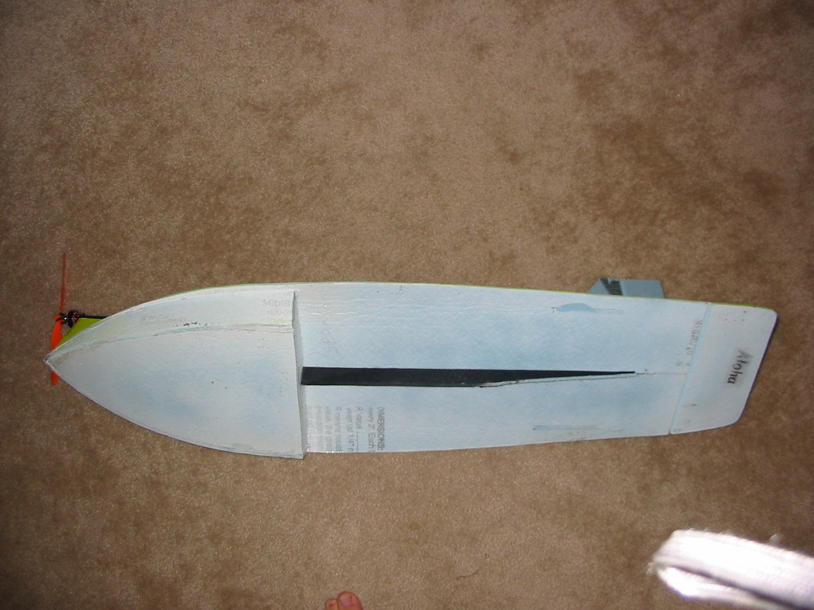

    I was able to modify my surfer to rake off from ground and from water. :D :D
    I've got some ideas for more improvements and a better looking "surfer" (better looking than the simple fin I used) will be added in.

    What was the difference in this version (besides the rudder) and your first one that would not take off from the water? Do you think it's because you got rid off the fins? Maybe they were keeping the angle pointed down?
  25. leadfeather
    leadfeather New Member
    14
    Even with smaller, thinner fins, they created so much drag I couldn't get enough speed for take off. Then I realized by getting rid of the fins altogether for max speed on water I could also possibly take off from ground. It worked for both ROW and ROG. ;)
    I think the improvements from here would be a deeper hull to allow more rotation for take off and then I could also lower the thrust line too.
