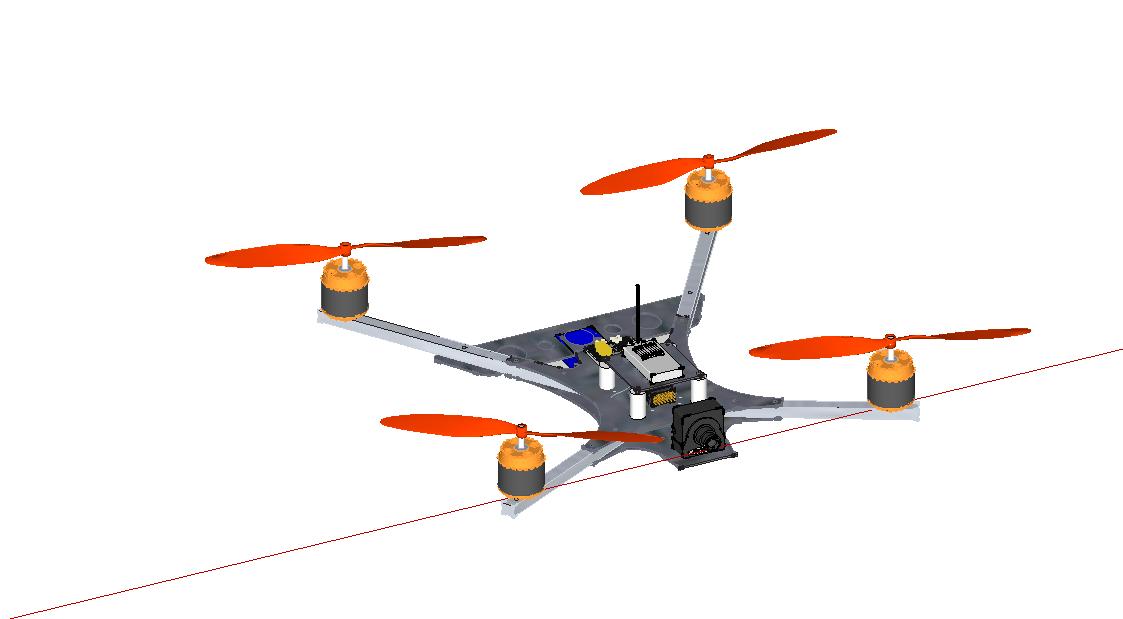

    Here's one I have been working on it uses good ole slow stick fuses(3/8 sq aluminum) and 1/16" g-10. I used the basic shape of one I found online and changed an few things on it to suit me, still have to decide on landing gear and motor mounts. Gotta order some G-10 so I can get it built .
    Attached files fpv quad.skp (13.5 MB)Â [​IMG]

    Got it finished, flys great!! used a bondo lid for the "dome" :)
    Equipt.
    frame- 1/8" lite ply (for now)
    booms-slowstick fuses
    4- suppo 2212/13 motors
    4- hobywing 18a escs
    open pilot copter control board
    sony kx 191 camera
    rangevideo 500 mw tx/rx
    3s 2200 lipo Attached files [​IMG] [​IMG] [​IMG]
    Nice job Ken! It come out just like the sketchup you made :doubleup:
