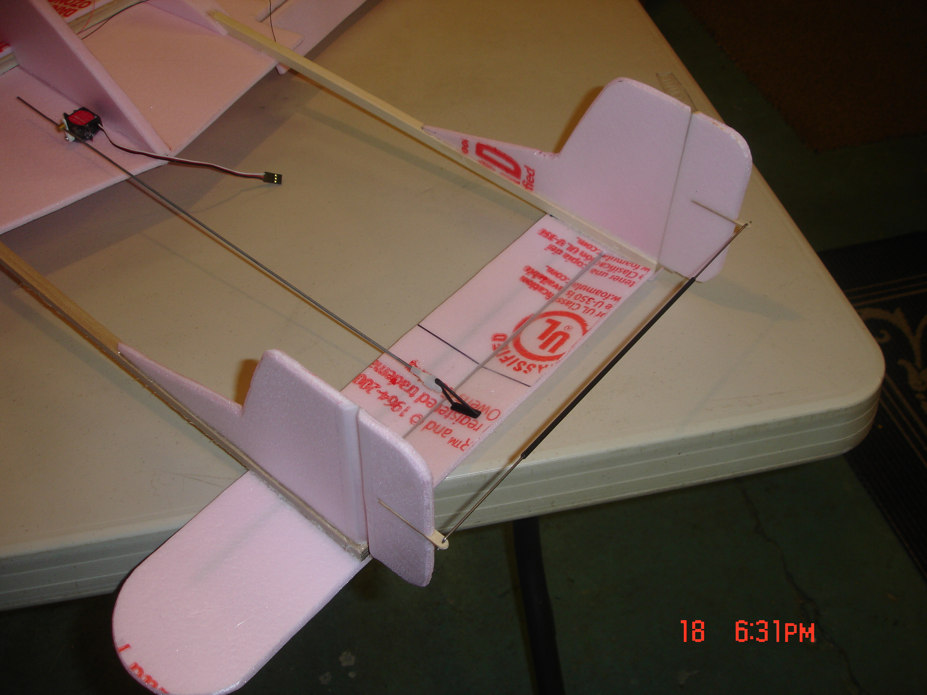

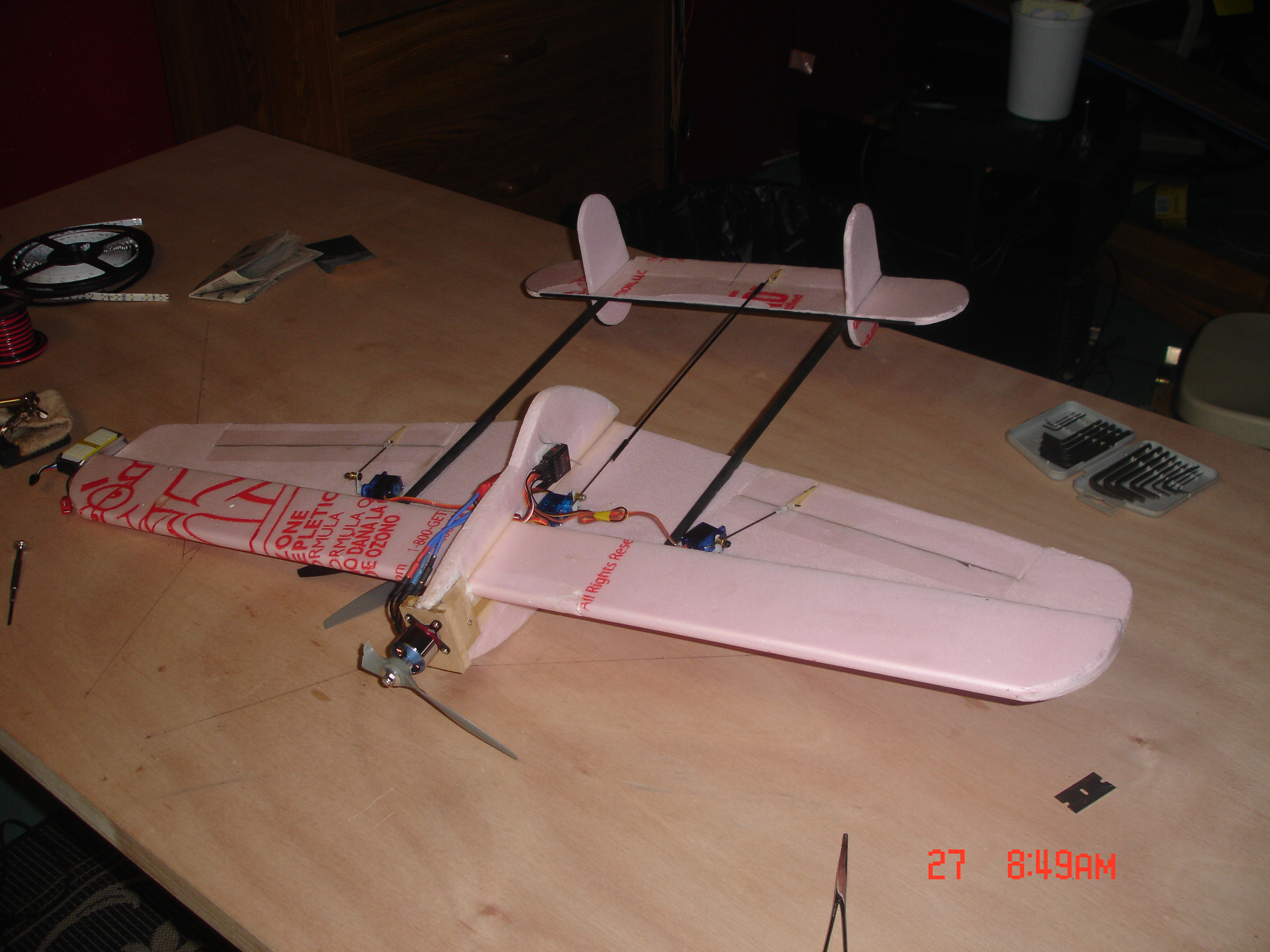

    I like the Funder so much I decided to build a "Big Twin F&L" whilst waiting for my Phlatprinter :p
    Built at 125% of the F&L and using two of the 56g 1400kv RCtimers that I use on the 100% version it ought to go just fine :twitch:
    I also modified the tail to allow rudder installation. The full size version has no rudders and I find myself still twitching the left stick when I want to straighten out a climb or whatever. In the original thread they swear rudders aren't necessary, and truthfully it does a good job without them, but I really can't help but think they will improve some points of the aircraft.
    Now if the mailman would bring me some electronics I could fly it on about an hour or so. Attached files [​IMG] [​IMG]

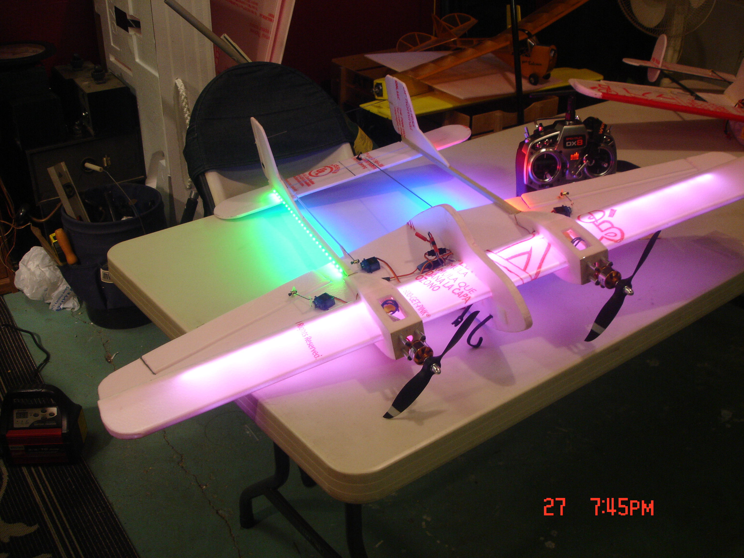

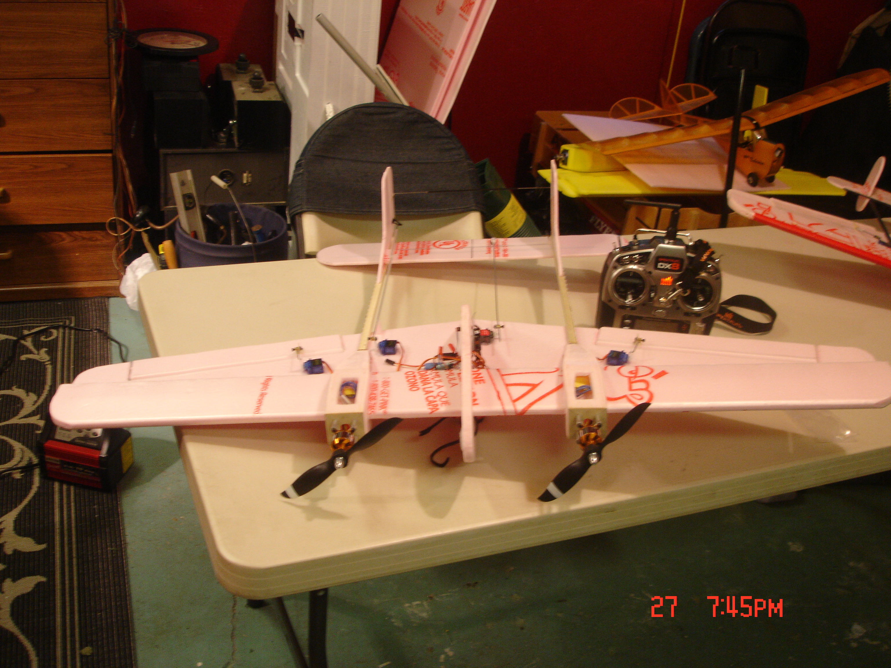

    Here she is with her guts and night flying garb on.
    She flies like a dream, pretty much unlimited vertical and will do loops as big as the sky.
    The rudders do add some kick to the tail when tracking loops and drilling holes in the sky, I think they need to be bigger in relation to the fixed portion of rudder.
    If you are not flying at night you are missing out!!!!! Attached files [​IMG] [​IMG]
