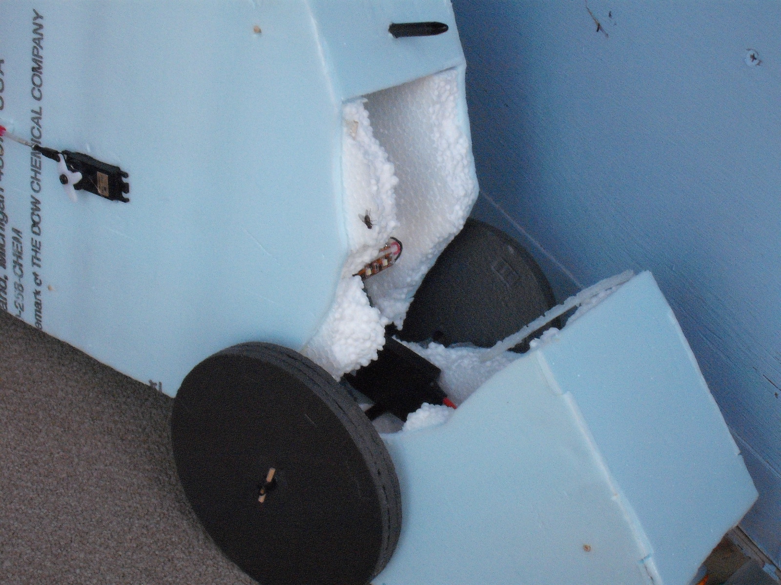

    I spilled the details on the latest CrashCast...It flies great, rather it did fly great..up until the wing decided to show it's joy for the flight by clapping :twitch:
    We had a structural failure of the wing, but the damage was very minor considering. The worst of it was when it pancaked to the ground...the nose caught the brunt of it. I will try to post pictures later this evening. Heck, I haven't even unloaded the trailer yet from Sunday...

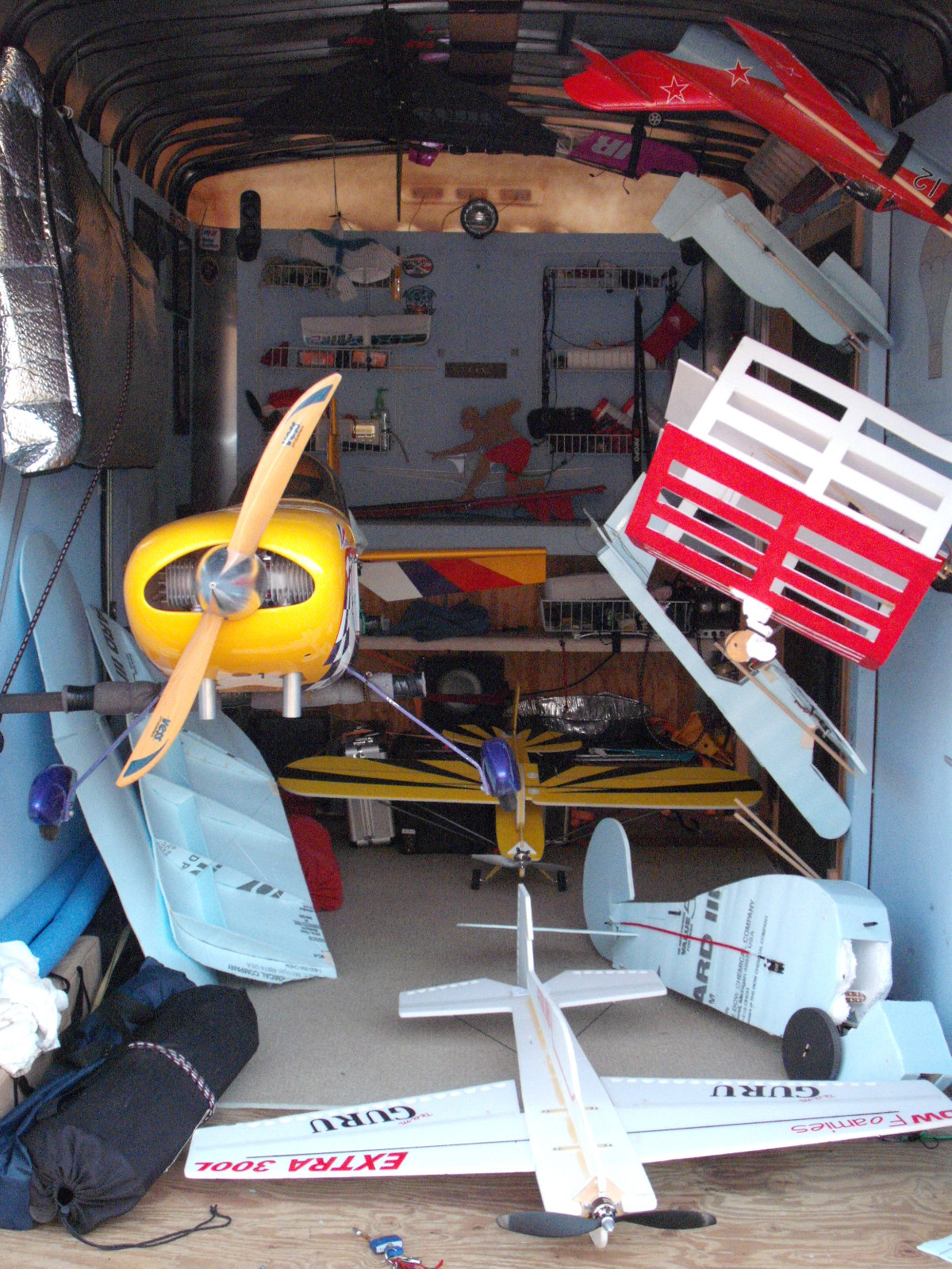

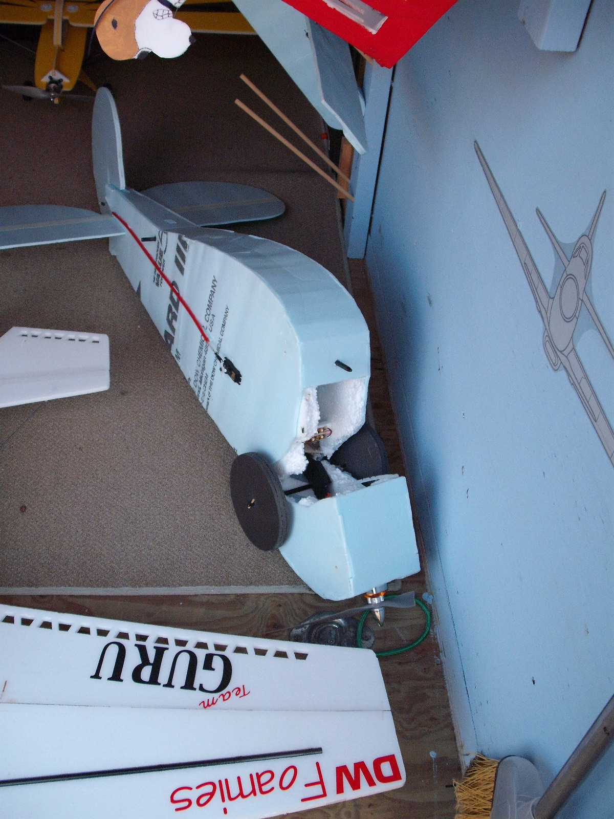

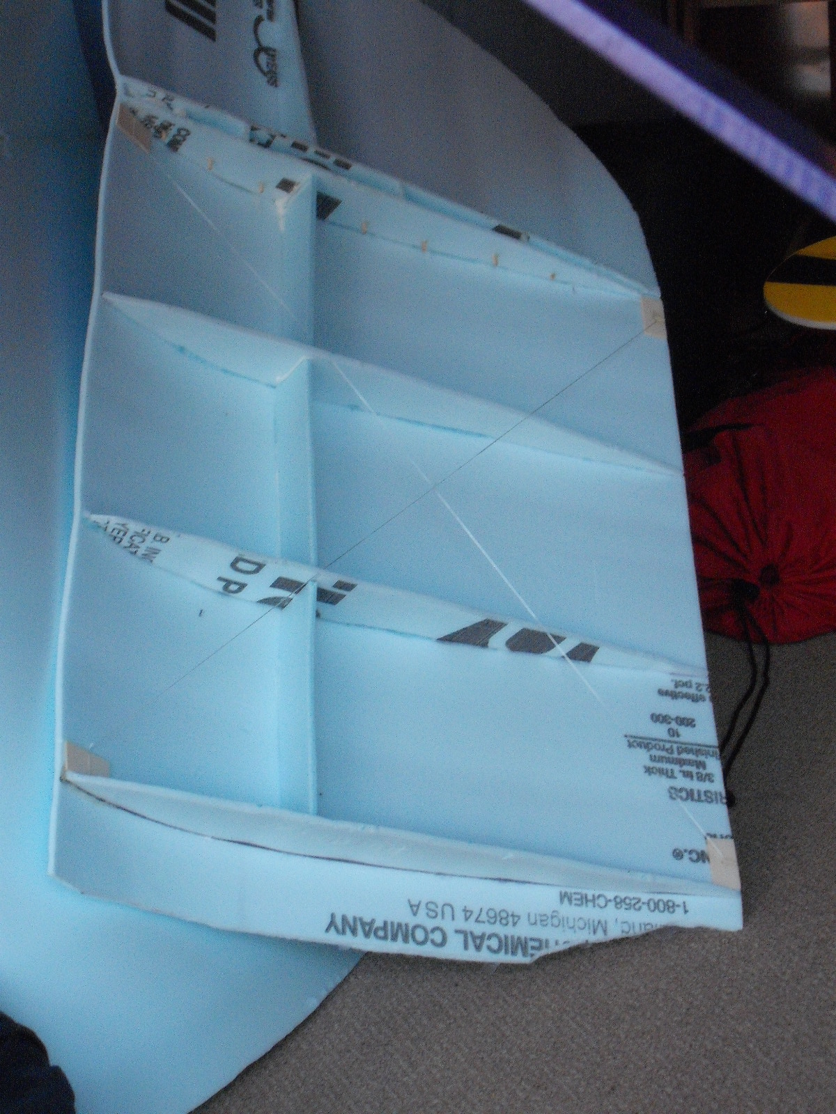

    As promised...here are a few pics, right before I unloaded the trailer this afternoon.
    Attached files [​IMG] [​IMG] [​IMG] [​IMG]
  11. kram242
    Cool pics Tim! Love the Flying Surfer Dude chillin in the back ground :good:

    241
    Urbandale, IA
    Well, here are those darn structural challenges we were talking about. :( But, nothing a 2" spar wouldn't fix. :D

    All right, so I got some time tonight to really look at and think about the repair. The nose section got epoxied back on. Some 30 minute Epoxy, and a nice large surface to mix it on helped, as well as a couple of acid brushes.
    I joined the "cooler foam" back, and have it all jigged up to support the nose and plane while the epoxy sets. I also am going to add some fiberglass cloth to help scab the joints. With that, and a few well placed skewers I think the nose will be fine.
    The good news is that I didn't find any other structural damage. When I build the next one, I do have some changes in mind. I will use 1 inch blu-cor for internal bracing, rather than the cooler foam I had on hand this time. I know there will be a weight penalty, but realistically, it won't affect performance.
    The other thing is I will add the traditional landing gear box that a real Lazy Bee uses. I see the need for a floating, shock absorbing gear for this thing, even at this light of a weight. I think the damage would not have been as bad had if I had incorporated it first.

    OK, so I repaired the wing...a little more fiberglass and epoxy, as well as the addition of a yardstick spar, and it is strong! I got to fly it again, and I am HAPPY!!! The power system is beyond insane (thats a good thing!) and it flies very well. Quite responsive, and feels light as a feather (Wonder why,:lol: )
    The wing held up well, and showed no signs of "Clapping" again. I am going to incorporate some tie-downs into the spar, though...the slightest breeze and she wants to dance all over the place while on the ground. There are still some improvements to be made, and I think I am going to go ahead and sheet the bottom of the wing. I still get a little twist, even with the dental floss bracing, that I want to eliminate, and it will make it easier to do the LEDs in the wing. I would rather have the wing glow like the rest of the fuse, rather than have the LEDs out in the open, where they will blind you when it is flying close by.
