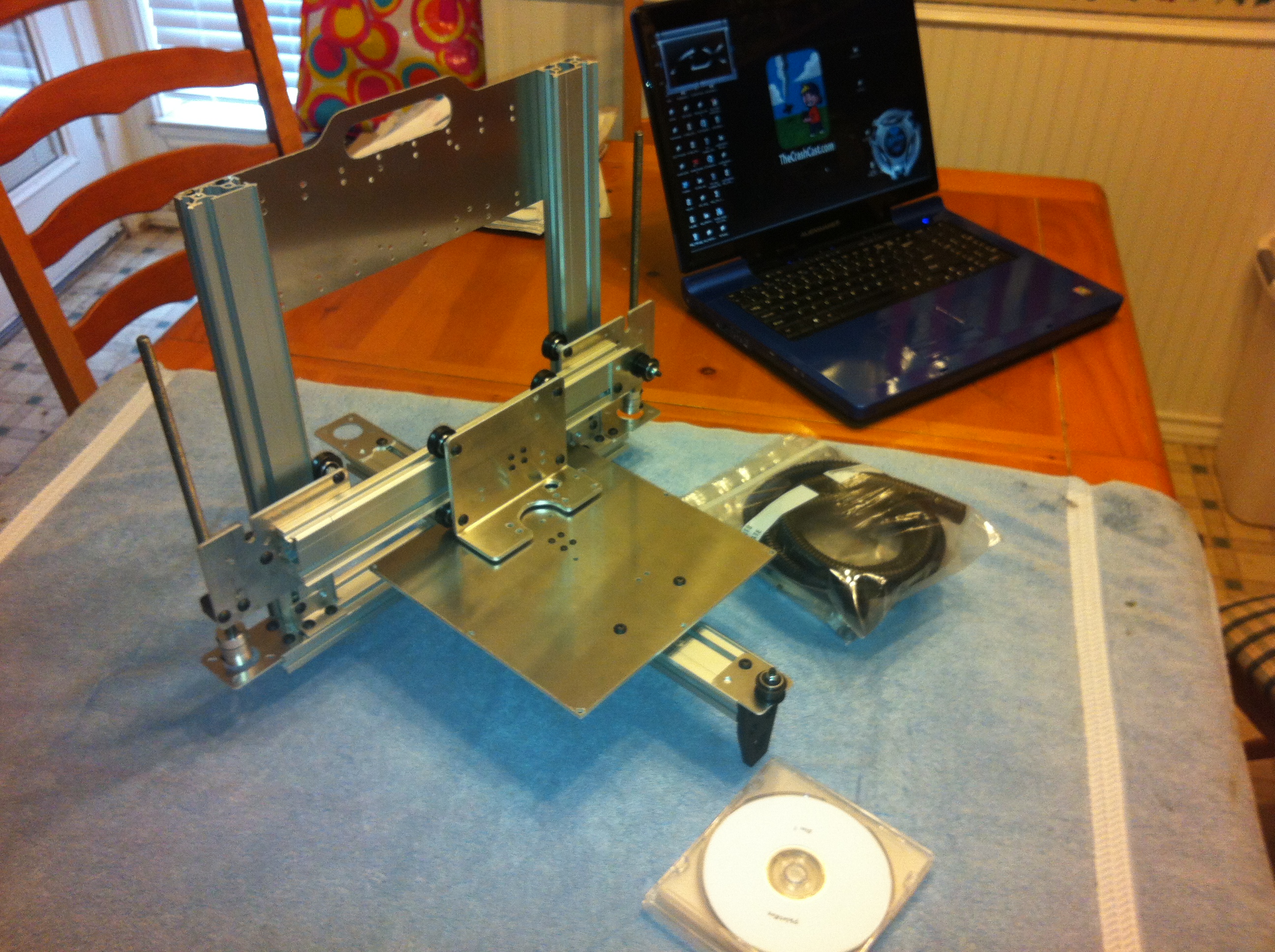

  13. Crash
    Same here. I got a dupe of disk 1 labeled as disk 2.
    Did you guys get Limit switches with your kit? I did not and am wondering what I need to buy.
    And, BTW, I have completed my build without disk 2. It's all kind of straightforward after disk 1 anyway. All I need is to get some steppers motors, a heated bed, a hot-end and extruder, and a tap to make threads for mounting the front leg. The cool thing is that I finished all that I can in only a couple of hours. Attached files [​IMG]

  19. nitro
    nitro Member
    40
    Hey crash, Nice job on the building, looks great. I am really looking forward to this thing for sure. Thank God for you guys and this forum, it makes taking on these projects a lot easier. Larry
