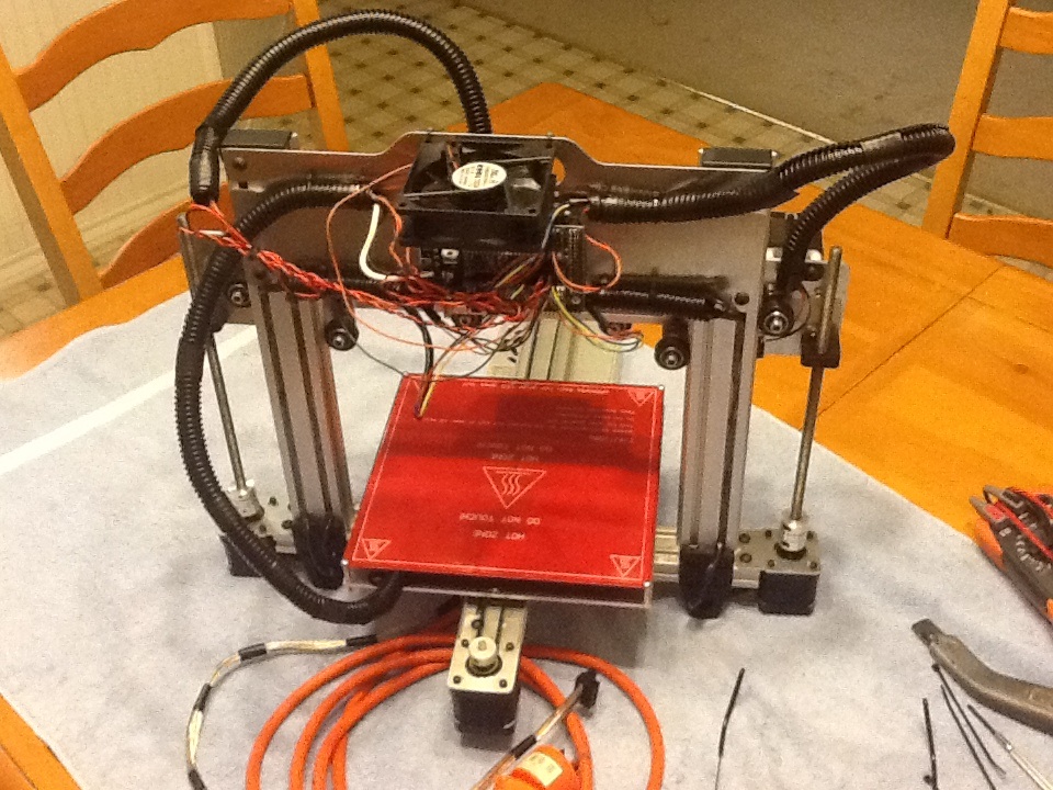

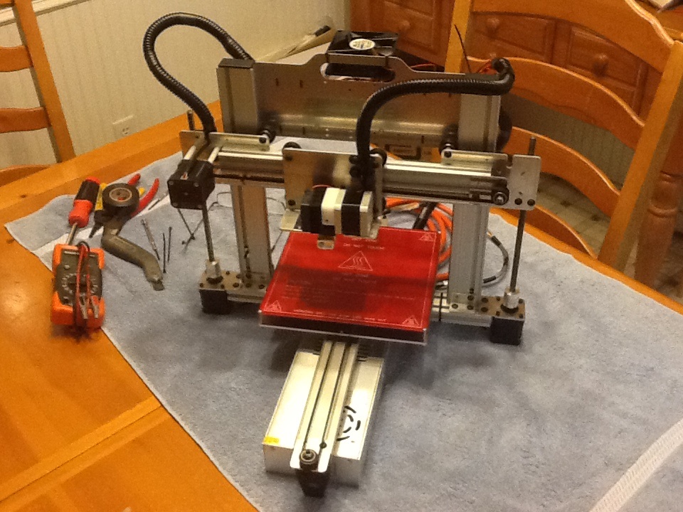

    Well, I finally found some time to get back to my PhlatBot!
    All I lack at this point is to extend the wires for the extruder, extruder stepper, and fans, the I should be ready to flash the firmware to the board and make this thing start moving on its own. The only thing I have left to order is some filament. I'm thinking I'll get a roll each of ABS and PLA, but plan to start with the PLA.
    Now I've gotta start researching to figure out where to get all the software... Attached files [​IMG] [​IMG]
    Looks great Mike! :doubleup:
    The software I am using is Repetier
    http://www.repetier.com/documentation/repetier-host/
    It has Slic3r built into it as well as a Repetier version of the Marlin firmware that you can flash the Arduino with. (you can just use marlin as well if you like)
    Its nice because everything you need is in one place.
    Hope this helps
    Have fun Mike your almost there Brother! :)

    All the wiring is complete and software is installed, and I have made the gantries move!
    Of course, the steppers, as I wired them, were exactly 180 degrees off (isn't that how it usually works out? LoL). I flipped the plugs and now everything moved in the correct direction. The thermistors are properly feeding back and I am getting heat to the hot-end and bed.
    Basically, I think all that I have left to do is to level the glass and print a calibration square and start tweaking. :D

    Crash, I will second everything Mark said..run the fan all the time. I have done this on my MendelMax from the start, and have not had any issues.
    Side note...the dining room table looks nice and protected from "errors." Glad you learned from past builds! :lol:
